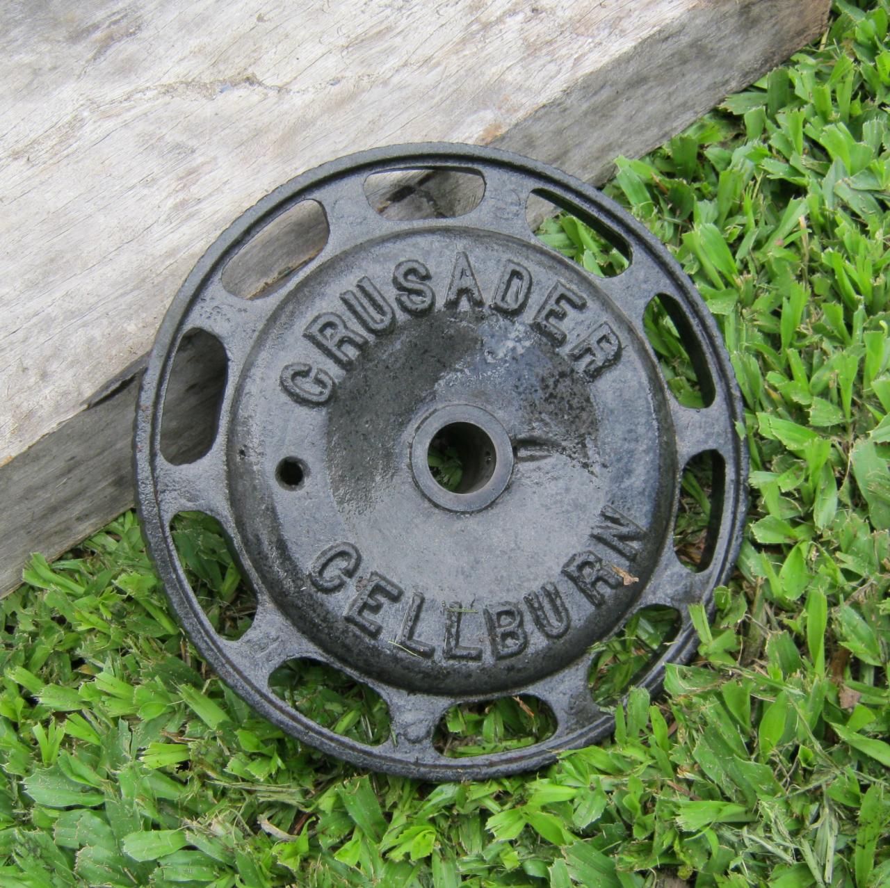

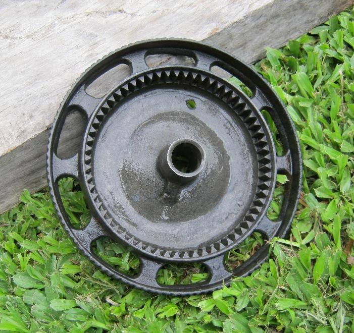

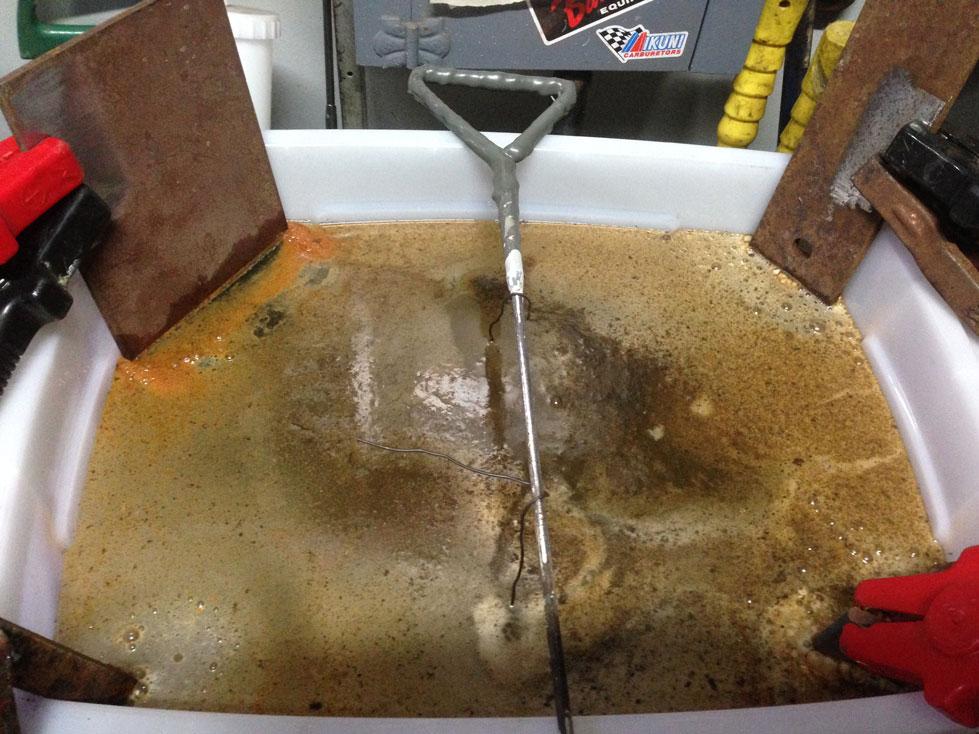

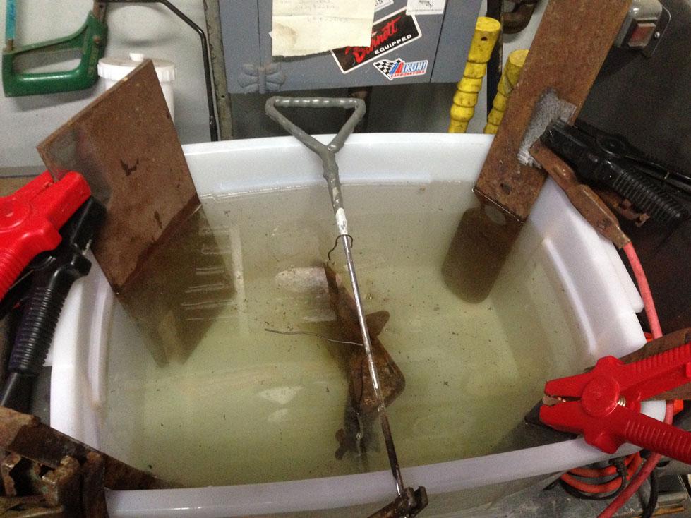

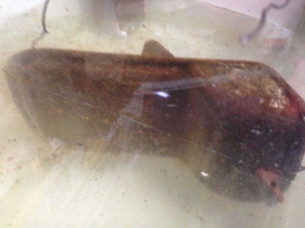

Continued war on rust, I've been meaning to try this for some time now so off to the supermarket to get some washing soda, None, so Bi-carb baking soda it is, they are not the same thing but you can make Baking soda into washing soda by sticking it in a pot on high and stirring it every 10 min or so, I did this for a bit over an hour, once the sort of steam stops coming out of it it's done but I did it for a bit longer just to be on the safe side because it will not affect it any, set up a tub and some jumper leads and the battery charger and away she goes, working pretty fast too  the set up ![[Linked Image]](https://www.outdoorking-forum.com.au/forum/uploads/usergals/2014/01/full-6801-14232-start_set_up.jpg) the lid off my old Myers pump. ![[Linked Image]](https://www.outdoorking-forum.com.au/forum/uploads/usergals/2014/01/full-6801-14233-pump_lid.jpg) after 15 min ![[Linked Image]](https://www.outdoorking-forum.com.au/forum/uploads/usergals/2014/01/full-6801-14234-after_15_min.jpg) After 1 hour. ![[Linked Image]](https://www.outdoorking-forum.com.au/forum/uploads/usergals/2014/01/full-6801-14235-after_1_hour.jpg) Will take some more pics when I get closer to finishing it, but I pulled it out for a look and it is working a treat.

Wow Jonesy, i've never tried it but have heard good things about it. i just didnt realise it was that easy to set up at home. Is there a risk or leaving your parts in there too long and totally disintegrating them?

Bigted,as Gadge has pointed out, very good on steel and cast but will eat Aluminium and brass ect, the soda ash I will look into but I only used about $2 worth of baking soda and from what I have heard the water may get all gunged up but will last as long as you want to put up with it, I have also read that if you use Graphite or carbon for the sacraficial anodes the water stays clean.

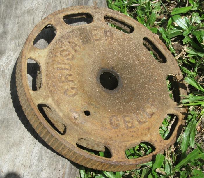

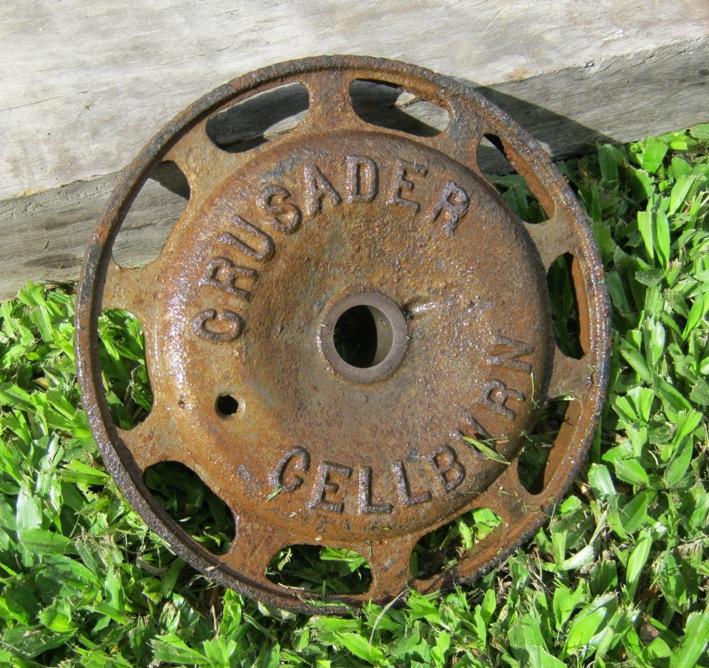

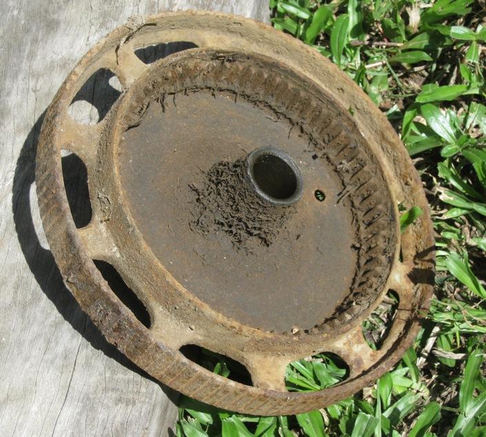

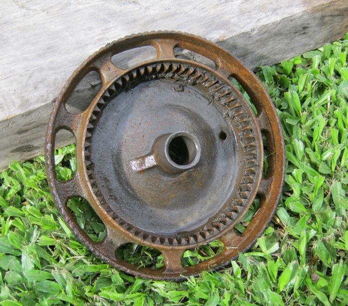

one thing to note guys is dont use stainless steel as an anode. the end mixture is extremely toxic using stainless.stick to mild or cast steel for your anodes. as far as disintegrating your parts. maybe if you left in in solution for 12 months?? it only reacts on the rusty bits so not too much to worry about ![[Linked Image]](https://www.outdoorking-forum.com.au/forum/uploads/usergals/2014/01/full-5742-14264-rust.jpg) ![[Linked Image]](https://www.outdoorking-forum.com.au/forum/uploads/usergals/2014/01/full-5742-14265-rust_gone.jpg)

Nice result there Gizmo, as I am only new to this stuff I only know what i have read so you guys with experience can teach others the benifits and short falls.

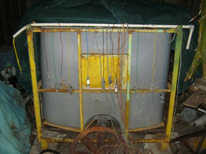

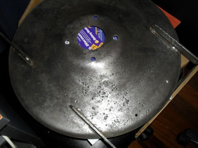

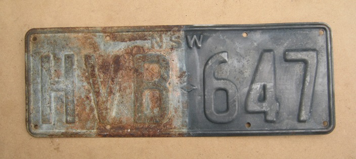

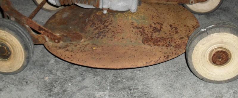

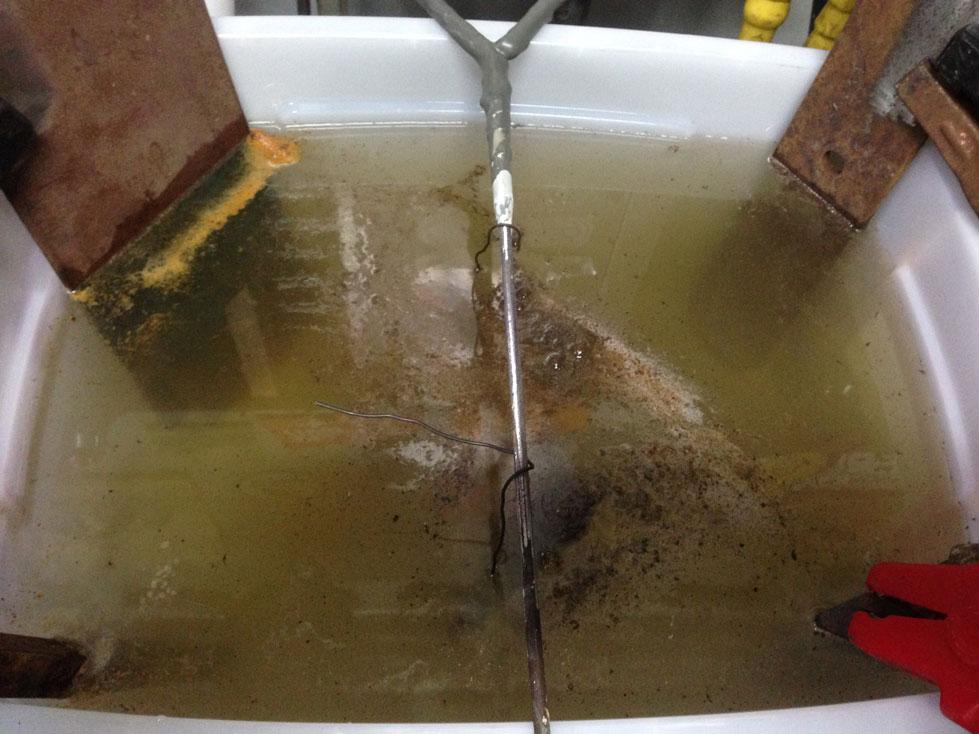

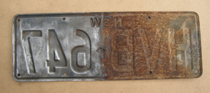

BB I disagree with what you have said You use washing soda or Soda Ash and no heat needed yes it can take a few hours for the above mower bass about 4hrs for me I have plenty of time I have been using this method for about 20 years and lots of info on it My tank set up below also lead is the best anode and you only need one Ian ![[Linked Image]](https://www.outdoorking-forum.com.au/forum/uploads/usergals/2015/01/full-7423-19558-img_1081.jpg) half Number plate took about 2 hrs then jet blasted with water and hand brushed with a brass wire brush ![[Linked Image]](https://www.outdoorking-forum.com.au/forum/uploads/usergals/2015/01/full-7423-19559-img_3983.jpg) ![[Linked Image]](https://www.outdoorking-forum.com.au/forum/uploads/usergals/2015/01/full-7423-19560-img_3984.jpg)

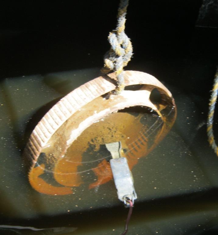

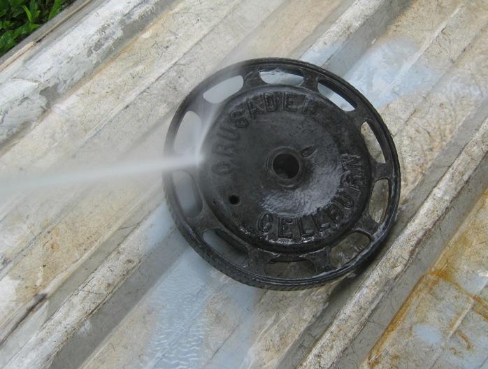

I decided to show how good a Electrolysis bath is Electrolysis bath works by forming Hydrogen bubbles on the surface of the GOOD steel/iron which means everything paint/rust/grease etc is pushed of the surface of the good steel/iron by the bubbles. The wheel was put in overnight I usually do this ready for the next day The wheel was not cleaned usually I brush of, jet blast of any lose junk The wheel was NOT rotated over night as I was sound asleep ![[Linked Image]](https://www.outdoorking-forum.com.au/forum/uploads/usergals/2015/01/full-7423-19584-crusader_01_r.jpg) ![[Linked Image]](https://www.outdoorking-forum.com.au/forum/uploads/usergals/2015/01/full-7423-19585-crusader_02_r.jpg) The wheel hanging in the tank with ONE anode facing the front of the wheel YES it was fully submerged ![[Linked Image]](https://www.outdoorking-forum.com.au/forum/uploads/usergals/2015/01/full-7423-19586-crusader_03_r.jpg) Removed from tank and you can see most of the junk has fallen off. What can be seen will wipe off with your fingers BUT to do a better job I use a jet blaster. Very small jobs where I would be chasing it around the yard with the jet blaster I do under a tap with a wire brush ![[Linked Image]](https://www.outdoorking-forum.com.au/forum/uploads/usergals/2015/01/full-7423-19587-crusader_04_r.jpg) ![[Linked Image]](https://www.outdoorking-forum.com.au/forum/uploads/usergals/2015/01/full-7423-19588-crusader_05_r.jpg) ![[Linked Image]](https://www.outdoorking-forum.com.au/forum/uploads/usergals/2015/01/full-7423-19589-crusader_06_r.jpg) All finished and clean when dry ready to paint or to make it shinny like the above mower base run a wire brush over it Drying of for me in North Queensland with our hot sun is easy you might have to find another way or just use a wire brush before painting to get of rid on any new surface rust Ian ![[Linked Image]](https://www.outdoorking-forum.com.au/forum/uploads/usergals/2015/01/full-7423-19590-crusader_07_r.jpg) ![[Linked Image]](https://www.outdoorking-forum.com.au/forum/uploads/usergals/2015/01/full-7423-19591-img_3993.jpg)
