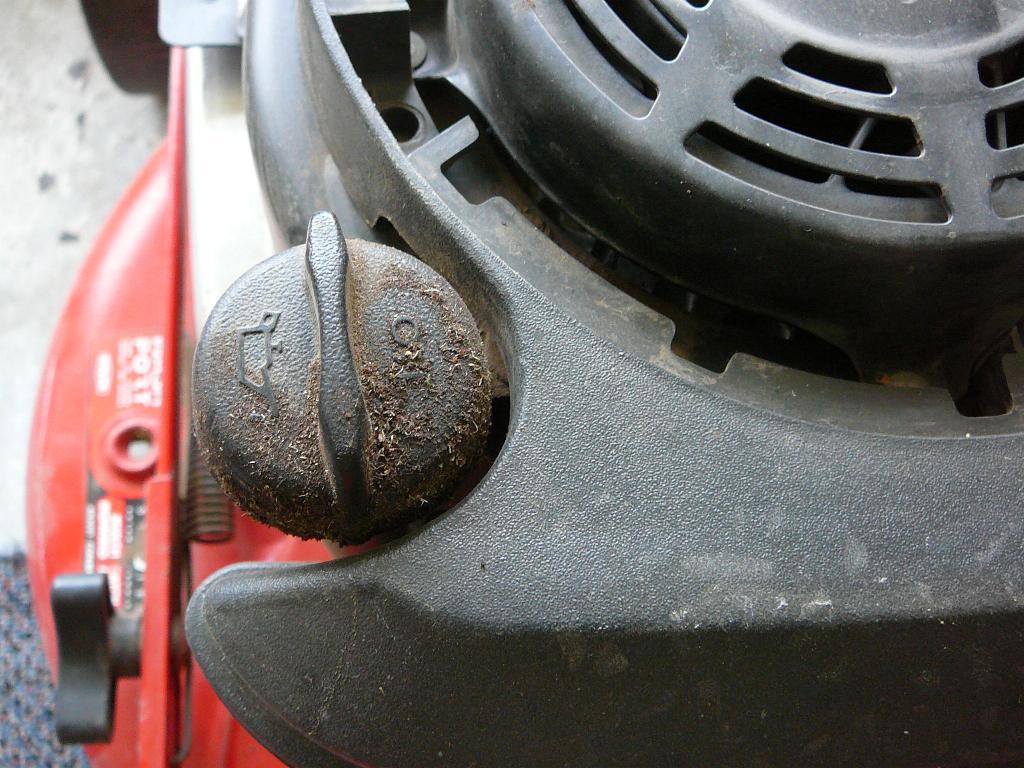

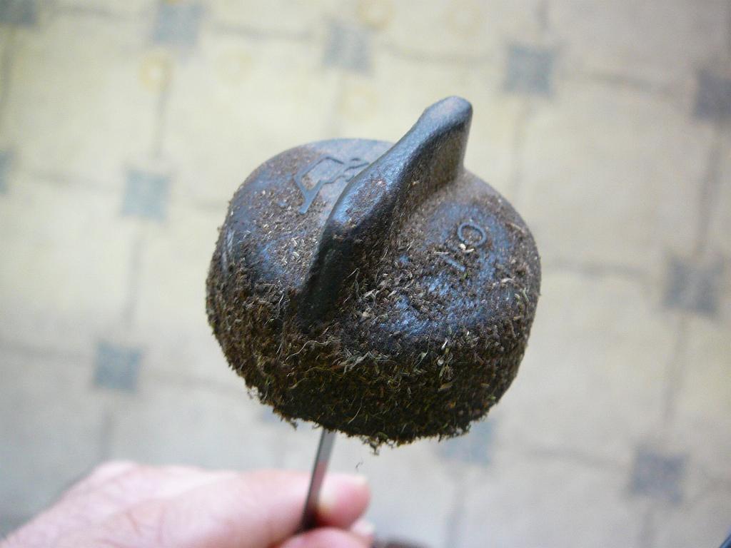

I'm gettng a peculiar little oil leak re-occurring on a Briggs & Stratton Quantum XTS50-powered Rover Mulch n' Catch that I purchased brand-new back in 2006, but which hasn't really done all that much work since, due to my preference for the lighter pushing-weight of my 2-strokes. In case it's helpful to the really clued-up Quantam'ites amongst you, the leaking motor's Identification Number is:
12F802-3179-B1 05050658
The following photos should give you some idea of the location of the leak. The motor itself has done about five hours of work since the leak was last cleaned away:
As you can see, the leak appears to be occurring primarily around the base of the Oil Filler Tube, but it is also extending forwards in a thin band along the gasket-line between the Crankcase and the Sump (but only on the Exhaust side of the motor). For some weird reason, it appears that the leak (or at least oily vapours from it) are somehow finding their way up on to the top of the Dipstick! If you have a good look at some of my photos, you can see how oily the top of the Dipstick is, yet how clean the rest of the motor's upper surfaces are. The motor's missing plastic trim-covers, by the way, were all removed (but not replaced) prior to the last time I cleaned away the leak (ie. about 5 running-hours ago). So it might be significant that the upper surfaces you see in the photos are not smeared with oil, in contrast to the top of the Dipstick...
Anyway, due to the preponderence of oil around the base of the Dipstick, the instinctive first inclination of many might be to suggest that the leak is being caused by crankcase oil seeping past the O-Ring at the base of the Oil Filler Tube when the motor is running, due to vibrations from (presumably) worn blades...
Well, I suppose the true cause could end up being something like that, but due to the fact that the blades aren't all that worn, and that the O-Ring in question (which is in a non-wearing application) is still in perfect condition, I'm therefore very interested in whether anyone has seen a similar leak in a Quantum before that was being caused by something else entirely...(?)

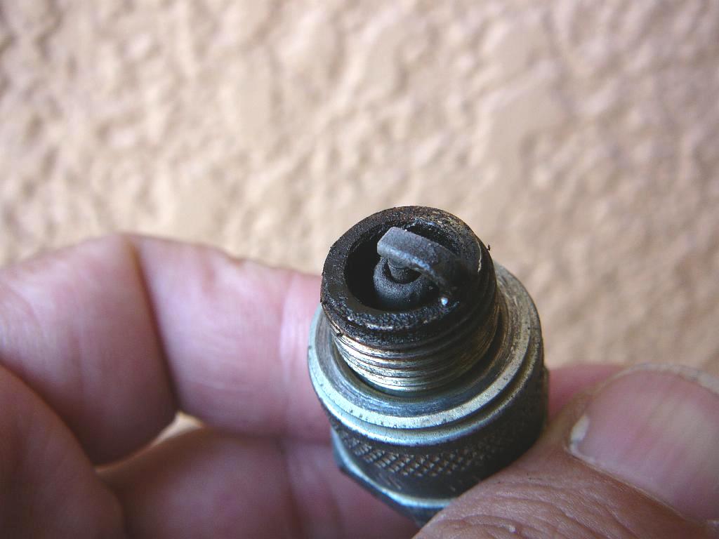

Fourthly, it would account for why the thing's Plug has been consistently dark around the cylinder-end of the threaded section, since the motor was brand-new. Have a look at this photo that I took just this arve:
This is more or less how the Plug has looked since new. The electrodes actually used to be even darker than what they appear to be in the photo, but the recent change to the thicker oil seems to have agreed with them, which would be consistent with the "blow-by" theory...

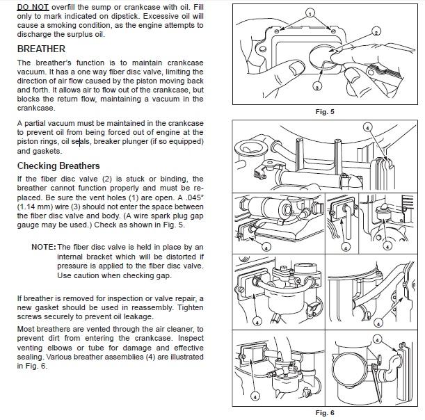

Mick, you can inspect the positive crankcase ventilation valve if you want to: it is built into the cover over the valve chest, on the side of the crankcase. You can find it by back-tracking the breather hose that goes into the carburetor. Here is the instruction on it from the Briggs manual:
If the valve is clear, and the valve chest is clean, I think you can be fairly sure it is a blowby issue.

So I opened the Valve Chest up this morning, and as you can see from the photo below, it's as clean as Kleenex in there:
As for the Breather itself, it works perfectly. I blew into the disc-valve opening, and could feel air come out of both of the small liguid return holes at the bottom, as well as the vapour outlet at the top. In order to check the Breather Passage, I then blew into the top of the Oil Filler Tube and could readily feel the air coming out of the Passage where it enters the Valve Chest. Finally, to check the Breather Tube, I removed the Air Cleaner Base, and stuck a Blow Gun into the Carburettor end of the Tube, and was able to feel air entering the Valve Chest at the other end. So the whole Crankcase-ventilation setup appears to be working fine...
Now, as regards compression, I performed the backwards-bounce test as you suggested, and the amount of bounce that resulted seemed quite exemplary. So I'm scratching my head again...(?)

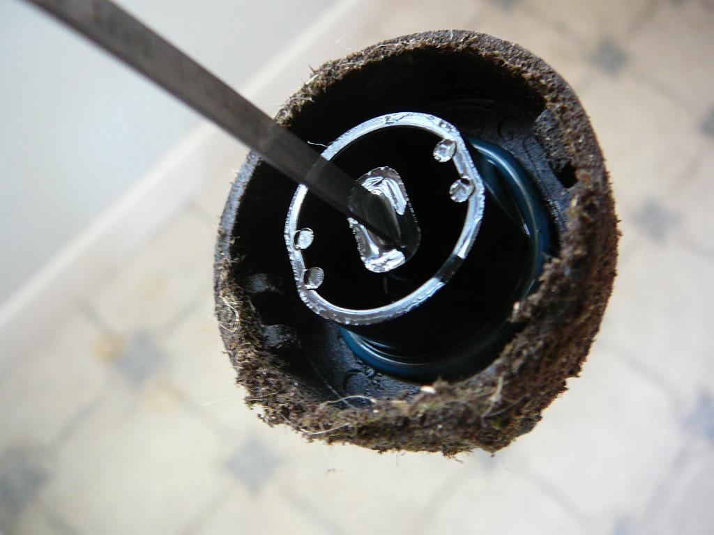

Well, I took the machine outside this afternoon, and performed that Oil-Cap-removal test you requested several times. The result each time was that the motor didn't miss a beat at any stage, nor huff and puff or chug in any way shape or form. I imagine that you will interpret that outcome as meaning that there is probably a pretty good seal being formed in the bore by the piston rings...
Just by the by, I was a little surprised by just how many small oil droplets were getting flicked up high enough to make it out of the top of the Oil Filler Tube when the motor was running with the Cap off. There was truly a steady supply of them!
I can see now from looking at the Exploded Parts Diagram for this motor that it does indeed have a dedicated Oil Slinger, but I was still surprised by the amount of spray because I was hitherto under the mistaken impression that only the I/C variants ran Slingers. In light of this, and given that it appears that the Rings and Bore are probably in good order after all, I'm swinging back to thinking that the problem could be due to liquid-form oil, after all. Or in other words - a case of poor sealing from the O-Ring (albeit still in perfect condition) at the base of the Filler Tube, as well as from the Seal under the Cap...
Mind you, that still wouldn't explain why the Plug has been running dark since the thing was new - The "oil vapour" theory works better with that issue...

Mick, the "huffing and puffing" I was asking about, was the extent of gas blowing out of the oil filler when the dipstick was absent. The engine should not run much differently with the crankcase open: on cars, the idle speed used to pick up a bit in the old days before automatic idle speed adjustment, but you'd never notice such small effects on a mower engine.
From your description, there isn't a lot of blow-by happening, since if there were, you'd see something like a thin sphere of oil mist around the open end of the filler tube. If you've ever seen a tired old car engine idling with the filler cap removed, you'll know what I mean. Of course the amount of gas expelled from the filler increases exponentially when the engine is under load. Those of us old enough to remember the "road draft tubes" running downward from car engines prior to Positive Crankcase Ventilation, and the vast cloud-banks that used to roll out from under old cars when they attempted to go uphill, will never forget the image.
It sounds as if the only issue is that there is a mismatch between your expectations, and your engine's design and manufacturing standards.
