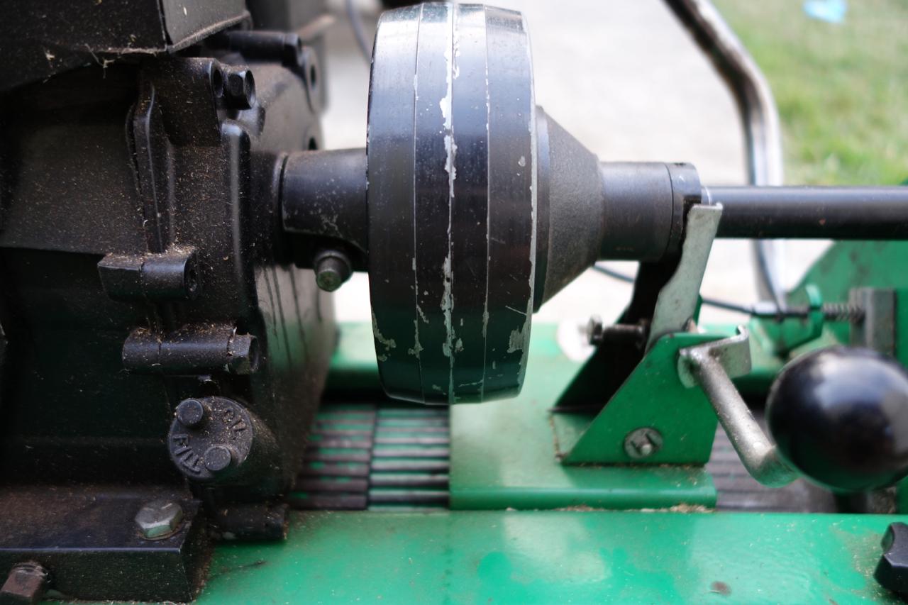

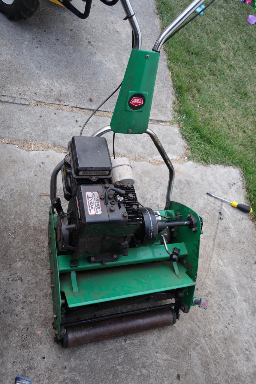

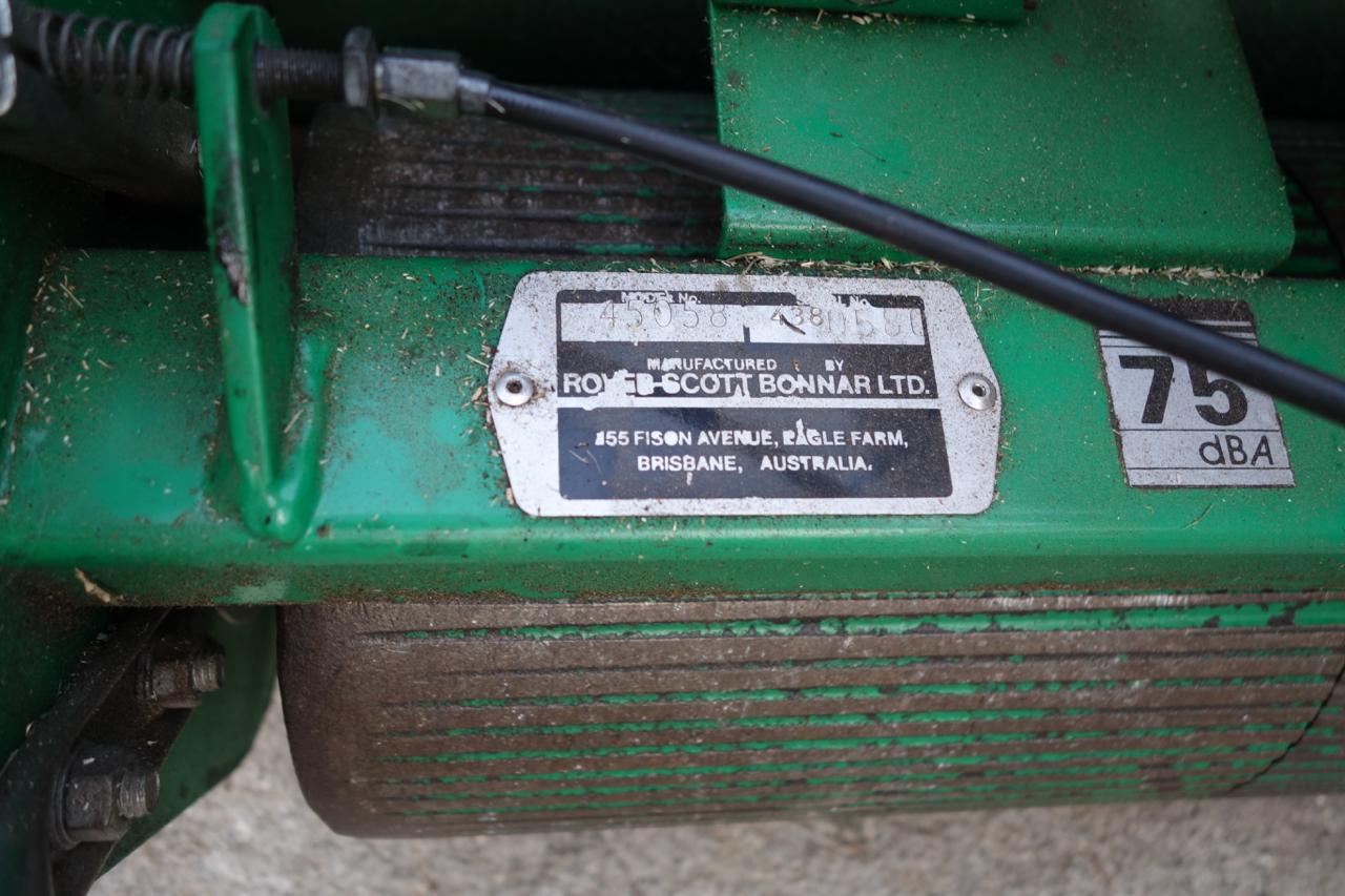

Hi Guys, thanks for the warm welcome and for the quick responses. I found a company in Cheltenham called ADE Turf that service pro greens keeper equipment including reel grinding...not sure if they are any good. Cheltenham is a bit of a hike from me so I think I will try Deejay's recommendation first and contact the local bowls club. I managed to take some snaps of my SB this afternoon so here goes... [Linked Image]
The mower has obviously had a Briggs & Stratton motor added and the old one replaced. I have the manuals for both.
ADE Turf certainly have the top-end gear for cylinder/bedknife grinding.
However, it's likely that they aren't the only firm who do, in the Melbourne metro area, so see if there's someone closer to you. You may have to balance convenience vs. price, though.
There are some 'bitsa' aspects to your SB45. For one, it has the captive cotter main clutch body, which was never OEM fitted to Rover-plated 45's.

Hi Gadge, just a gentle heads-up mate, this machine could be what we describe as an early "transitional" machine...as it wears the ID plate from Rover-Scott Bonnar...and may have employed NOS Scotty parts in its construction...We have seen that on the forum in the past. wink
Seeing that the Briggs has been replaced, without the Model, Type and Code for the original engine, we may never know the approximate date of erection of this machine. wink

I'd be pretty confident that the clutch is more than likely the last of the Alloy type captive cotter units that were used still in the early Rover days until the twin set screw unit was designed and put into production around the time of the full Rover 45 machines.
Gadge is probably in the mindset of the earlier cast iron captive cotter units that are nearly indestructible until hit with a hammer by a novice. They are the biggest gold nugget on the early SB units and I'd crawl over hot coals to gain more of them.
If you look closely at that photo you'll see that both clutch halves are alloy, which indicates it's of the later variant.

I new the motor wasn't the original...looks like it might have come with a Briggs & Stratton 60152.

(1) The cutter clutch is the one that is directly connected to the Engine PTO (Power-take -off) shaft on the right hand side, (looking from the front), painted black, round; secured by 3 screws with a nut looking at you on the inner side, ( the captive cotter-pin) when you rotate it..
This is where I believe your problem is.... wink

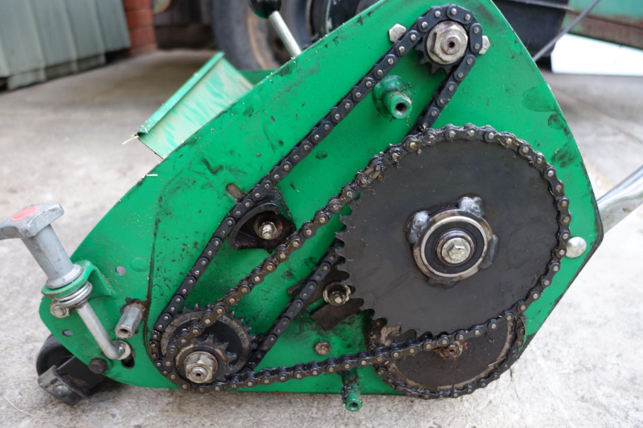

(2) The land-roll clutch, is located in the chain case, and is located in the chain-case under the removable cover on the extreme right-hand side (looking from the front) behind the largest sprocket in the bunch...this is the system that drives ( self propels) your machine across the lawn...and engages when you squeeze the left-hand lever on the left-hand handle bar. wink
As you have adjusted this...it may need re-adjustment to correctly position it back to where it was initially.
Similarly, the primary chain tension adjuster may have to be re-positioned to where it was initially....there must be 1/2" play in the center of the chain (roughly) and definitely not tight, this is the chain that runs to the cutter sprocket (the double one that connects to the cylinder reel) from the small 12 tooth (little) sprocket that connects to the engine PTO shaft.

Hi Deejay, Sorry for the delay getting back to you. We have had some atrocious 40 degree days with strong winds here so have been unable to work outside. I reset everything back to the way it was. Symptoms are...when I engage the clutch lever the SB starts to move and the cutter clutch and engine shaft start spinning (as to be expected). After a few seconds or under any load, the cutter clutch outer cones continue to spin but the inner cone stops as does the engine shaft, chain, cylinder etc. I haven't touched the cutter clutch yet but thought it might be the inner cone lining. Happy to take advice from you though before I do anything. It does look like the cutter clutch is alloy.
