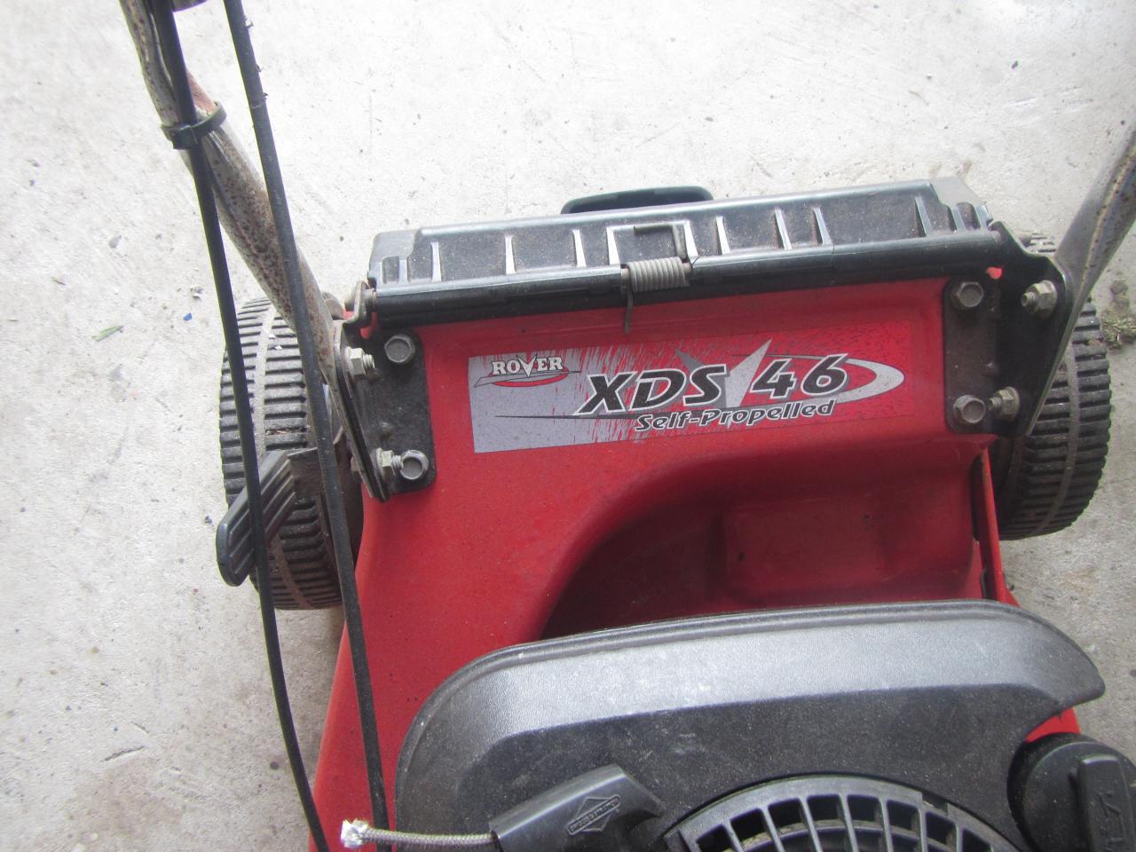

My Dad has been on the job picking me up some good mowers from his home area and he came across this self-propelled Rover which I have never worked on before. Best thing is it came with a mint catcher for $10 bucks all up so good find in my book.
After a quick carby clean and air filter replacement the mower actually runs quiet well however I suspect in will need the valves lapped and ground because once the engine warms up you get a light miss through the exhaust � I will check the clearances in the morning but I suspect it will need a valve job which is pretty simple. I am not concerned about this problem.

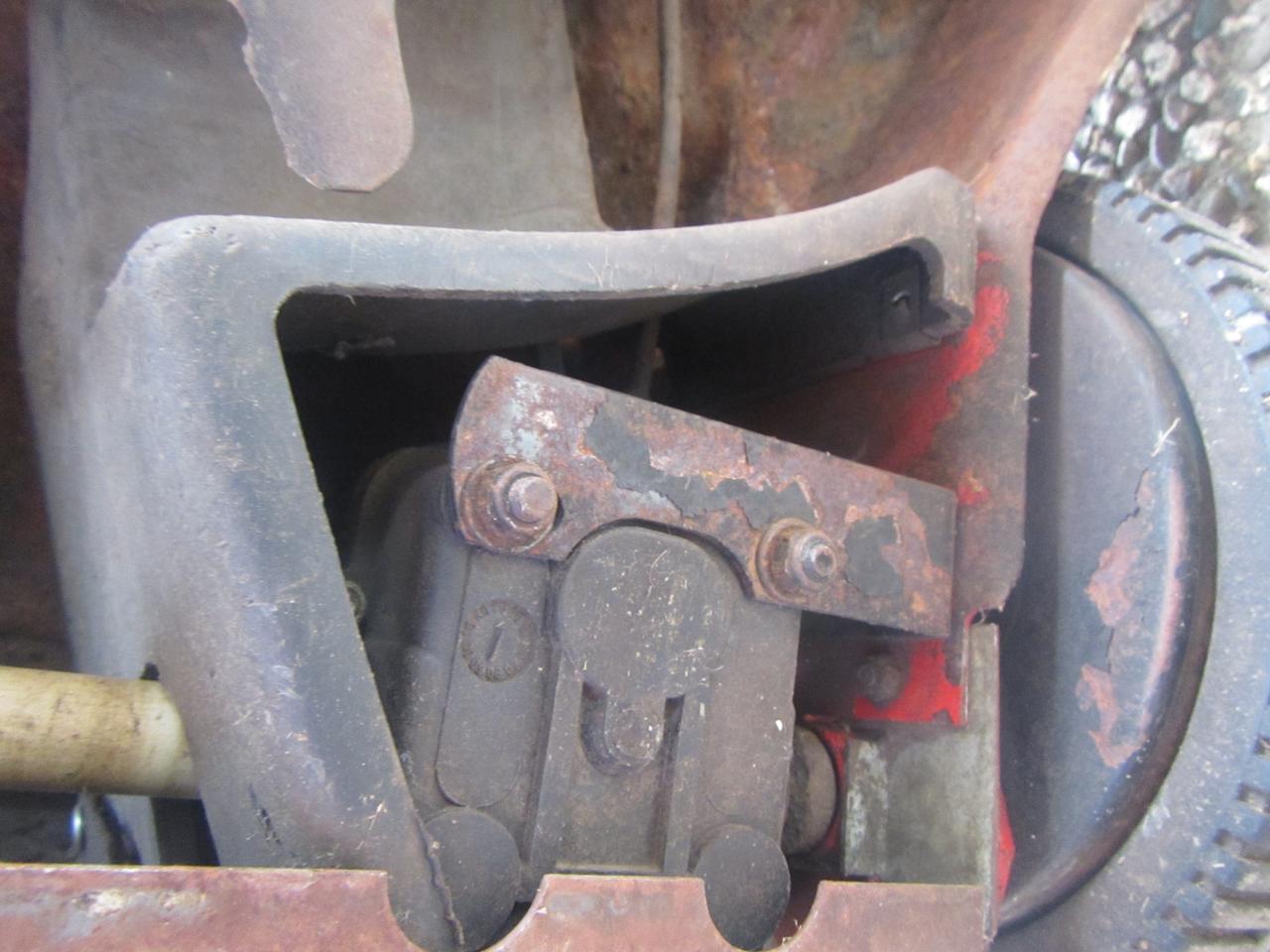

Now to the self-propelled function � All Dad and I actually did is clean out the area which surrounds the belt which included sticks, dirt and just about anything else you can imagine. The self-propelled now works really well. It�s actually a struggle to keep up with the mower once it is going.
My question surrounds how I properly service the self-propelled function to ensure longevity. I have tried to find other threads but the forum is pretty light on from what I can find.
Before I bring the mower back home I�d like to understand more about the self-propelled function and understand the servicing requirements.

Hi Peter, couldn't find much on that particular model but I believe the self propelled mechanism doesn't need servicing except for belt tension. The rear wheels are held on with metal single use clips that I push on with a socket. I guess you will see them when you pop the hubcap off.
I've never pulled the rear wheels off my Procut 560 because it rarely gets used but the John Deere I had used to come apart every 6 months for a clean and regrease with a light/minimal grease application to minimise dirt sticking.

Codes are as follows 12F802 1975-B1 03101757
Well after a good service and clean of the self propelled area the engine is running really well. The valve clearances where within the required tollerances so I didnt need to grind the ends as suspected earlier - I just decoked the head and cleaned it up.

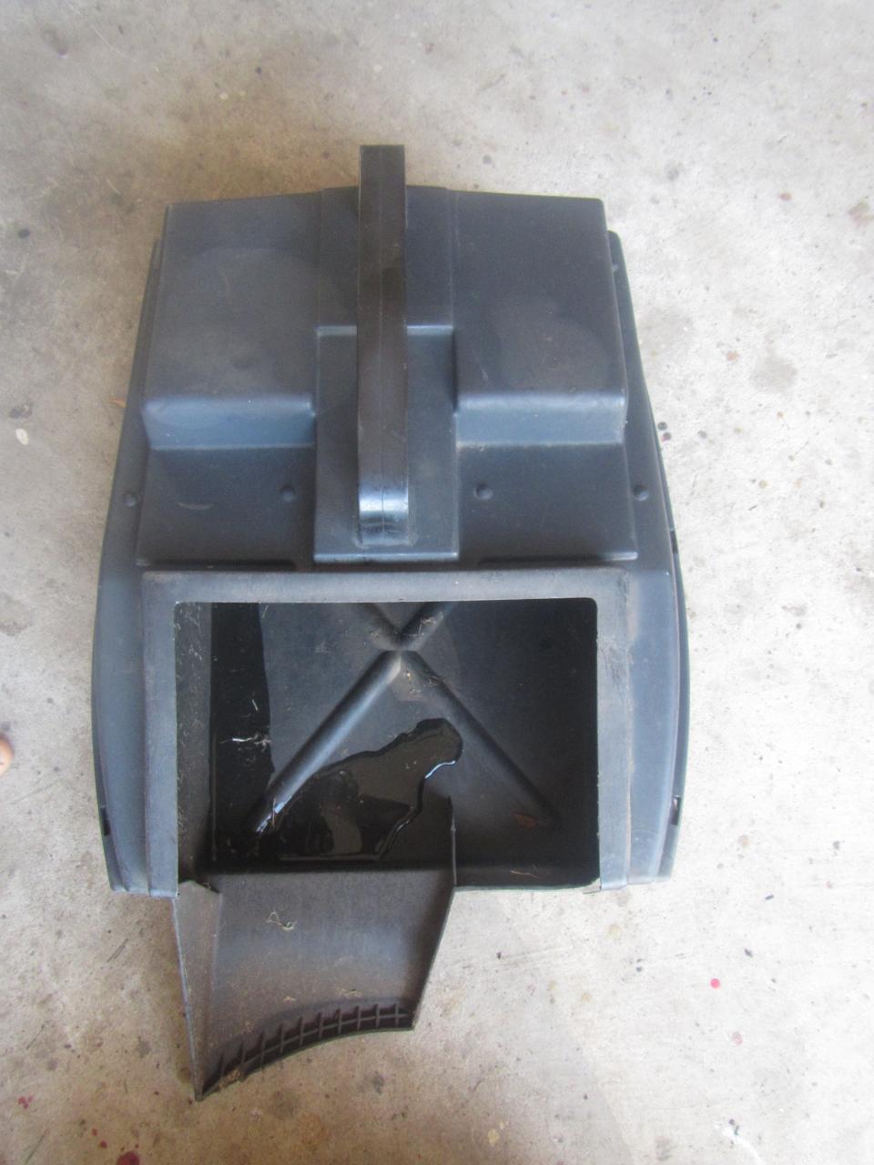

I gave it a good run through some pretty thick grass and it performed really well. I have included a few extra photo's of the finished product including the unique catcher just incase anyone cant find one.
I am pretty sure this engine only got thrown out because the belt came off. Well I am pretty sure the old belt had snapped because the belt I found it with was brand new. I suspect the previous owner bought the belt and couldnt fit it correctly.
