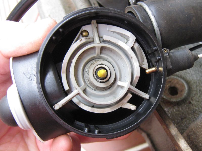

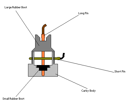

Are the kill wires installed correctly?
Even with the wires inserted correctly, sometimes I find this issue can occur where both wires have the 'Short' metal tip, as opposed to one having the long one with the recess.
The long one goes vertically, through the boot, and into the carby, and if the short one is all you have, I would swap it out.
Here is the set up you are going for:
The cut out set up also stops the slide returning to the point at which the cable detaches for servicing, as seen here:

Mr Davis the kill wires shouldnt affect the thing popping out should it? I mean I basically can't close the throttle enough to make contact with the kill wires before it pings out. My cam also looks different to,yours , yours has a ramp for the kill wire to move along before hitting the stop. Is yours an LM carb.
Also your poppet valve is yellow, what is going on?

if you hear it every time it pops out them its already bent too much , the cam should have the 'ramp' on it as it contacts the kill wires before the cable pops out .
clip on the air intake hold the outer cable in place , so if all is good there then maybe its bent from an old owner ?
staighten it first then see how it goes
If it's happening mid way, then the wires are not the issue, however if it's popping out when moving towards stop when almost there, then it could be.
I sometimes find some cables a little hard to seat, to work around this I tend to attach tricky cables during carby assemply, passing the cable though the intake, and pulling it through enough to be able to then use pliers to push the ball into the rotor hole till it clicks in, then fitting the rotor and setting the cable sheith end in place.
I personally have not tried bending the cable, if the problempersists at this point, i find a new rotor, but it is an option if no spare rotors are about.
The ramp is indeed LM (this is a google pic) but aside from that it's the same, it was simply added to prevent stopping problems, and increase cable hold, the wall at the end of the ramp is still there on the early models, and it's contact with the pins has the same effect, when the pins are removed, this wall can move further, which is how the cable is supposed to be released.
