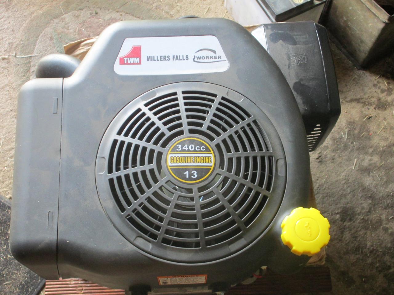

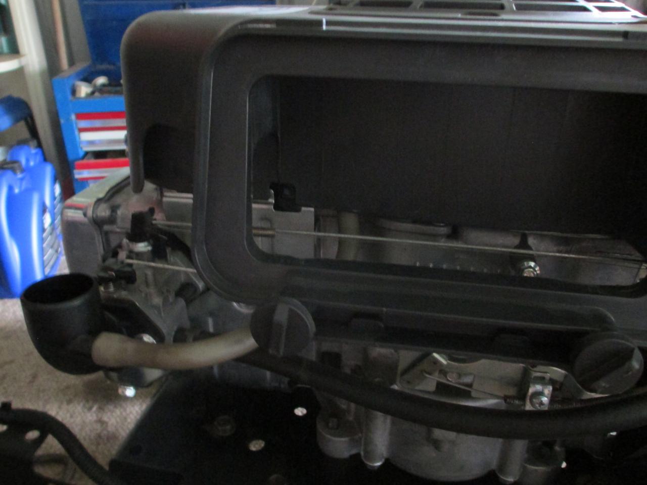

Hi have put a Millers Falls 13hp engine onto a spare ride-on i am doing up. Was given thge motor, never even heard of them before. Problem, engine will idle and rev out to full throttle without air filter attached, as soon as i attach airfilter the governor will go off, as in rev out fully back to idle back to rev out fully. Have had to reset valves, which i have checked a couple of times still all good, carby/ fuel tank/ hoses are clean and free of dirt and a new spark plug and new airfilter. First photo is engine before fitment. Photo 2 is how the engine wants to run , nice and smooth. Photo 3 & 4 is when engine will start to play up quiet hard. ![[Linked Image]](https://www.outdoorking-forum.com.au/forum/uploads/usergals/2014/12/full-6941-19134-img_0533.jpg) ![[Linked Image]](https://www.outdoorking-forum.com.au/forum/uploads/usergals/2014/12/full-6941-19135-img_0618.jpg) ![[Linked Image]](https://www.outdoorking-forum.com.au/forum/uploads/usergals/2014/12/full-6941-19136-img_0619.jpg) ![[Linked Image]](https://www.outdoorking-forum.com.au/forum/uploads/usergals/2014/12/full-6941-19137-img_0620.jpg) Wondering if anyone can answer why or has had this problem before. Any help or advice appriciated. Thanks Paul.
Posts: 6,926 Likes: 10
From the pictures I'm guessing that is a chonda copy of the GXV390. I haven't worked on one. Remember, with chondas the bits that play up are the external bits that aren't accurate copies of the Honda parts: the governor plate, muffler, air cleaner, starter, top cover/fuel tank, etc. Hence I think you are likely to be correct in focusing on the air cleaner, or even more likely, the air cleaner fouling on the governor plate or linkage.
If it will run perfectly without the air cleaner, but plays up when you put it on, the air cleaner is causing the problem. I'm not clear on whether it runs properly with the air cleaner shell in place, but no filter element installed. If it still plays up under those conditions, and in view of your description of the problem, it sounds like mechanical interference between the air cleaner housing and the governor mechanism. Some part of the housing may be rubbing fairly hard against the linkage.

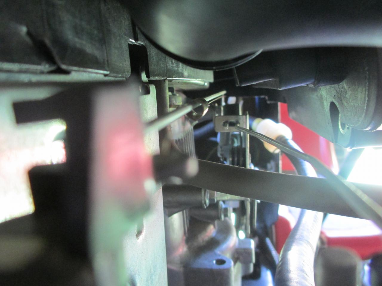

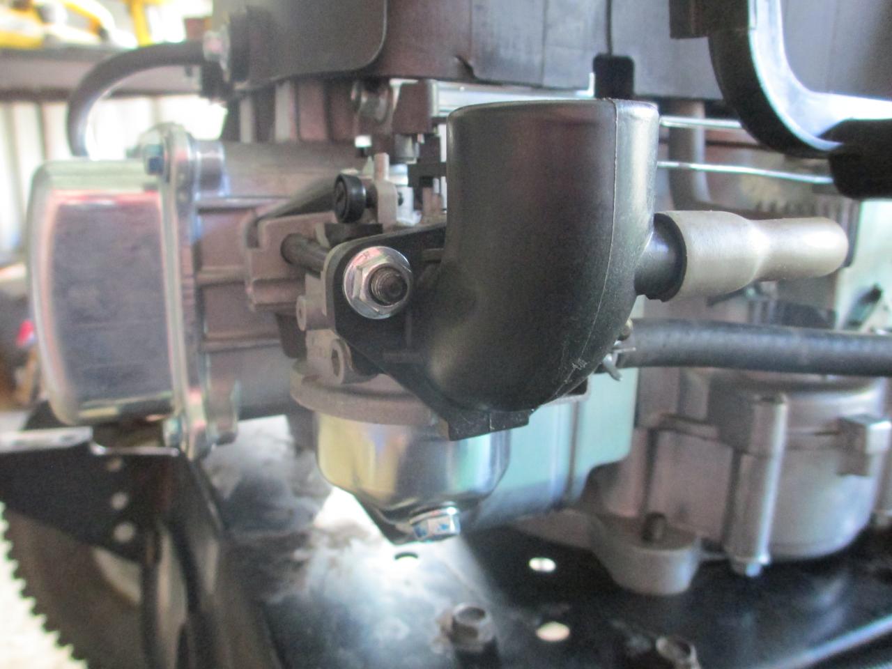

Please post pictures of the governor arm and governor link, Paul.
Joined: Jun 2013
Posts: 173

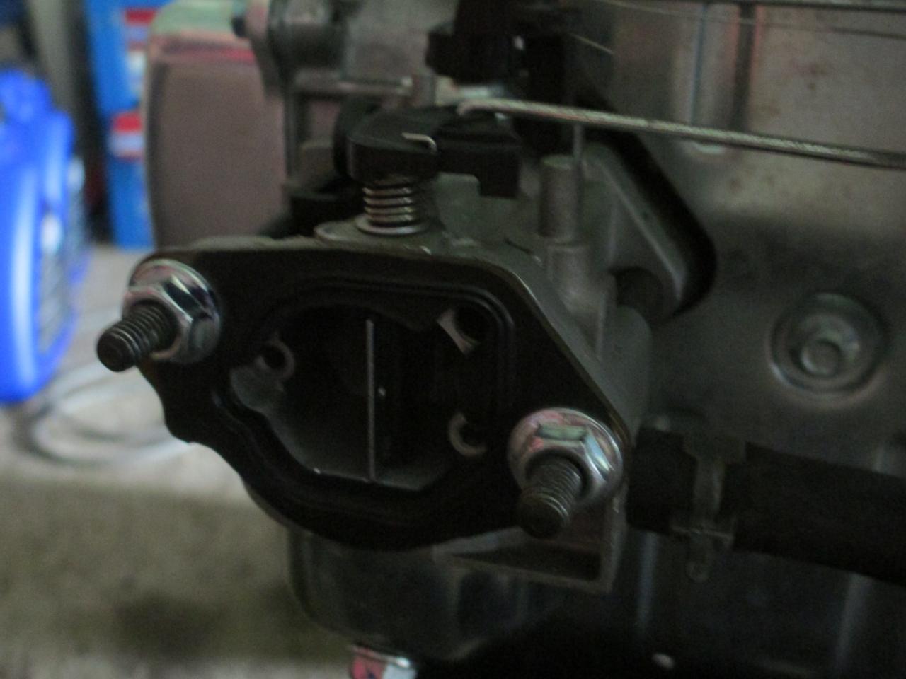

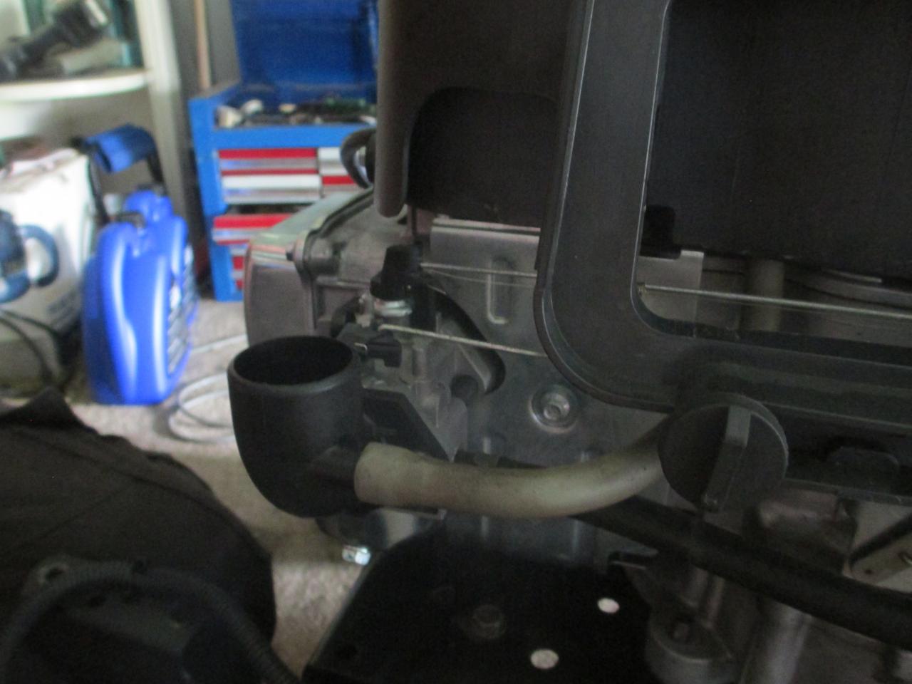

Hi Grumpy, have a photo, its not the best, with the air filter inner shell and air hose attached. There is about 1" of space between governor arm/linkage and airfilter casing and about 3/4" space between motor and governorarm/ linkage. Have done some thourough looking around all parts that are near governor arm/linkage but there is nothing close enough for it to rub on or for something to rub on it. Have even double ckecked the governor setting but no problems there. In my second photo, above, having no hose or airfilter attached is the only time it will run without stuffing around, as soon as i attach the hose, with or without airfilter, it will stuff around. Will take top off tomorrow when i get another 5 mins and get some more photos. ![[Linked Image]](https://www.outdoorking-forum.com.au/forum/uploads/usergals/2014/12/full-6941-19143-img_0621.jpg)
We should check some other obvious things if it isn't the most obvious one (friction in the governor linkage). Can you try choking it to see if that stabilises it? If it overcomes the problem, obviously it is lean mixture, and we can go from there.

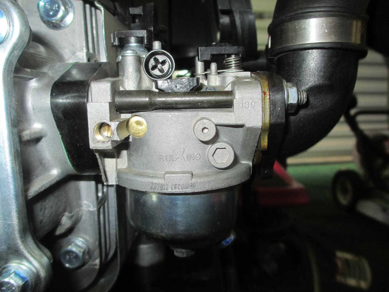

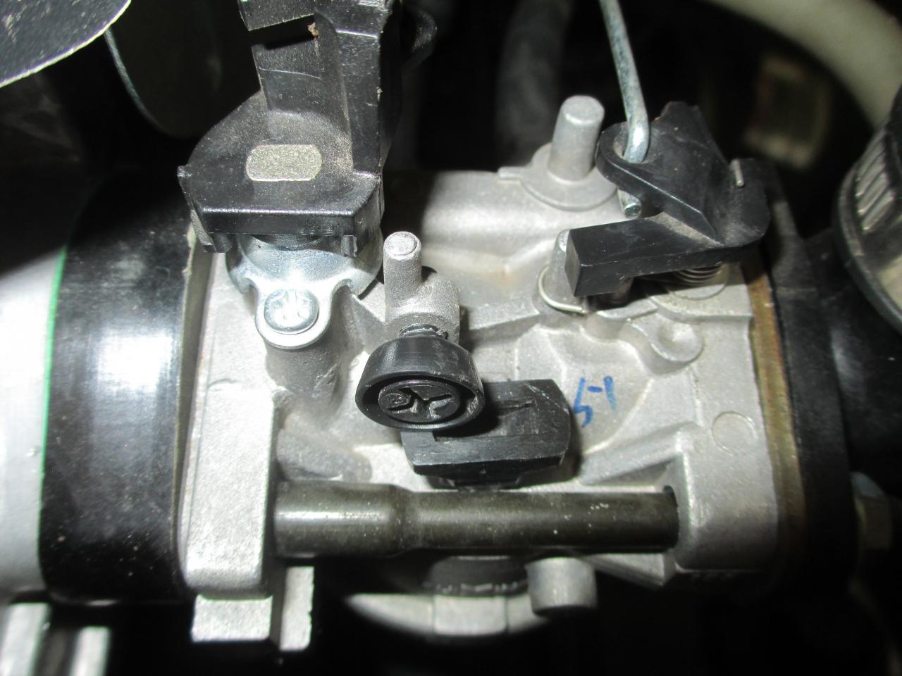

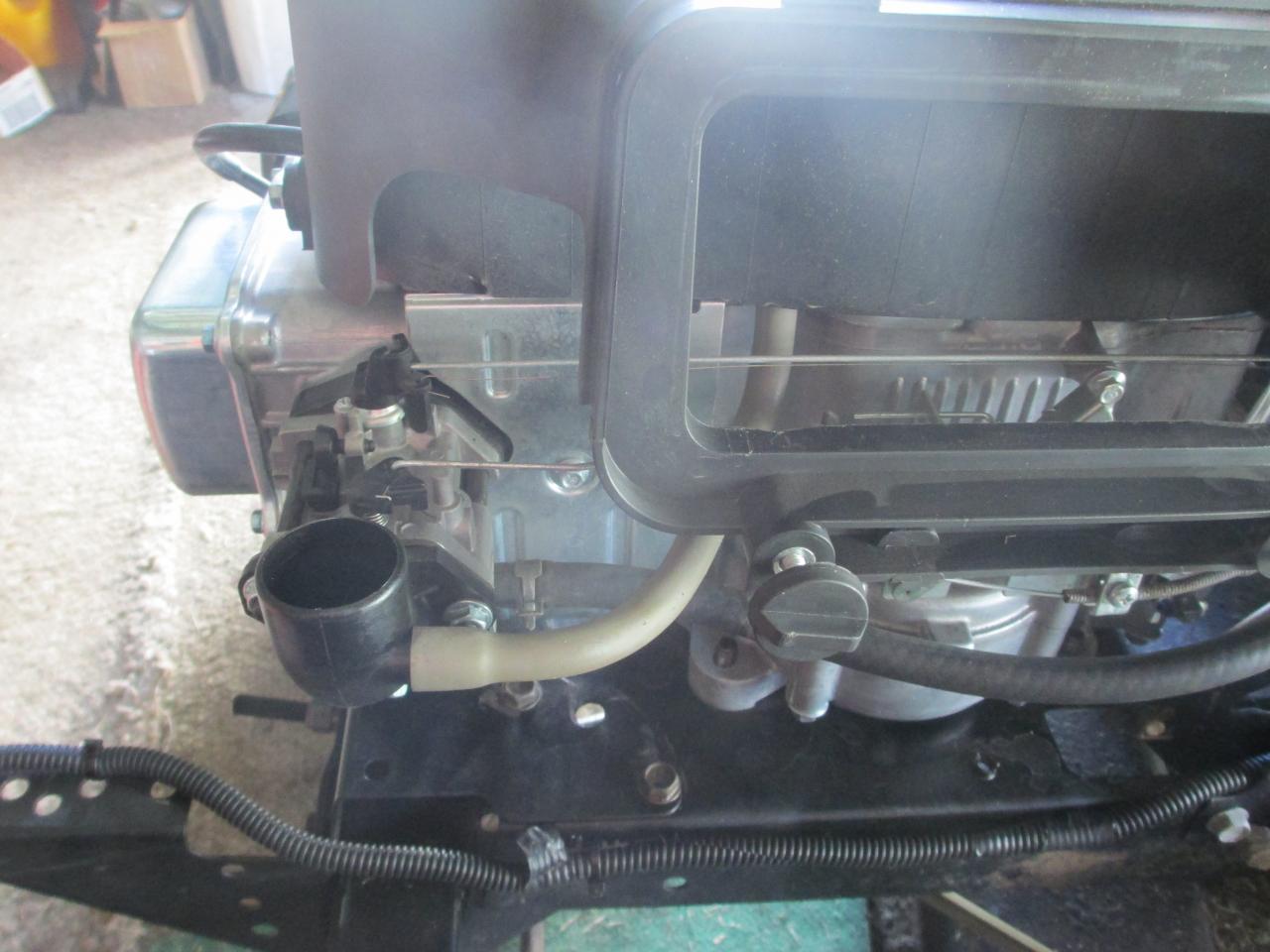

Hi Grumpy, have done as you suggested. Started engine without air filter/hose attached ran smoothly as we know, attached hose and airfilter, started stuffing around so i slowly started closing the choke. I was able to close choke half way before the engine started to run smoothly. The first photo is of carby and i will let you know what i did. ![[Linked Image]](https://www.outdoorking-forum.com.au/forum/uploads/usergals/2014/12/full-6941-19145-img_0627.jpg) There was a little metal cap if front of mixture screw so i carefully drilled it out. Did try adjusting screw to different settings, 1&1/2 turns, 2&1/4 turns but made no difference were i put it. At the moment it is out 3/4 of a turn, that is were it originally was. The next photo shows the governor linkage on carby , underneath it is a small metal base that is screwed on, would it be worth taking it off to see what is under it, as there are no springs under governor linkage as there are with other mowers, wondering if there might be one under it. Let me know what you think. ![[Linked Image]](https://www.outdoorking-forum.com.au/forum/uploads/usergals/2014/12/full-6941-19146-img_0626.jpg)
I believe you have been adjusting the idle air bleed, Paul. It is in series with the idle jet, and is strictly a very fine tuning adjustment of the idle mixture. In other words, it does not seem relevant to your current problem.

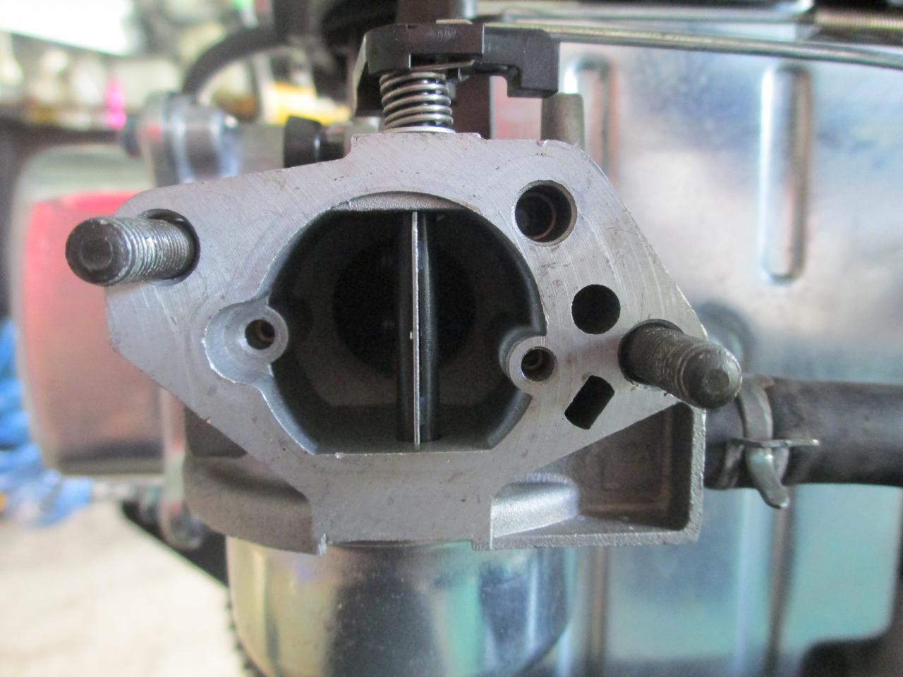

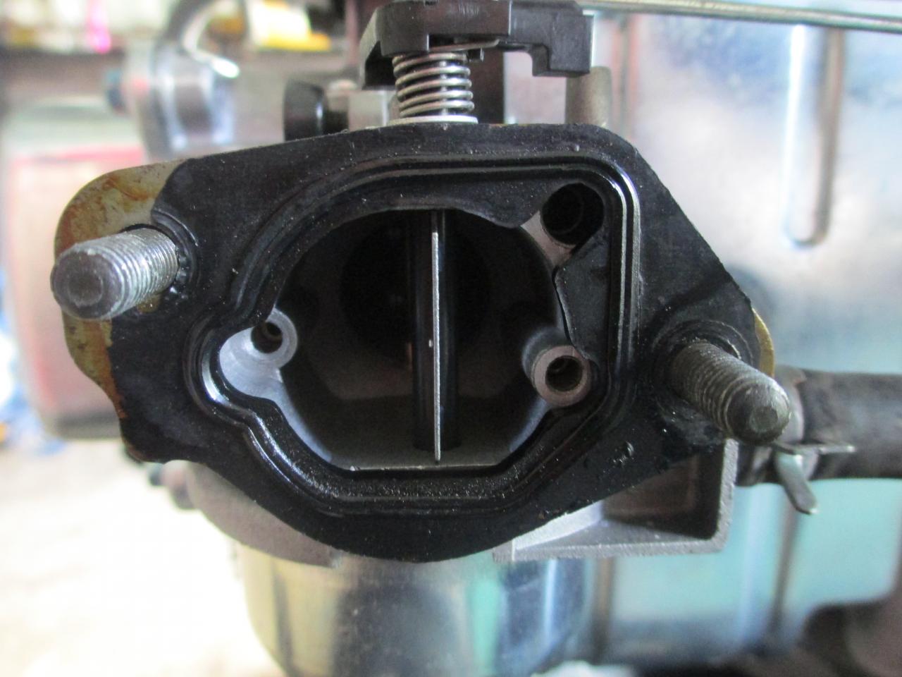

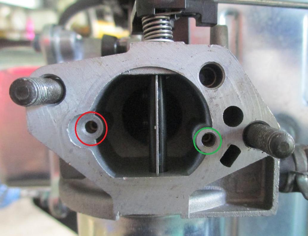

Can you post a picture of the carburetor flange where the air cleaner mounts on it, and the matching gaskets and insulator please Paul? Remember, the air cleaner side of the carburetor, not the cylinder head side.
I'll tell you where I think this may be heading. On many of the Keihin carburetors Honda uses, and the Ruixing and other copies of them used on chondas, the float bowl vent runs to the air cleaner through a port in that flange. If you put the gasket or insulator on backwards, you block the float bowl vent, and probably get a result something like what is happening.
Joined: Jun 2013
Posts: 173
Well, I don't think you could put the insulator or gasket on upside down without it being very obvious. I don't understand the part about there being a flat part next to the bolt hole.
It seems to me that the next step is to lay each of the other parts (gasket and insulator) on the carburetor flange, and see if the three holes in the flange are unobstructed. You might also try clamping those two bits to the flange and verifying that the engine runs properly. Then we'll know it is the elbow that is at fault. I'm conscious that one of the moulded recesses in the elbow is very much smaller than the corresponding recesses in the gasket and insulator, and I think it won't reach across the matching hole in the carburetor. Does it actually block the hole? That may depend on how it fits over the gasket and insulator.
If it runs well with gasket and insulator clamped in place, the next step would be looking at the gasket and insulator placed over the flange on the elbow, to see how they match up.

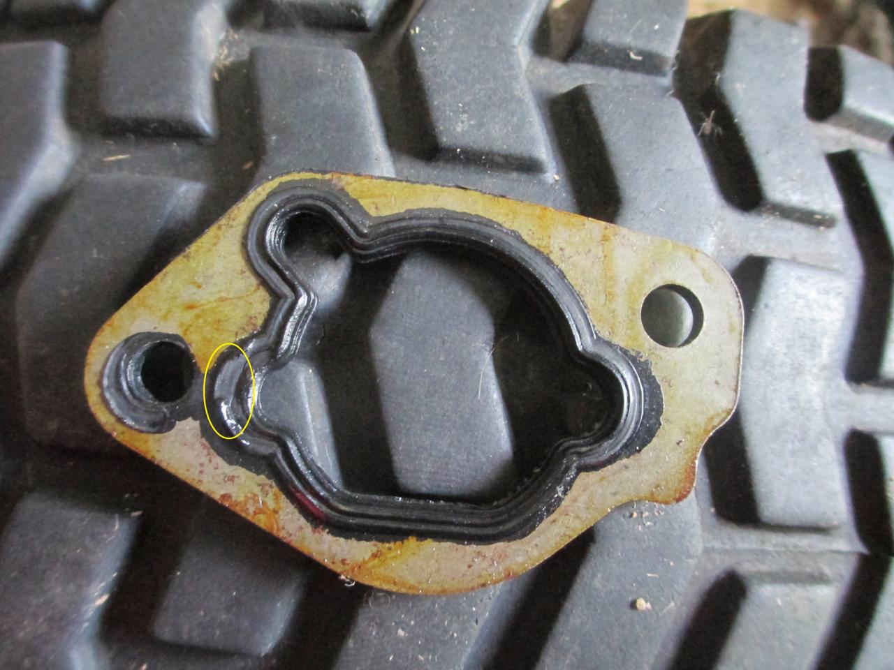

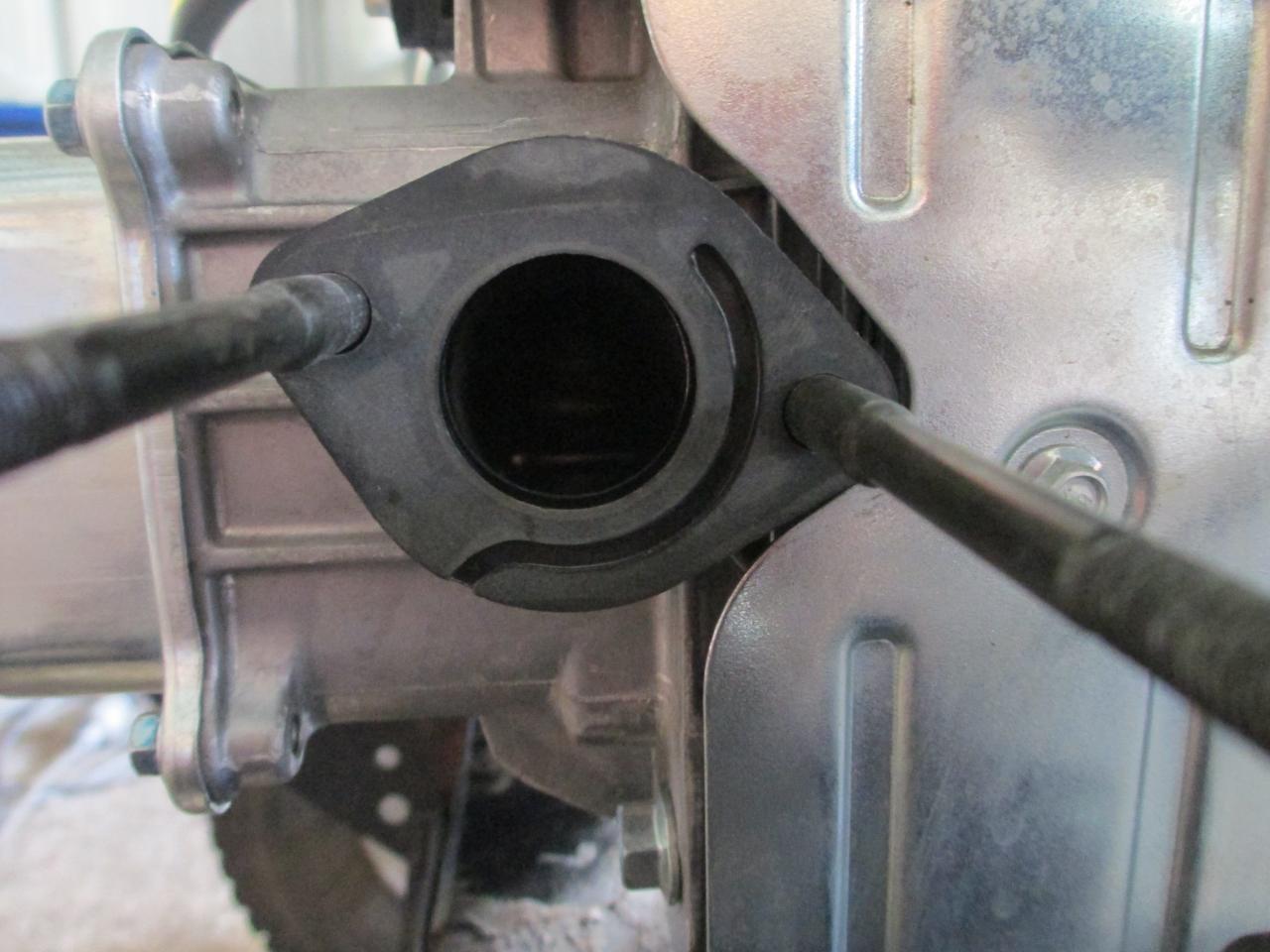

Hi Grumpy, have worked out how to put circles and such onto photos. Sent the photo of gasket/insulator and put a circle around the flat part. This side sits against carby and unsure if it makes any difference. ![[Linked Image]](https://www.outdoorking-forum.com.au/forum/uploads/usergals/2014/12/full-6941-19180-img_0633.jpg) Have proceeded as you suggested and all holes between carby,gasket/insulator and flange on elbow do actually line up. Have found this though. ![[Linked Image]](https://www.outdoorking-forum.com.au/forum/uploads/usergals/2014/12/full-6941-19181-img_0639.jpg) Even with the gasket sitting against the elbow you are still able to see a tiny bit of sunlight through the two. I am thinking once attached to carby, because the bolt holes are on the edge, it may not be not sealing properly as all pressure is twisting elbow flange into a slight arc as to say. Hope i have explained this easy enough to read and understand.
I can see that the elbow flange is bowed, Paul. It may be leaking dirty air into your carburetor, and should be fixed in due course, but that is not the immediate problem. ![[Linked Image]](https://www.outdoorking-forum.com.au/forum/uploads/usergals/2014/12/full-2772-19182-honda_gxv390_carburetor_flange.jpg) I've copied your picture of the carburetor flange. The red circle is around the idle air bleed. I think you've said it idles properly even when the elbow is in place, and if so, this hole is not being blocked. The green circle is around what seems to be another air bleed: it connects to the inside of the carburetor but only passes air slowly. If that one is nearly blocked, but allowing a bit of air in each time suction builds up, it could cause your problem. That is the cut-out that you put the yellow oval around in the picture of the insulator. Note that the moulded-on rubber on that metal insulator will be crushed when you install it, and it may be squeezed into that recess. Can you try running it with the insulator and gasket omitted, so the elbow bolts directly onto the carburetor?

Hi Grumpy, lead you astray abit, the flattened bit rubber on the insulator actualy sits to the outside of the hole so there is no problems with it. Have ran the mower with only the elbow attached and it was worse, now jumping at both idle and full revs. Tried just the gasket/insulator, had same problem...until i put my finger over the idle air bleed (red circle). Smoothed it out and ran perfeclty at both idle and full rev. Did cover over the other air bleed ( green circle ) made no difference. Would it be worth attaching all peices again and trying to adjust the idle air bleed screw or will i be making it worse, or worse yet more fustrated. Or would you advise taking carby apart for another thorough clean and inspection.
I'm a bit mystified at present Paul. In an earlier post, you said it will run perfectly without the elbow or insulator. Now you said it won't run with the insulator unless you block the idle air bleed. Can you verify that it will run without anything at all on the intake flange of the carburetor, but it won't run with the insulator on unless you block the idle air bleed?
If you find it won't run either with or without the insulator unless you block the idle air bleed, that will make sense, but at this point I don't see how putting on the insulator alone, can mess it up in such a way that you have to block the idle air bleed.

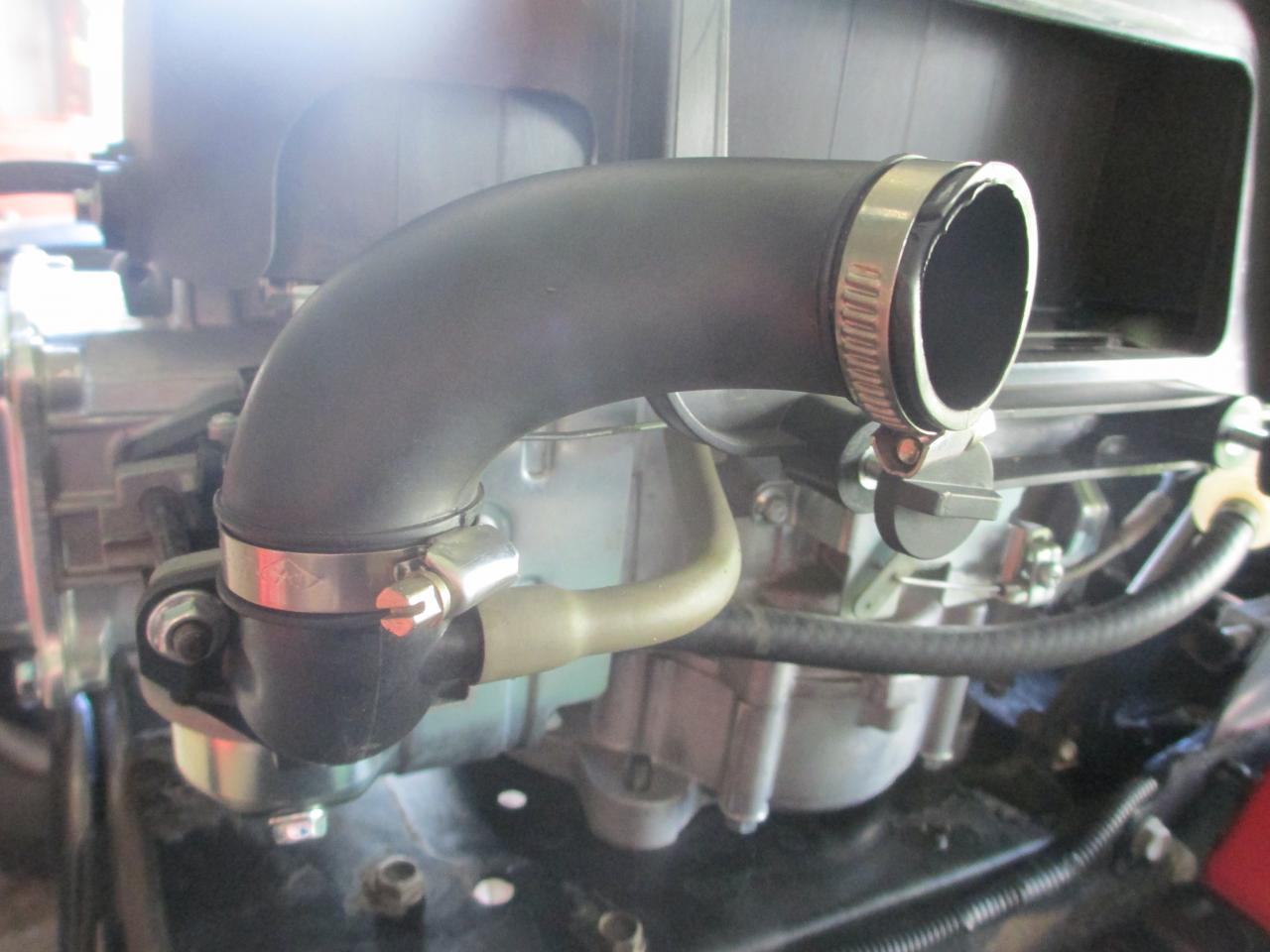

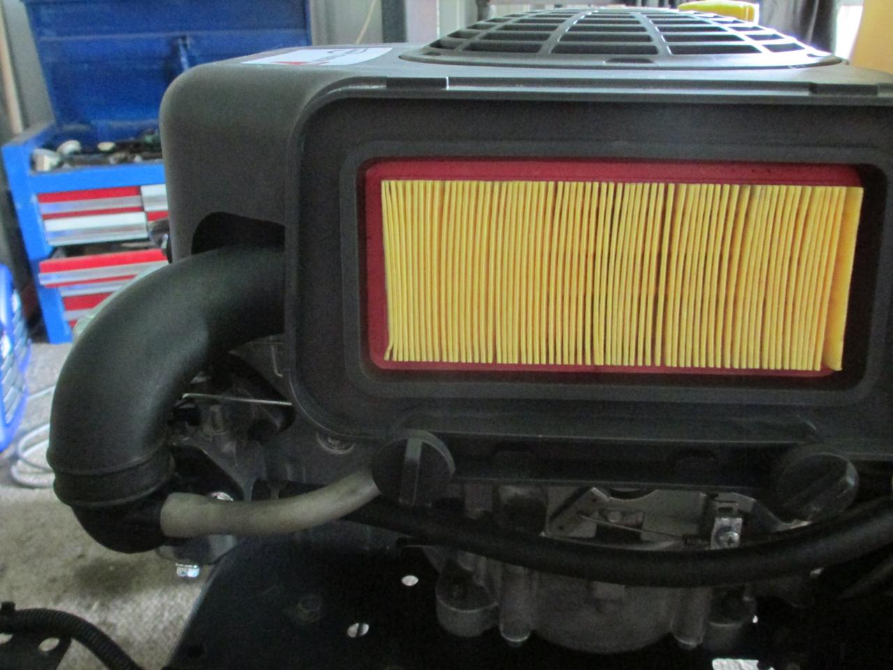

Hi Grumpy, no doubt i have confused everyone involved, this is how i feel everyday ( sorry readers ). Let me start again. Photo 1 all attachments on carby: runs but revs high then low etc. ![[Linked Image]](https://www.outdoorking-forum.com.au/forum/uploads/usergals/2014/12/full-6941-19186-img_0643.jpg) Photo 2 elbow and gasket/insulator attached, no hose or airfilter, runs as above. ![[Linked Image]](https://www.outdoorking-forum.com.au/forum/uploads/usergals/2014/12/full-6941-19187-img_0644.jpg) Photo 3 elbow only, no gasket/insulator, runs as above. ![[Linked Image]](https://www.outdoorking-forum.com.au/forum/uploads/usergals/2014/12/full-6941-19188-img_0645.jpg) Photo 4 gasket/insulator only, runs as above. ![[Linked Image]](https://www.outdoorking-forum.com.au/forum/uploads/usergals/2014/12/full-6941-19189-img_0647.jpg) And with nothing on the carby it will run the same as above.. I think i have forgotten to mention that if i pull the choke approx half way closed while running the motor it will smooth out and run properly, or as i just found out blocking the idle air bleed. Sorry Grumpy, hope this get us up to speed.
It seems straightforward now, Paul. I went off in a different direction in the belief that it worked properly without the entire air cleaner apparatus, but badly if any part of the air cleaner were fitted. However if it runs badly regardless of the air cleaner fitment, and gets better when you partly close the choke or cut off the air bleed, we are down to two main suspects, both of them pretty routine, in happening and in repairing. It sounds as if it either has a leaky carburetor insulator gasket (they often split when the carburetor is removed, and will not work properly thereafter) or an obstruction or misassembly in the carburetor. I suggest you begin by removing the carburetor and inspecting both insulator gaskets (there is one on each side of the plastic insulator). If they are perfect, you need to look primarily at the main jet and the emulsifier. All these things are very easy to put right.

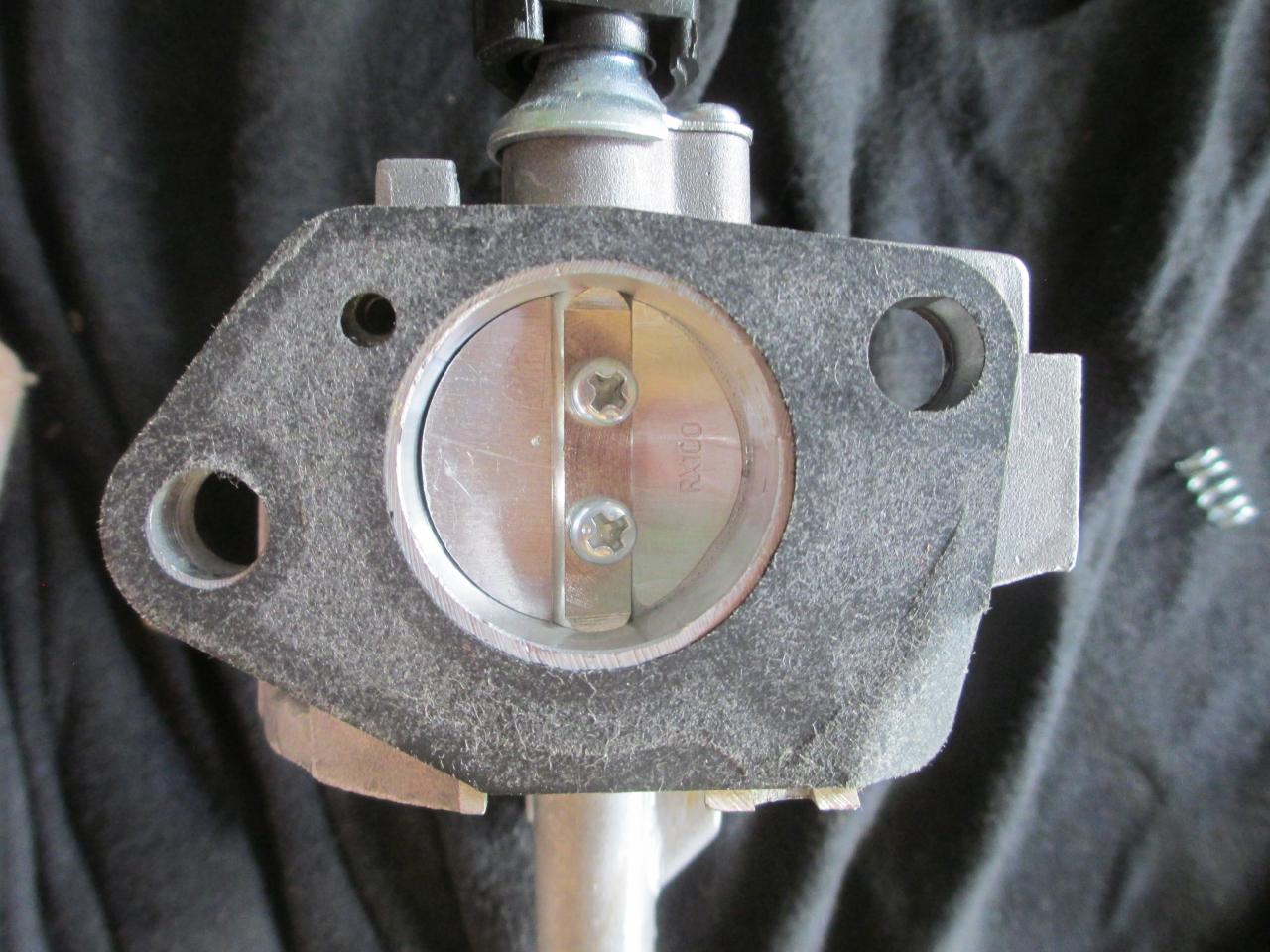

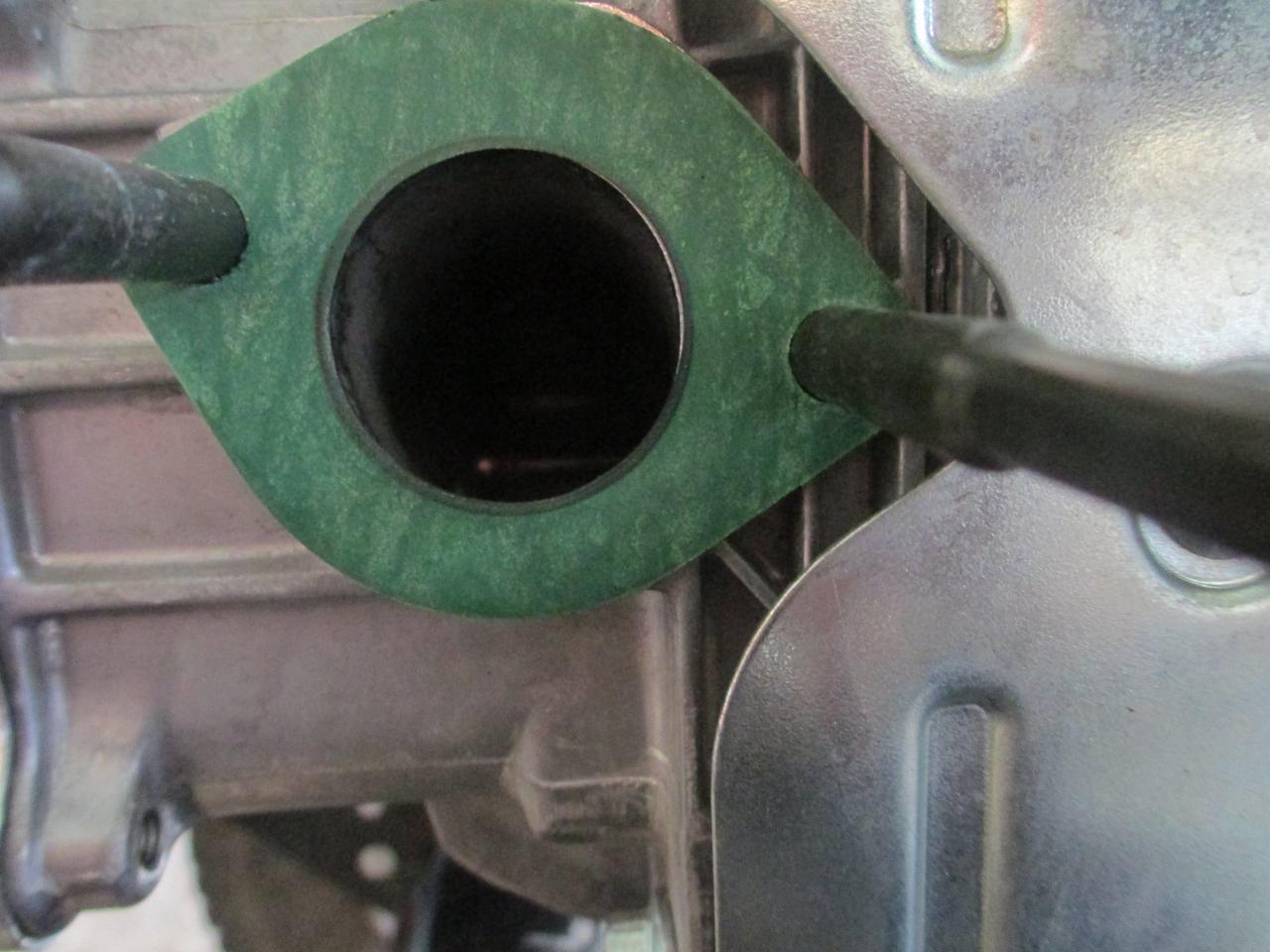

Hi Grumpy, have had a look at both gaskets and plastic insulator, they are all in good condition. Have some photos of them ![[Linked Image]](https://www.outdoorking-forum.com.au/forum/uploads/usergals/2014/12/full-6941-19192-img_0650.jpg) ![[Linked Image]](https://www.outdoorking-forum.com.au/forum/uploads/usergals/2014/12/full-6941-19193-img_0649.jpg) ![[Linked Image]](https://www.outdoorking-forum.com.au/forum/uploads/usergals/2014/12/full-6941-19194-img_0648.jpg) Have also stripped down and cleaned the carby again, not that it was needed, i blew it all out with air compressor and followed it with carby cleaner for a just incase. Photo of carby parts. ![[Linked Image]](https://www.outdoorking-forum.com.au/forum/uploads/usergals/2014/12/full-6941-19195-img_0651.jpg) Now all back together, will wait for a reply before i go any further incase i have missed something.
The green gasket looks good - not so sure about the grey one. The insulator looks good, but be sure you put it on the right way around so that the groove in it matches the port in the carburetor flange.

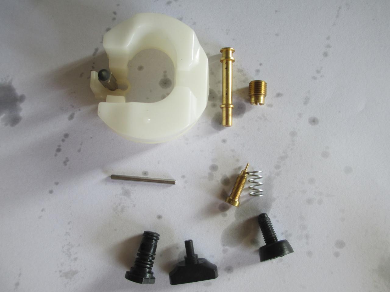

Most people who get poor results from cleaning those carburetors make one of three simple mistakes: 1. They don't use carburetor cleaner on the main jet because they think it looks clean. Blow carburetor cleaner cleaner under pressure though the jet: it is often reduced in size by gum. 2. They aren't nearly careful enough cleaning the emulsifier. Don't just blow carb cleaner through the central orifice: put a finger over the hole in the far end and make that carb cleaner squirt out under pressure from every one of the lateral holes. If any of them doesn't squirt or looks a bit less strong than the others, put a jet drill through the hole backwards, or use a piece of copper wire and a lot of care. 3. They don't clean the idle jet properly. The hole in it is tiny, only 0.014". If carb cleaner doesn't come out of the tiny hole strongly when you put a finger over one end of the lateral hole and squirt the cleaner in through the other end, you need to use a jet drill (usually 0.33 mm, but you use the 0.3 mm one that comes in the set). Note that in your case the symptoms don't match an obstructed idle jet, so it isn't a big issue, but it's never too early to develop good habits.
Joined: Jun 2013
Posts: 173
Hi Grumpy, the way you have explained cleaning a carby is the way i do it, in one of my first post you talked me through it that way and done it that way ever since. But just to make sure did strip carby down and fully cleaned it again. Did make a new gasket for side of carby, grey one, there was a tiny split in it were the air port is, other "split " was just a mark. Sad to report there is no change at all. Thinking out loud here, could it just be a sh#t carby.

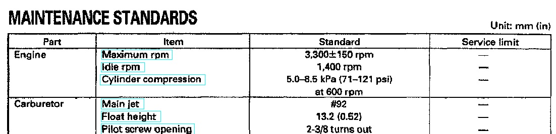

There are still things to look at, Paul. Have you checked the fuel flow rate from the needle-and-seat with the float bowl plug removed? That checks the whole system upstream of the needle-and-seat. It should continue to flow a good stream, steadily: run the test for at least half a minute. If that is OK, check the float height, idle mixture screw setting, and main jet size. ![[Linked Image]](https://www.outdoorking-forum.com.au/forum/uploads/usergals/2014/12/full-2772-19202-honda_gxv390_carburetor_settings.jpg) ![[Linked Image]](https://www.outdoorking-forum.com.au/forum/uploads/usergals/2014/12/full-2772-19203-honda_gxv390_carburetor_settings2.jpg) Does it idle best with the screw set where it should be? Does the float mechanism operate smoothly with no binding?
