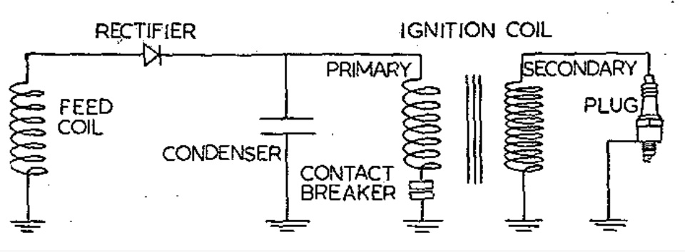

Just curious about something in the Wipac Magister feed.
A, The diagram for the magister appears incorrect,was this made or is it the original? Its shiwing a std magneto coil assy with primary and secondry and another secondry? This doesnt seem accurate am i missing something?
B, Deejays Magister for blumbly couldnt possibly work as there Is no Primary wire going into the magister! The wire is in the loom but doesnt enter the unit.
The green wire from the primary magneto/coil is supposed to enter the magister next to the purple and attaches to the secondry trans coil....
If its as mine are then it cannot work...
HT6 #59836 30/11/14 06:21 AM
I can't make your feed work, Blue. Were you talking about this circuit diagram?
The circuit can be seen in a published magazine article, referred to in this thread:
https://www.outdoorking-forum.com.au/forum/ubbthreads.php?ubb=showflat&Number=37014&page=3

Yes grumps...that diagram. No its correct what confused me was the primary and secondry coil section...but if you look at the primary trans coil inside the magister is in two winds,one inner one outer....so its all good....when I looked at it I firstly thought it was the magneto coil...all good:)
Blumblys coil was meant to have been tested and operational by my understanding.
The green wire is the feed from the primary magneto coil to the rectifier and loops back into the switch then into the primary of the trans coil....So it can never work!

Gadge has now supplied most of the component details, including the coil winding data both for the feed coil (inside the flywheel) and the transformer, or HT, coil (inside the earphone unit). I'd have thought it would be both more authentic and more practical to retain the original design, rather than have an HT wire a yard long, passing through a fake earphone unit, now that the component details are available. Remember, Phillips used to make replacement earphone units for the aftermarket. Their version was extraordinarily ugly, but shows it can be done provided you have access to the patent information (as we now do, thanks to Gadge).
