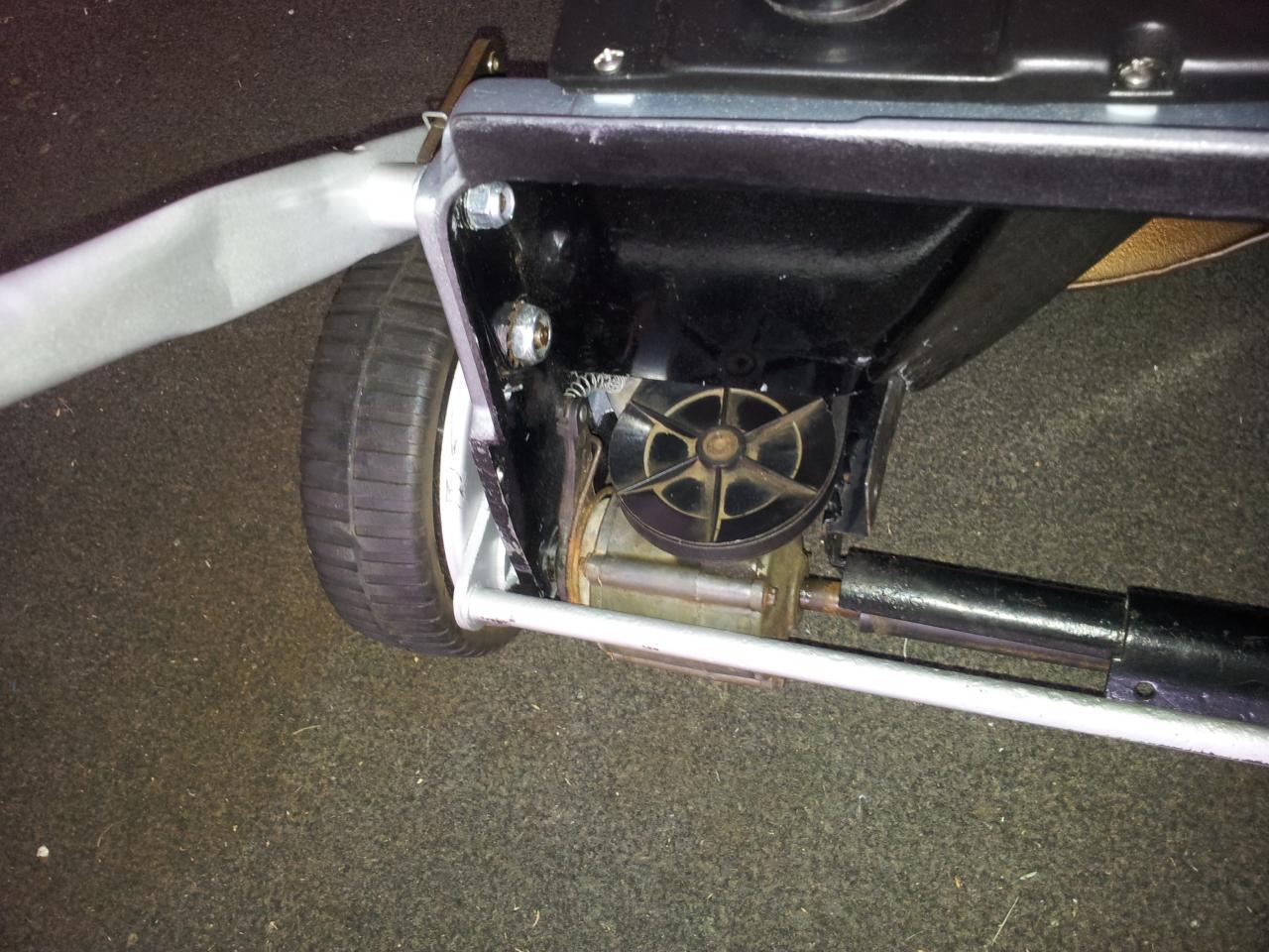

Engine runs first start and is very smoothly, but I cannot get the clutch to drive the back wheels.
I have a new clutch cone, new drive wheels and a new clutch cable - all correct parts from Bruce at Outdoor king who did a great job is sourcing the bits.
If I have the mower not running the mower moves easily frontwards and back and I can move the mower around the axis of the rear axle son the independent real wheel clutches seem ok.
When I engage the clutch lever I can pull the mower back but can't push it forward and the gearbox locks it to the motor. This seems back to front. Shouldn't it lock when I pull it back??
With the mower running when I push the clutch lever down as usual I get no drive!. If I lift the back wheels up I am getting forward rotation pf the drive wheels but there is no real power to push the mower. All adjustments of the clutch cable take up point or the position of the actuating arm on the gear box don't fix it.
Some help would be greatly appreciated.

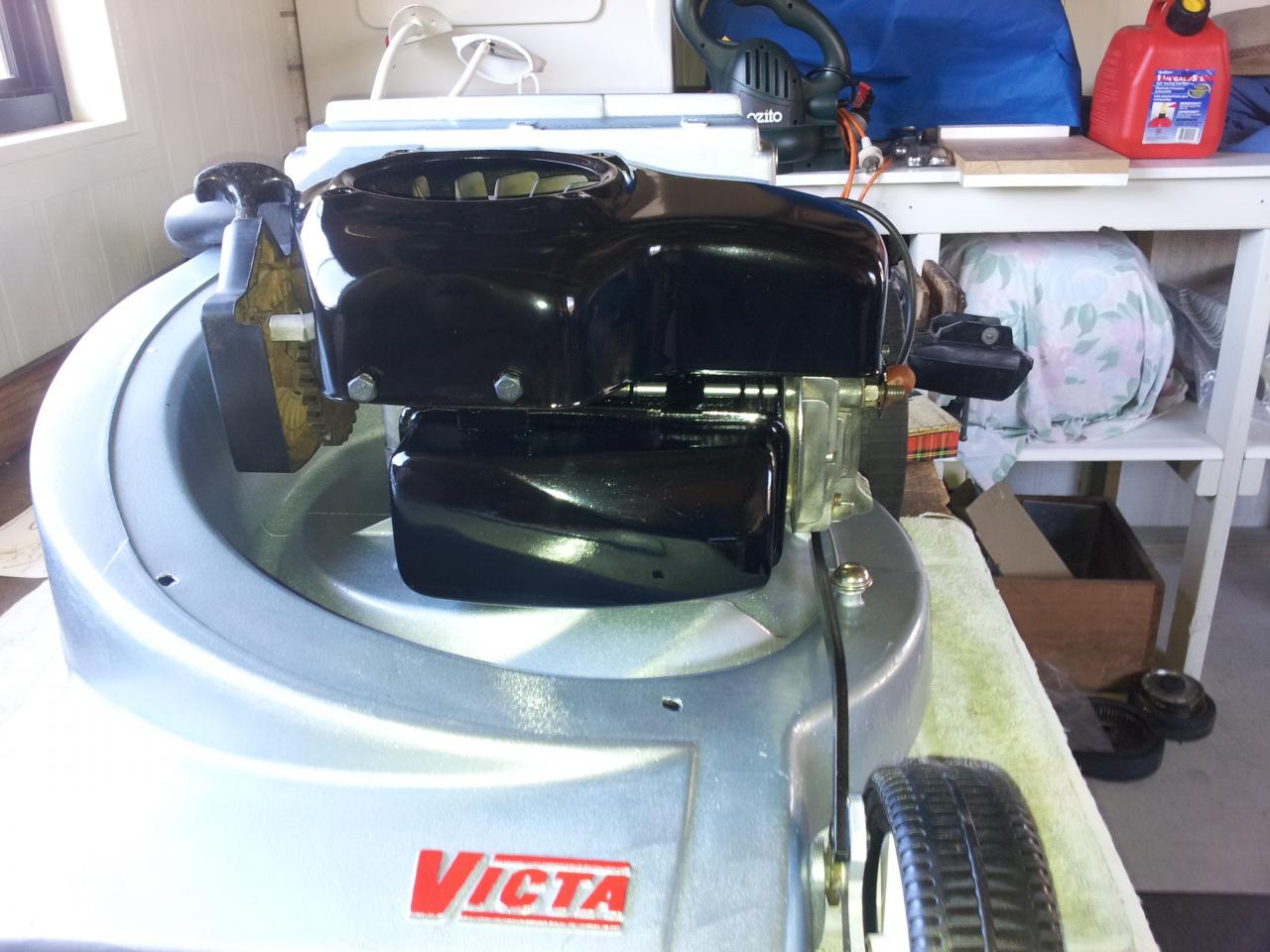

Pics of the Clutch installed

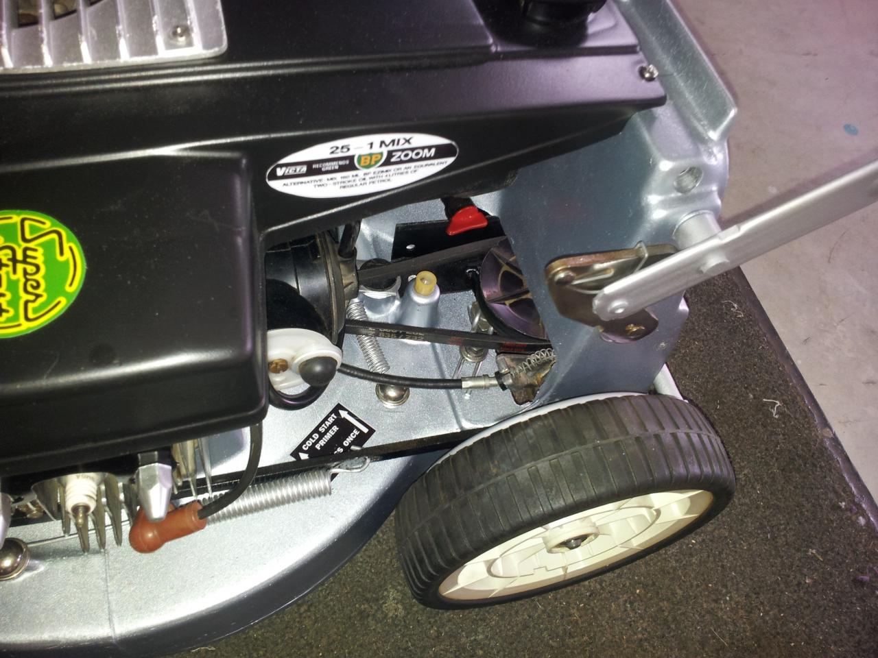

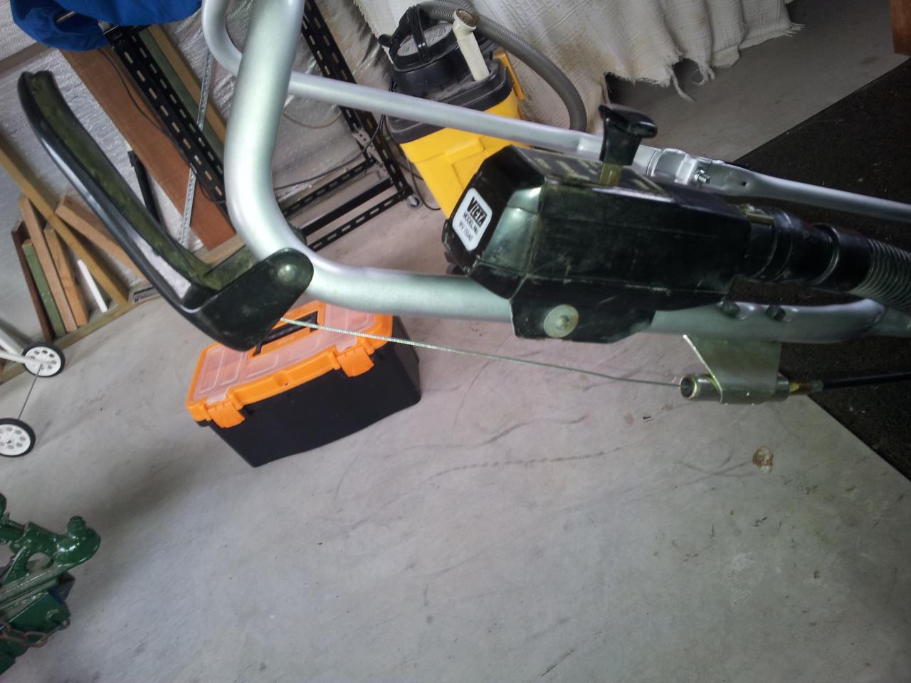

You have some cable adjustment up on the handles under the air filter, loosen the 2 x nuts and the bracket slides up or down a bit.
All mine are mounted on the inside, so you could flip yours around to match the one in my image.
I would jack up the back wheels and watch what the belt is doing when you push the SP lever.
Your locking wheels in reverse is a worry, you should be able to pull the mower back (it shouldn't lock) because when you are mowing you need to be able to get out of a corner.

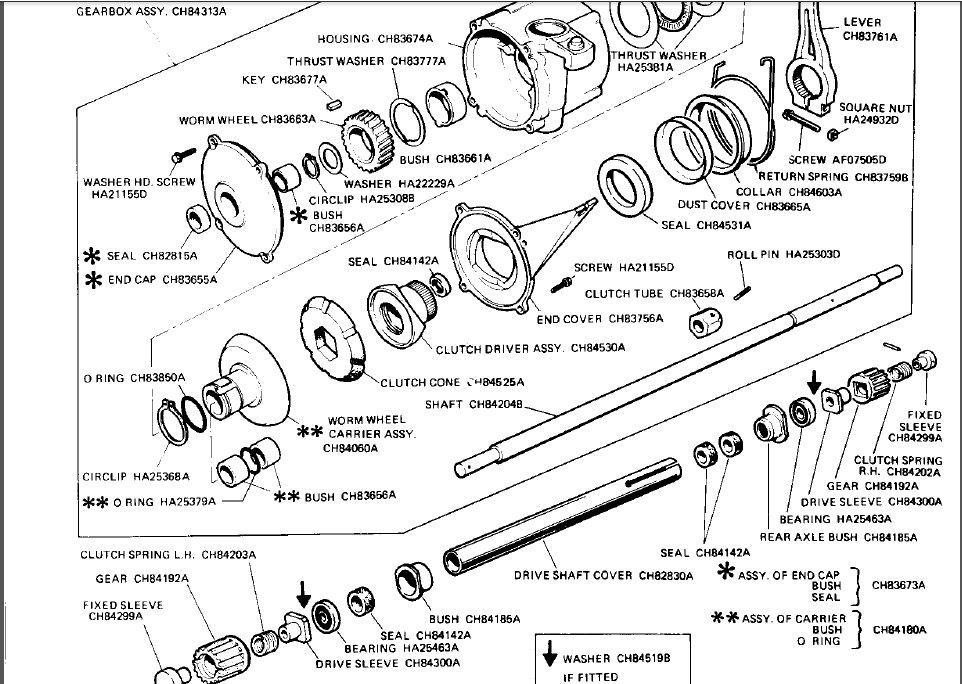

Are the wheel drive cogs reversible? I cant remember, I think its the Honda SP that has a Left and Right cog that cant be swapped.
Joined: Feb 2013
Posts: 194
Hi, there are one way clutches on each gear where the drive wheels fit, just make sure they are on the correct sides.

Mark, I fixed the clutch cable holder as described, duhh that was a bad miss for me.
Thanks guys I was almost onto it last night looking at the diagram I used to work on the drive shaft shows two different parts for the Clutch Spring RH - CH84202A and Clutch Spring LH - CH84203A
Only one number different! Another mad thought - if I could have made the motor run backwards the mower would have mowed fine in reverse ha ha.

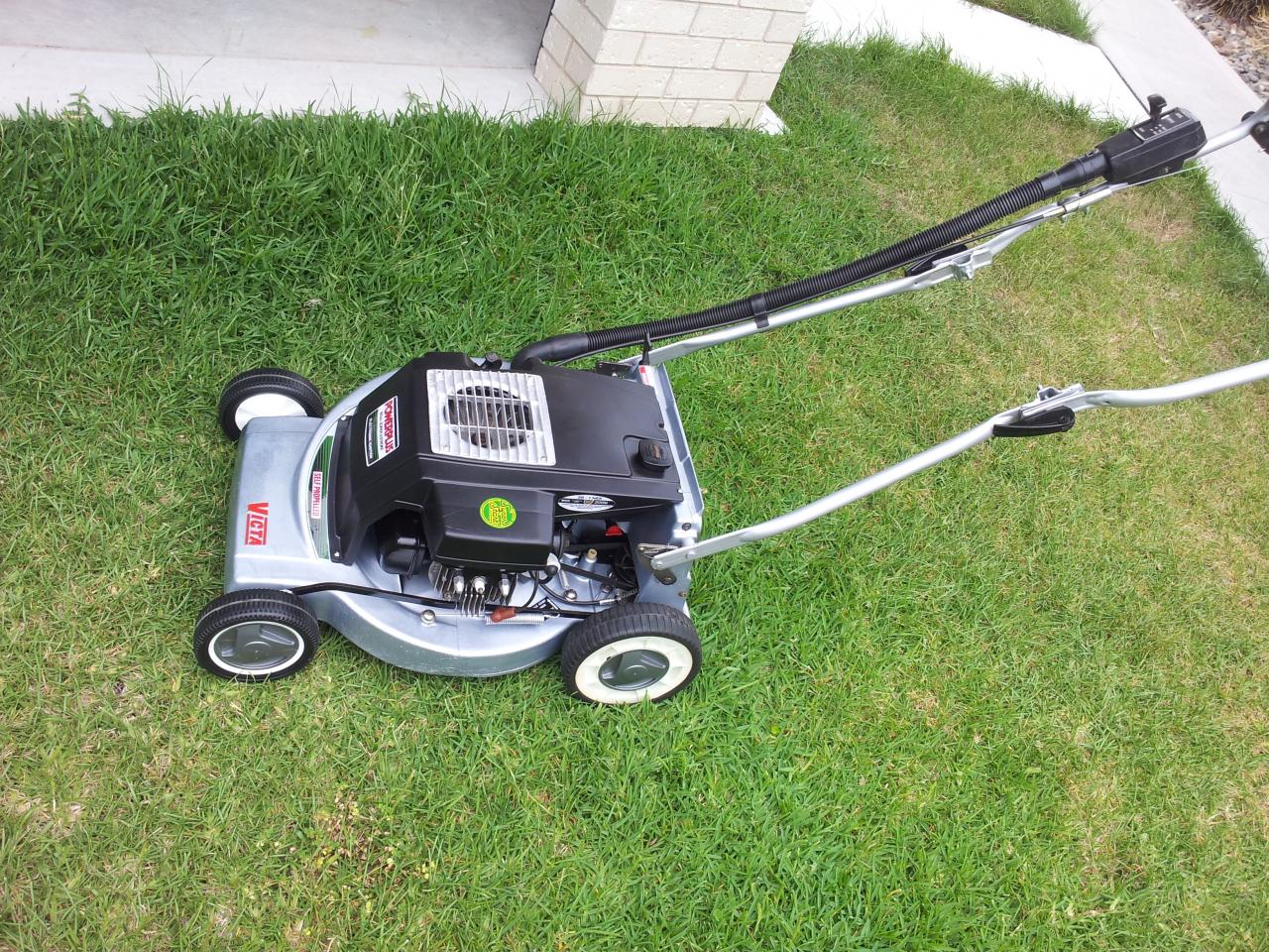

All finished now as far as I can tell. It is operating like brand new and has a lovely feel to the drive.

Some finished piccys
