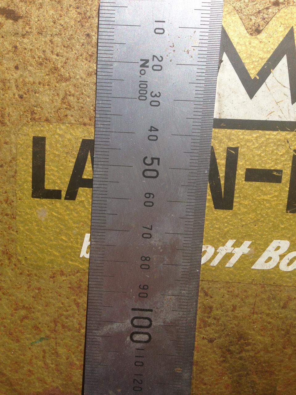

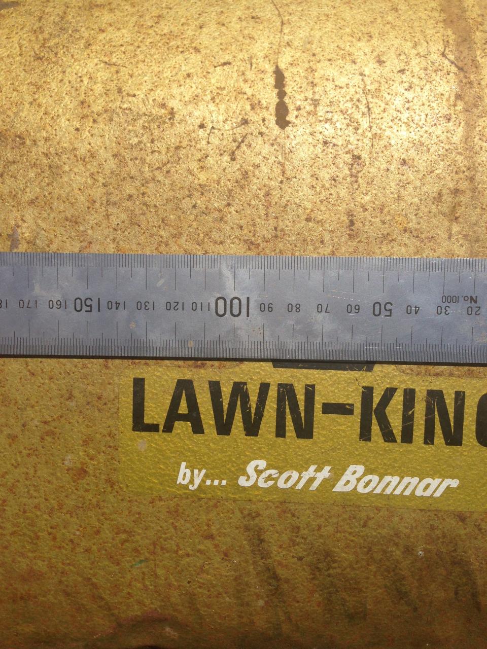

Just out of interest, below is the very last variation of the Lawn King Decal that was used exclusively on the Pacific Blue and Silver Streak [Linked Image]
Model 45's
It's not a great example but it's the only one I've fallen across in a few years.
This sticker was also used on the Silver painted Lawn Kings.

Yeah right! Thats not a bad looking decal at all! I haven't seen that one before.

The decals you'll buy are in fact taken from my original photo that's back up this thread a bit. Grant Simpson (willingworker) who does them is down Glenelg way.

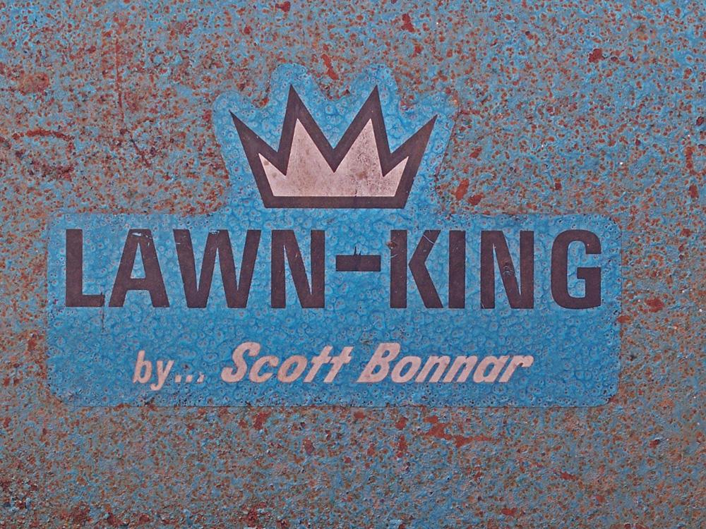

While this is a Model 45 Lawn King, this mower displays the blue livery with the same decal as shown on the silver version. I though that I would add this just for completeness of discussion regarding liveries and decals.
