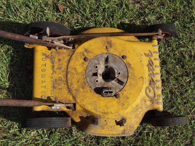

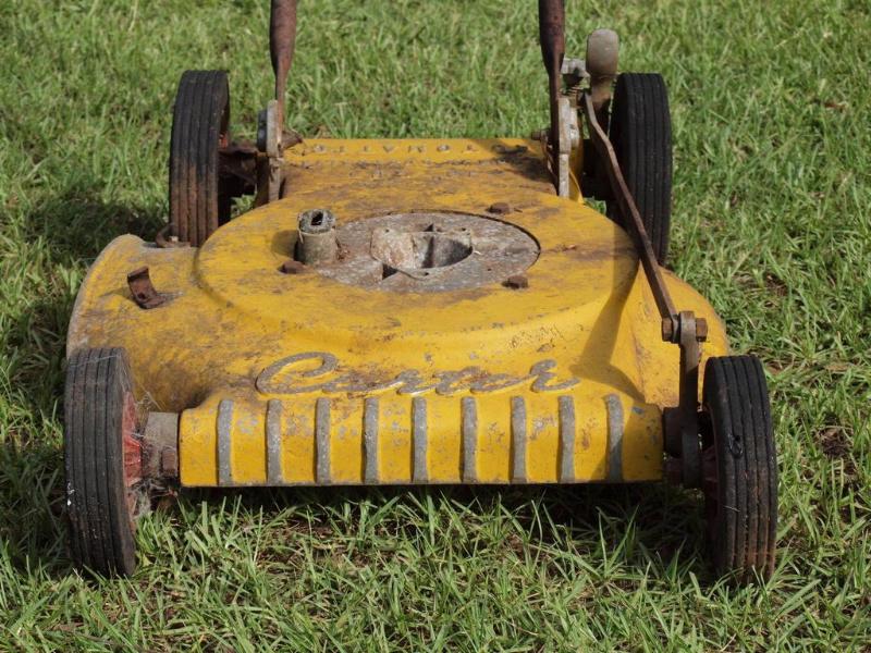

PART TWO - The Chassis
The alloy base had a narrow skirt that was an improvement in safety when compared to the 'plough disc'
or 'toe cutter' bases used on many Australian rotaries of the time.
It had 'instant' 4-wheel height adjustment. The automotive-style 'grill front' in the casting resembled
Pace, Supa-Swift and Turner bases of the era. The rear wheels were larger than the front and all wheels
were 'tubeless'.

It was an exciting find when a member came forward and presented a Carter Chassis
on these forums. All but the original Kirby 2-stroke engine was there!
