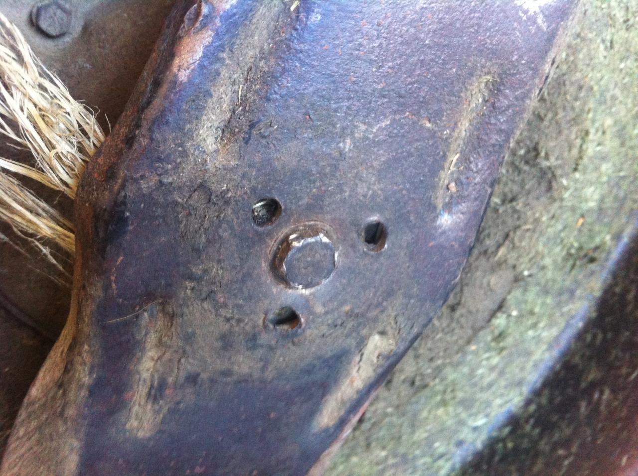

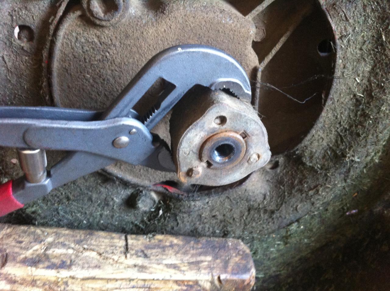

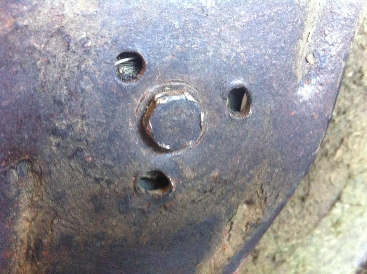

Hi Guys, I was just working on this mower. The engine after some repairs is going sweetly however I flipped it over to clean underneath and replace the blades and I encountered a problem. The photos are pretty self explanatory. It came to me with only one bolt holding the plate onto the boss. The 3 small bolts were not installed. I have tried to get the centre bolt out but it is stuck solid. Unfortunately I have burred the sides a little. I am hoping somebody could share a trick because this mower runs really nicely and I dont want to move it on before I fix the blade plate area. Hoping its a reasonably easy fix. ![[Linked Image]](https://www.outdoorking-forum.com.au/forum/uploads/usergals/2014/11/full-6412-18271-img_1688.jpg) ![[Linked Image]](https://www.outdoorking-forum.com.au/forum/uploads/usergals/2014/11/full-6412-18272-img_1689.jpg) ![[Linked Image]](https://www.outdoorking-forum.com.au/forum/uploads/usergals/2014/11/full-6412-18273-img_1690.jpg) ![[Linked Image]](https://www.outdoorking-forum.com.au/forum/uploads/usergals/2014/11/full-6412-18274-img_1691.jpg)

No go with the impact wrench. The bolt head is stuffed. Damn previous owner stuffed around with it so much Any other suggestions?

I have been using my rattle gun hooked up to the compressor and its a no go. I was using the 14mm socked as indicated. The problem lies in the fact the bolt head is pushed into the metal plate. It does not have a washer and lock washer like it should have to enable you to grip the head of the bolt fully. With a washer and lock washer it enables you to grip and yes with my rattle gun it normally comes off with ease. I am learning towards Marks suggestion and cutting the bolt down to the next size. I am not worred about marking the blade plate as its already damaged from not being connected propery. By marking the blade plate slightly I am hoping to get a bit more grip on the bolt head. After doing some more reading I found a suggestion stating that cutting a slot into the middle of the bolt might work to fit a large screwdriver into the head. I was worried this might make the situation harder again. Suggestions?

I had thought your bolt head was originally 5/8" A/F, but if you actually had a 9/16" bolt head (14.28 mm) and you were able to put a 14 mm socket on it, the bolt head must be substantially damaged.
The absence of the washer under the bolt head makes the situation worse, because the end of the socket is slightly radiused, further reducing the amount of engagement. If you are prepared to damage the blade plate, you can apply an angle grinder to grind back the blade plate around the bolt head by a full millimetre, then hand file or, if you have one, apply a diamond cutting disk in a small angle grinder, to make a perfect hexagon head out of the mangled mess you currently have. You will probably then need to undercut the blade plate from beneath the new hex head, because initially you'll have cut a hexagon into the blade plate when you cut one onto the bolt head.
Making perfect hex heads is a tricky process, and you need to succeed first time because every time you make it an extra size smaller, you reduce the torque you can apply to it. This is a process I've been through a fair number of times, though not on lawnmowers, and I've had both successes and failures. The failures were always because I didn't achieve a perfect hexagon of the perfect size to fit firmly into the six point impact socket.

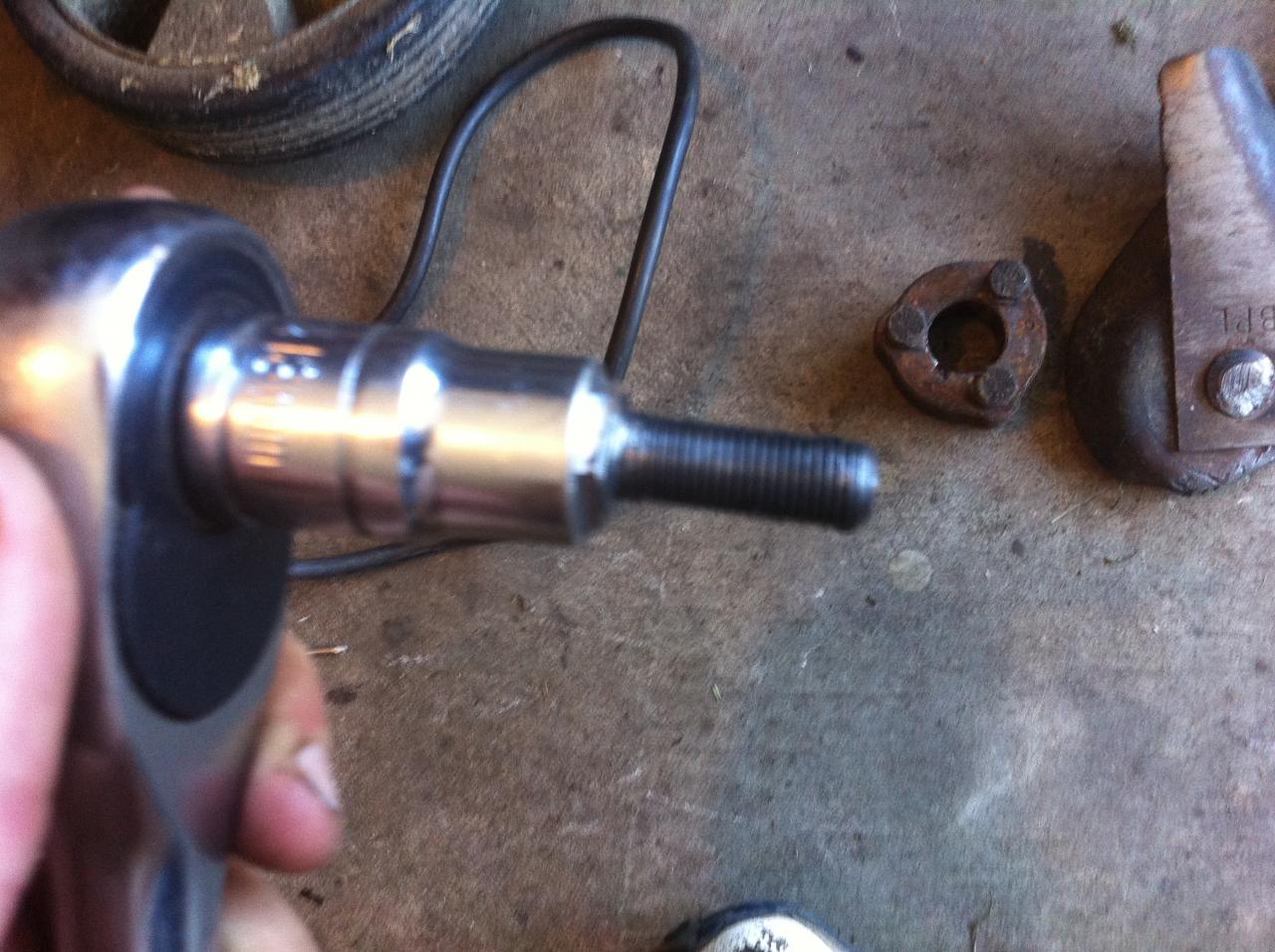

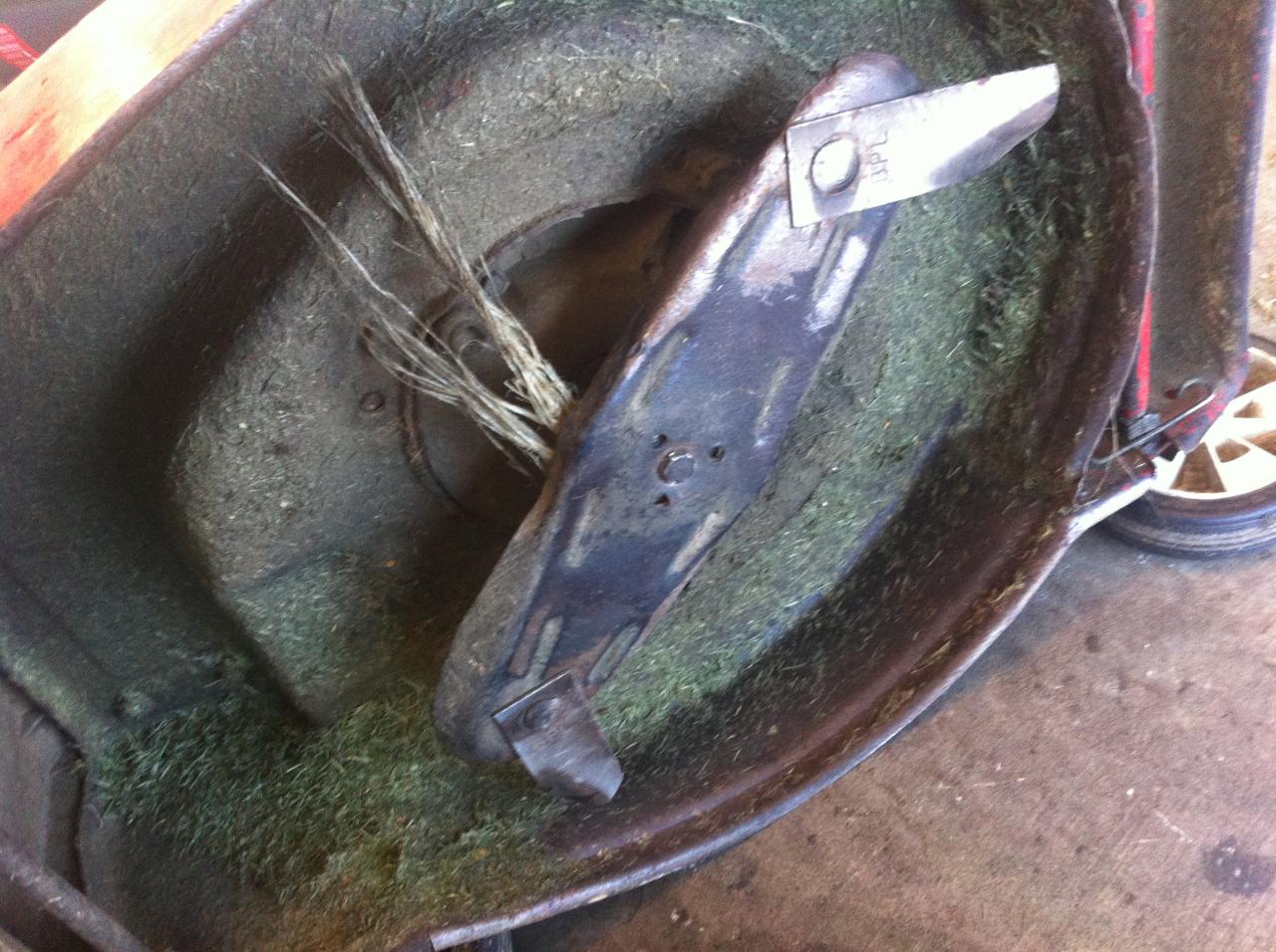

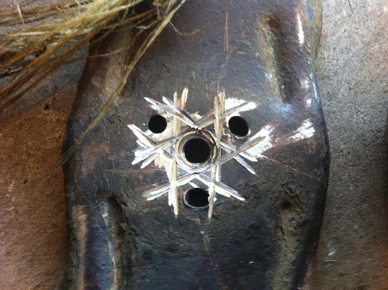

Thanks for all the pointers. The rattle gun wasn�t an option as the bolt head was far too indented into the blade plate because the previous owner obviously forgot to put a washer and lock washer before tightening the bolt. Thanks for the tip of using the standard socket. I�ll keep that in the memory bank for next time, noting of course the potential safety concerns. I ended up going with Mark and Grumpys suggestion. It took some careful grinding to keep a nice hexagon. After about 10 minutes of careful grinding and then re-testing with a 13mm socket the bolt came out relatively easily. The trick in this case was grumpy�s suggestion to cut into the blade plate (which was already damaged) and allow the compelte bolt head to be gripped with the 13 mm socket. I had to grip the boss with a set of multigrips because it was spinning in the absences of the 3 snapped bolts. I ended up putting on a round plate plate with four blades for that nicer cut. I also had to replace the boss because of the broken bolts. I have a couple of second hand bosses off wrecked mowers so it wasn�t a problem. I have included a couple of photos below. Thanks again for all your help Peter ![[Linked Image]](https://www.outdoorking-forum.com.au/forum/uploads/usergals/2014/11/full-6412-18286-img_1694.jpg) ![[Linked Image]](https://www.outdoorking-forum.com.au/forum/uploads/usergals/2014/11/full-6412-18287-img_1697.jpg) ![[Linked Image]](https://www.outdoorking-forum.com.au/forum/uploads/usergals/2014/11/full-6412-18288-img_1699.jpg)

Nicely executed, Peter. That blade plate was very deeply penetrated by a spinning spring washer at some point, and wasn't salvageable anyway, so you didn't lose anything by grinding it.
