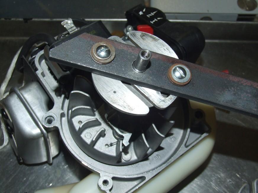

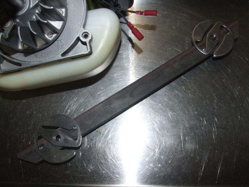

Well here's my new tool to tighten up the clutch plates on that particular model of Ryobi trimmer.
Basically I grabbed an offcut of 25 x 6 mild steel bar of a handy lever length, and put screws in to create pins that can engage the clutch plates. See photos below.
The tool had to be double ended, because to get the clutch plates off, the pins have to be spaced 47mm apart, while to tighten them on, the pins have to be 50.5mm apart. I just used some 3/16" BSW dome-head screws that were in one of my screw jars, they were a nice fit, but a bit long, hence the washers on the back-side of the tool, just packing the screws up so the projecting pins are the right length (3.4mm). I drilled my screw holes 4mm and tapped 3/16 BSW - handy I got those BSW taps on eBay a while ago. To let the engine shaft through, I drilled a 10mm centre hole. That the steel bar has mitred ends is just because it's an offcut from another job.
Now to see if it works, as in, to get the clutch plates down really tight so that the flywheel can't lift and strip its spline off when running. Stay tuned.

I assembled the trimmer, tightening the clutch plates as hard as I could using the shop-made tool shown in my previous post. I was afraid to go too tight, because all I was working against was the piston pressing up on the wad of nylon cord I had pushed down into the cylinder. I didn't want to spoil the piston rod or bearings in some way by yanking down too hard with the tool. Still, the clutch plates must be pretty tight.
So I ran the trimmer for about 20 minutes cutting grass. So far so good, the flywheel is obviously still engaged on its taper. I guess my failure with the first flywheel was from not tightening it down properly by fully tightening the clutch plate over it to jam the flywheel onto the taper. Fingers crossed.
To minimise the risk of breaking the piston or rod when you do the rope-in-the-cylinder trick, make sure you put in just the right amount of rope so that the piston is halfway up the stroke after the rope has compressed as much as it is going to. If you do the rope trick and end up with the piston near the top or bottom of the stroke, you are greatly magnifying the forces on the piston and rod, due to the crank and rod acting as an over-center mechanism.
