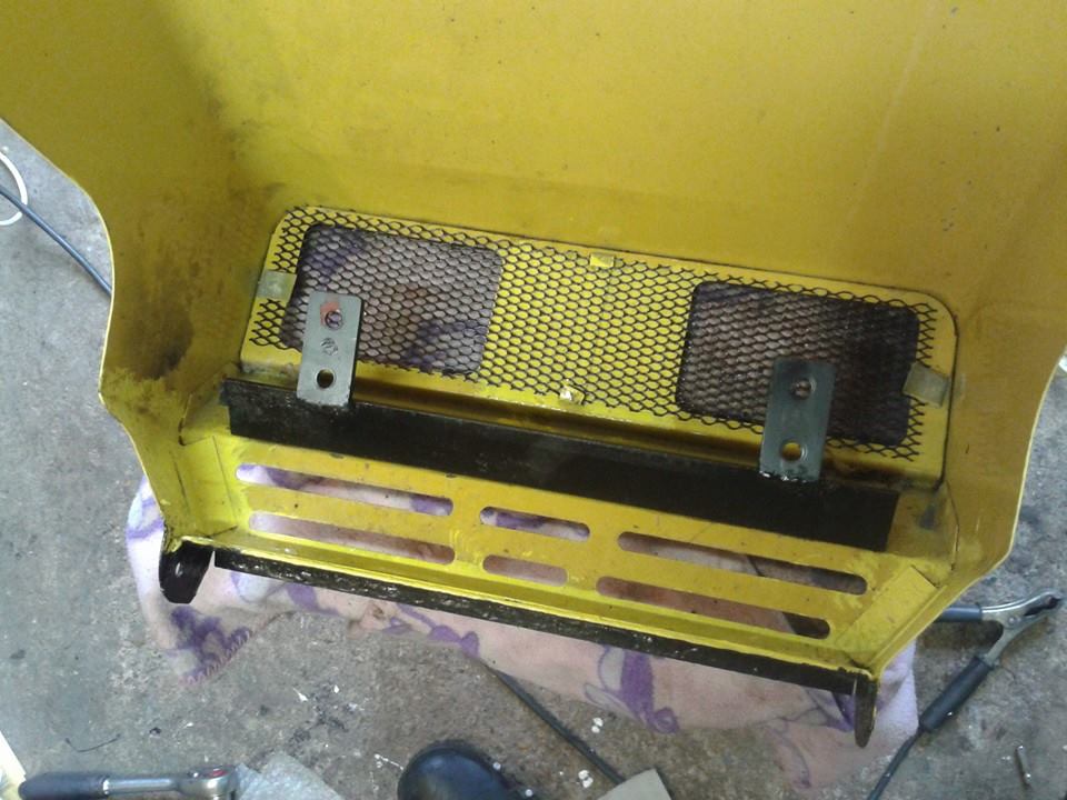

The reason the wire mesh is in front of the lights is for two reasons, well three reasons really new
It was already in place and I had just painted it as it was rusty,,,
Also, the new lights are a different shape to the holes already in the bonnet as I could not get original items. So to make these lights a snug fit I would have to trim metal off of each side of the headlight hole and weld a strip along the top and bottom of each hole and make the bracket to mount them so the lenses are just protruding through, with a rubber trim around the opening and obviously paint the front of the bonnet. I like the "simple is efficient" rule!
As for stones flying up, when it is on a trailer on the back of my van going to and from jobs, yes it is quite possible, which is why I left them as a type of stone guard, I live on a small island, 26 miles long, and approx. 13 miles wide, (146 sq miles) and our roads are horrendous frown

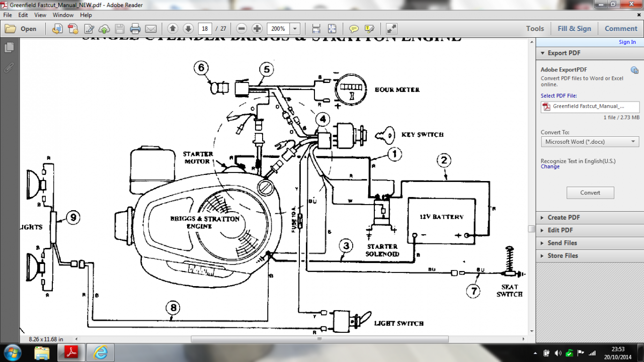

the drawing i have is not really clear.
*Now if i connect the orange wire from ignition directly to DC output, will i charge the battery this way?
*Also i don't understand where they take the positive power for hour meter looks like a red wire from the body (that doesn't make sense.)
That diagram does not make much sense by itself. It seems to be just part of the mower's wiring diagram.
The Briggs engine has a single wire that should be black, and a pair of wires that could be various colours, that connect to the mower itself. The single black wire is the kill wire: its only job is to stop the engine when it is grounded. People sometimes make the mistake of connecting this wire to +12 Volts when the engine is running: don't do it, that will destroy the ignition module.
The other pair of wires are the alternator output. They are connected together at the alternator, but one of them has a diode in it somewhere along its length - usually near the output connector that connects to the mower's wiring harness. The wire with the diode supplies DC, the one without the diode supplies AC.
If your engine has an electric starter, there will be a heavy wire from the starter motor. Most likely the mower's wiring will have a solenoid to operate the starter, but this is not a part of the engine.

[quote=Iceman][quote=Gadge][quote=Iceman]
In this picture could you please tell me where the orange wire is connected.
I believe that the wire with red terminal and diode goes to the key switch and the other with black sleeve should go to 12v+ pin on hour meter.
Can somebody confirm this is the correct way to do it.
I definitely have a diode connected on the red output wire (DC output) and nothing on black output Wire (AC output)
thank you all for your precious information.
jerome

no nothing like this. But my mower is Evolution 2000 MKII with 15.5HP B&S.(originally B&S 16HP)
here is my configuration. just with harness 5 and 6 messed up by previous owner.
I successfully connect DC output directly to Key switch so now its charging at least and also I connected the Hour meter to key switch to.
So the clock tick now as soon as i turn ignition on. i don't really worry so much as i don't leave contact on if I'm not mowing. i may Add a Diode later on so the hour meter will only tick if engine is on.
Cheers.
