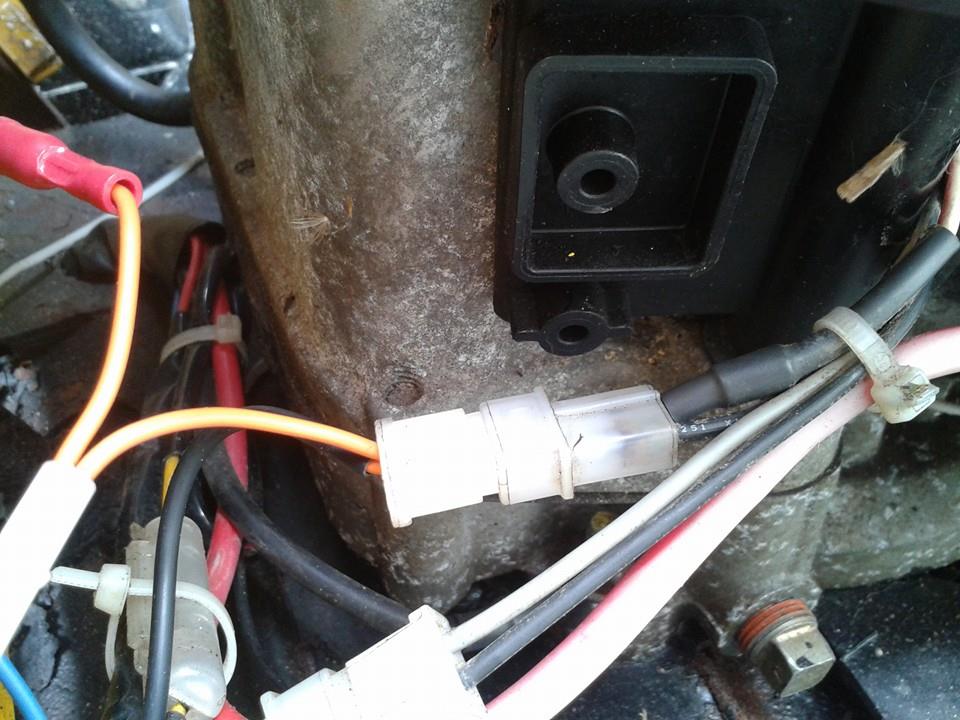

RE the wires coming out from the engine, looks like a red and white wire, and also a black wire, going in to a white plastic two pin plug, but the black wire is not connected to anything on the other side of the plug so am I right to assume this is the lighting coil wire!
The other wires beneath it in the photos are to the carb fuel solenoid on the other side of engine. I had flushed the fuel system out, was clean, runs like a dream apart from backing off of the throttle. Locals always moan about poor quality unleaded fuel we have, but I run a diesel van so only buy petrol for my mowers! But yes, possible air leak, I did have to replace two lengths of fuel pipe due to perishing, (plus the tap and filter of course).

On the smaller alternators Briggs usually fits the diode right at the output connector. You can see it in your picture: red/white and black wires into the white/clear connector, with a diode in the red/white wire. The red/white wire with the diode is connected to a yellowish-white wire on the tractor-harness side: this is the DC charging current to the battery, and the tractor electricals in general. The black wire from the engine's alternator into the connector is not being used at present - it carries AC, and would normally be connected to the headlight switch on the tractor harness side of the connector. This coincides with Gadge's Figure 11, but the feed wire to the diode is red and white instead of red.
Greenfield, like many other tractor manufacturers, does not use the AC supply circuit. My guess as to why they do not use it is that they want the headlights to be available for use when the engine is not running. Of course, the AC supply will not produce any output when the engine is stopped, which to me seems like a good thing, since it prevents the battery being discharged foolishly by inappropriate use of the headlights.
When you replaced the perished fuel hoses, did you remove the carburetor float bowl and clean the inside of it, plus clean out the anti-afterfire solenoid, and the main jet? The material from the perished hoses has to have gone somewhere, and those places seem likely destinations. Note also that the anti-afterfire solenoid on Briggs engines has been a very unreliable component, though at the moment I can't relate a problem with it (other than its fuel passage being blocked with junk) to your symptoms. For diagnostic purposes people sometimes remove it temporarily, screwing in a suitable very short bolt instead, to see if that fixes something. If it does, the solenoid has to be replaced with a new one.

Looks like a match, except of course for the white/red DC output wire colour. Wouldn't be the first time changes during the production run haven't made it into the service literature!
The tractor-harness side wire is of course whatever colour Greenfield saw fit to use...

Had a couple of hours free today so I knocked up the bracket and fitted the lamps and heat shield.
Dug out the yellow wire that was folded up in the loom and yay it does have power!!
Will sort the wiring out next time.

Excellent cheers, I am a bit concerned about running the lights from the battery itself while running, I put a voltmeter on it to check the output while engine running to see what it is charging at and on tickover it is 12.3v and full revs it is 12.6v. It has a brand new battery.
This worries me as my other Briggs (11.5hp) puts out 12.9v to over 13 volts on full revs, and about 12.6v on tickover.
Not sure if I am missing a voltage regulator, I have tried looking for the location of one online but where is it meant to be on a 15.5hp intek?
Greenfield have an added charging harness which is brand new on mine, numbers 5 and 6 are the harness and charging diode. Would this be what is making the output so low? I am concerned the lights will draw more current than the alternator can put back in!! [Linked Image]
