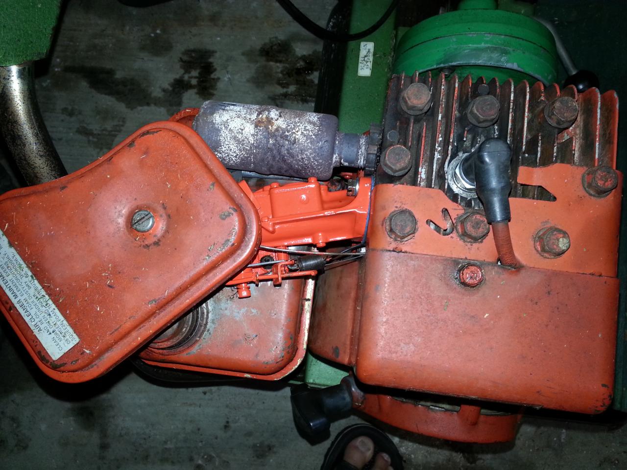

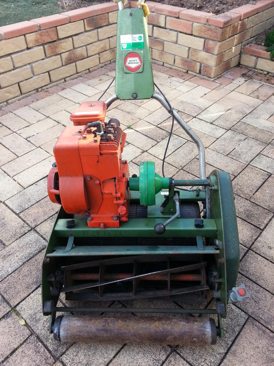

Hi, I have a Rover Scott Bonnar 45 model no 80202 0880 01 80030303. Have cleaned out the carbe, new diaphragm, air cleaner, manifold and fuel tank gaskets, oil and no rubbish around the cooling fins. It starts and runs for about 5 minutes and then runs rough, loses power and stops. The only way to restart is to choke it once and it will go for another 5 minutes. Very frustrating. A couple of photos [Linked Image]

Thanks Grumpy, tried a couple of things, noticed it runs very hot about the time it runs rough and stops, also noticed that the head gasket is leaking, will get a new one next week.
The symptoms fit an overheating problem. I note you have already checked the cooling fins. Did you check the fins right across the head, especially underneath the top of the cowl (the most important part)? Are the fins on the flywheel fan present and clear? Of course a severe head gasket leak could be the problem too, but such leaks have to have a cause. Unless someone has loosened one or more of the cylinder head bolts at some time, blown headgaskets on side valve Briggs engines are more often a symptom of overheating, than a cause of it.
Joined: Feb 2014
Posts: 12
It's leaking from between the intake manifold and exhaust, the fins are clear and present.
The gasket obviously needs to be replaced. When you do it, you will need to check both head and cylinder castings for flatness. It must have blown for a reason. One part or the other may be bowed, and if it has been blown for a long time, you may find a leakage path that has eroded the aluminium.
