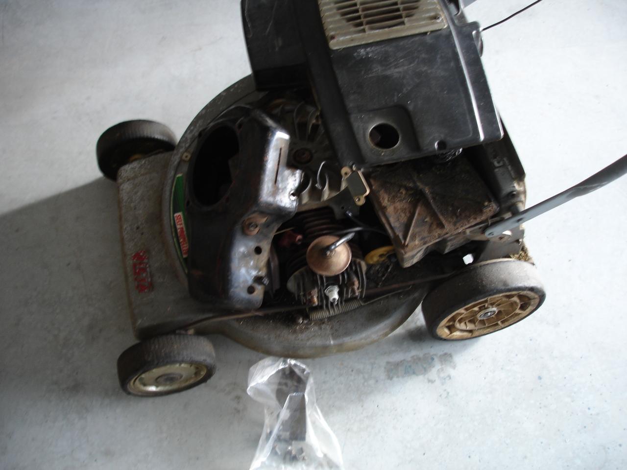

I could do with some help identifying it and some advice on an ignition problem. I will post actual pictures of it soon as I get it back from the repairer. The repair refuses to do any more work on it after trying three different ignition units on it. He says that the coil tests perfect on his "coil tester". The repaired said it is a 160cc pre "Power Torque" and a good engine to have. The bore and mechanical check out OK.

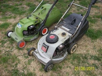

In this picture it is like the grey one but the plastic goes right over to the front. The air tube and drive lever are the same.
In this picture the mower I have is similar but my air tube is on the other side as mentioned but the plastic cowl is like mine. My starter handle comes from a hole in the side of the cowl not on top.

Is this by any chance the mower in question? its hard to give good help on a machine if one cant be definate on whats being worked on.

Yes Yes Yes - Good on you Joe!
That is the exact model I own.

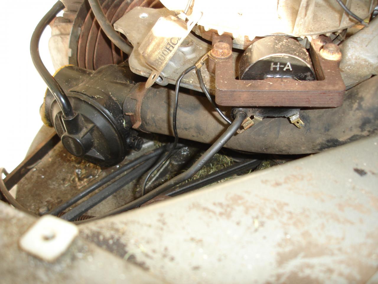

Ok, I got the mower back from the "Repairers" Ha!
If you look at the pics you sill see they gave it back to me in a mess. The wiring is apart and they have lost my rear wheel cover! And they have left the ignition module off and with no lug on the end of the wire!
Talking to the dudes there,they said maybe it's not the spark after all and maybe the carby. He said that as I told him I had completely r/r and cleaned the carby and in the process knocked the lug off the coil. They haven't got a clue do they?
All of that cost me four weeks and fifty bucks.
The mower ran well after the carby clean but became impossible to start. I told him I had to inject fuel in the plug hole to get it going. It seemed that with the throttle at the start position I could never get the plug "wet" even with pumping the rubber dome heaps. I have checked the needle and seat and it works ok with the bowl holding fuel.
The ignition module has 800HC2 printed on the side and it is rectangular as per the pics. The coil has H-A printed on it. They tried to make it go with smaller square modules.
As the ignition wires are all over the place can anyone please tell me.
1. Does the module rivet under or on top of the plate?
2. Which side of the coil lugs has the ignition module and which side the earth wire? The pics show the earth wire very stretched onto a lug?

Re riveted on the old spark module to the underside of the plate.
Got a weakish spark at the plug.
Reversed the wires to the coil cause I don't know how they go.
Got no spark at the plug so moved the wires back.
Took the magneto off and all seems good there.
Reset the air gap to the magnets as the "repairer" left the gap big enough to jump thru.
Set the gap a double fold of A4 paper thickness about .010 thou?
Got a bright blue spark at the plug. Yay
