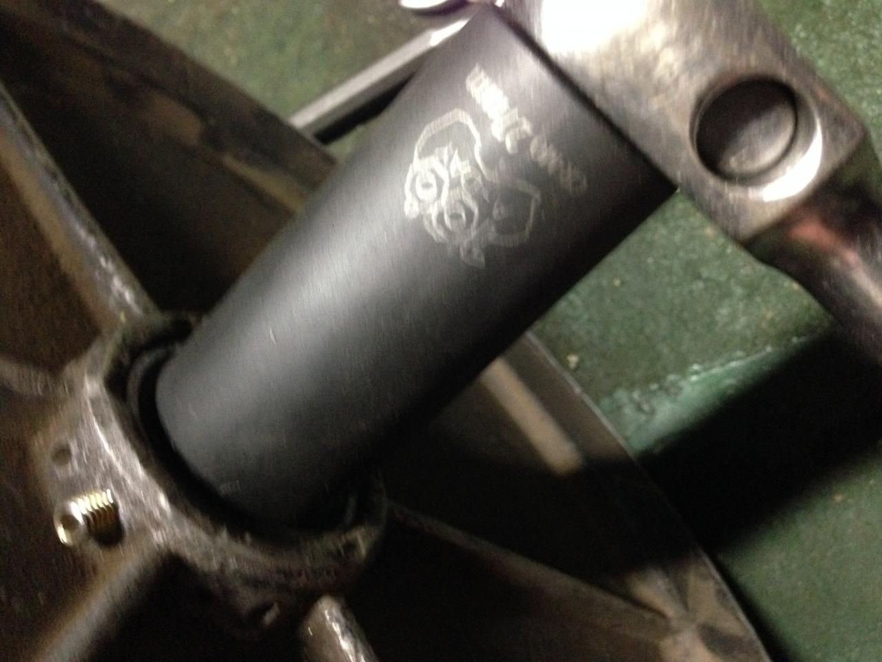

For the members here that have not got experience with ride-ons, can you please post some pics of the axle during the drag tests...I, for one, can't picture in my mind what you are actually doing. wink

This roughly shows what i am doing to get the shim correct i first pull it apart then i remove the shims and i reassemble with out the sprocket and run it on a set of jack stands to check the drag i have it now so it has little drag on both clutches so when i get it back together i will post up how it went

Good photo's Wiix, keep up your good tutorial.
Aldot did it by assembling the clutches on the axle (including tightening the nuts properly) then holding the two ends of the axle in his hands so it couldn't rotate. He rolled the pulleys (on the outside of the clutch disks) back and forth across the bench. By feeling how hard the axle was trying to rotate, he could monitor the drag. No drag, take out a shim. Too much drag, add a shim. Not too difficult, I think, once you have the axle out of the tractor.
Thanks Wiix for posting the pix, this will be very good for the archives... grin

Am thinking of tightening the clamp nut on the forward clutch just a bit on my E2000 as I need to put a fair bit of pressure on the forward pedal but the reverse is fine, both corks were changed in Feb 2012) and the drive belt is as tight as.
I was thinking of doing it on the machine, but I don't have the right size open end spanner, do you remember what size socket you are using on that second photo so I can buy the correct size spanner.

yea it was a 27mm
