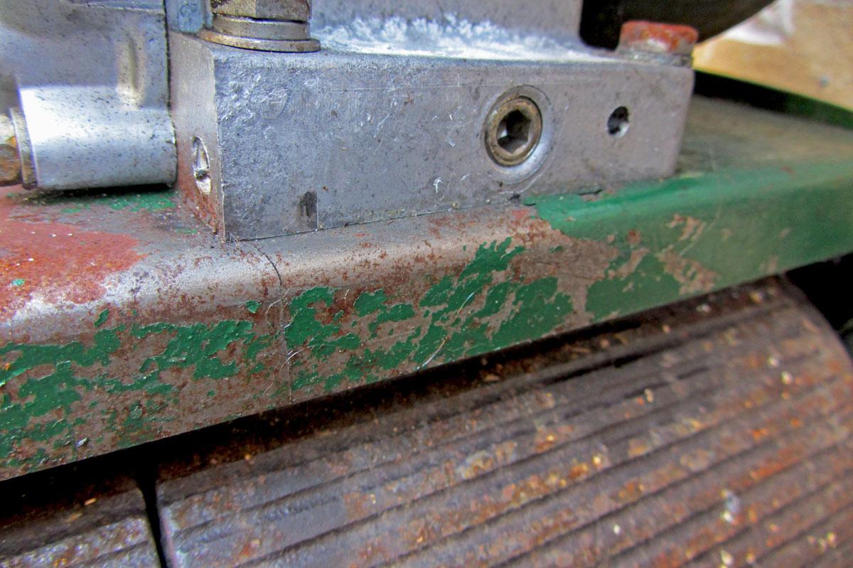

Well here's a cracked Rover in my boneyard..
The solid deck machine from my previous post is also cracked badly at the rear of the deck..
I can only remember seeing one cracked single deck in our archives before, compared with quite a few twin rails.
