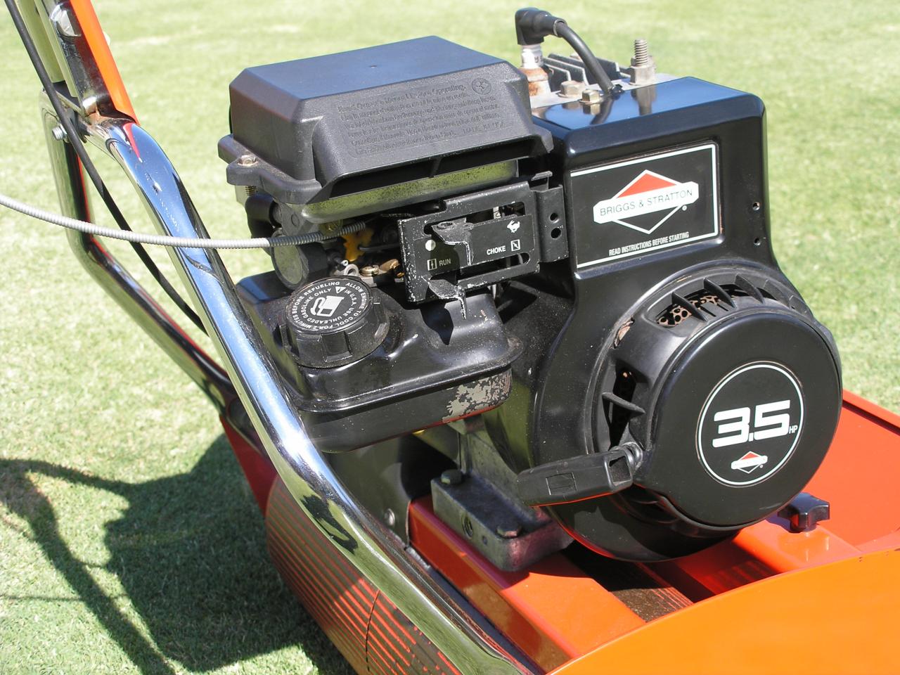

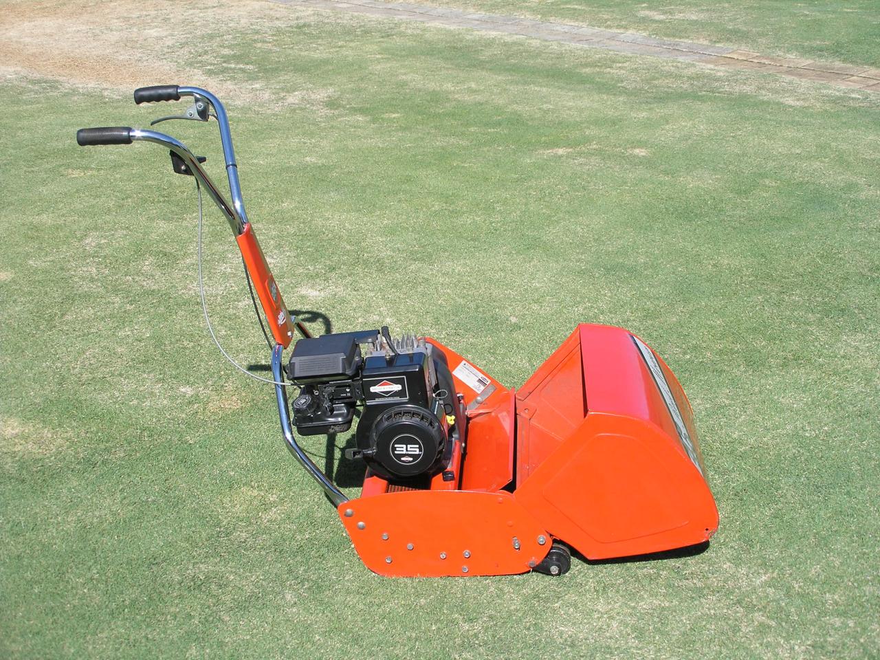

Hi all. I'm wondering if someone can help with a problem?. I have a Rover cylinder mower with a Briggs & Stratton that surges at idol and at full throttle.
Model 91212.
Type 1025EI.
Code 0006093A.

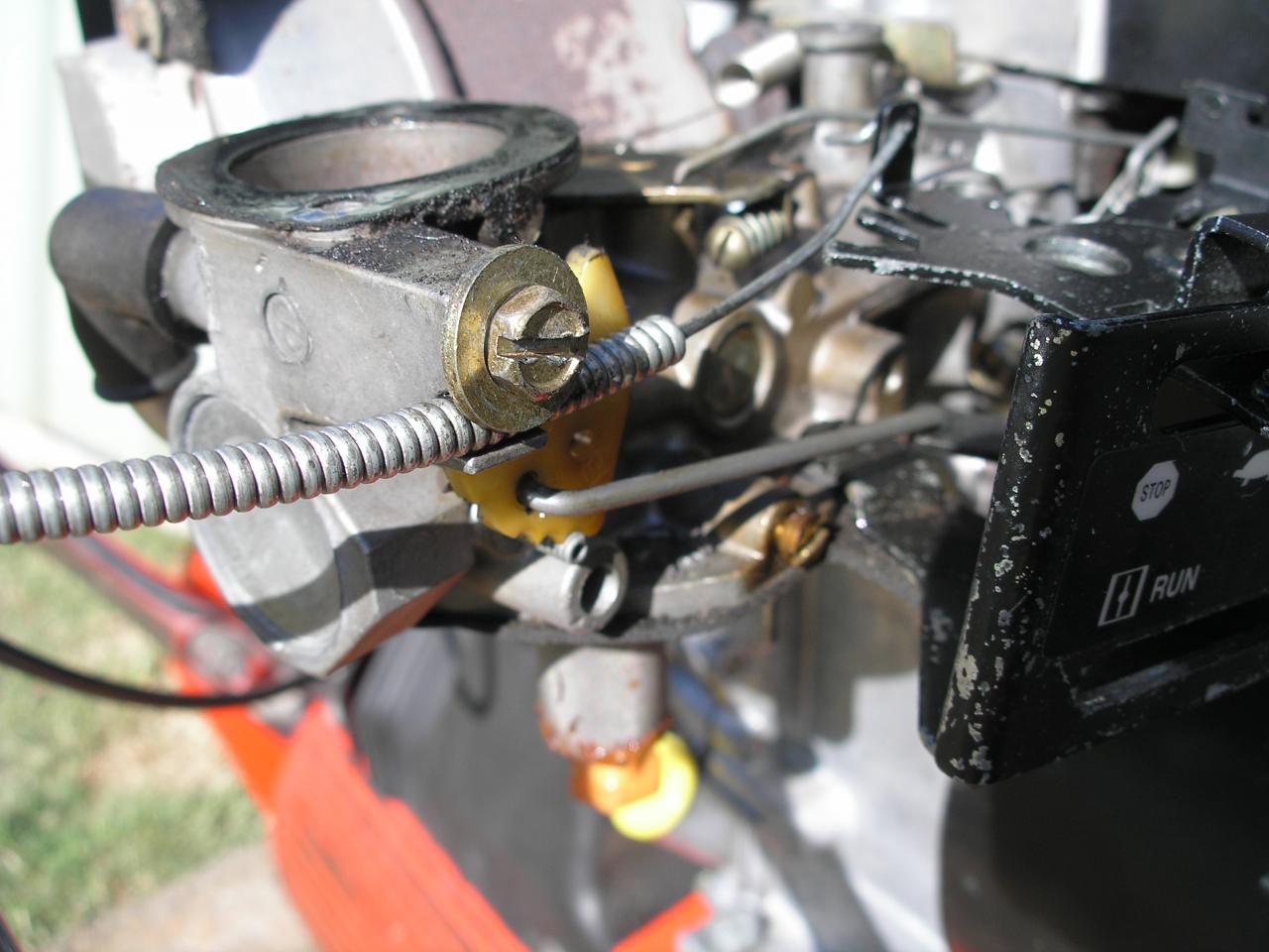

It sounds like lean mixture then, and you will need to look at the carburetor. Please post pictures of the carburetor. It appears to be a version of the Pulsa-Jet with governed idle and a rotary choke, but let's be sure we are on the same page about that.

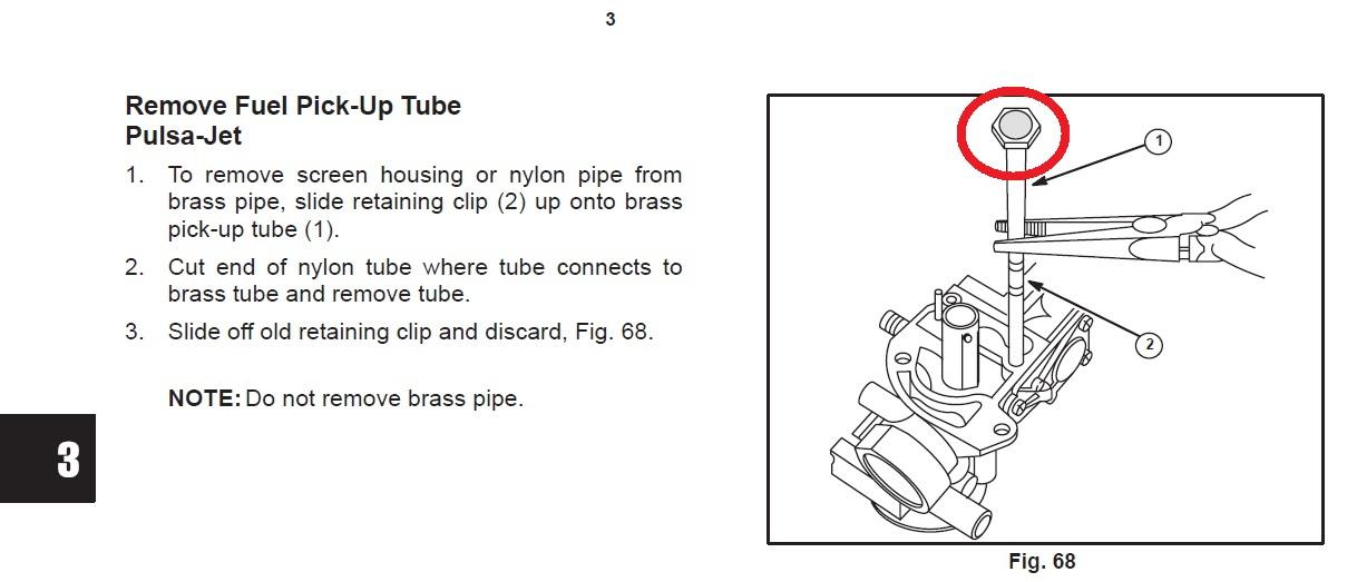

Once we are both sure which carburetor we are talking about, you will need to remove the carburetor and attached fuel tank from the engine, then remove the carburetor from the fuel tank. Turn the carburetor upside down and check that the fuel screen is clear (circled in red in this illustration from the manual):
If the screen is clear, we can look at the main jet, but the screen is the usual cause of your kind of problem. If there is dirt or, more likely, grass on the screen, you will need to remove the fouling. I do not recommend following the instruction on the diagram to routinely cut the nylon tube, since you'd then need a new screen: usually you can avoid this disassembly process and clean the screen from the outside with a soft brush, being careful not to push the rubbish through the screen.

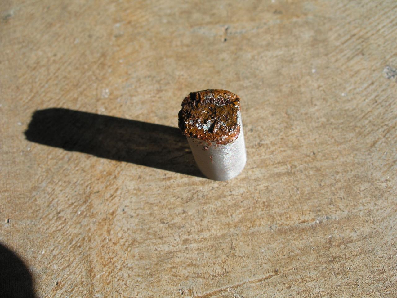

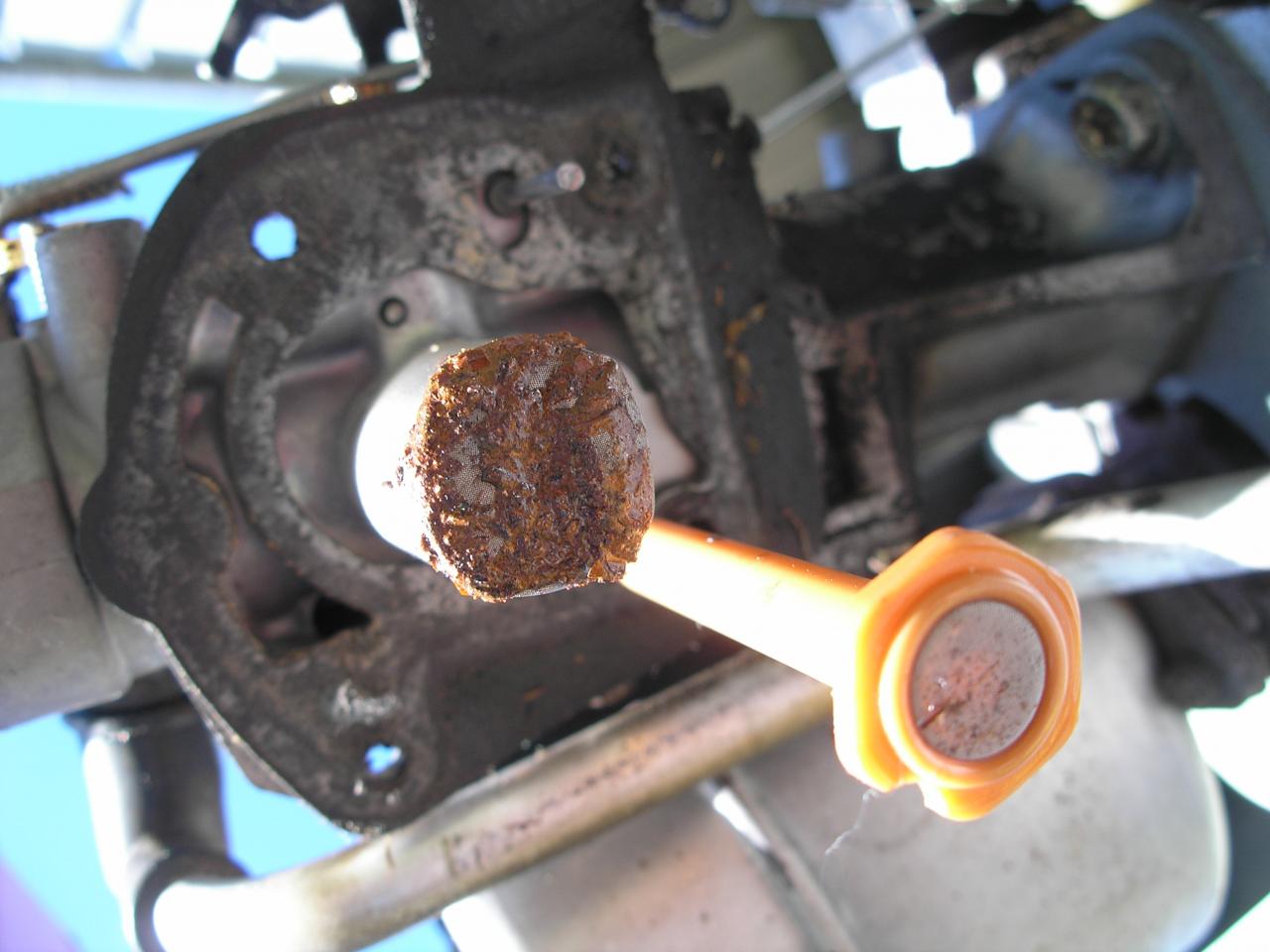

Hi grumpy. I removed the fuel tank from the carby and discovered a little fouling of the fuel pick up tube screen, however the other screen which dips into the secondary tank within the main tank was fouled with rusty gunk. I cleaned the screens as well as the fuel tank, put it back together, but to my disappointment made little improvement to the way it runs frown. See photos below. [Linked Image]
It looks as if the fuel tank has had water in it, from the brown sludge in the well that the main jet screen dips into. The main jet is right behind that screen, either in the bottom of the tower or in the side of it near the bottom. Clean that jet and the passages behind it with carburetor cleaner, and inspect it afterward to be sure it is clear. Was the well below the main jet screen full when you removed the carburetor from the tank? The purpose of the fuel pump is to keep that well steadily overflowing back into the tank. The pattern of the crud on the filter suggests it may have been barely reaching down to the fuel in the well, which would imply a fuel pump malfunction. Are you sure the tube that leads to the fuel pump intake screen (the longer tube, with the screen that was only slightly fouled) is clear? I suggest you revisit the fuel pump overhaul you did earlier, and make sure all is well there.
