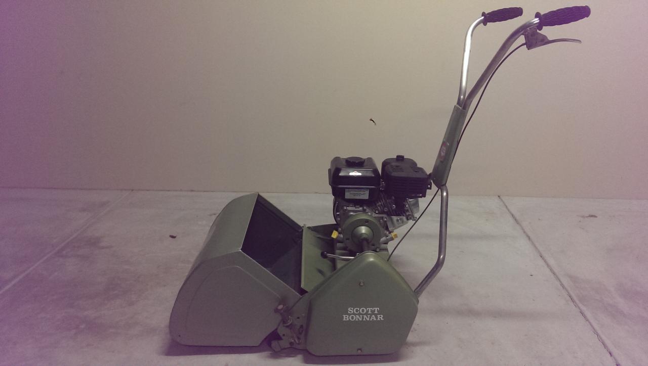

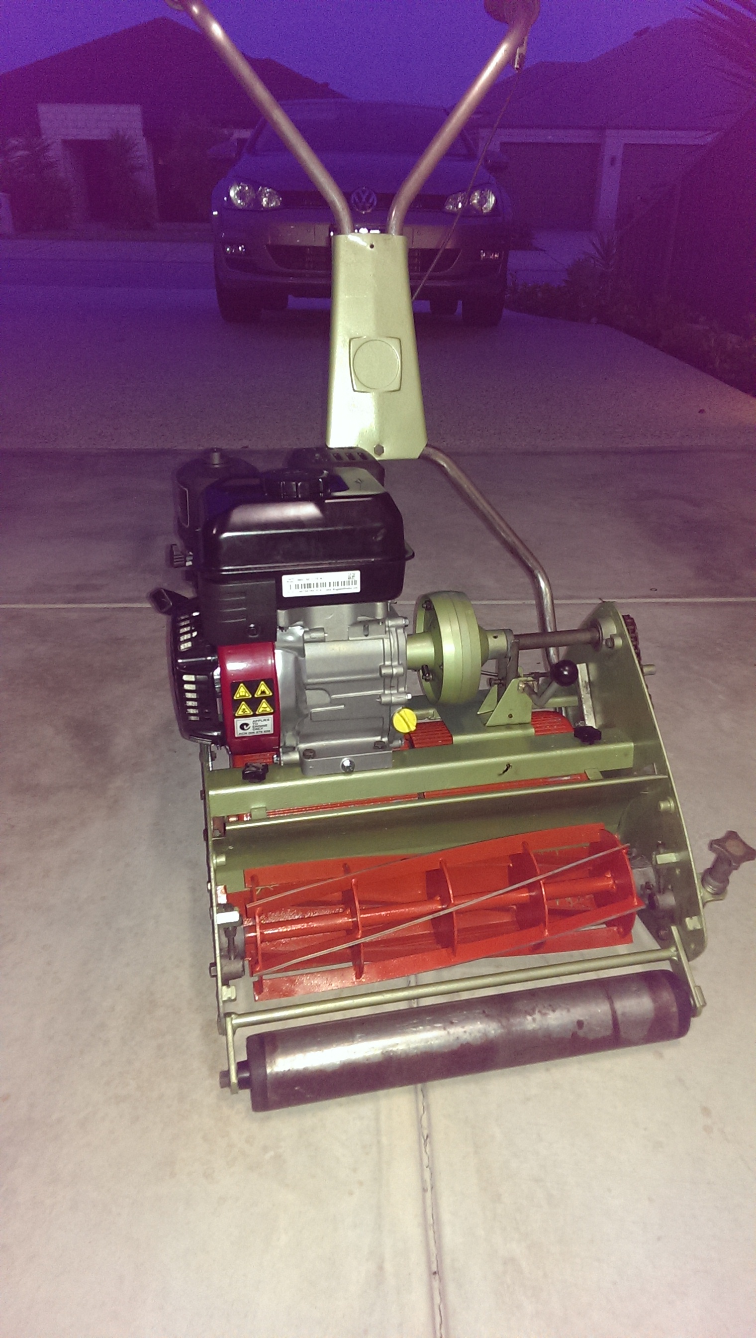

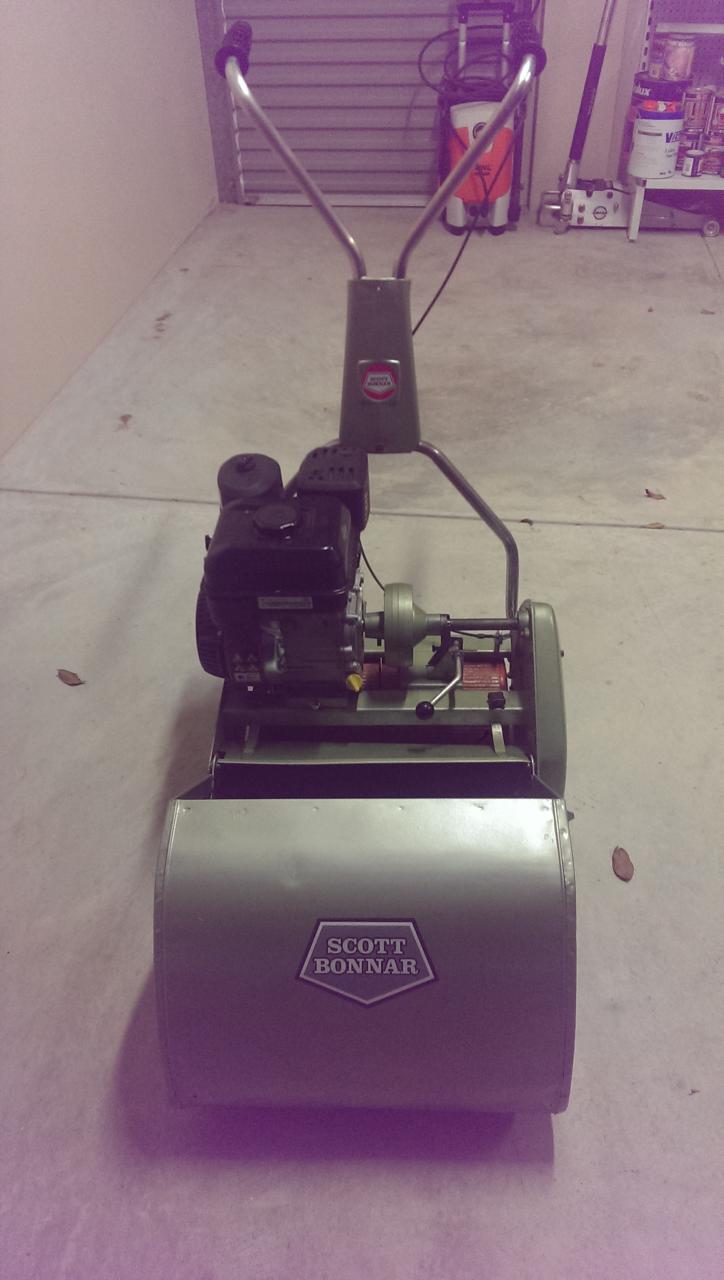

I've starting to put her back together. The Honda GX160 was looking great until I realised that a threaded shaft won't work with the Scotty. Long story short, I sold it, made a profit, and bought a new Briggs & Stratton 3.5hp 550. I should be good to mow my lawn by this weekend.
Mind my dirty fingers all over the paint job...
