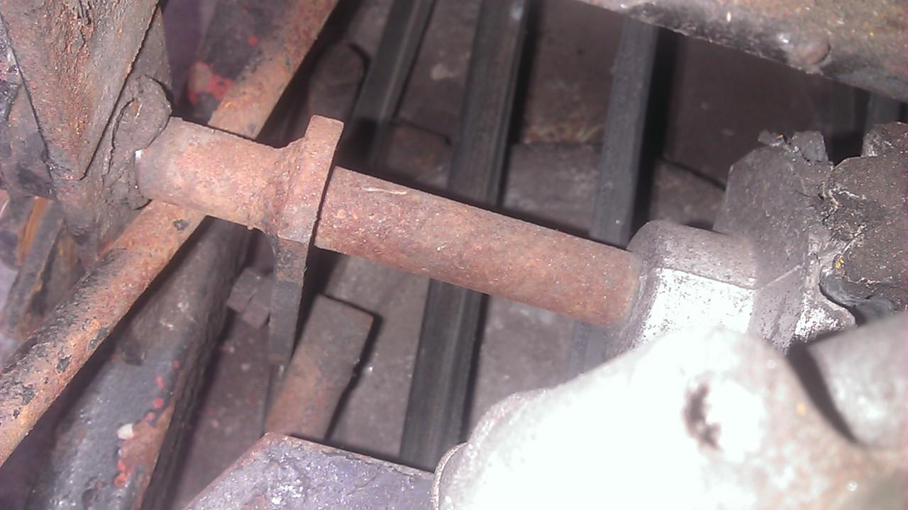

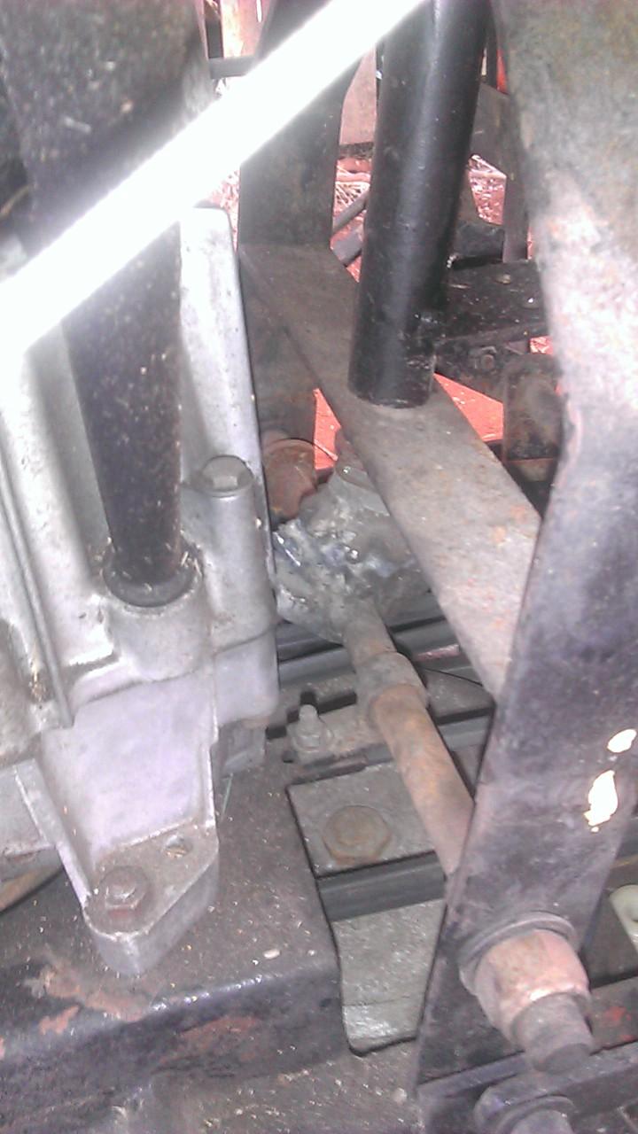

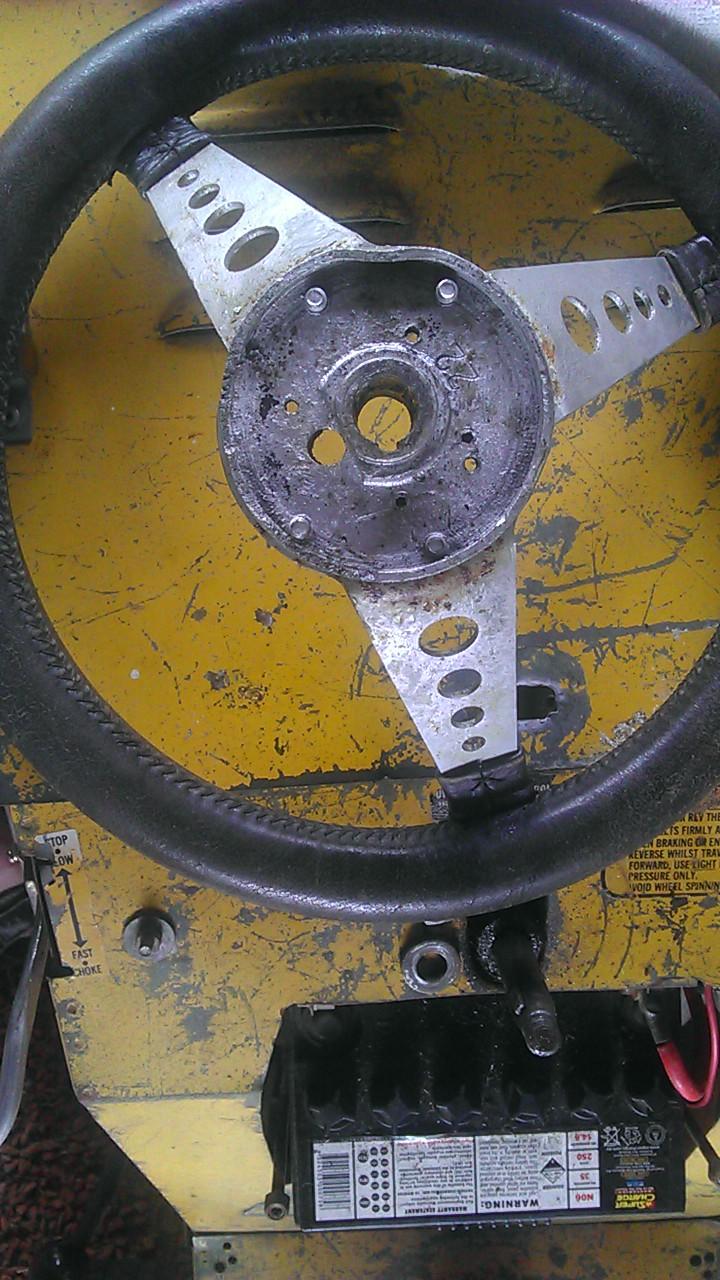

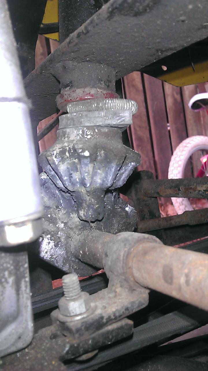

Major drama with this one is steering. 1st steering wheel is broken. ![[Linked Image]](https://www.outdoorking-forum.com.au/forum/uploads/usergals/2014/09/full-8329-17539-imag0145.jpg) 2nd bottom part is just pached looks like something was missing so they put one piece of bent steel and bent rod to fill the gap. I have to remove steering column but I'm not to sure how yet. ![[Linked Image]](https://www.outdoorking-forum.com.au/forum/uploads/usergals/2014/09/full-8329-17540-imag0144.jpg) Also very dodgy engine control here. Maybe because of new engine. Maybe a little bit of slipping gears but I'm not surprised they seem to have had a hard life.

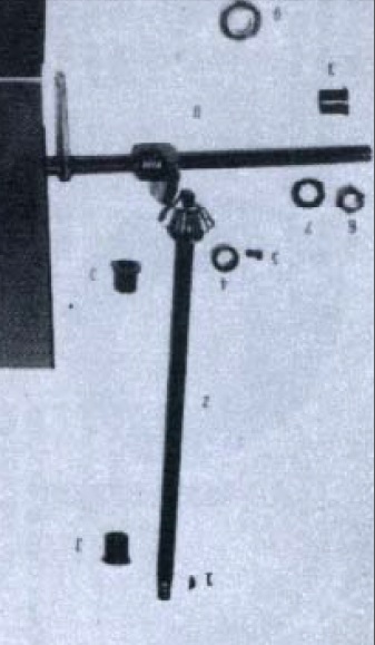

Here is what the steering parts look like in the Illustrated Parts List: ![[Linked Image]](https://www.outdoorking-forum.com.au/forum/uploads/usergals/2014/09/full-2772-17541-greenfield_8_28_steering_parts.jpg) As you can see, there have been some "tenant's improvements" brought about by a previous owner. The purpose seems to have been to space the steering bevel gear downward, so it would mesh properly with the matching gear sector on the cross-shaft. I can't tell from those pictures why this was necessary. Possibly the bracket that locates the bevel gear has been moved up, or the cross-shaft has been moved down (or even both, who knows?). However, note that the Tractor 5, Tractor 8, and Tractors 10-11 used three different designs of vertical steering shaft, so it is possible that a worn-out shaft has been replaced at some point with one from a different model tractor. This is not a problem in any case - if necessary the improvised spacer on the shaft can be replaced with a proper one, without making other changes to the steering. To remove the steering column, it clearly cannot be moved upward because the bevel gear is permanently attached to the shaft. It looks to me as if the cross shaft which includes the matching gear sector has to be removed, but let's verify that. Can we see some pictures of the mountings for that cross shaft please? You will have to remove the broken steering wheel, probably with a gear puller.

Thanks Grumpy. I can see from this. that I'm missing the bracket(4) all together. I will definitely have to remove the all column to fix it. here is more pics of the vertical shift. removing it won't be to hard but i will have to remove the all deck to slide column down.I'm not to sure of when i will be able to do this. but i will take pictures of it when doing so. Right side ![[Linked Image]](https://www.outdoorking-forum.com.au/forum/uploads/usergals/2014/09/full-8329-17544-imag0149.jpg) Left side. ![[Linked Image]](https://www.outdoorking-forum.com.au/forum/uploads/usergals/2014/09/full-8329-17545-imag0151.jpg)
Posts: 6,926 Likes: 10
Thanks for posting those pictures, that has clarified things quite a bit. Item 4 is called "Shaft Collar" (part number GT628) and is a simple spacer of the correct width to place the bevel gear in correct mesh with the mating gear sector on the cross shaft. It is held in place by a grub screw, Item 5. You can either buy one from Greenfield, or make one from a piece of bar or heavy-wall tube. You could obtain a price for a steering wheel from Greenfield as well, though you can probably obtain something suitable second-hand.

Thanks for this. I don't need the all steering wheel as mine have a centre hub screw to the wheel. ![[Linked Image]](https://www.outdoorking-forum.com.au/forum/uploads/usergals/2014/09/full-8329-17550-imag0157.jpg) ![[Linked Image]](https://www.outdoorking-forum.com.au/forum/uploads/usergals/2014/09/full-8329-17551-imag0162.jpg)

You will need new replaceable top and bottom bushes for the vertical steering shaft (the one with the bevel gear on the bottom). It is important that those bushes are always in good condition, or the bevel gear, and the mating sector, will be ruined and will jump teeth.

I suppose you are talking about item (3) when referring to bushes.? Had a little go on it today. Again a little slow to take off and need more gas to climb hill. But reverse like hell And i discover a fuel leak from fuel line near tank so just a new hose will fix it. Can we adjust drive belt tension like e2000 model? As i believe forward is slipping a bit. One more time thanks a lot.
Yes, the bushes are Item 3: Part Number 1179, Nylon Bush.
