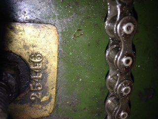

I was obviously looking too hard but the plate was in front of me the whole time but now it changes things.... I think....
I gave the plate a bit if a clean and it appears it is a 12" Minor MK 1 not MK 4....
Now i really cant find any info!
It looks almost identical to the MK4..
Is it the same but earlier? If so how early?
Thanks again for your help!
Marcus

That is significant!
I would like to say with authority what the difference between
the marks were. Alas, I cannot. There were minor changes (pardon the pun)
in the Mk1 thru Mk 5 range.
I do know that the Mk 1 should be pre-war:- an (attributed) 1939 catalogue does show this.
I just can't, as yet, find evidence of their pre-war importation to Australia.
It does make your machine significant to Australian vintage mower history.
I'll let you know as information comes to light.

Hi Marcus,
Yes, I was not aware the MK1s came to these shores.
I'm not the expert on Atco.
Sir Chook is the best Australian authority on these wonderful machines.
The typical Atco 'dogtag' suggests this is of '40s vintage.
I look forward to some pics on the Ransomes.
If possible, the stamped info. on the flywheel (behind the cover plate)
may give a close (approximate) production date.
Cheers Marcus, and thanks for sharing on the ODK forums.

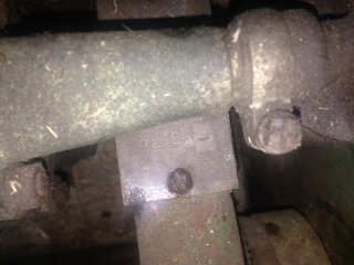

Not a problem, please find the pictures attached... The flywheel data was strange... Ends with a 9...
The front rollers are missing but i think the guy i bought it off of still has them (or so he thinks...)
Hi Marcus and ODK members,
Thanks for the photos of the Mk 1.
The flywheel data does not mean anything to me.
I'm hoping some member might make sense of it . . .
I'm keen to know whether this machine was privately imported,
or sold here. The war years really complicated things.

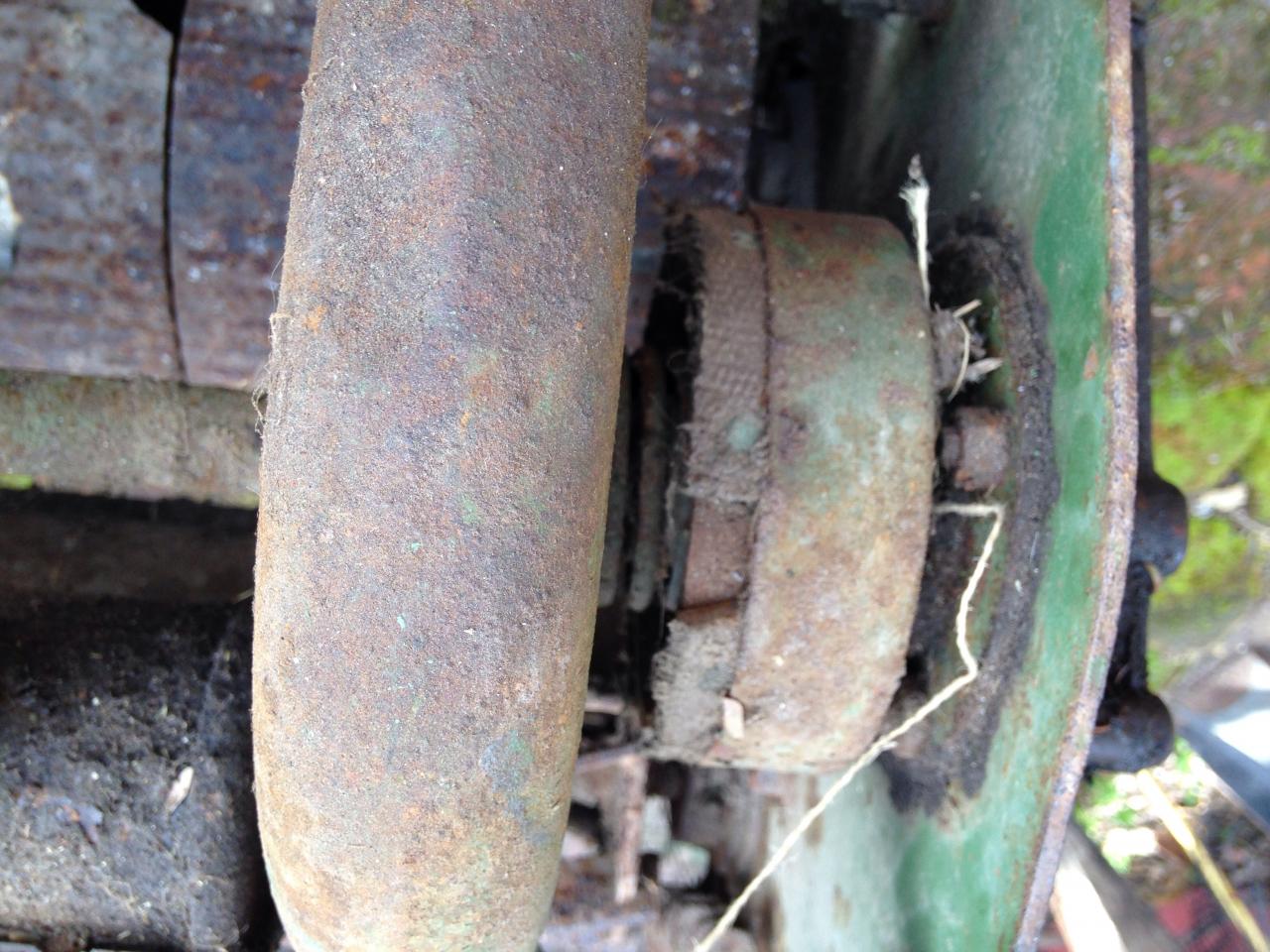

Deejay, i have removed the carby and given the plate a bit of a polish, to get it off is another issue if i end up doing anything about restoring!
Also looks like an asbestos clutch...
Thanks for posting the pics for us mate, just remember to handle that clutch material very carefully if you disassemble the machine...asbestos is very dangerous to your health. I am confident that it could be replaced by cork as an alternative .....Scott Bonnar used cork to great effect. wink

No probs on the Asbestos, i wondered if cork was still an option of am i better off with an asbestos substitute like a softer version of what they use in disk brakes (if it exists!)
Thanks again!
Marcus
Hi again Marcus,
That I could not advise you on, as I don't know of a substitute suitable for use as a clutch lining...most are too soft, and mainly used for heat dissipation. wink

With respect to the flywheel data, this remains problematic.
Villiers, to my knowledge, never intended that there be a public,
logical, codified system of engine identification. The numbers
just might be esoteric and factory specific.
With respect to the clutch. I have no information that asbestos was
ever used in these clutches - these were positive engagement types,
and slippage did not generate the heat that asbestos materials could
handle. They were not brakes. Any replacement lining should be no
problem, if a lining is required at all.
