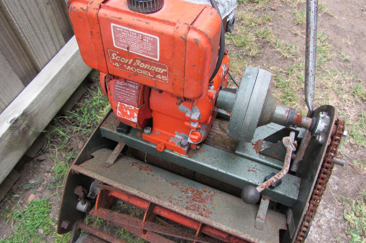

just picked up this bargin & trying to figure yr & model , cant locate engine number , she is briggs & stratton 127 cc 3hp
only plate i see is model numnber 45 06209,
14 inch , solid deck [Linked Image]
, cheers darryl
Hi Darryl, welcome to Outdoorking.
The engine's cooling air cowl, which has the Model, Type and Code stamped on it, is missing in that picture. The Code tells us the date of manufacture of the engine.
Do not operate the engine without the cowl - it will overheat, and the air-vane governor will not work properly. There may be other essential items missing too - in particular, the plastic thrust bearing between the clutch arm and the clutch. The machine needs to be completed before it will be usable.
Hi Darryl, and a warm welcome to the forum. It's always nice to welcome another Scott Bonnar model 45 owner, as we all like to learn new things and tinker here. wink
Your machine is a 14", manufactured at the Thebarton factory in Sth Aust, sometime between 1968 and early 1976, as it has a solid deck. It is a shame that the air cooling cowl is missing; as grumpy has said, that would have given us the date of manufacture of the Briggs, which would give us the approximate date of manufacture of your machine. wink

hi thanks for reply , air cowl is not missing it off so i can replace cord, machine had been su=itting for 10 + years, changed oil, plug, fresh fuel & away it went ,
will check it when home & get some numbers
thanks again darryl
No probs Darryl, can you please post the complete string of numbers (ie, Model, Type and Code) here...
