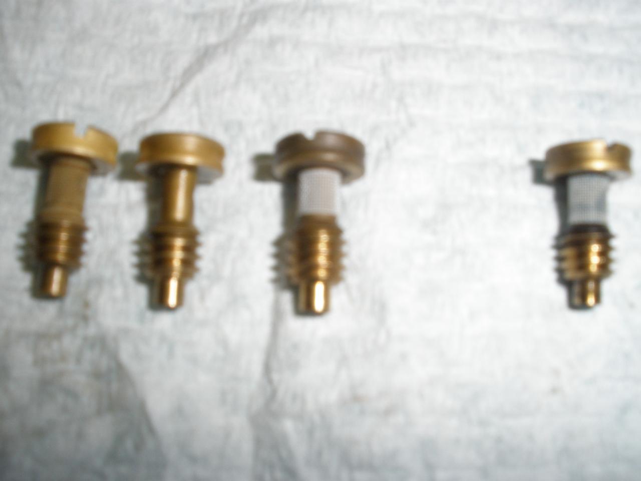

Did some measurements today with a vernier and as far as I can tell the end of the jet go's into the tube in the body (?)
Some pic's:
This is one of the G4 body's.
This is the three jets from "G4's" on left and one from a Powertorque on right. They are all plain faced.
Sorry their not as sharp as I would have hoped.

Bushie, they're all the same jet, off the carbies with the fixed emulsion tube, like the one in the pic. Check the air gap on the coil to flywheel for spark, otherwise try another coil to see if it improves.

So the longer length body. black poppet and the idle screw mean nothing?

The different bodies, and black poppet valve definitely mean something but be careful as the carbs have probably been bastardized over the years. I think the idle screw caps are interchangeable but i can't recall for sure, try them and see if they fit.

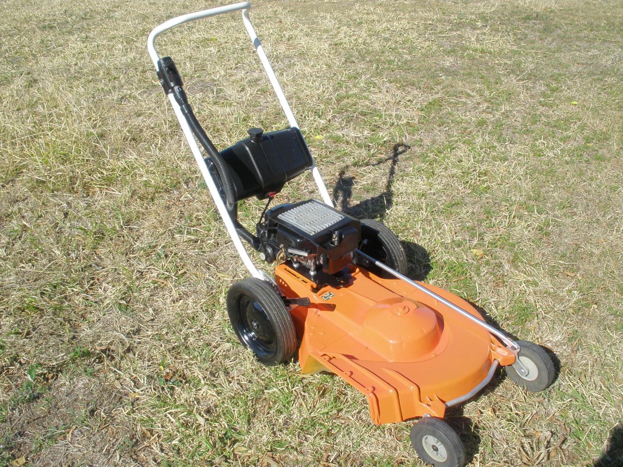

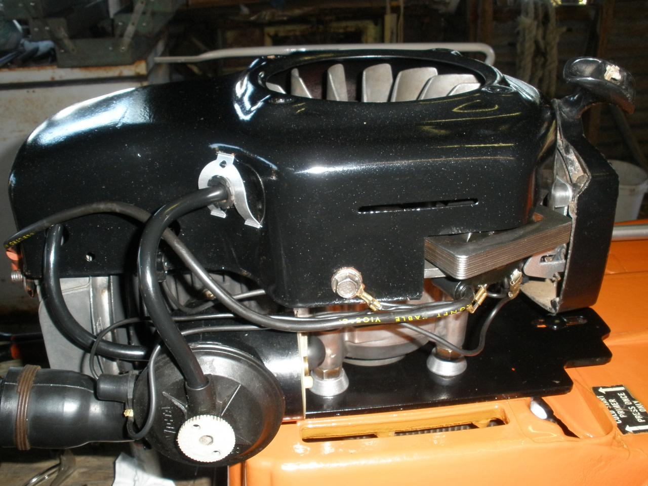

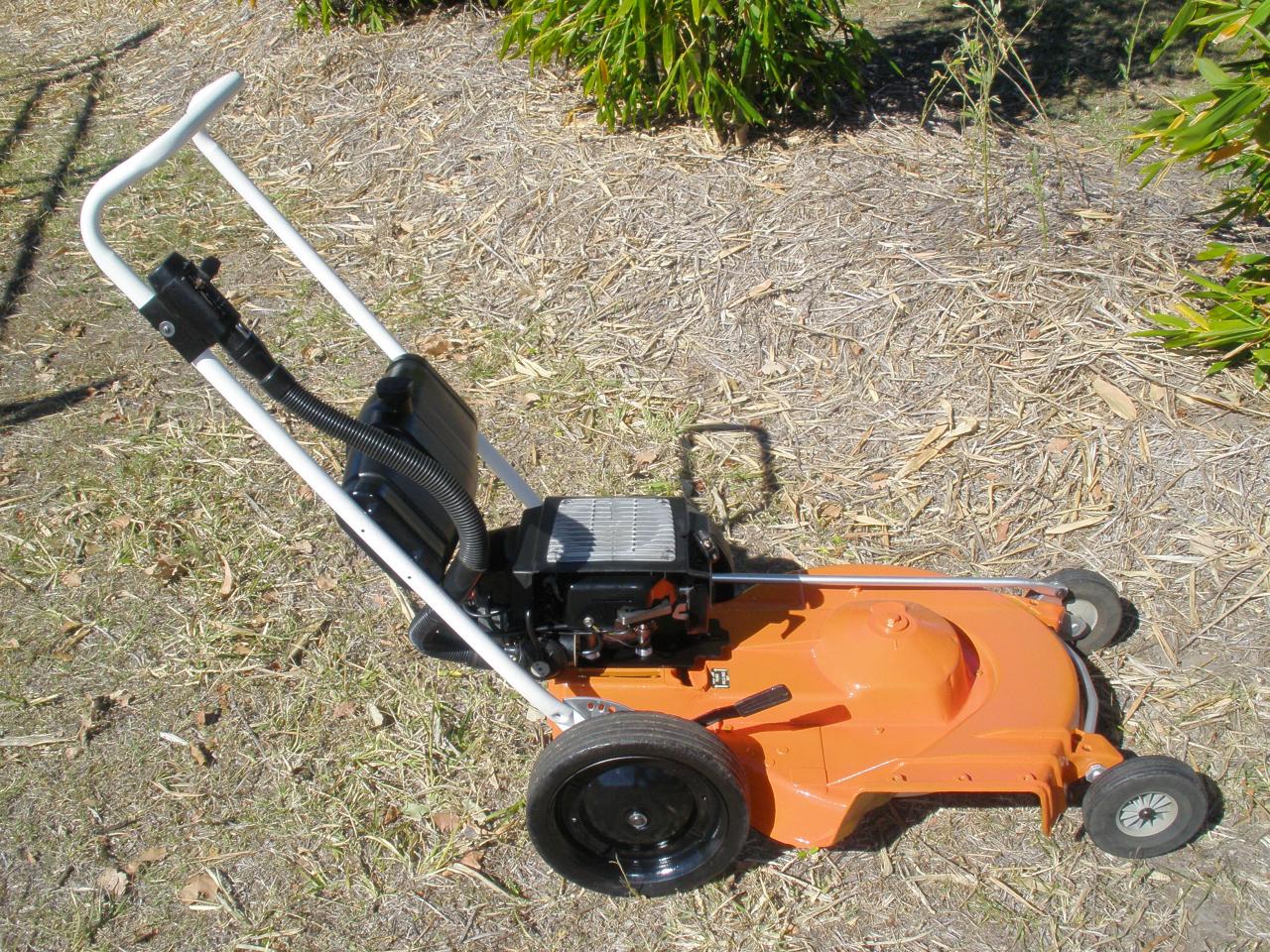

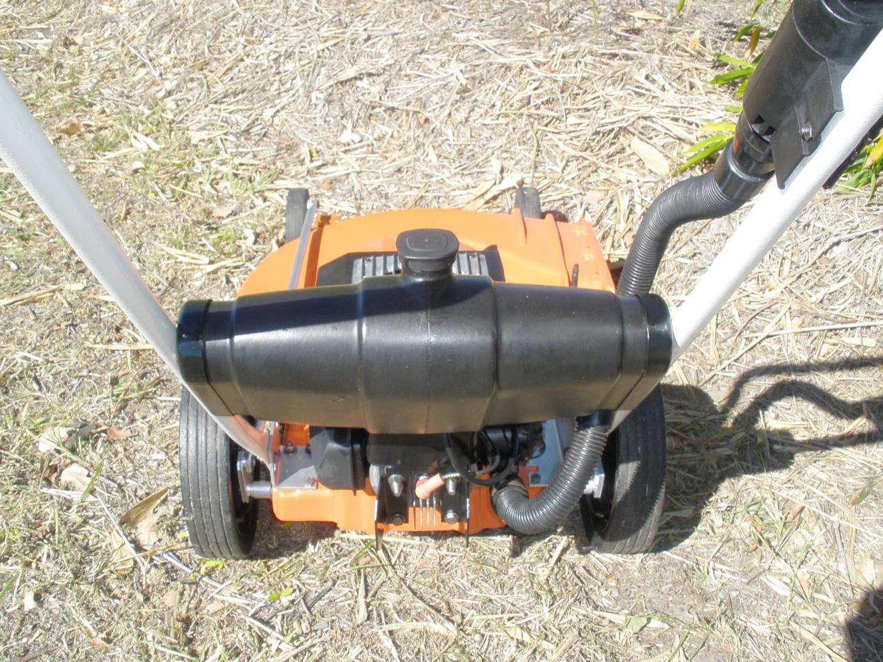

Oh well they say a picture is worth a thousand words:
Still waiting to get the 'windrower' attended to, will probably paint it black, like the '24's', as I'm really over that cheap orange.
Will slash some grass and do a summary soon.
Posts: 959
Well Bushie, i think the end result looks awesome. Well done!
Joined: Mar 2014
Posts: 99

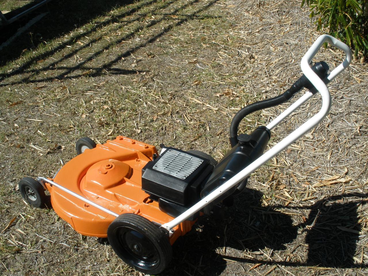

A couple of more shots, maybe never this fresh and clean again.....
then into the work!

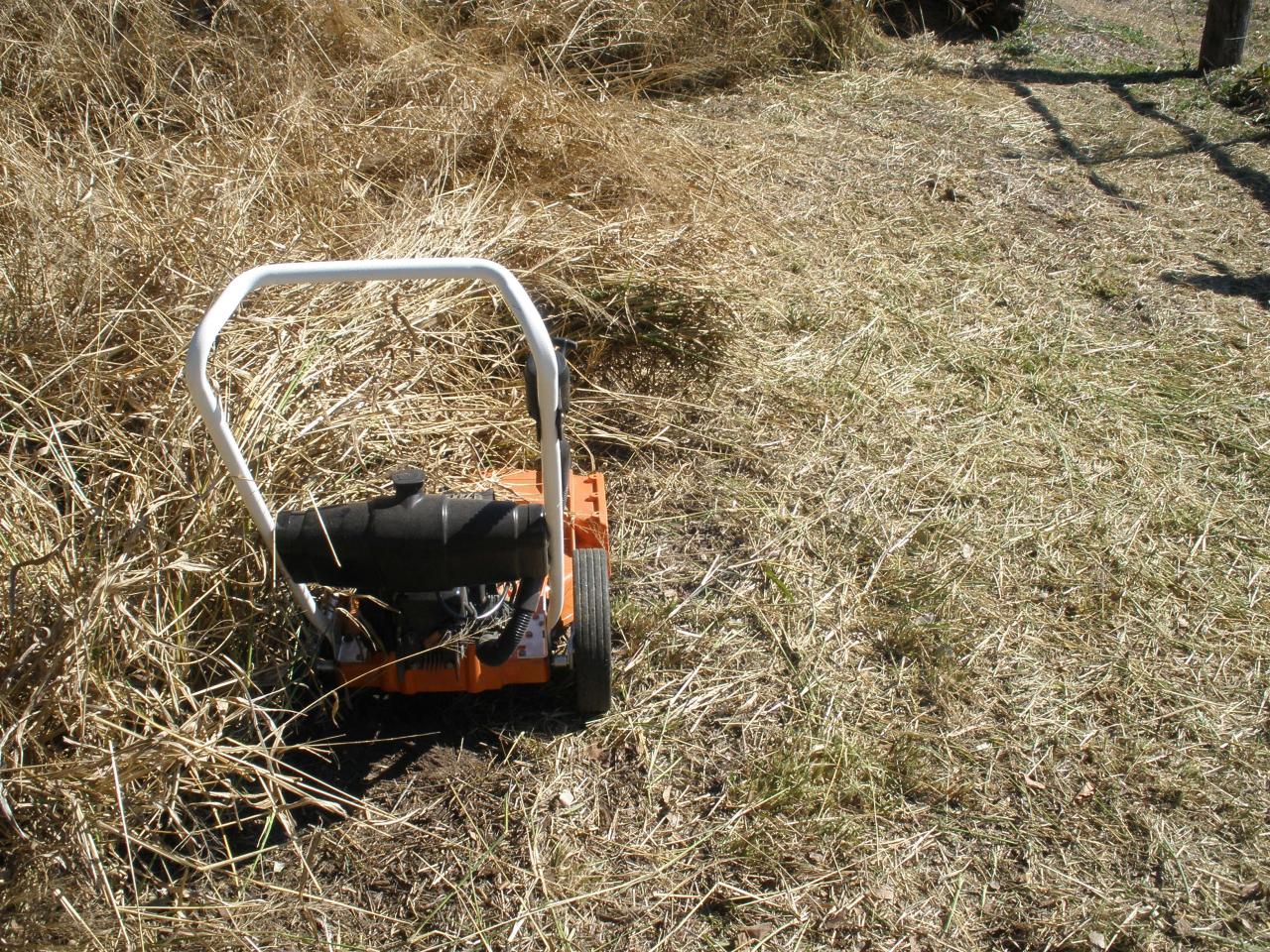

Started first pull from cold again, warmed up for a few minutes then knocked of the tops of some thin grass for 15 minutes, varying the speed, then into the above. Crikey it's got some power! Started second pull from hot.
Tried to adjust governed speed but the revs it was doing was freaking me out, that is especially with no load, and it didn't seem to make any difference.

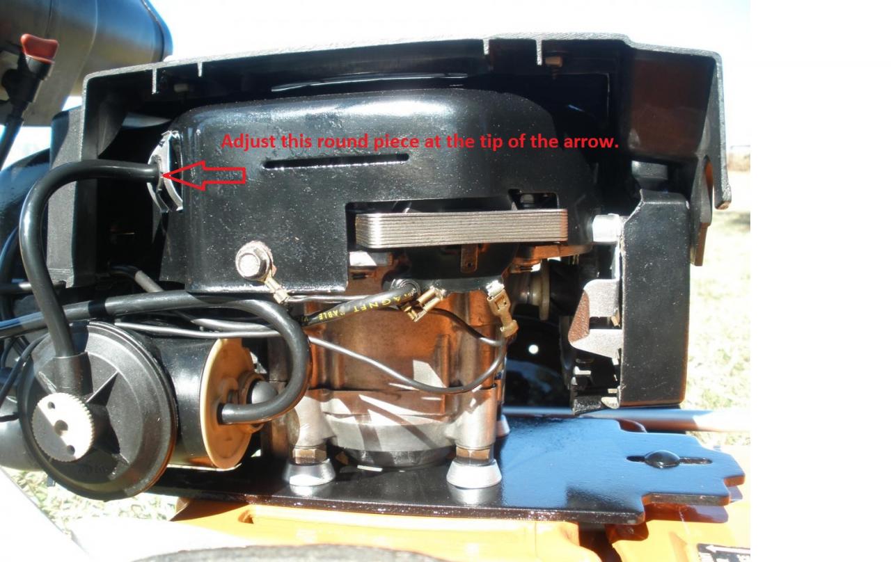

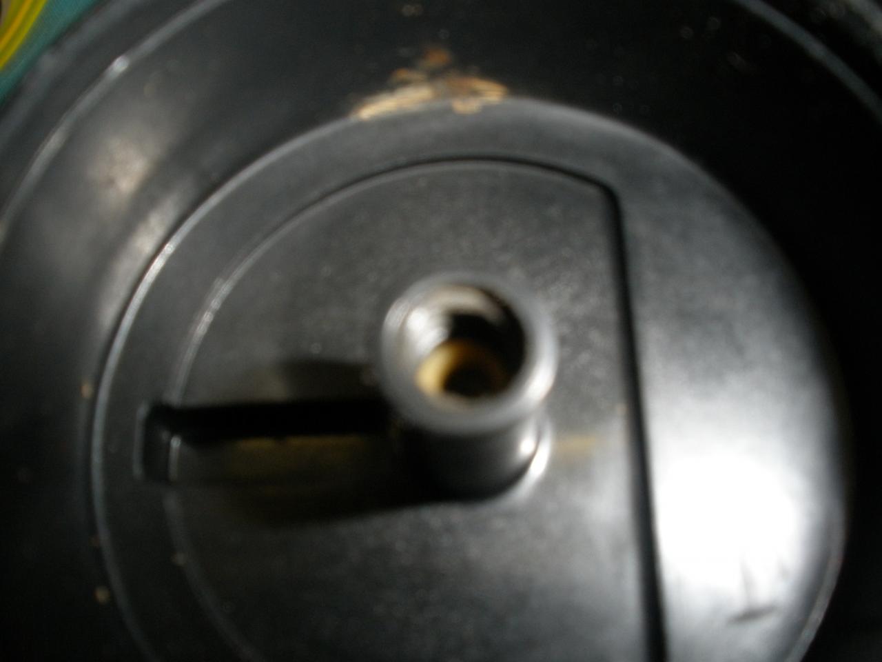

You should be able to knock the revs back by turning the venturi in the cowling where the governor vacuum line connects, just push it in a little and turn from memory, clockwise?? i think. It does not take much to make a difference.

Thanks Luke, very good explanation of what I was trying to do today. Sorry didn't make myself clear in last post. I turned it both ways but couldn't notice a difference, meanwhile the engine was screaming it's a$$ off, which can't be good for the engine. I didn't have the courage to keep persisting with it.

To slow your engine down, here are some other things to try:
# Remove the hose were the red arrow is pointing above. You should not be able to blow air through it (should be sealed by the diaphragm).
# You can try a lighter spring in the carby.
# You can place a shim or shims under the rotating cam inside the carby.
Others here may have more tips, or expand on this post.

Finally got back to look at the Super. Had read, in the meantime, that the outer long spring in the carby would only account for a few hundred revs, was certainly looking for a larger adjustment than that.
First did the test Mark suggested, blow in the governor tube, sure enough air was passing through. Tested another one that was rebuilt, just to confirm the amount of air pressure. Popped the cap off..... yeah the diaphragm was indeed crinkled down, just a little, simple fix.
Gave her a run (second pull start from cold this time) and thought it could rev a fair bit more so turned the venturi control, which Luke suggested. This time there there were definite substantial changes in revs, albeit from sounding to low to to high, probably should have persisted longer.

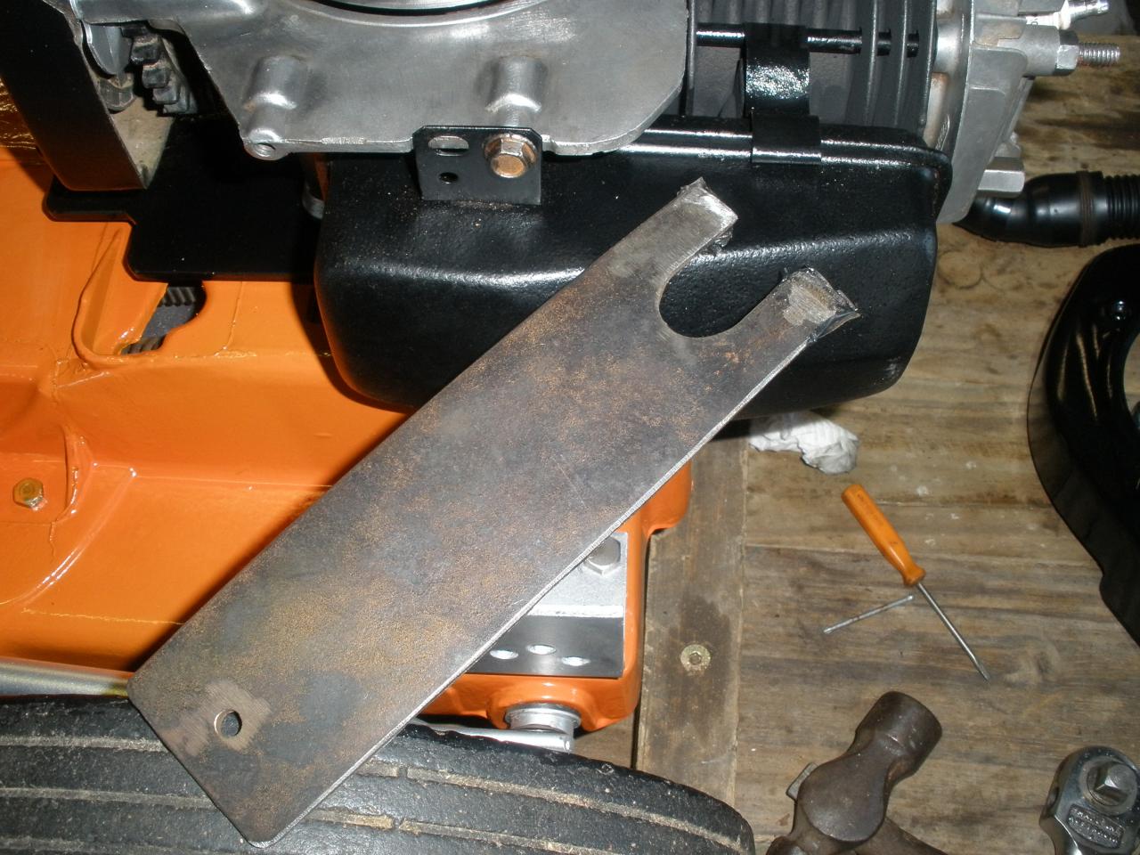

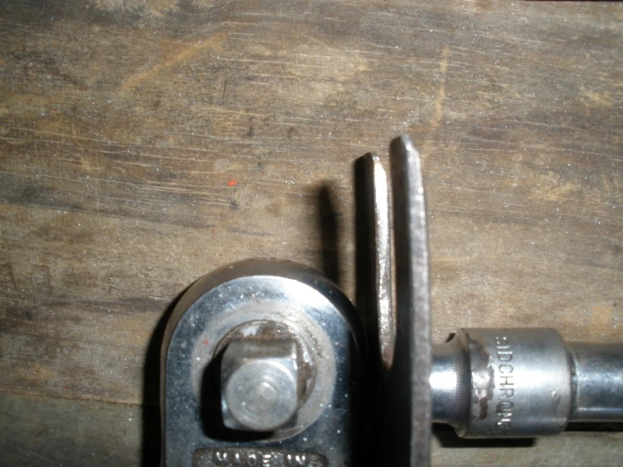

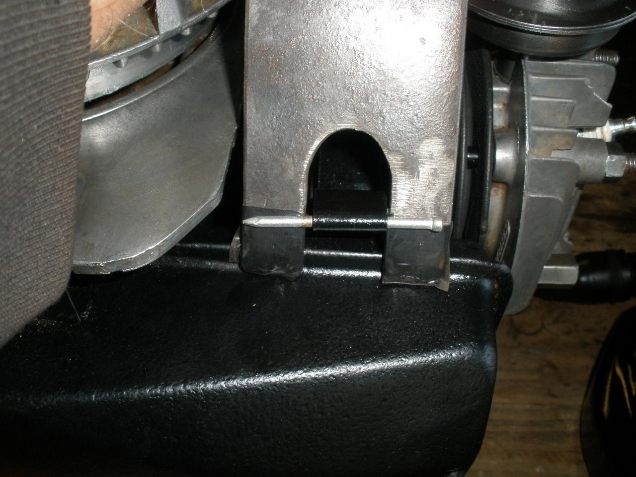

One thing that helped my rebuild was this lever pictured below. Had read on ODK a few folk were having a awkward time remounting the top clip on the muffler.
A small rod is put through the hole in the end of the spring (in this case a nail)
I scraped off the electrical tape on the front side of lever to allow freer sliding of the nail down the lever. the tape was put on to preserve the paint.
This is a side view, the chamfered edge goes toward the muffler to allow the nail to run down. Probably would round this off more, almost to points and up the lever more, before I do another one. I did hold pressure on the lever and tap the nail down, a little on both sides, with a tack hammer.
It works really well!
This idea was given to me by an old time mower repairer.
