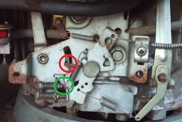

I think we can do better than that, flatlinerz. Please post two pictures into this thread: your governor mechanism with the speed control in the stop position, and the same shot with the speed control in the choke position. The same two shots you posted in PM's to me are the ones we need.
This seems as if it will be easy to put right, though I warn you now, that mower has had unusual experiences along the way before you got it. I'll prepare a couple of pictures to try to explain what is going on.
Joined: Jul 2014
Posts: 11
here are the pics lawn mower is on choke:
[Linked Image from i57.tinypic.com]
Here are pics of the mower at stop:
[Linked Image from i61.tinypic.com]
[Linked Image from i60.tinypic.com]
Thanks
Let's begin with a couple of things about your mower that are irregular by Honda's standards. First, the speed control cable, from the lever on the handlebar to the governor plate, is non-genuine. Whether it works properly depends on whether the lengths of inner and outer are correct. Second, the carburetor is not a Honda one - Honda uses Keihin carburetors, the one you have is a Ruixing copy of the Keihin for that engine. That need not be a problem - so far I have found Ruixing carburetors to work properly and their calibration to be close to the Honda ones. Third, the protective cover is missing from your governor plate. This picture shows GXV120 (your engine) and GXV140 (the engine used on the HRU195) governor plates with the covers in place:
The fourth and final irregularity is the most interesting one: your mower has a Honda GXV120 engine, but it has been fitted with a Honda GXV140 governor plate. Here are the two governor plates, shown with the cover plates removed so you can see the mechanism. First, the genuine GXV120 one:
Here is the GXV140 one, the same as yours:
The GXV140 one has an extra mechanism not found on the GXV120. The GXV120 has just one screw adjustment, to stop the choke from being closed too far, and potentially damaging it. The GXV140 has this same screw adjustment, but it also has another one. The second screw adjusts the maximum governed engine speed. As an additional sophistication, the GXV140 governor plate reduces the maximum governed engine speed when the choke is operating. Generally the GXV140 governor plate is superior to the GXV120 one, though the extra features may make the governor more difficult for an amateur to set up.

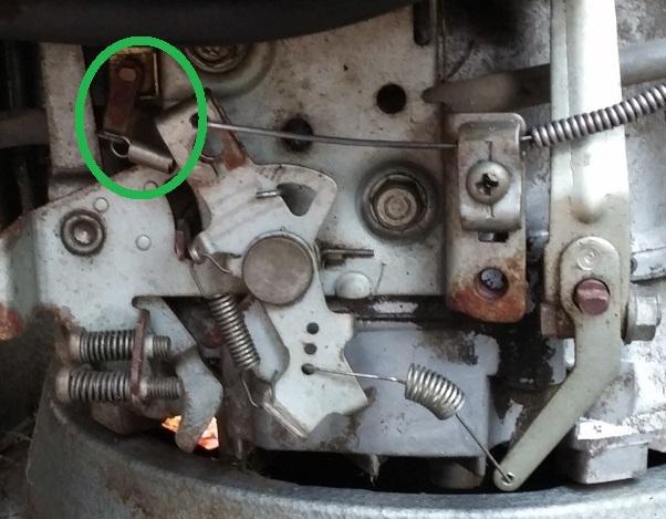

Now, let's talk about how to adjust the governor plate so that your choke closes correctly. The choke is operated as follows. Look at this marked up version of the GXV120 governor plate:
Look first at the green oval near the top of the picture. This is the top of the choke operating bellcrank. A wire link runs from the hole there, to the black plastic bellcrank on the choke butterfly on the carburetor. The hole in the green oval needs to move to the left by a precise amount, to close the choke. Here's how it is done. Look at the yellow circle. The yellow circle shows a tab on the same bellcrank that operates the choke. So, if that tab is lifted upward, the choke closes. Now look at the bottom green oval. That is around a tab on the speed control lever (which is operated by the speed control cable). When you move the speed control lever to choke, the green tab moves upward, snags the yellow tab, and closes the choke. Now look at the red oval near the green one, on the speed control lever. It shows a mechanical stop. When the choke is fully applied, it moves around and hits the end of the adjusting screw in the other red oval.
Here is your latest picture of the governor plate on your engine:
The green oval shows that the speed control lever has not moved all the way until its mechanical stop hits the adjusting screw. If the adjustment of that screw has been correctly set up, the choke is not closing fully. To verify that this is the actual situation (the stop-screw adjustment is correct, but the speed control lever is not moving as far as it should), we need to know whether the choke is fully closed when you put the speed control all the way, as far as possible toward choke. To do this, see if it is possible to lift the tab in the red oval on that picture, or rotate the black plastic choke bellcrank even slightly anticlockwise, when the speed control is on full choke. If so, your choke is not closing fully, and it will need to be adjusted. We can talk about how to do that once you verify that it needs to be done, by checking whether the choke closes at present.

Ok so I tried lifting the tab in the red oval on the pic above and yes it when I lift it it goes all the way up but when its in choke it doesn't move all the way up so I'm guessing my choke is not closing?
That's right, flatlinerz. Those engines will not start in winter without full choke, so that is at least one thing that has to be fixed. Please clarify, though: when you lift the tab, it should move up until the black bellcrank on the carburetor has moved all the way anticlockwise, but the tab should not move all the way to the top of its slot. If it went right to the top of the slot, there would be something wrong with the wire link between the bellcrank on the governor plate, and the bellcrank on the choke.

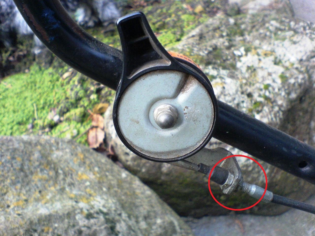

So, the choke is not closing, due to the speed control cable inner not moving far enough when in the choke position. There are two ways to adjust it. The preferred way is to lengthen the cable outer, by adjusting these nuts at the speed control lever on the handlebar:
Please post a picture of the same part of your mower, so we can assess whether it has enough remaining adjustment to fix the problem. If it does not, we'll have to resort to the non-preferred approach.

Ok mine is different to the pic above it does not have that part. Here are mine.
[Linked Image from i59.tinypic.com]
OK, that is a universal aftermarket speed control that is part of the aftermarket control cable. You may not be able to get a perfect result with it.
