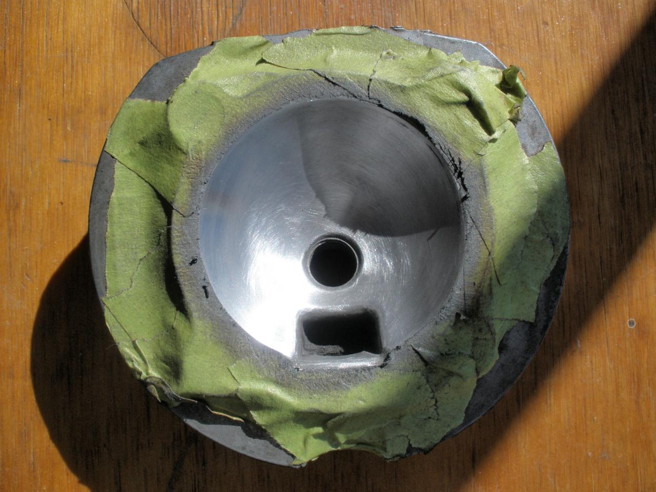

Had a go at a full crank head, didn't want to start on my head off the 600.
I gave it a soft steel wire brush out to get rid of the carbon, then used emery down to 240.
Where should I go from here?
Should I take out all marks/imperfections such as the one about 1-2 o'clock, right up near the machined edge, then polish with something?
Cheers.

I stripped and painted the frame, to give those parts plenty of time to dry, before starting on the engine. Was hoping for a reply to the above but went ahead anyway and polished the HC head down to 400 wet & dry.
Pretty happy with the result, but any further advice would be appreciated. Have now started polishing the exhaust port and tidying up the inlet port up. Oh, and sanded the machined part of head to 250 on glass.

Your HC head looks great, I normally just remove all the carbon, make sure I have a good mating surface and they run fine, I have cleaned them up before better than that, never done one as nice as yours above.

With the head, figured the 'shinier' it is the harder it would be for carbon to build up. Still not as good as Chris125's though. The exhaust port is coming along well too, but wish I had a Dremel.

Ground down casting marks and polished with stones and various other bits of 180, 240,320 and finished with 400. The foreground is not as good as this pic looks, with the light reflection, but the barrel end sides and the 'dip' is a fairly good representation. Looking into the bore you can make out the cross hatching, if that's a term, of hand (three finger) honing, as I don't have a honer yet.
Below is the inlet.
Just used a small stone to remove some casting irregularities and 180 grit. couldn't get into the sides of barrel end very well, a Dremel is definitely on the list before attempting another.
Heat proof painting didn't adhere very well, probably due to final clean with turps instead of metho. ??
Comments welcome, including critical analysis, as trying to learn here.

I am not the guy to ask about porting, as I normally just scrape away all the carbon in the exhaust port and pretty much clean the inlet port.
I have read and since forgotten about chamfering the ports on the barrel side after your work, so that the rings wont catch. Cant give you any fine details there.
