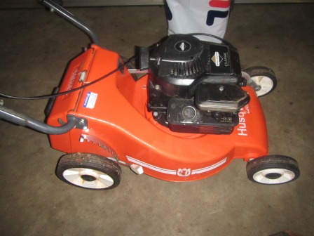

I recently acquired this Hasqvarna Push Mower that seems to be a pretty decent quality unit.
The mower is now running nicely and with a full service it will no doubt run even better. The only obvious fault was the starter clutch however that�s now working spot on after a little TLC.
Where I am after some assistance is with the blade bar. It is stuffed. See the photo�s.
I have tried searching through the outdoorking online store and cant find anything to suit. I have also searched ebay and no luck.
I am hoping someone can point me in the right direction as this will be a really good mower when its done. The frame and catcher are in great condition.

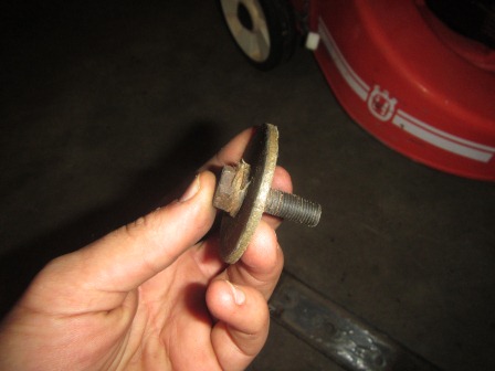

Yeah, i had a look at the bynorm and GA spares catalogue and couldn't find anything remotely similar. Although from your pics its hard to tell what's wrong with the blade.
Retrofitting is not a problem but there are 2 main things to consider, cutting width and how high up the pan the new assembly will sit. We need to see the boss to see if it has a deep spacing or a shallow one. Judging by the 2 bolts in your photo i'd say at least 10-15mm beyond the bottom of the crank.
Also helps to know if the crank has 1 or 2 keyway slots as that will help eliminate the types of bosses we can and can't use.

Theo, there is nothing wrong with a blade bar with the exception of a fair bit of wear.I get the drift you think it could be tidied up on the grinder and still perform well?
Or best to go with a new bar as VC Victa suggested?
Posts: 961
Nothing beats the cut of a new blade but I think you can clean that up and save some money. It doesn't appear to be beyond repair.
The key is to go nice and easy on the grinder so it doesnt get too hot and compromise the integrity of the steel. It is a bar blade after all and unless it's bent, damaged or broken it's made to be sharpened.
Bar blades need to be sharpened regularly, and yours has been neglected: it looks very blunt. Remember to balance the blade as you grind it, and remember you must finish up with a straight cutting edge, not one that curves back as you move toward the tip.
Personally I do not regard bar blades as a competitive cutting system, compared with swing-out blades on a blade disk. The quality of cut is inferior, they get blunt too quickly, they are dangerous to use, and they cost too much to replace. My favourite mower is an early 1980s Honda, and it had a Ninja blade when I got it, but now it has a 4 blade disk system from an HRU model. The cut is just incomparably better, and it is a lot easier to maintain. Better yet, it was a straight bolt-on modification, using only Honda parts (which were junk from a dead mower). I don't know if there is a readily available conversion for your Husqvarna, but in my opinion it would be a considerable improvement if you find one.

G'day Jaffa, I have recently sharpened and balanced one of these and it came up fine.
It was in the same condition as yours.
My method is to use a bench grinder and a nail I have hammered into the side of a cupboard to watch my balance as I go.
You can also use one of these below for balancing.
I use a screwdriver shaft through the central hole in the bar blade for balance, and a 14" flat disk (36 grit size) for grinding, because the very coarse grinding material reduces the heating of the steel. An angle grinder will also do the job properly if you are careful and go slowly. However in essence the rule is, you use what you've got. Just don't let the blade get hot. If it's gone blue, it's gone soft. Grinding off the blue doesn't grind off the softened part, the blue is just the oxide layer on the surface of the metal.

Thanks guys. Again I appreciate the pointers. I put the mower back together today and took if for a run in the long grass and it performed pretty well for an older unit. Starts first pull and only blows a little smoke on startup. I ended up sharpening the blade on my bench grinder as best as I could being very careful to ensure it didnt get hot. I took the softly softly approach.
The mower performed well but I didnt take the catcher with me. It took down some relatively high grass. Tomorrow I'll take the catcher with me to ensure it gives a nice clean cut before throwing some fresh oil into it.
