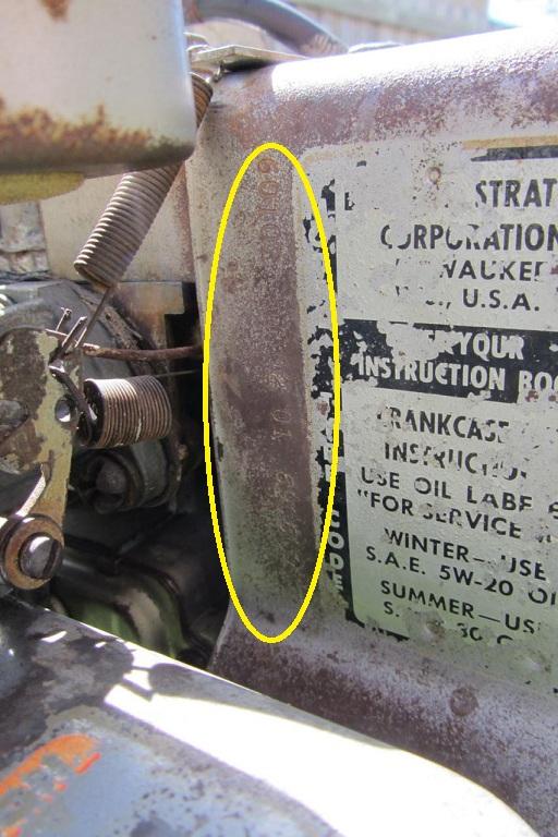

Hi SBM45, and a warm welcome to the forum. It's always great to welcome another Scott Bonnar model 45 owner on board. grin
Your machine is the Series 2 (twin rail engine deck) Model 45 made in the SB Thebarton factory in South Australia.
If you could post the model, type and code numbers stamped into the metal air cowling of the B and S engine, we can give you an approximate age of your machine. The numbers are in the location usually near the intake manifold...please post the whole string of numbers. wink
As far as the chains and sprockets are concerned, I would need to see a close-up of the sprockets, where they are not covered by the chain, so as I could assess their condition for you. wink

Joined: Jun 2014
Posts: 41
Hi Darryl,
Thank you for your warm welcome. Happy to be part of this forum family.
Will get a photo of all the numbers. Not sure if this black coloured case cover is the original cover??
Got my inspiration from my fathers Scott Bonnar. Will post some pics of his joy and pride.
Hi SBM,
Thanks for your reply and I'm looking forward to seeing more pics! grin
It will be interesting to see if that is the original cowling....we may be able to tell from the numbers. wink

Hi SBM,
I think the Victa sticker on the air-cowling might be a dead giveaway plus the B & S signage that is upside down and the pull handle position, that this is definitely not original to this machine....In fact it came from a vertical shaft engine, manufactured in 1991. wink

Hi SBM,
That is the way Briggs and Stratton have done it for years...if the recoil starter can be repaired, there should be no reason (other than external damage) that the air-cowling should part company with the engine. I suppose they have to put the ID info somewhere. wink
Hi guys,
I guess that the cowling was the cheaper alternative, as to stamp into cast ally would be risky of fracturing the casting and the cowling is made of steel. Just my opinion.
BB
