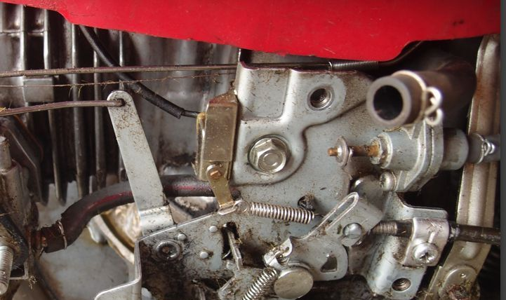

Well, we are getting further ahead. Can you post some pictures of the leak please?
If it is a cylinder head gasket leak, it may be either because the seal around the combustion chamber has blown, or because the oil passage to the valve gear is leaking. It is important to know which, and pictures may tell us, particularly if you clean the area, then make it leak and photograph it immediately.
I customarily address these problems in the Sherlock Holmes manner, by tracing cause to effect. If the cause were over-filling with oil, I do not think it all that likely that the result would be a blown-out top crankshaft seal: in my experience those seals are not all that easily pushed out, while some of the engine gaskets are relatively easily blown. I have seen this problem before, though on a copy of a Honda not a real one (the copies are called "chondas" here in honour of their country of origin) and the symptoms so far are reasonably similar - however oil came out through a multitude of gaskets on that engine, not from under the engine's red plastic top cover, as it would if the top crankshaft seal were leaking. My first guess would be that the excess oil that was in your Honda has caused oil to flood through the PCV valve into the oil-separating compartment under the flywheel, and (probably temporarily) caused the valve to stop working, thus pressurising the crankcase and forcing oil out from the point of least resistance. If it couldn't go through the PCV valve, it had to blow a gasket or a seal. In that other case, the oil began by coming out past the gasket around the cylinder head's valve gear oil passage (underneath the head, not on top of it), but as the mower kept being run, it started coming out from the crankcase cover and the bottom oil seal as well. You can help resolve this possibility with your engine, by pulling off the rubber breather hose from the bottom of the air cleaner box and seeing if there is oil in the hose. If there is, it is consistent with my guess, though it does not confirm it. Incidentally, please do not run the engine for long, since if it is generating pressure in the crankcase, it may blow a gasket rather than cause one to leak temporarily. This is more difficult to fix.

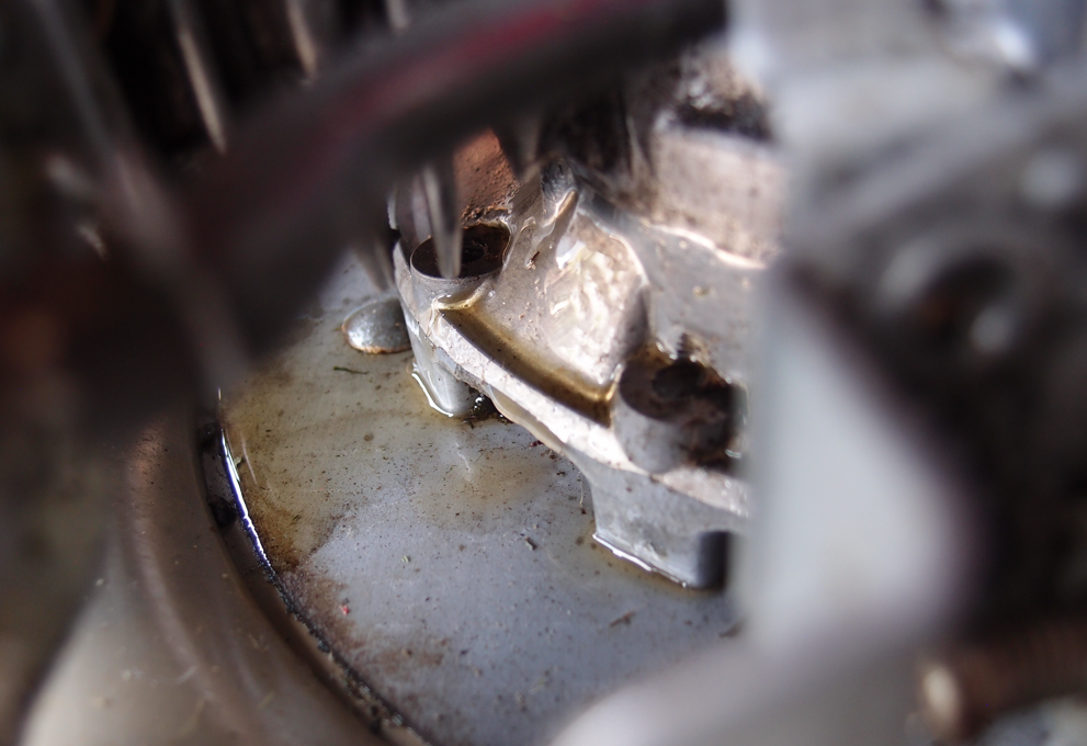

I am glad you encouraged me to do some detective work.
I cleaned the area and then ran the engine for about two minutes.
The leak is coming from the oik pan gasket in the same are where I though I had seen the it dripping from the cylinder head. The cylinder was dry, no leaks there. I then cleaned the area and ran the engine for just 10 seconds or so and confirmed the source of the leak. Its possible that I might see another leak if I ran the machine longer. Here's a pic
https://www.dropbox.com/s/ozssx8it90my8wc/GXV140Leak1.tiff
OK, now what? Tighten bolts? Replace gasket? It seems gasket is discontinued for some reason. Anyway, does this mean I have to get the engine off the frame. I see five nuts at the bottom. I guess I have to remove blades and clutch and any cable. Any guidelines on how to remove clutch??

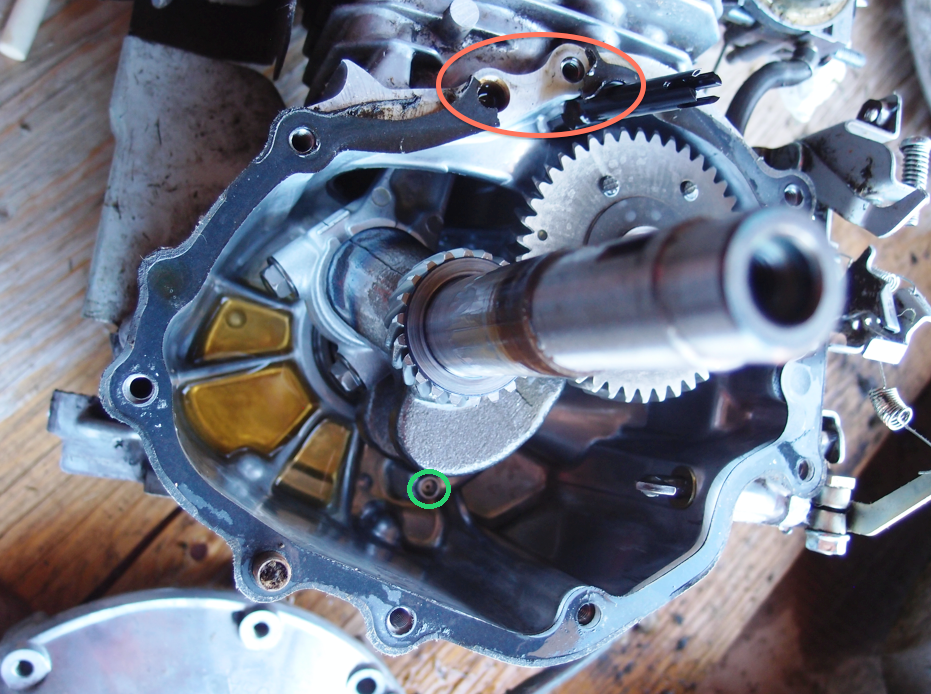

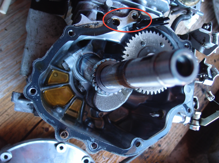

Unless the engine has been dismantled at some time, it is unusual for a Honda to leak oil through a gasket. I suggest your next step should be to read through these two threads:
https://www.outdoorking-forum.com.au/forum/ubbthreads.php?ubb=showflat&Number=49392&page=2
https://www.outdoorking-forum.com.au/forum/ubbthreads.php?ubb=showflat&Number=52741#Post52741

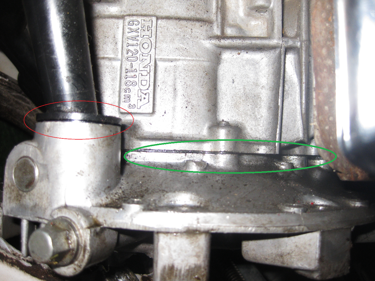

At the moment I'm having some difficulty finding the joint face, where the gasket is, in your picture (though I see the oil of course). Is it the gasket inside the green oval in this picture?
(That picture is of a GXV120 not a GXV140, but the crankcase cover is the same part, and the cylinder/crankcase is the same except for the bore diameter.)
If it is the crankcase cover gasket that is leaking, we still have the question of why. Did you check for oil in the rubber breather hose? If the problem is a stuck PCV valve, you cannot cure it by increasing the clamping force on a gasket: all that would do is cause it to leak through another gasket. On the other hand if the engine just has a loose crankcase cover, and the previous over-filling with oil had nothing to do with the problem, tightening the cover bolts would probably be a complete cure.

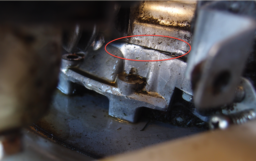

Yes it's the gasket in the green oval in your. Here's another view of the same leak
[img]https://www.dropbox.com/s/5ukfhhu367zxxjd/GXV140Leak3.tiff[/img]
Its dry above the gasket line, wet below. I don't see anything anywhere else so the oil in the pic is from the oil pan gasket. And the rubber breather hose is clean. See pic
[img]https://www.dropbox.com/s/c6a749hj00pkbg1/GXV140Leak4.tiff[/img]

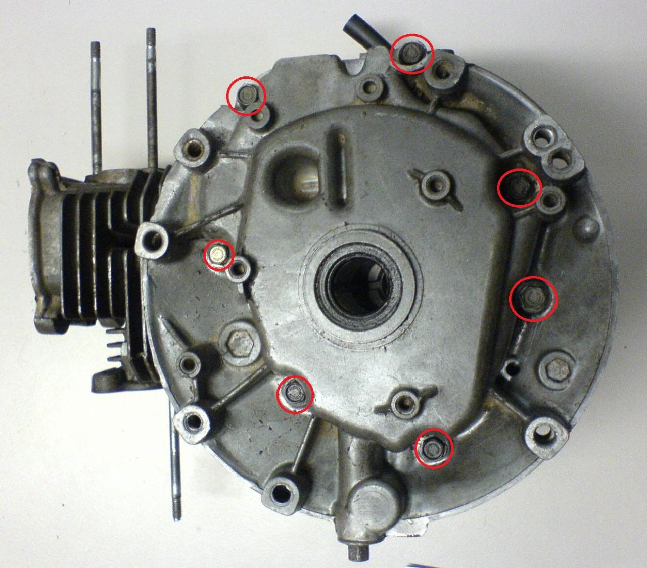

kurb #55987 27/05/14 09:26 PM
The crankcase is secured by 7 bolts, circled in red in the above picture. They should be torqued to 9 lb ft (12 Newton-metres). Torque them all to just 3 lb ft first, working diagonally, then increase to 9 lb ft, then run around them circumferentially to ensure you haven't missed one. Pay attention to whether any of them is substantially looser than that, and report back please.
On the Honda mowers I'm used to (bear in mind that the Australian versions mostly have no clutch or brake) the engine is held to the mower base by 4 bolts, which go into tapped holes in the crankcase cover. I haven't seen one with belt drive to the transmission, but it sounds easier to deal with than the propellor shaft coming out of the crankcase cover that I am used to.

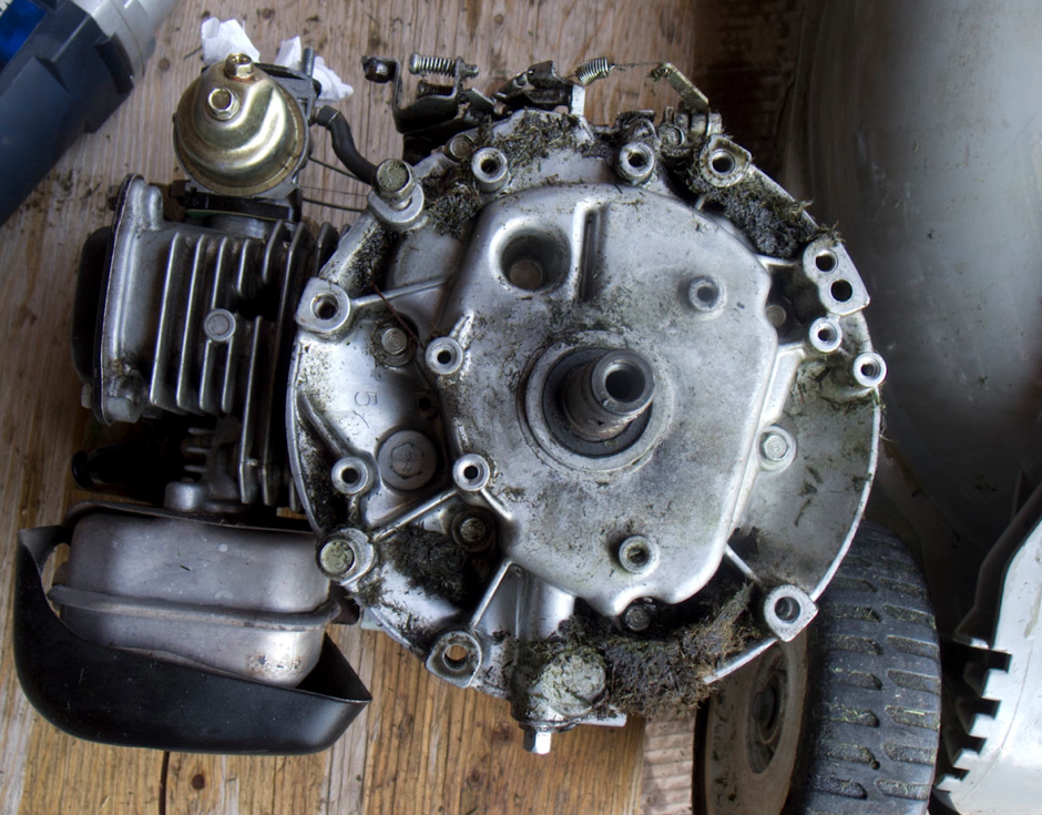

I finally got he engine out. See pic
[img]https://www.dropbox.com/s/r39qtxow3ik8kl5/GXV140Leak6.tiff[/img]
So one of the bolts(near) the leak was looser than the others, so I think that this is the culprit. Since it was such a bigger to get the whole thing I am wondering whether it makes sense to replace the gasket. Actually, they don't make these gaskets any longer. Honda dealer told me to use product called "Honda Bond". It's a silicon based glue, costs about $10US per tube. Not sure that its worth the extra effort/risk.
I am thinking that while I have the engine out I should test for the leak. Put some thin oil in and blow through the filler hole (if necessary) to precipitate the leak. Then tighten the nuts and see if that fixed the problem.
It was quite a bugger to remove the two nuts that holds metal base plate to the oil pan, even with an impact wrench. Do you know what the torque for these two nuts should be? I have to find me a torque wrench somewhere for both these nuts and the oil pan. Honda dealer said that the torque for the 7 nuts was 7.8 lbs. Thanks, kurb

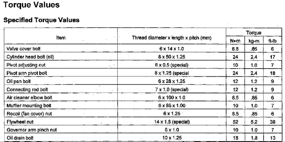

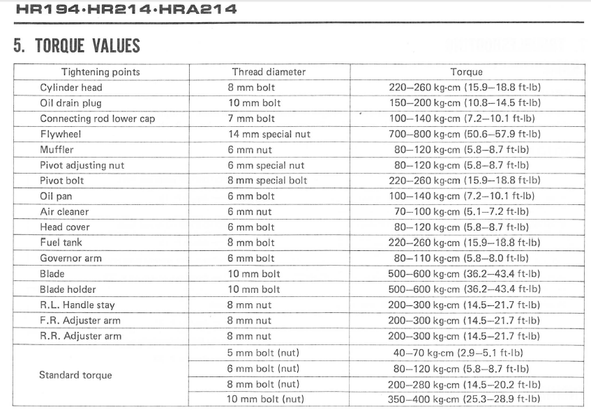

Here is the page from the on-line Honda GXV140 service manual, showing specified torques for the most important bolts:
I think your dealer looked up Honda's standard torque for a 6 mm bolt (7 lb ft unless otherwise specified), rather than looking up the actual bolt.
I don't know where the rumour that the crankcase cover gasket is unavailable, came from. The part number is 11381-ZG9-T00. Here is a US dealer listing for it:
http://www.2lcstore.com/catalog/item/4771015/4843300.htm
The crankcase cover, and the gasket, are the same as for the Honda GXV120 engine, which is still in production, so it would be unlikely that the gasket would be discontinued. I suspect whoever told you the part was not available was looking it up in the wrong way. The GXV140 engine went out of production in 2003, so some of the parts listings for it may be getting a bit erratic by now, but the majority of the parts are the same as GXV120 ones.
Never substitute sealant for a gasket on a small engine's crankcase cover. On Honda and Briggs engines in particular, the thickness of that gasket controls the end-float (i.e., axial slack) of the crankshaft. The sealant has a compressed thickness of almost zero, versus about 1 mm for the gasket, so you would be reducing the end float by 1 mm. I don't know of a specification for the end float of the GXV140 engine, but for the GCV160 it is 0.1 mm to 1.0 mm. Unless your engine is fairly worn, it might have negative end float without the gasket, which would cause it to lock up and refuse to rotate when you tightened up the 7 crankcase bolts. Some engines (in particular, Honda's OHC mower engines, which are for "residential use", compared with the OHV engines like yours being for "commercial use") originally use sealant instead of gaskets, and of course the crankshaft end float is designed accordingly. You should always use the parts specified in the original design, unless you are planning to experiment with a modified engine design for some reason.
When a gasket has leaked, it is good practice to replace it. In this case, when you have the engine out of the mower and can replace the gasket with very little work, it would be best to do so. However if your local dealer can't supply the part, it may take you a week or two to get one from the US (Canadian customs delays are somewhat notorious, though Australian ones are much the same) and I suggest you don't remove the crankcase cover until you have the gasket in hand. Gaskets fairly often break when the parts are dismantled. Remember when you talk to your Honda agent, the gasket is the same part as the GXV120 one. If he cannot supply GXV120 parts (possibly Honda's most popular engine, ever since it was introduced in 1983), I suggest you choose a different agent in future. Frankly, he doesn't seem to have covered himself in glory with this repair process.

When I checked online ( http://www.ereplacementparts.com/ho...ine-parts-c-37657_37658_38012_64902.html ) it said that that part number for the gasket was obsolete and Honda dealer told me to use the silicon stuff. I'll try to get the gasket, and try to use the GXV120 approach. It will take more than a week to get from the States unless I use courier.
The torque that I needed to know for the base plate are the two bolts you can see in my pic. The base plate connects to the chassis via 3 bolts and to the engine via the two bolts. I didn't see them referenced online manual.
Thanks again, Kurb
kurb #56006 28/05/14 10:31 PM
The on-line manual is just for the GXV140 engine, not the mower frame. I do not have a manual for your mower, but the usual process is to use specified values where they feature in the manual, and default values elsewhere. I have looked in the HR214 manual and no torque is specified for the engine attaching bolts. Here are Honda's torque values for that mower, including the default values, for each size of bolt:
I suggest you measure the diameter of the bolts, and look up in the above table, the default torque value for that size of bolt. It will most likely apply, and should do no harm. You will find that in general, when the bolt is screwed into aluminium with a thread length exceeding twice the diameter of the bolt, the specified torque is higher than the default value.

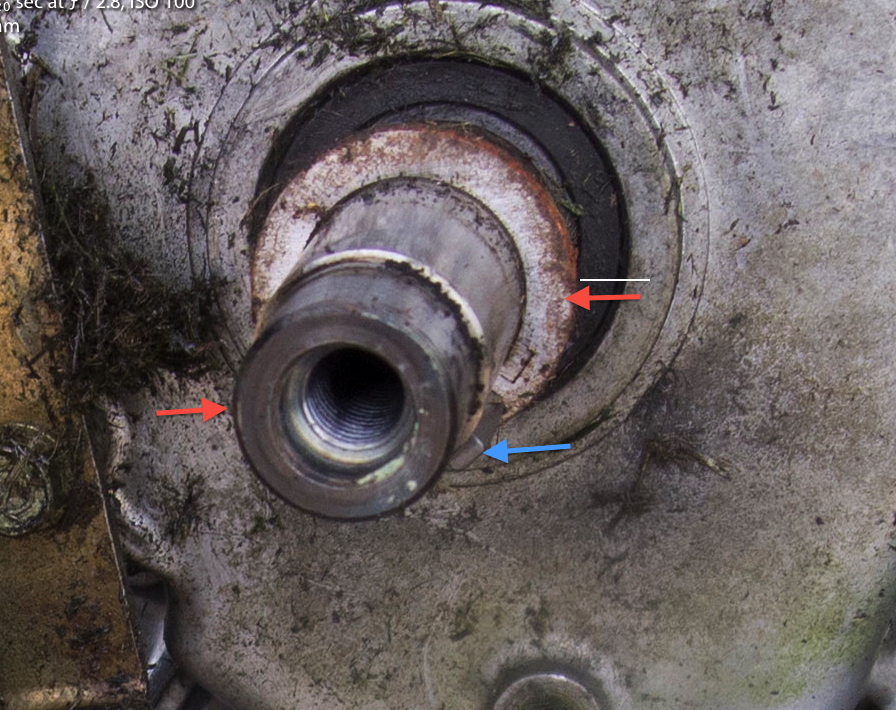

OK grumpy I I think I have already removed that key, unless there are two of them. See pic. This is after I removed the clutch. There are two washers (shown in red) and the blue arrow is I think what you call the Woodruff key. It came out quite easily actually

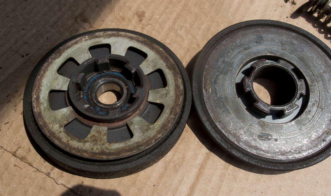

Another question if I may. This is a pic of the clutch .. The circular spring fell when I removed. The photograph shows the way to insert the spring (yes?) and the tabs on the spring on the does not have to align to anything (yes?)

Yes, that is the Woodruff key, at the tip of the blue arrow. If you got it out easily, you were fairly lucky - sometimes it is difficult to get them out.
So long as the two points on the crankcase cover (sump) where you tap are directly opposite each other, it is not important where they are. I select them according to where the cover extends well beyond the crankcase itself, so I have room for the rubber hammer. Remember, just one light tap, then go to the other side, so the cover comes off in tiny increments without tilting relative to the crankcase. If it tilts, the holes the dowels are in will become deformed. Do not put a screwdriver or anything else between the crankcase and the cover, or you will damage the surfaces and cause an oil leak.
The clutch spring, which is of a type called a Belleville washer, is there to push the two halves of the dog clutch apart until the central spline disengages. You should be able to see marks where the tabs have been sliding around one half of the clutch, and marks where its outermost region has been pressing against the other clutch-half. I can't see it perfectly in the picture, but it looks as if I'm seeing rub marks under the tabs, and rust marks on the outer region of the other part. If that is correct, you have it in the right way up.
The tabs can't align with anything rotationally: whenever the clutch is disengaged, they are spinning relative to the clutch-half they are resting on in your picture.
