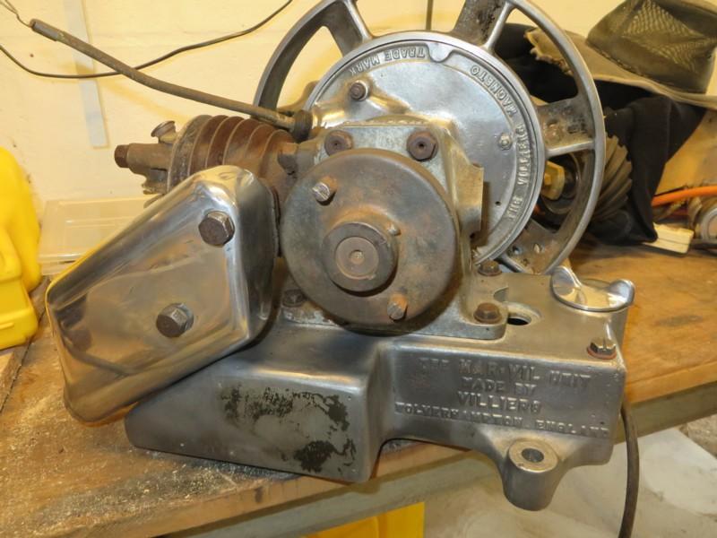

i found this little gem . and fell in love its awesome.
its a mar-vil engine from 1937. [Linked Image]

Love it Gizmo! I came across one a while back,wished I had bought it. Did a bit of quick research when it came up. Theres a bit of info on them which is good. Anyways great score and a very interesting piece for resto. Villiers sure where diverse when it came to engine styles and applications...

yes i found the lack of a throttle. fuel tank on bottom, and the carbie of sorts on the crankcase end? and generally the quirkiness of how it operates quite fascinating.

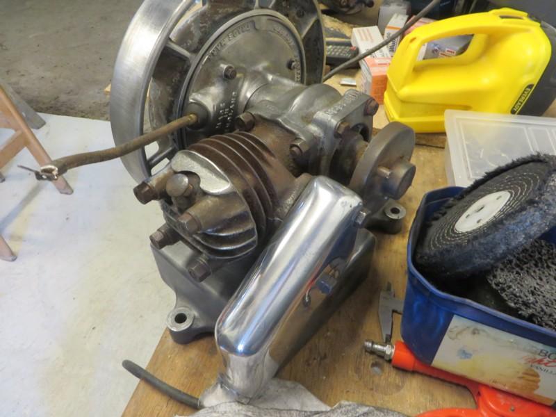

well finally got her up and running.
and i found out its a 1934 model which makes it 80 years old . wow rockon

yes the carbie is on the crankcase end of the engine. something i have never seen before. and it uses crankcase suction to suck up the fuel from bottom tank through a disc valve.

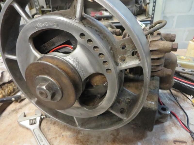

it has no throttle or air filter so the engine revs are limited by using a fly out cam to keep the points fully open when it gets up to speed then collapses as it slows once again.
the screw on top of carbie is needle adjustment for fuel intake.
i will need to fix the baffle on end of exhaust to create a little back pressure. i just wanted to get her running before a full stripdown.now is to be packed away for a later date. cheers bazz

the camming device on the flywheel to keep points open

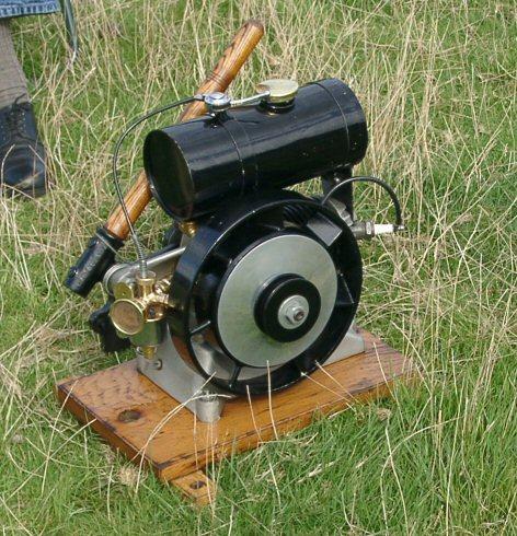

thats it grumpy youve nailed it. exactly how it works. as it was the first of these models the latter ones did have a proper carbie and top fuel tank
Gizmo #55792 18/05/14 09:31 PM
Now you're talking. With that slide carburetor (it's a real one, with a needle), it should run as well as the 1950s Villiers 2 strokes.

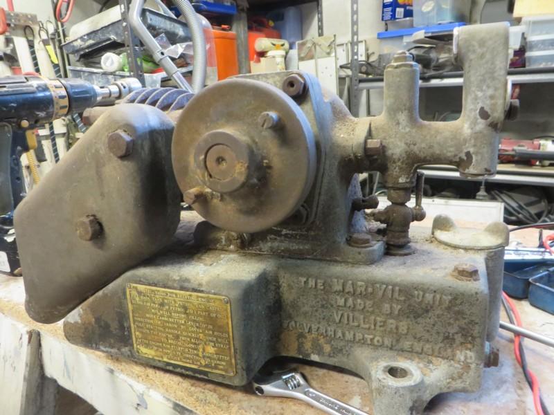

I picked up one of these engines yesterday, adding it to Gizmos thread to keep all the information in one place
It has spark which is a great bonus
Engine number
So lucky that the magneto assembly is all there and working
I am missing the fuel tank, carb and exhaust. I will be searching for them but they may take a lifetime to find. I found that a later Villiers carb bolts straight on so all that's left is to sort out fitting a later type Villiers fuel tank and it will be up and running :-)
