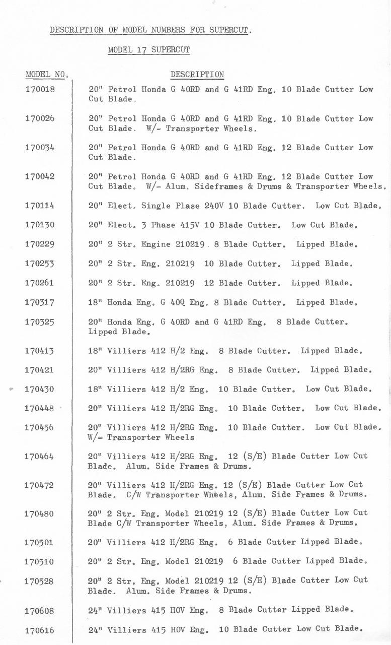

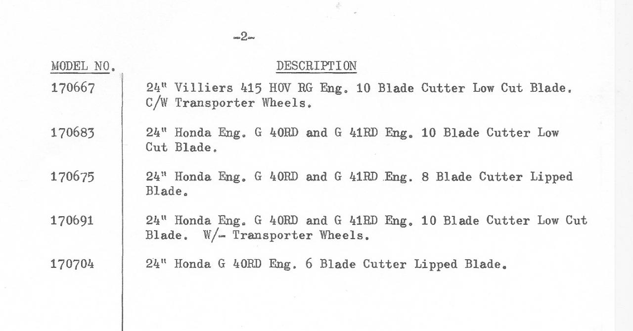

Hi to Rolla and Mal,
Here is some interesting descriptions of the various models of the Scott Bonnar Model 17 Supercut. These were all manufactured at the Thebarton (formerly Southwark) factory in South Australia.
All good stuff...
