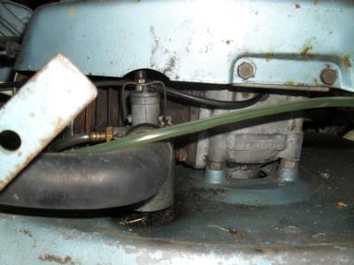

So my Buddy turns up at My place with his old Victor 160 Corvette, a non runner and asks me to fix it.
[Linked Image from i98.photobucket.com]
New Plug, fires straight up, BUT throttle works in reverse sense, I.E. pushing it forward, revs reduce to Idle, pulling it back, revs increase to Max.
Closer inspection reveals a G3 carbie, so download the relevant docs, set it up, as per earlier on this thread, and Voila.. exactly the same.... which didn't surprise me as that was exactly what I expected from how it is rigged. Now i'm a modest man, but I think I'm a pretty good engineer, and this set up just makes No sense at all. I fully understand that the throttle doesn't control the butterfly, but only the spring tension, but regardless, pushing the throttle lever forward is only ever going to INCREASE the tension in the spring, and make it HARDER for the butterfly to open, and EASIER for it to close.... i.e REDUCE the revs.

Yep, definitely a mismatch between the carby and throttle control.
One giveaway is the stop switch wire going to the throttle control. This setup is pre-G3; all G3 carbies had the stop switch in the 'throttle connector' arm, as that one does.
Victa carby diagrams: https://www.outdoorking-forum.com.au/forum/ubbthreads.php?ubb=showflat&Number=11468
I'd suggest that the machine has been retrofitted with the G3 carby at some time, likely due to parts availability. The throttle control/air filter is probably original.
Some more detail: https://www.outdoorking-forum.com.au/forum/ubbthreads.php?ubb=showflat&Number=47903#Post47905
The G2 carby is P/No 3-260; the G3 is 3-335 - that list shows different throttle controls and cables for the two carby models.

Long air cleaner [top-opening] + separate throttle control [both VC-160 type] is correct for the G3 carby on the Corvette. That's what's shown in the pic in the second link in my earlier post.
