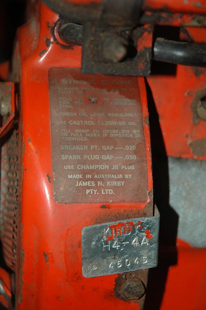

But here on the engine(H4, but I would presume it would be the same for the H30) is the makers instructions:
Fill to overflow or to full mark if it has a dipstick. wink
