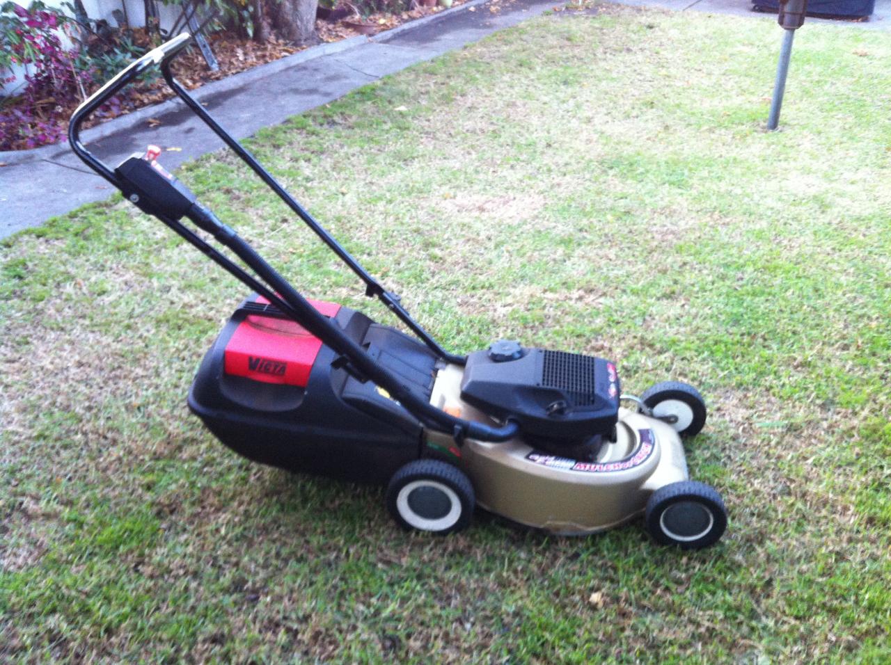

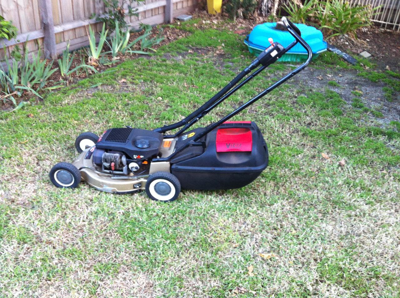

Righto, so let's see how this goes.
This is the beast in question just after I've mown with it.
As I said above the plastic caged bearings are shot and I'm looking for replacement wheels that will take proper bearings and appropriate bearings.
The mower is Model number MCA202A with serial number 3539-437
Many thanks
Ironbark
The wheels would be fine, the replacement steel bearings are available and slot right in. I cannot remember the part no. off the top of my head...
