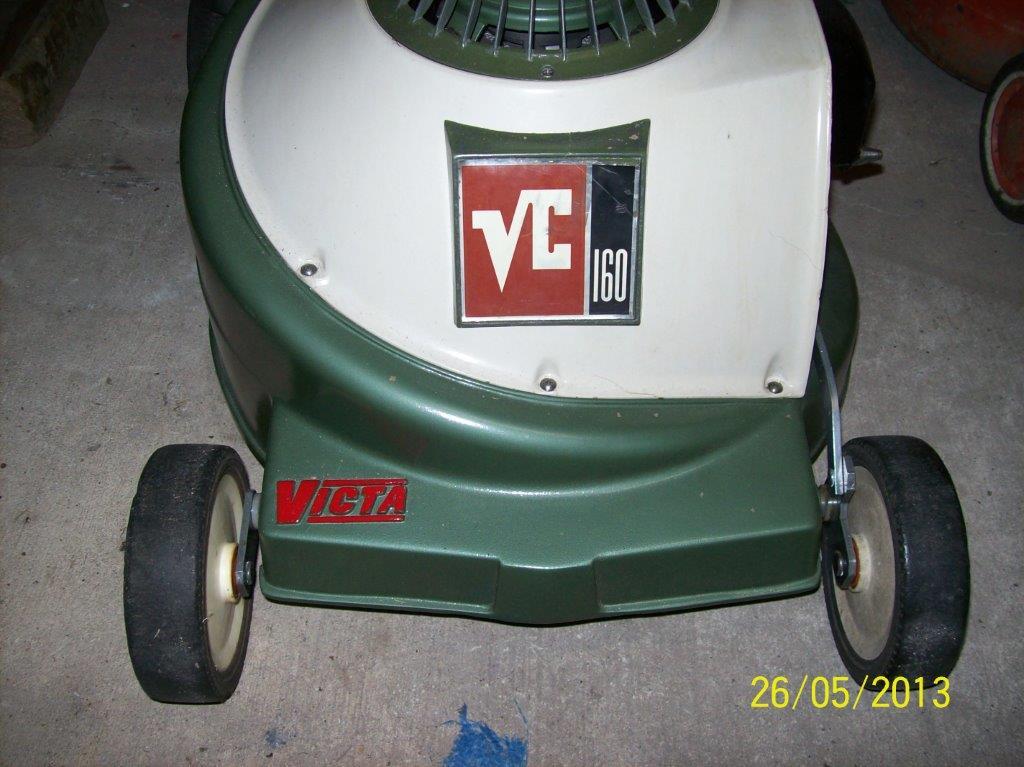

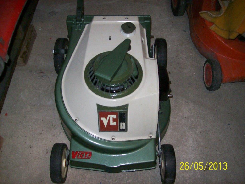

Just to inspire you on here is a picture of my mark I.
Just have to get my handles re-chromed and then it's done.

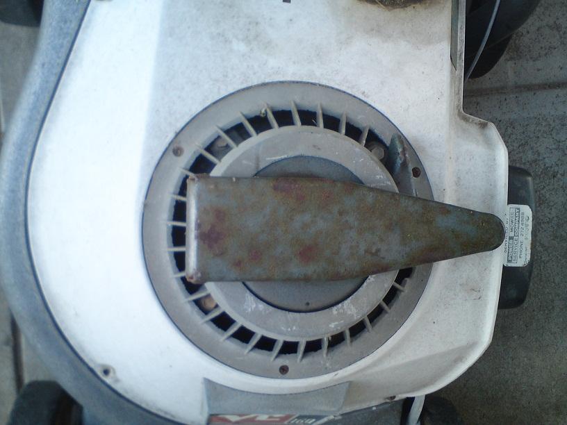

One issue I have noticed with the starter is that it doesn�t always �catch� when you wind it. Sometimes the handle just turns without seemingly engaging the spring. Fiddling around with the little lever on the side usually gets it to work in a few attempts. Is there a knack to this or does this signify a problem with the mechanism? How serviceable are these starters? I�ve downloaded the manual but they always make it look easy!

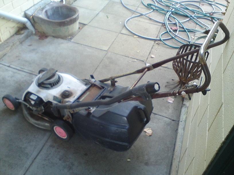

Here�s a few photos of my VC for your enjoyment - any tips or suggestions would be greatly appreciated! wink

Originally Posted by Llessur
it�s solid and all there
Except for the throttle. That's broken and rubbish. Someone's hashed up a replacement but it's on my 'to-do' list...
Wow the starter ring is indeed intact good work.Just be careful with it they do and can get brittle,yours doesn't look that bad.I had one that when I tried to take it off it just crumbed in my hand.
I guess with all 3 of my VC-160's they are not going to be mowing any lawns,yes they will run but not mow.I guess that's why I went to the trouble of detailing everything the way I did.If I was going to use them that would then be a different story.
As for the starter,

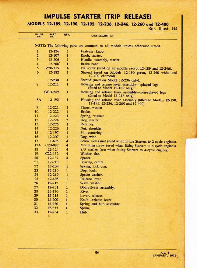

The biggest problem I have found with these starters is the release lever No29.As it connects to a piece (which I think in that is No27) the dog release assembly.As that can be worn and then doesn't lock in and will cause the spring hub assembly No31 not to lock in and cause the problem you are having.So I'd look there first,it is a common problem as they do wear out.
Hope that made some sense.
The pawl on the 'dog release assembly' is spring-loaded. A common failure mode was for the spring to fail. So the pawl would then no longer be pressed against the spring hub teeth, and it usually wouldn't engage to lock the hub, unless you got very lucky! Replacing the dog release assembly was a common job, back in the day.
The 'Victa Old Starter' doco at https://www.outdoorking-forum.com.au/forum/ubbthreads.php?ubb=showflat&Number=54967 shows the setup before the dog release became an 'assembly'.
