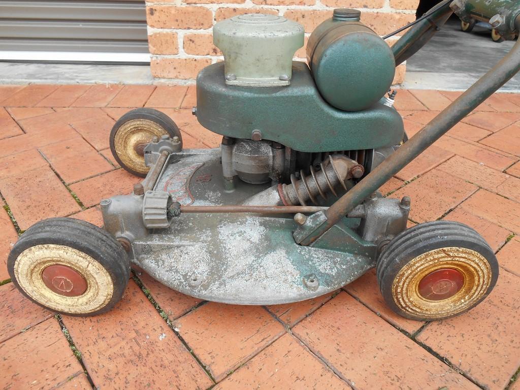

Hi Mal and Polybus,
Please Mal, correct me if I am wrong, but the second machine appears to me to be a Model 5 Series 1....It has the 4 skirt holes, edger slot, and front and rear Predicta axle housing extensions...which indicates a Model 4 base?
Here's the pic from the left hand side...

Sure is deejay,sorry Typo on the second one,never checked it at edit:( At the time of my post it DID show up as a Model 5S1, not S2...Also I posted my info before he put up the serials and link to the complete Images,so i never got to see the other side clearly smile
But its now irrelavent,as with the serial and complete Images of Model 4 Base it appears to be a Fairly Correct Model 4 STD(NON Auto) smile

Thanks for that Mal, I am still learning myself of the subtle differences between the Victa 18 models, and it's through specialists like yourself that I am gaining this valuable knowledge.
Many thanks mate. grin
No,thankyou Deejay for pointing it out:)...And as for learning,it appears your well and truly up on most if not all the Differences! lols.
Its good to get another accurate Model 4 STD in the forums especially with the correct serial...
One of a few little things I noted on this is the cowl assy. While its not impossible I would not expect to see this style sticker on a model 4 STD. Also the metal cap seems a good colour match to the tank. This combination I would expect to see on a 2a(cowl sticker),early Model 3 Rotomo or extremely early automatic,as the latter two ran mostly metal caps on the early release models. BUT since the cowl/tank assy colour seems to match the rear of the base Id say this is how it was sold:) Something small,but noteworthy...:)
