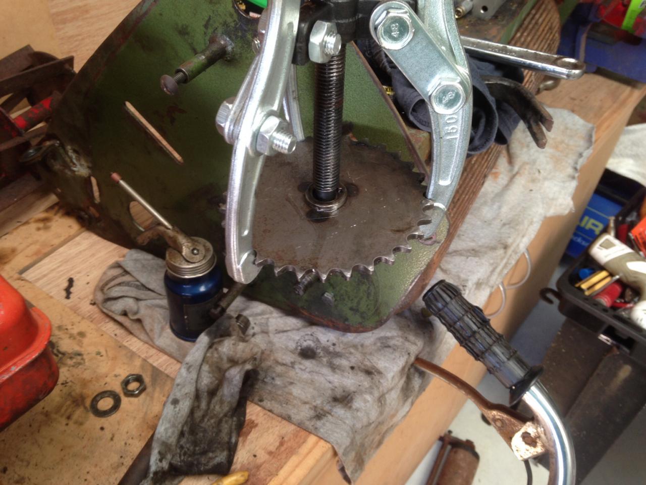

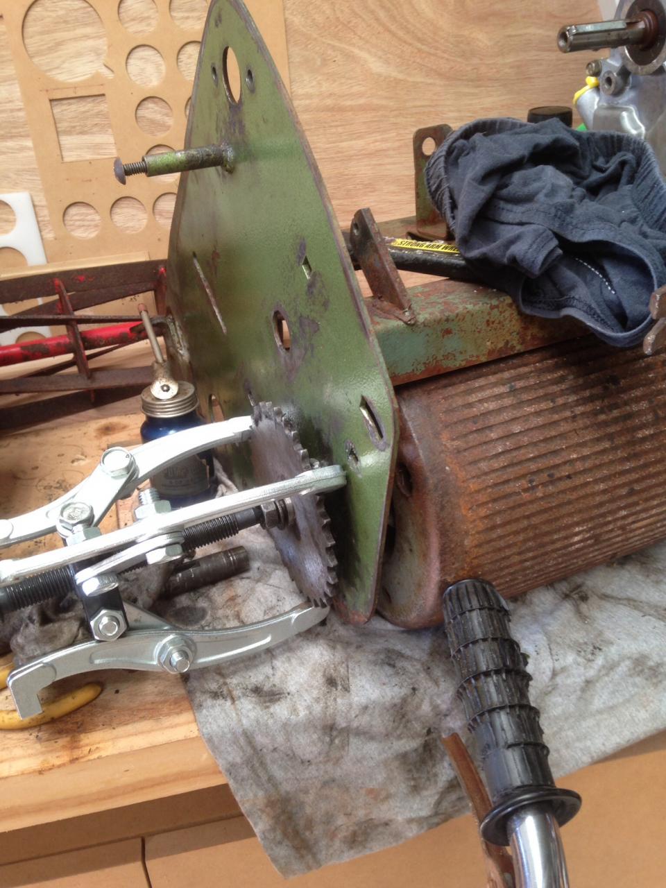

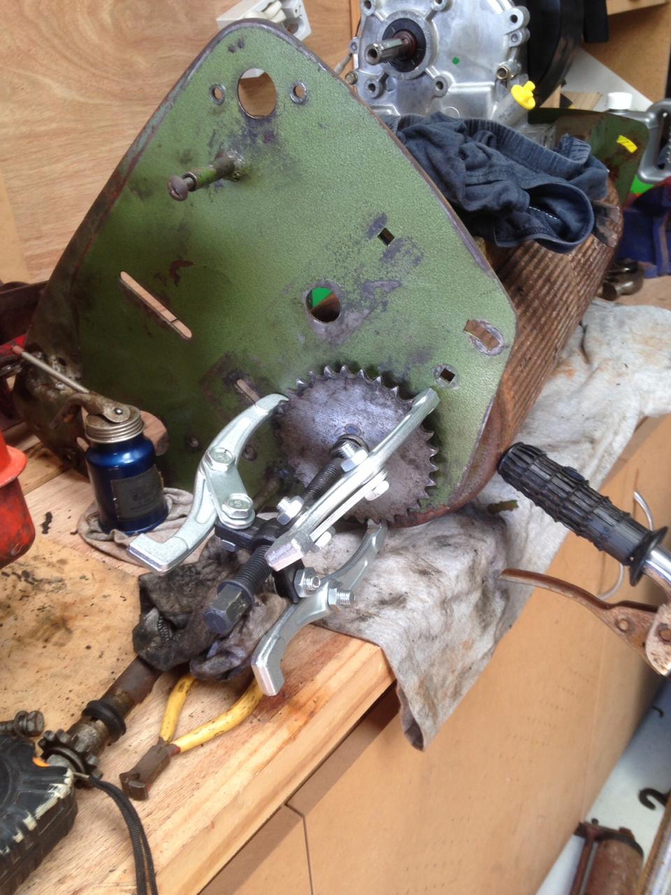

Ok so I thought I would just share the removal of the main roller cog in the event that someone else has the same problem.

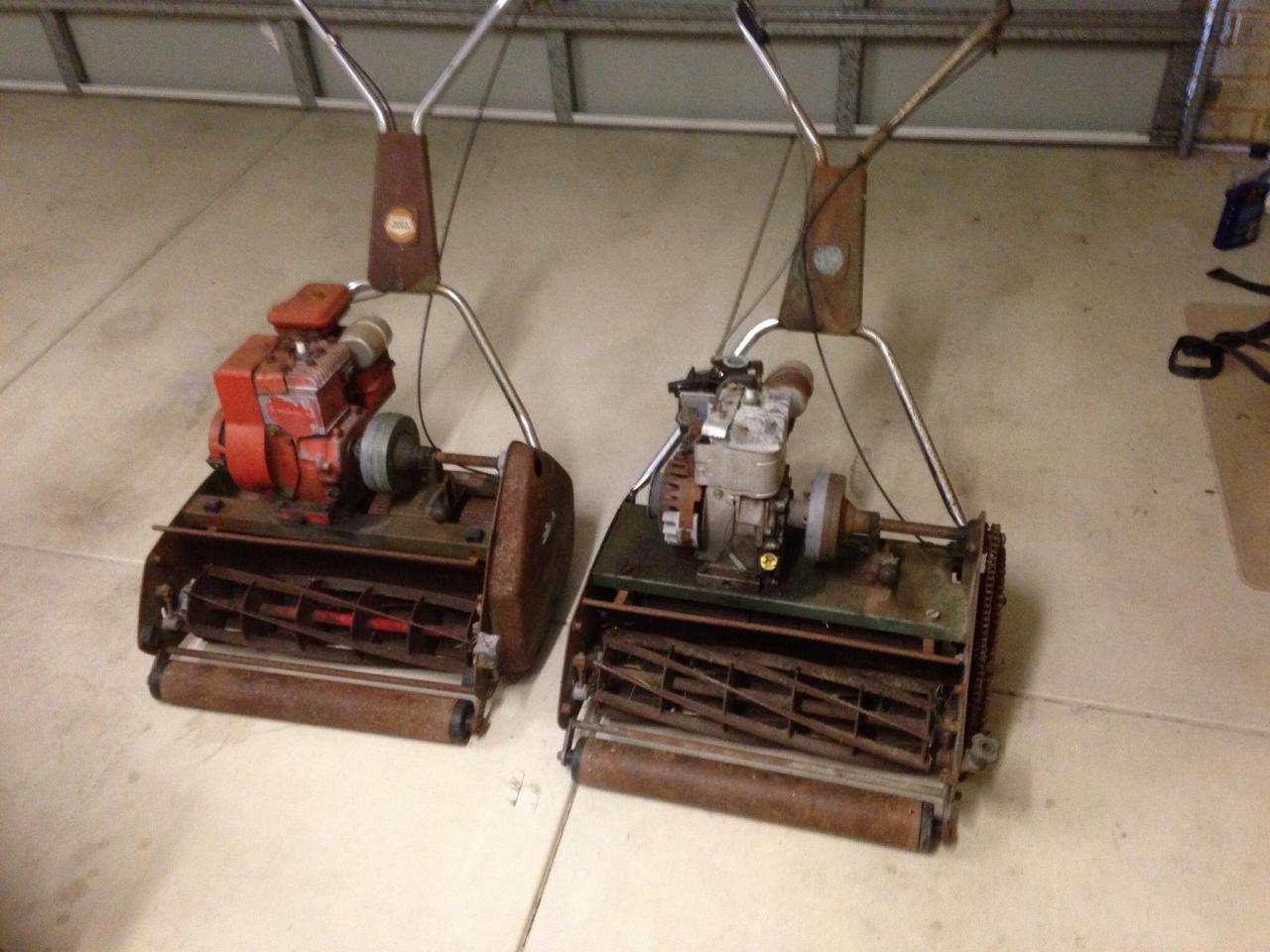

A little about my restoration, I have picked up 2 Scott Bonnar 45's for $100, what I thought were 17 inch actually turned out to be 2 20" machines, they had been sitting out in the weather for a few years and were not running.
Usually the cog should slide off quite easy as did most of the cogs on my restoration project however the main roller cog would not budge an inch. I did a rough measurement of the cog and found it to be approx 120mm.
I purchased a 150 mm cog puller for $24.00 delivered which worked well.
I left the nut on in the event the cog gave way in a hurry, there was quite a bit of force and didn't want every thing to shoot off and cause the cog to drop and get damaged.
I found that it was hard to get the puller legs between the back of the cog and the frame so I used the puller to pull the cog slightly, then loosened and re set the legs.

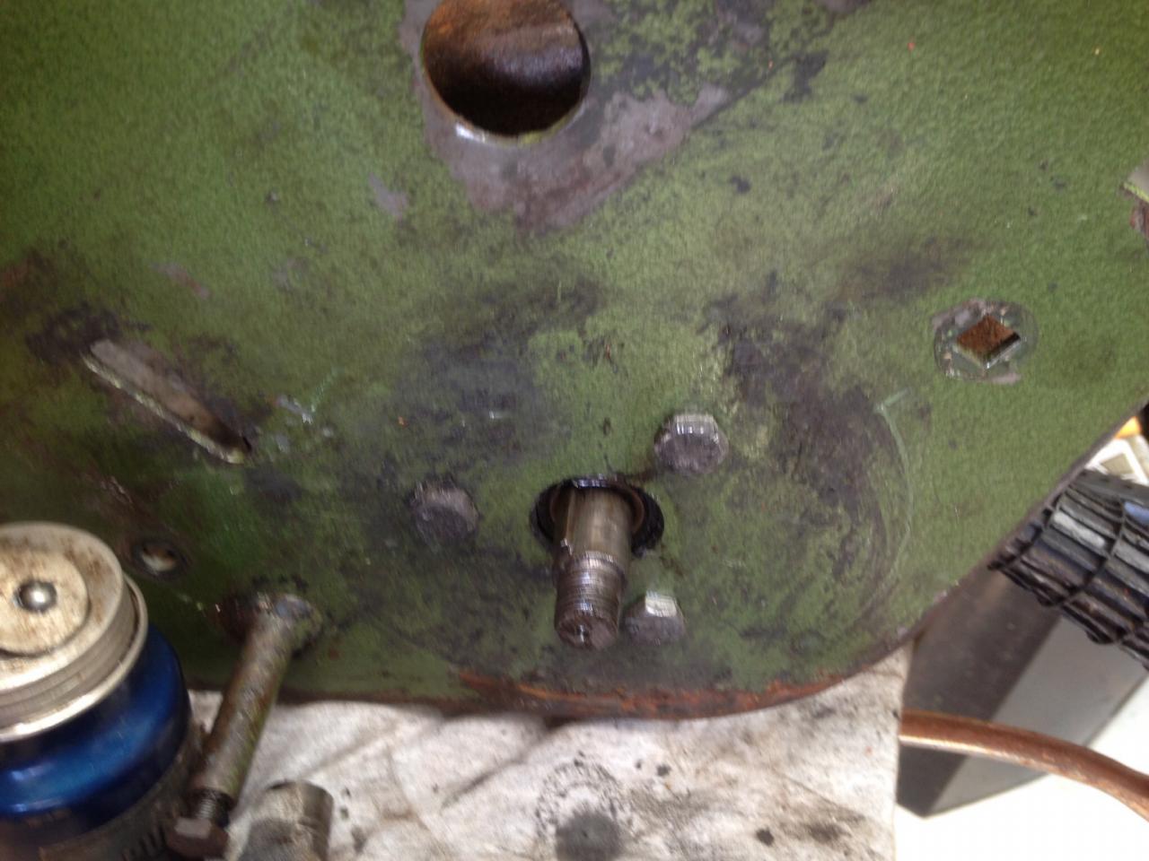

Then it was a matter of continuing to screw the shaft on the puller till the cog came free, making sure the shaft in front of the cog was well oiled to help it slip off easier, much better method than using a screwdriver or crow bar and the puller was well worth the investment.
Thanks for the report, Ozziesim. The right tool usually makes a big difference.
Just one finicky point: a cog is a tooth on a gear. The tool you bought is a gear puller. The object you removed with it is a chain sprocket.
