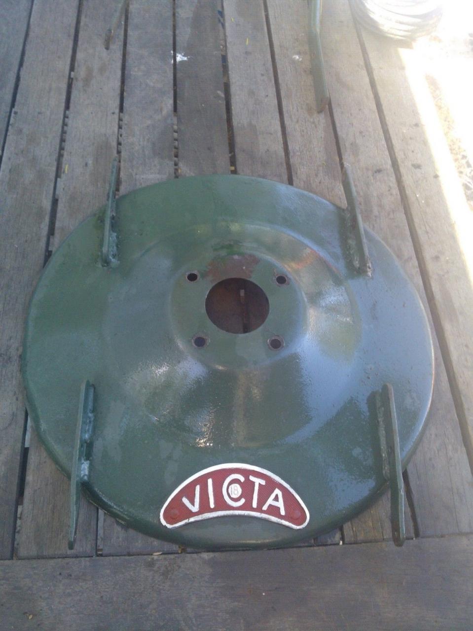

Already checked it's M1 290 & M2 280, you swap over to reserve quickly lol, cant see any circlip groove in rear axel but is welded, there are no circlip grooves at the split pin ends, and no spare M1 engines laying round LoL, the engine No is one that I know nothing about, the story goes his grandad used it to mow the lawns with and his grandmother used to follow him up with a mower with a catcher LOL. some more pics.
Just keep it aside until you do:) The rear axle looks like its been replaced,no pitting at all? The engine is an M5 S3,there is another in my wanted forum ICAA00000. And from those images the front axles are model 2 not 1.....They are bent,So id say its a Model 2 Chassis,Since youve already measured the rear axle and came up with Model 2,id say thats correct:) And im sure you have a spare engine or two now....lols.
Just To reconfirm,Ive rechecked my two model 1's and they are exactly 290mm between front axle mounts. So with all our other info its a definate.
Now something else to consider Ive also checked my early Model 1/2 thats the Model 2 with the Model 1 Parts and it appears its also running a Model 1 Base At 290mm,With front and rear axles both in model 2 circlip styles.
4 Rotomo 2s came in at 280 mm and 1 at 285 which is just a minor discrepency and id say,no issues. So again also reconfirmed as accurate.
Rear axle on the model 1's is Exactly 16" or 406mm. Full floating axle with NO inner circlip stays and holes in the ends for the split pins.
Model 2 is also at 16" Predominantly Steel wheels and ALL plastic Wheel models have Circlip ends + Inner circlip axle retainer.....Although some early model 2's having split pin axles is not uncommon.
Havnt checked plastic wheel rotomos for rear axle length yet,but not anticipating any difference.
So Im assuming unless its had axles changed...Your chassis is a very early Model 2 Version and would look nice kept original....What are your thoughts Jonesy? So time to start finding a nice early serial??? The Give it to me! lmao....

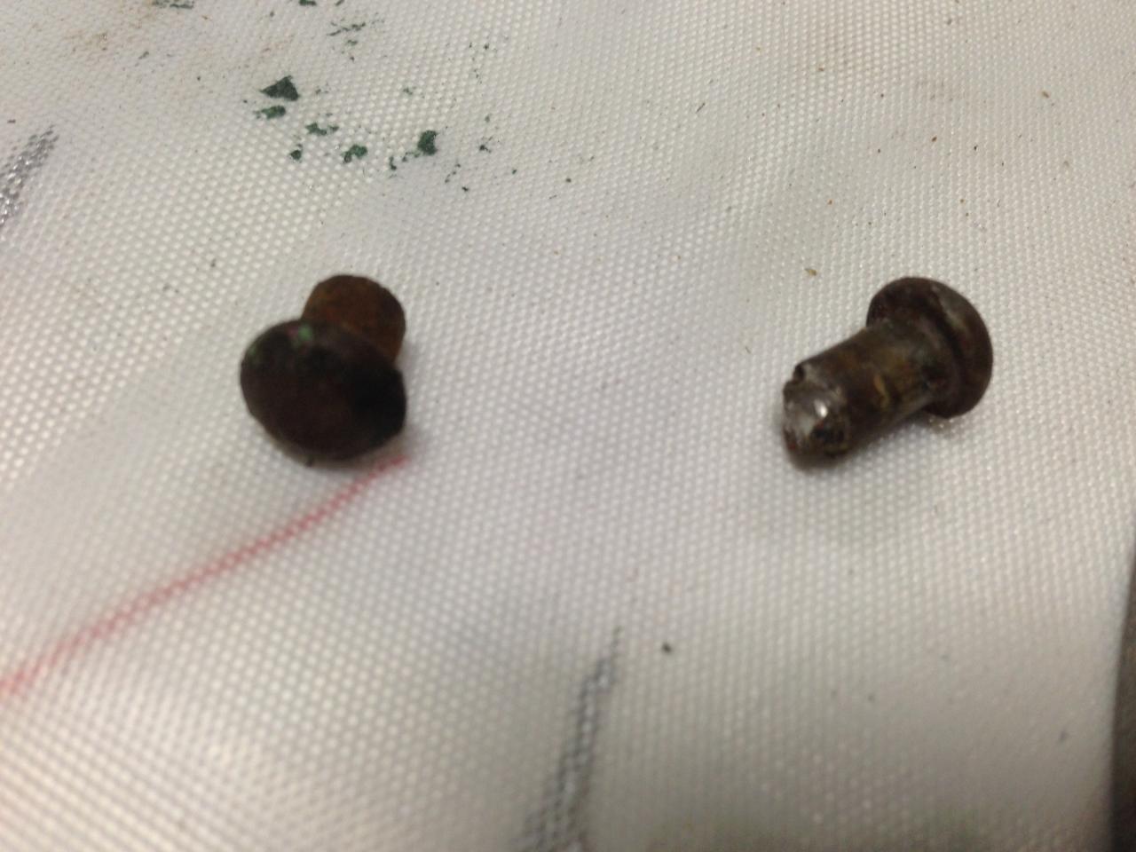

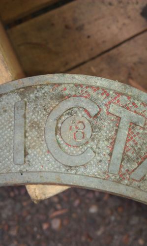

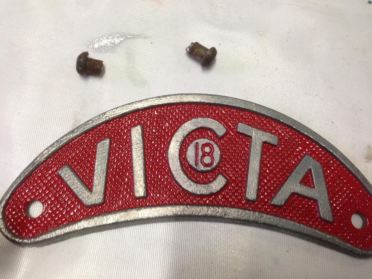

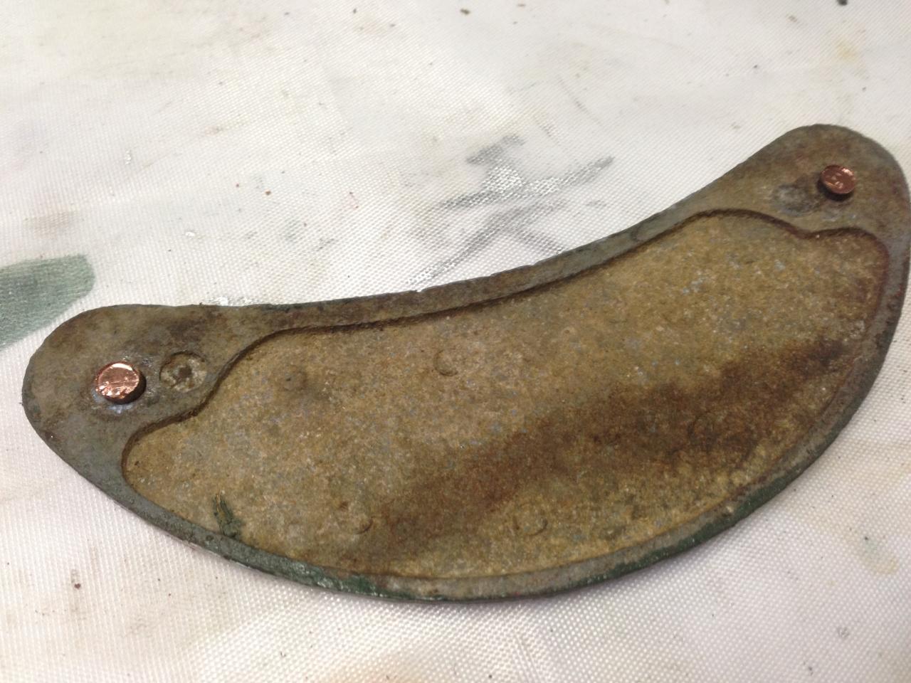

Re the topic of rivets or bolts on the badge, my 17,000 with a Model 1 badge came with one side alloy riveted and the other with a brass dome nut. Still not 100% sure which is correct, but I'm leaning towards the rivet based on this image from the March 1957 ad:

Yeah your 17,000 circlip is correct since it is a Model 2,So you have to go on the Majority and accuracy of that Model,Not so much what part variants carried on from the Model 1 to the 2,valid as they are. But in all reality the real transition happened when the serial changed. So yeah your 290 mm is a model 1 base carry over as well and since its 17,000 im not surprised...So we both have early model 2 examples with model 1 bases.
Ive stated my opinion on the Screws a few times,that they all came with 2x 3'16 Machine screws and nuts,so ill wait for more evidence,especially since this Ad shows a Model 1 With Plastic Wheels! And Id expect to see solid steel or alloy Rivets,NOT pop/blind rivets for this period as the Ad is showing....But yeah a couple more Images might give a clearer picture,and we do have a few original examples in the Roto forum using Identical screws. But Ill stick With Screws for Now....Why? Cause your going alloy and we cant have fun debating if I go quietly along with you! LMFAO...Naaa we will sort it out soon! muffles under my breath...Screws...Screws....shhhhhh

But yeah unkie it really is a credible Image,but im just not convvinced yet. So many examples running the screws,same thread same length same domed head size and chamfered nuts. both my original 1's have them and so does half my collection. especially the original ones... The most often I see rivets is on Restored,wrecked models and beat up examples. I guess another Image would help if possible,but I dont recall many clear ads showing enough to tell if they are screws or not frown. Ok as this is Important,ill try and find some more factual documented proof as I think I have enough Model proof. Also noticed the Fans and billy carts also running these screws. Other theories besides the image proof was that they used both, used them at certain periods,eg low stock of one for example,or the artist had worked his whole life in a rivet factory and had never seen a screw before? lols. I guess as ive said before,I really dont mind either way as so many restorers seem to use both...BUT ultimately we need to find out which/either are Accurate.
