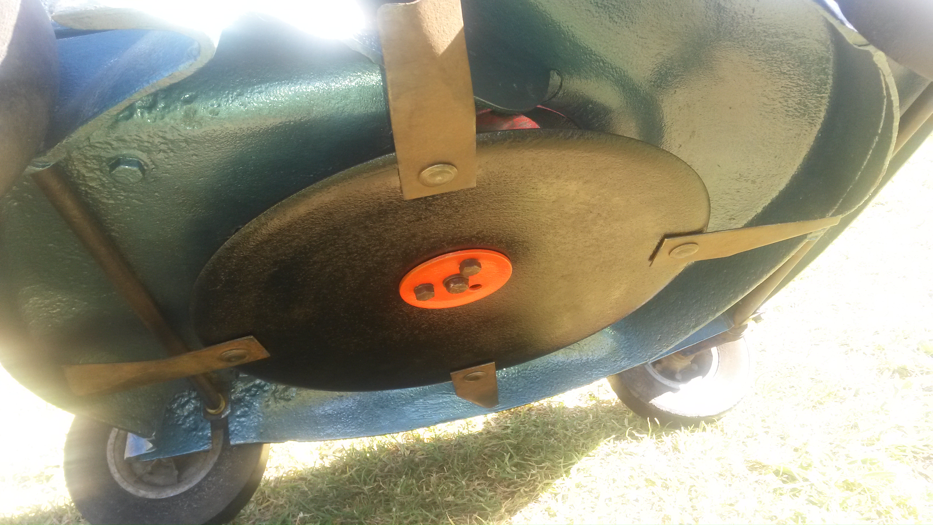

Kind of got distracted on this one lol...But am back onto it and should be done soon, Decals are on there way the blade disc is done and on just working on pulley guard and a few odds and ends....End result coming soon yay.....

looks great man you have done an awesome job and that chassis repair is spot on!!!

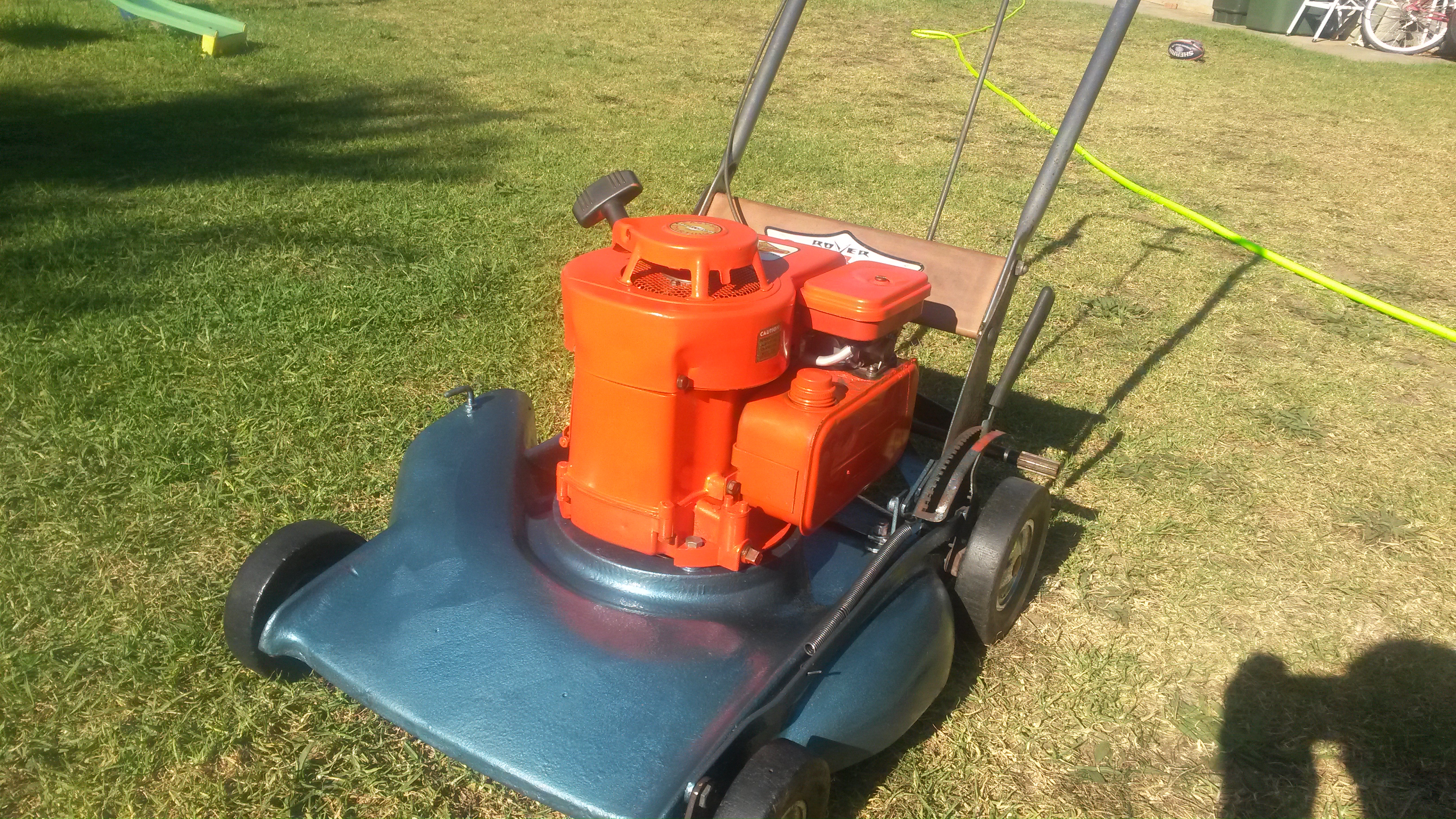

Looking good now it's just about done,Im very happy with the way it has turned out its a beast of a mower ....[Linked Image]

awesome job man , ive just got a mower very similar hope to do the same ! what paint did you use on the base its almost original !

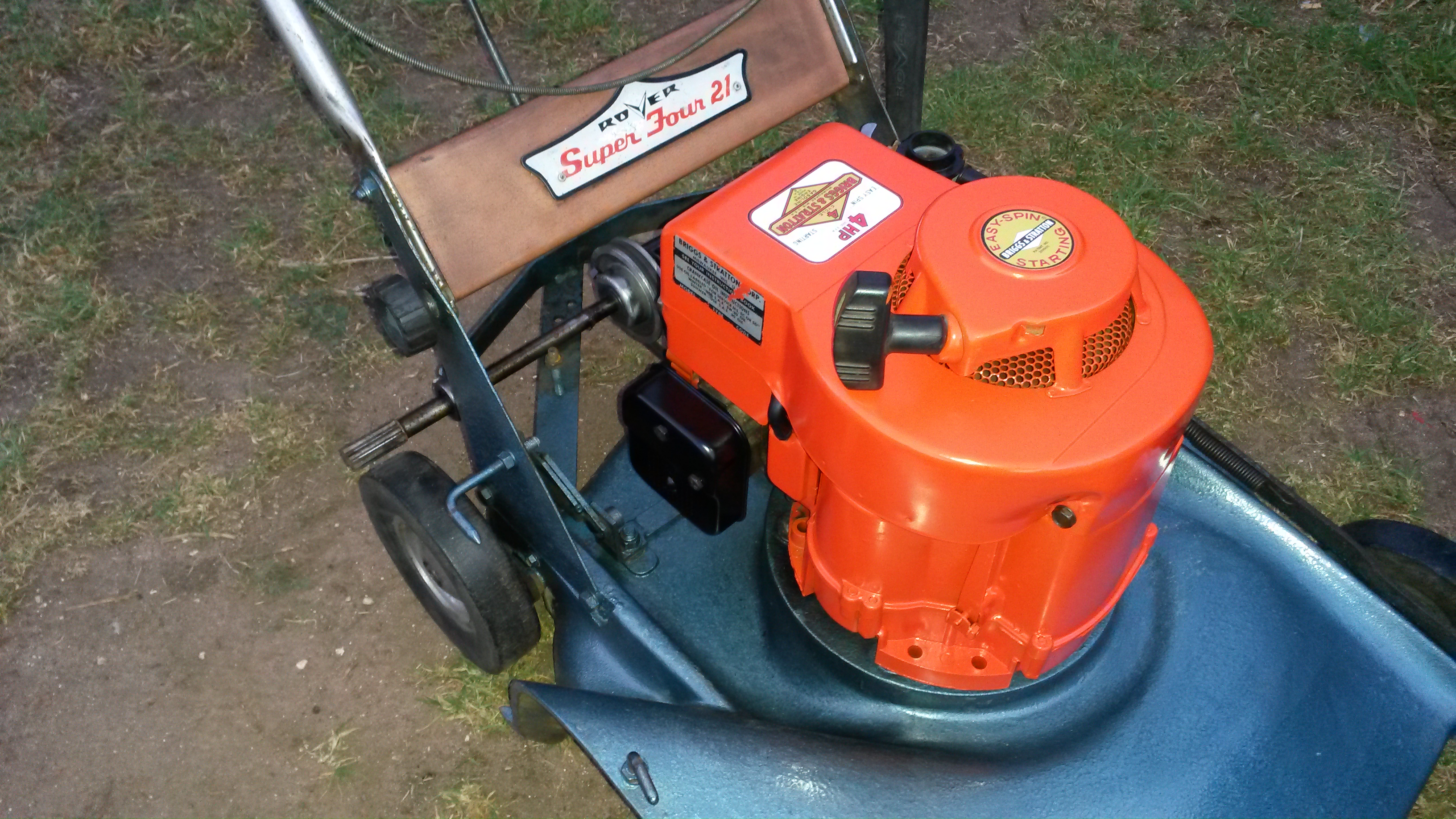

Chris125, I am not doing a restore like yours because I am only a learner. But my super 21 [Linked Image]
has been looking better since I followed your leading. Still a way to go yet though. Great fun this. wink

Christo you've done an awesome on your 21,something to be proud of for sure and you've done a great job on the briggs! ...Ive added your pics to my Rover self propelled archive keep up the good work. Cheers Chris...And yeah if you dont have a Rover badge for your base PM me and I will send you one that's if it's the same badge as on my 53, I think the 21 and 53 have the same badge?...

Thanks. I am a but troubled by the carby & enamel having a "run-in". frown
Chris125, Hold your accolades because mine in no way comes even close to to what you have shown us. Anyway I bought a new "carby to tank" gasket thinking it would help any leakage. But instead of helping it leaked all over the place. The Blue paint not affected but the paint from the spray can of the Chevy orange did not like it at all. So can I ask a few questions?
1)Do you have any advice on preventing leakage at the carby to tank?
2)Also is there any tips out there on preventing enamel from being vulnerable to petrol?
3)Should I use two gaskets on the carby? [Linked Image]

Bugger mate not good what paint did you use the brand?....My carby to tank was the same but the fuel did not worry the paint,all I did to fix the leak was to make a thicker gasket you could try two gaskets but with the thicker gasket mines fine now..The tank to carby is not what you would call very flat...Good luck and mower is looking great are you doing the catcher as well.....Cheers Chris

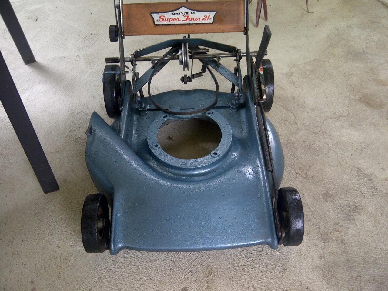

Also to Chris125. I have attached a pic of what Rover called their drive. If you want the pdf of the rest let me know. They called it a "posi-traction drive mechanism".

Never used that particular paint before myself...I have had good results using Motospray paint out of the spray can with no paint reactions to fuel, rust gurad paint is good stuff also...Interesting so they call this setup a "posi-traction drive mechanism" whatever that means aussie.
