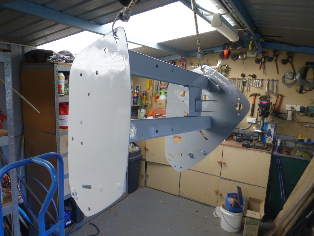

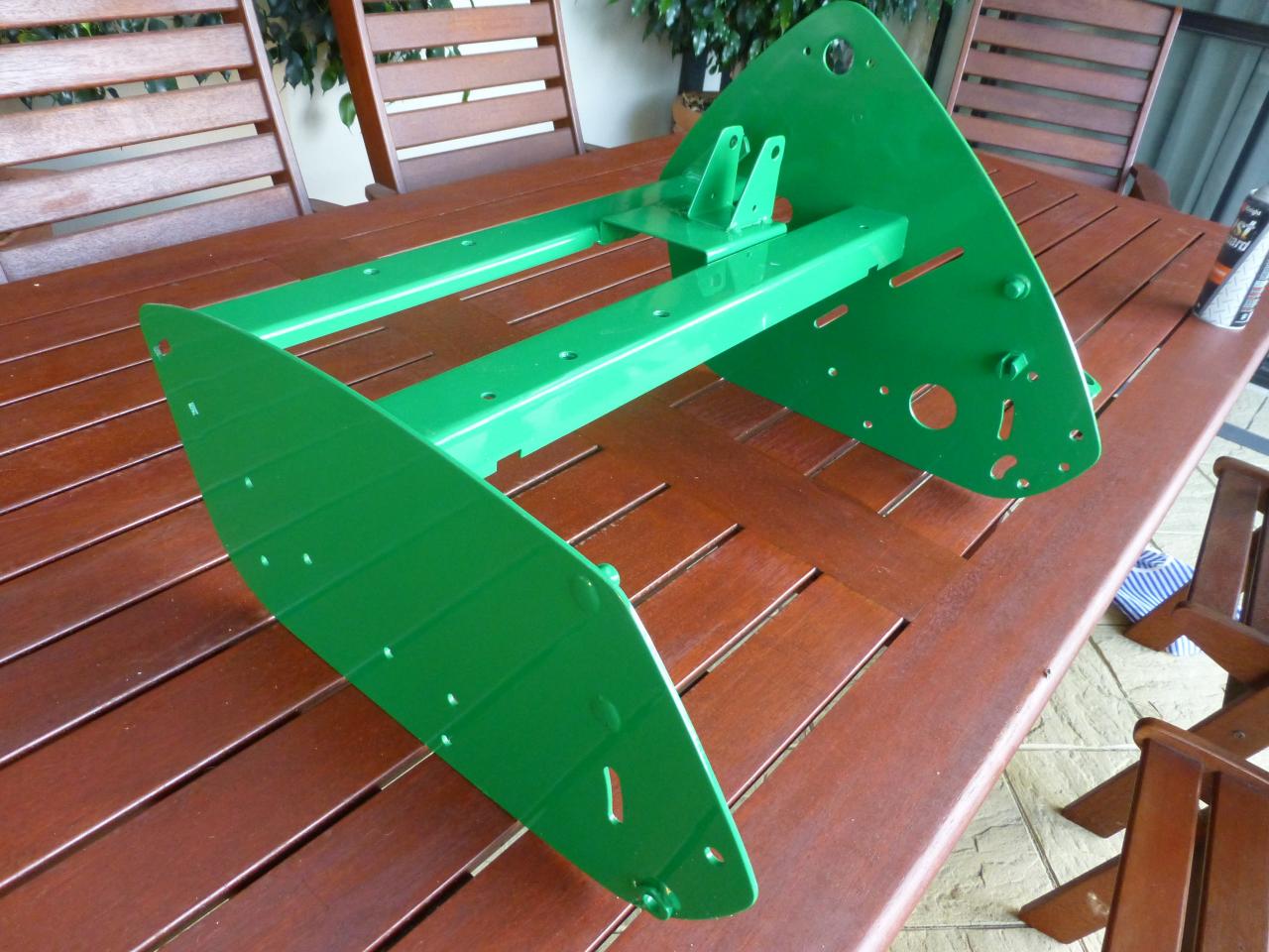

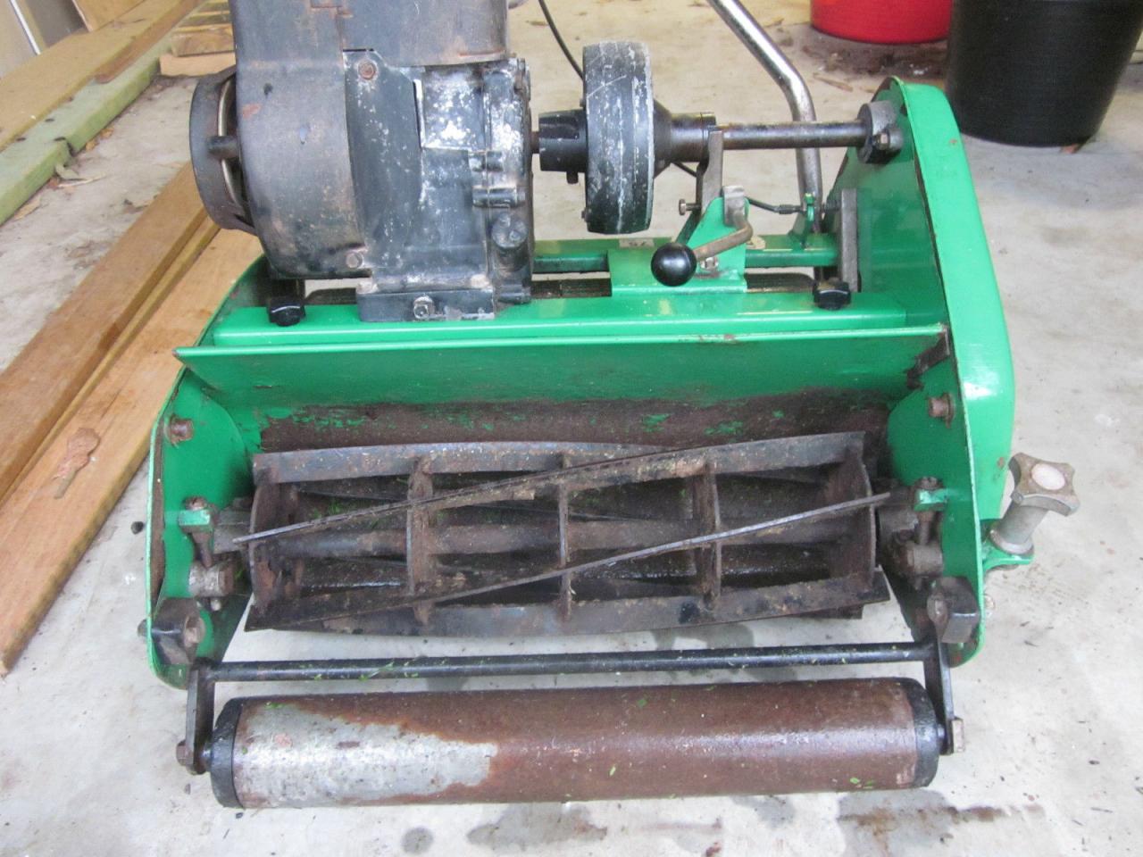

Hi all. I'm currently restoring a Scott Bonnar 45 17".....yes, another restoration post. I want to restore it to original condition. Below are some progress photos. I got my local paint shop to match the original colour. I'm very happy with the matching, cant see any difference. I'll add more photos as I progress.....though it is a long term project. Cheers all!

Hi Corduroy,The resto is coming along nicely, and the paint looks awesome! Well done mate....please keep the pics coming!
Posts: 2,998 Likes: 16
Glad to see another machine being done in its proper original colour, that's what restoration is all about in my eyes.
Good on Ya !! and as Deejay say's, keep those pictures coming as its puts the enthusiasm into us all that strive for perfection.

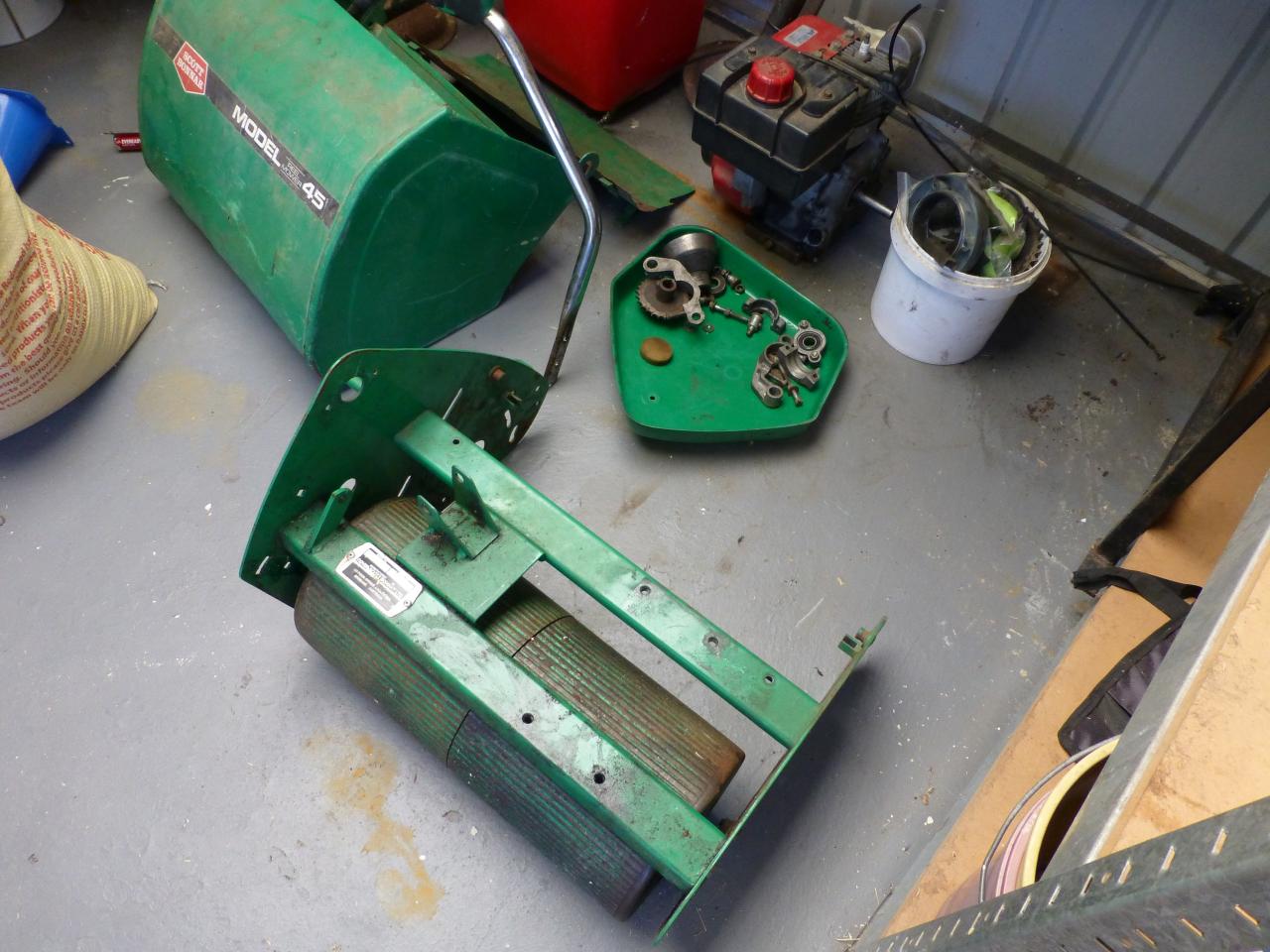

You can see just about everything in this pic, I can chase up some more if need be ![[Linked Image]](https://www.outdoorking-forum.com.au/forum/uploads/usergals/2014/03/full-6396-15859-_57o02.jpg)

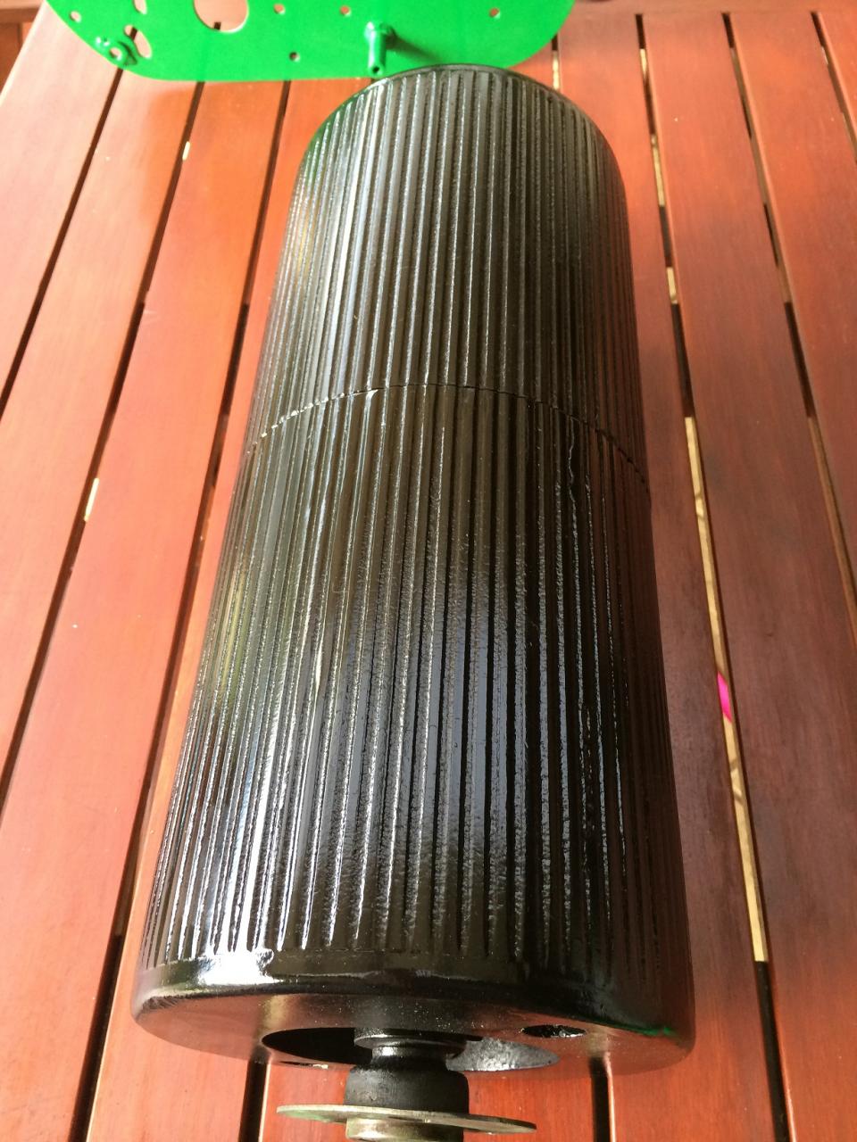

Hi All, Below are some progress photos. I had hoped to get more done this week, but having 3 kids takes away most of your spare time. I bought new stickers from a guy on Ebay. The instructions said you can coat the stickers with clear. I've done this before on another project as the stickers reacted with the paint. But this time it worked well. I'm pretty happy with the finish. What you see is off the gun. Should come up every better once buffed. I decided to paint the main roller black. I'm part disappointed as I wanted to keep everything original though the look of a green roller just doesn't look right. Next to do is the cylinder. What's everyone's opinion on the type of finish? I'll probably just go with paint. Though it appears the original coating was powder coated. I'm not sure if the extra cost is worth it. ![[Linked Image]](https://www.outdoorking-forum.com.au/forum/uploads/usergals/2014/03/full-7458-15913-img_0745.jpg) ![[Linked Image]](https://www.outdoorking-forum.com.au/forum/uploads/usergals/2014/03/full-7458-15914-img_0746.jpg)
Joined: Dec 2012
Posts: 289 Likes: 2
How good does that look  I've seen the instructions you're referring to and I must admit they really concern me. They suggest to use an acrylic clear for protection. Unfortunately acrylic clear is not normally compatible with enamel (as most paint their machines with), so sadly one day someone may end up wrecking their new paintwork to put some clear on a sticker  I've tried painting a reel once, I sandblasted it, primed and painted and it still wore off very easily within 12 months. I've powdercoated a few since and never had an issue.
Posts: 6,362 Likes: 11
Hi Corduroy,I'm glad you decided to paint the rear roller black, there was a guy not far from my place here with the same model and colour scheme as yours and his rear roller, now the green paint has worn off the outer ridges, it just looks dreadful... Re: the cylinder reel, because of the harsh environment that the reel has to work in....wet grass, dirt, dust, mud etc. I agree with Michael, powder coating is the only way to go. I did mine years ago and it has stood the test of time and will clean up well with a pressure wash, whereas paint would fly off in all directions and rust will set in very quickly.  Your respray looks just brilliant mate,

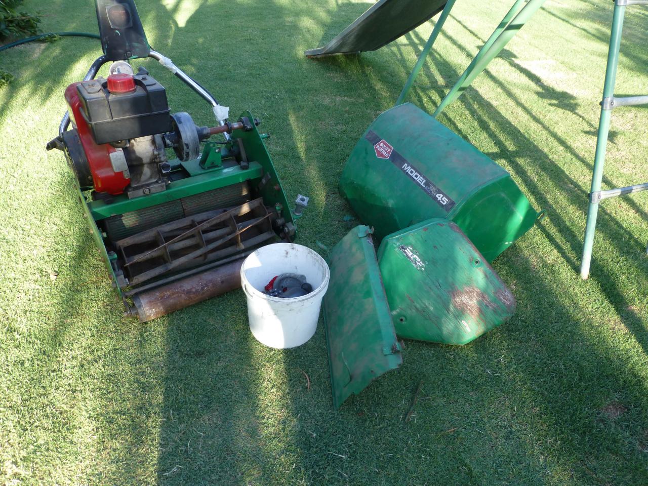

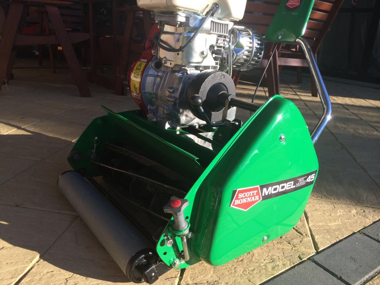

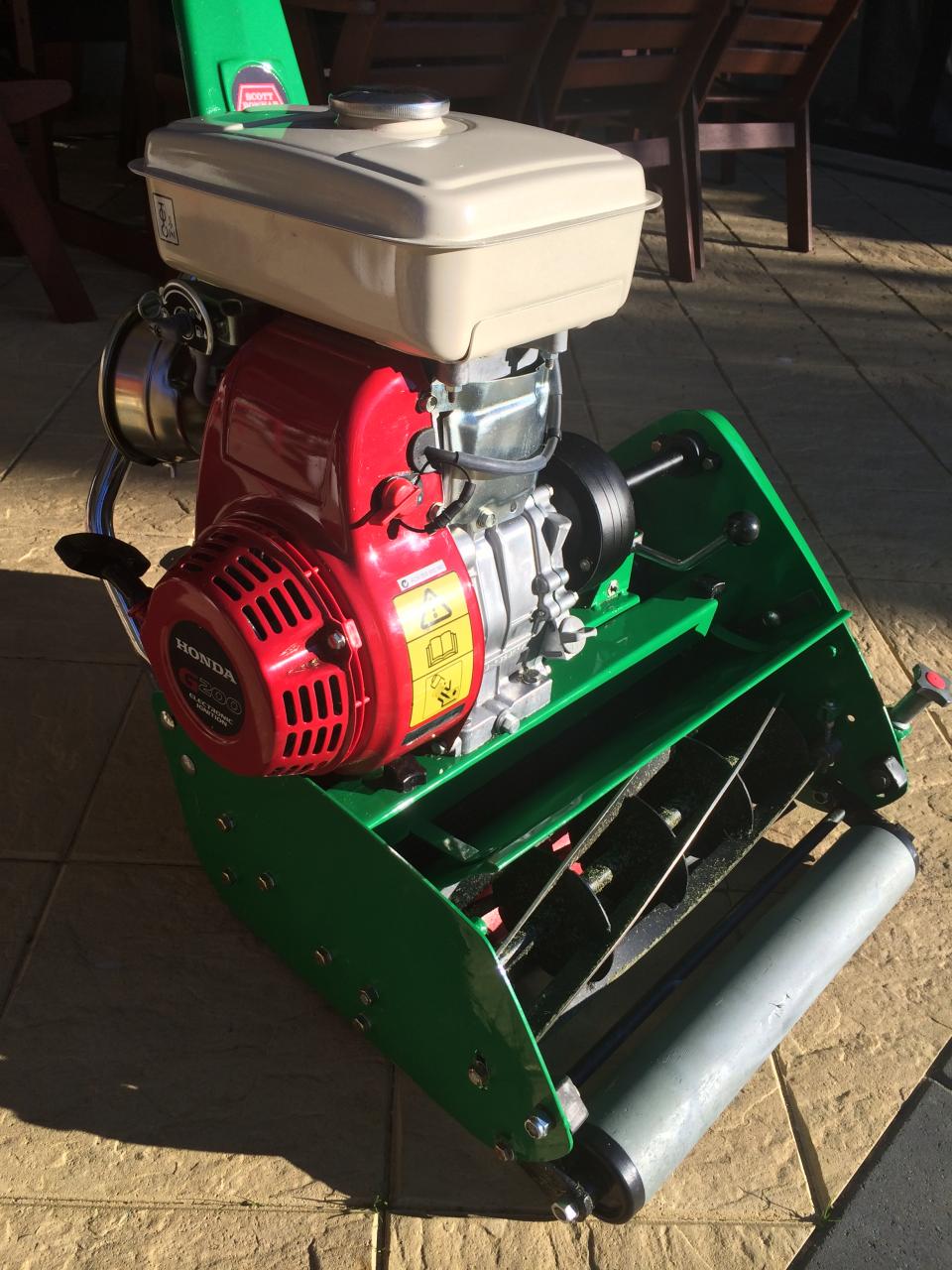

Hi All, An update on my restoration. I've completed the mower, just need to finish painting the catcher. After taking it for a test run, I was very impressed. I'll state the obvious, it felt like a brand spanking new mower.  From having a 14" all my life and going up to a 17" that cut the lawn in record time was the most noticeable improvement. Anyway, enough with the chat, the photos say it all. Thanks to all for the advice and Outdoor King for the mower parts. ![[Linked Image]](https://www.outdoorking-forum.com.au/forum/uploads/usergals/2014/06/full-7458-16709-1.jpg) ![[Linked Image]](https://www.outdoorking-forum.com.au/forum/uploads/usergals/2014/06/full-7458-16710-2.jpg) ![[Linked Image]](https://www.outdoorking-forum.com.au/forum/uploads/usergals/2014/06/full-7458-16711-3.jpg) Any questions, please feel free to ask. I'm sure most will be about the engine.
Hi Corduroy,That looks just brilliant mate....and  on a first-class restoration. What did you end up finishing the reel with.... powdercoat or paint ?
Joined: Jan 2014
Posts: 71
Looks great Champ, well done top job. Them 200's sure are tall, nice choice.
