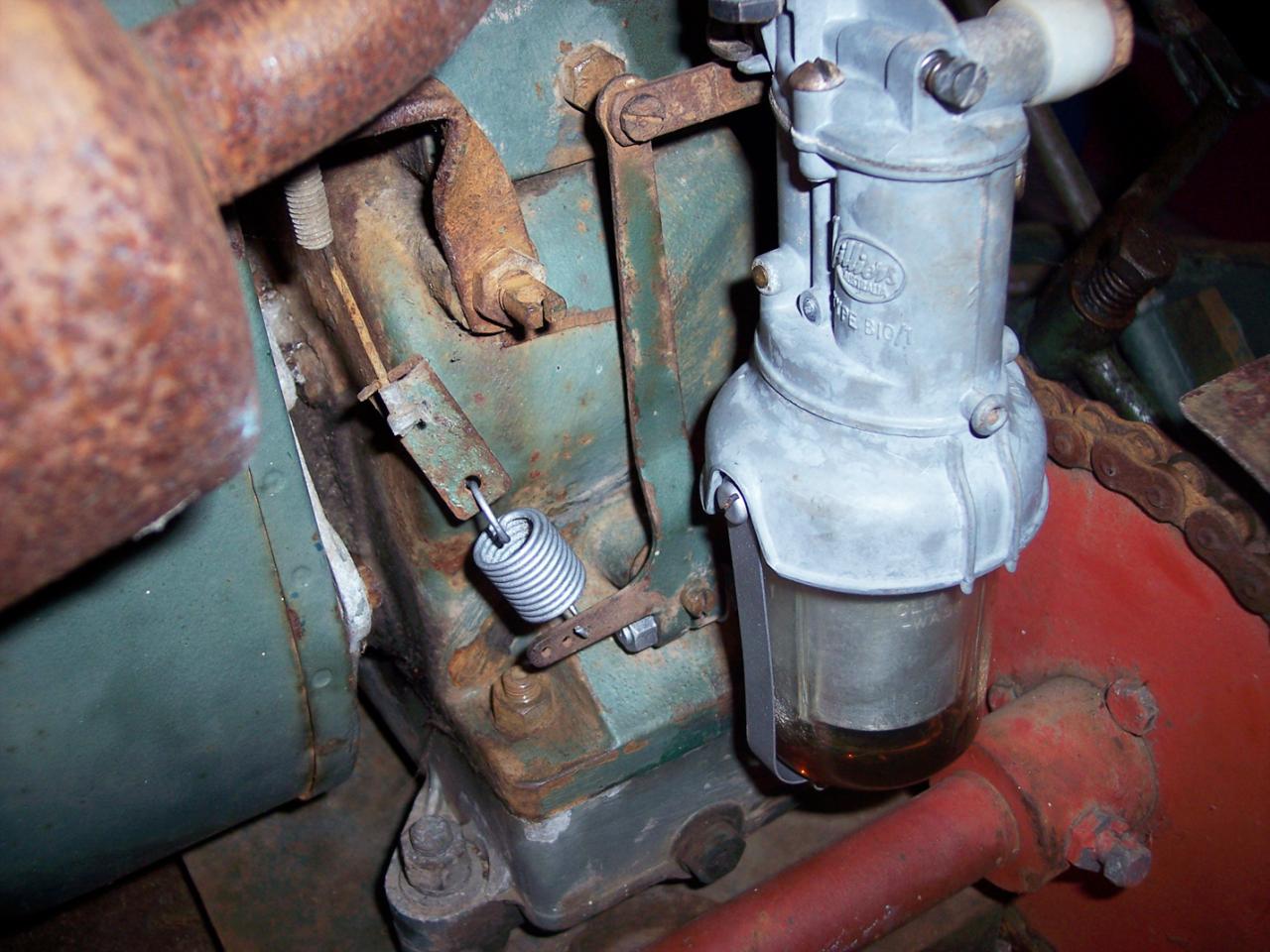

I'm no expert but the fuel tank and the carby are the wrong ones for the villiers engine I think?
The air filter should go directly onto the body of the carby facing toward the catcher.
The tank should be cylindrical with a tin cap.
Hi BB, and Agro mick,
I agree with Agro that the carby (and obviously the fuel tank) is not original for that engine,and that the air cleaner you have is attached to the carby facing forward. wink
See the pic here...
This is not your mark of engine, but you will get the idea.

hello B.B, the carby fitted to your 412 engine is correct. MK12/1,12/2 and the 412 were all fitted with the B.10 carby.the spec no 584x is a standard off the shelf engine. I have a spec listing for the 555x engine as scott bonnar,and the only special component was a different gov.spring, so I would assume that this engine also had the B10,carby.
regards, john.
Hi John,
Thanks for that info regarding the carby and to tell you the truth I'm kinda glad I don't have to change it back to make it original. So why I was given that earlier air cleaner is a bit beyond me as I'm wondering where it came from in the first instance. The mower was given to me from a woman whose father bought it new and used it for years until his death 5 years ago. Another thing that puzzles me is the change of the fuel tank from the original barrel type to the Kieby Lauson unit taken from a Model 45.
Do you by any chance have the original tank and mounting straps that suit the 412 engine available for me to purchase as I would dearly want to put it back to stock as I doubt there would be another Supercut out there that is in a fully original and showroom restored state.

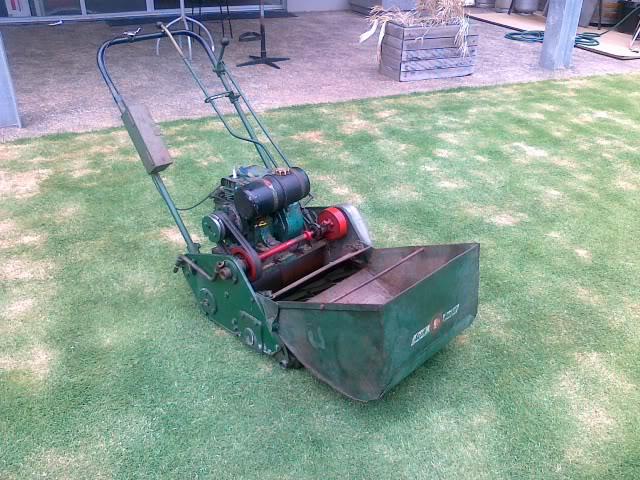

The following shot is an outboard mount version of the crank handle
Hi BB,
That is an easy one to explain mate.
You will notice that it has a Villiers that is mounted back-to-front when compared to yours, and is a clockwise rotating engine driving a double 'V' belt pulley to the large pulley on the counter-shaft, on the right hand side of the machine.
Your machine is driven by an anti-clockwise rotating engine with a small chain sprocket to a large on the counter-shaft,on the left hand side.
If the crank-handle was placed on the inside as yours is, it would interfere with the large double pulley and side plate, because of the handles length.
It is easy to see that in the photo. wink

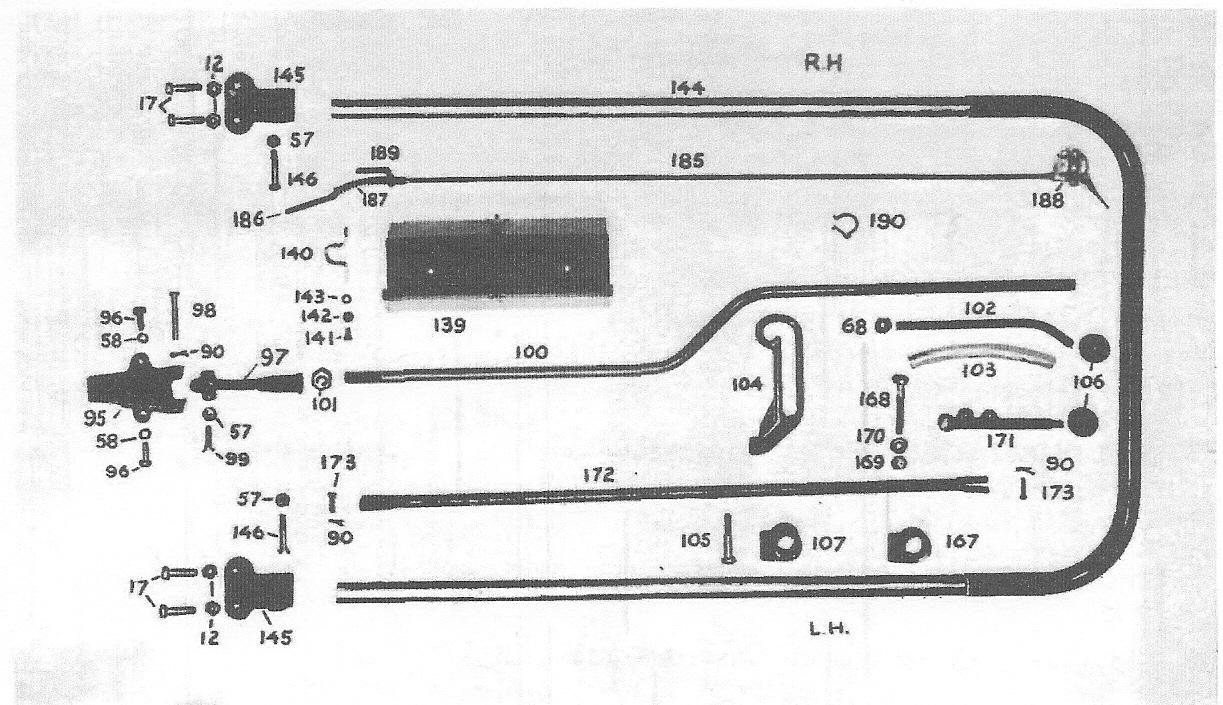

BTW, you will see that the Supercut in the photo also has a toolbox mounted on the right hand handlebar, I noticed in your pics, that both your petrol and electric don't seem to have one fitted.
I don't know if they were an optional extra or a standard fit...but you will notice in the original advert in my post above that it is not shown.
However, it is depicted in the Model 17 (Petrol) parts list shown here as part number 139 with the clamps (2 off) as part number 140.

BTW that photo I've posted up actually looks like an Electric unit that's been converted to petrol as the Electric mower uses a full width drive shaft with two belts.
BB
Hi BB,
The toolbox has been mounted in various ways, and yes, through the handlebar as yours has is one of them...the one on my electric was by 2 cast fittings (part numbers 107 and 105 in the parts lists above, with the nuts inside the box with spring washers) and also mounted using 2 'U' clamps which is also on the parts list.
That mower in your pic is original with the petrol engine, we had 2 of those used as greens mowers at my local golf club, both had the double 'V' belts and the clockwise rotation Villiers. wink
