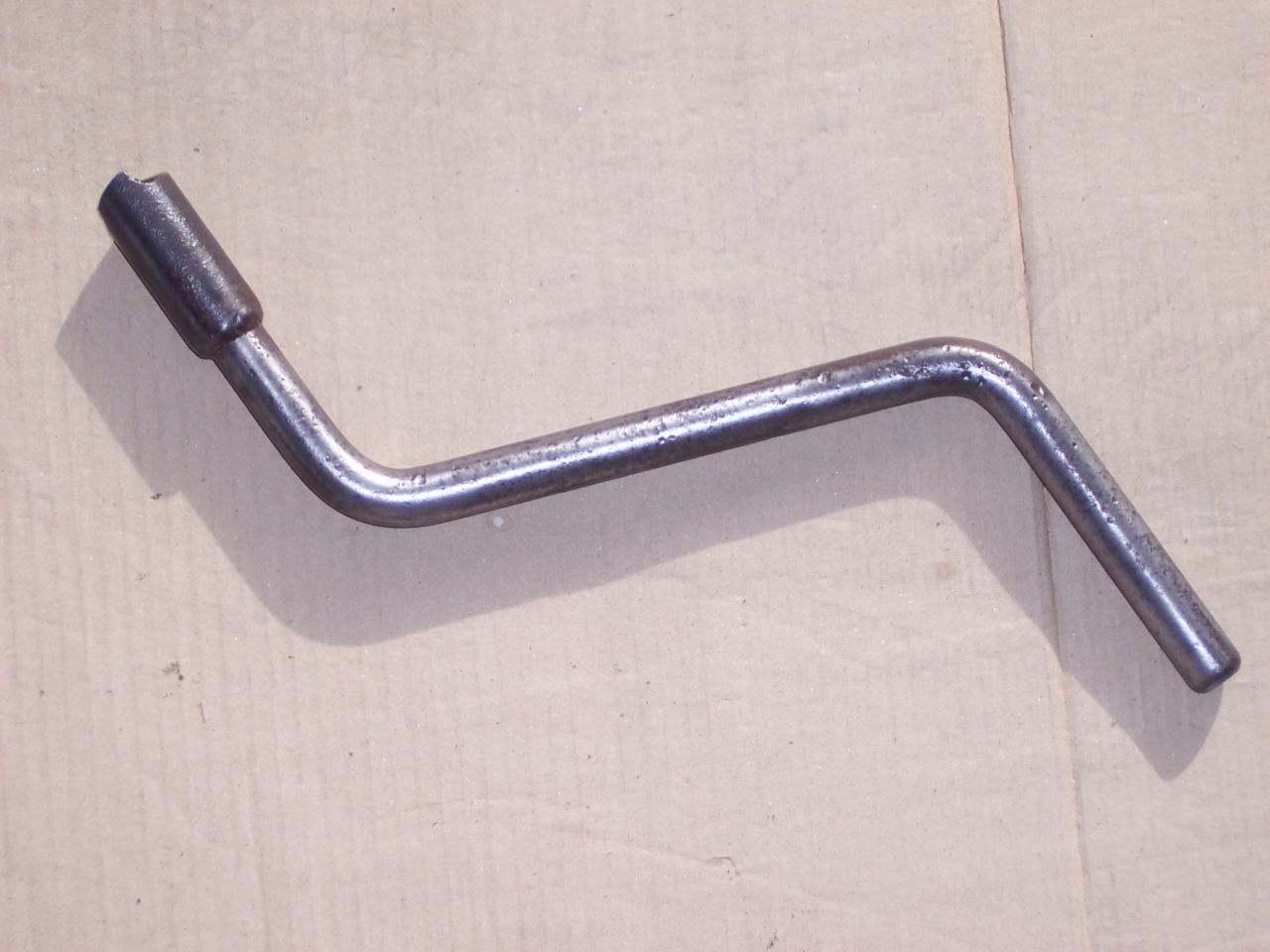

By the way, did you get the crank handle with the petrol Super Cut? It engages with a 'dog' in the front counter shaft bearing holder.

Now the magic crank handle, yes I was given this rusty item (yes I cleaned it, I have a habit of doing that before I take photos) along with the original air filter. I have to ask the question, what is it really used for as the engine is a rope start and is the original power plant I'd say.

Thanks for the pic with the crank handle in position, that is correct...and how you start the machine....you just turn on the fuel, disengage the cutter and drive clutches, set the choke and wind the crank handle...no rope, no fuss...easy-peasy! lol
The handle when not in use, slipped into a receptacle at the base of the right hand handle bar. wink
