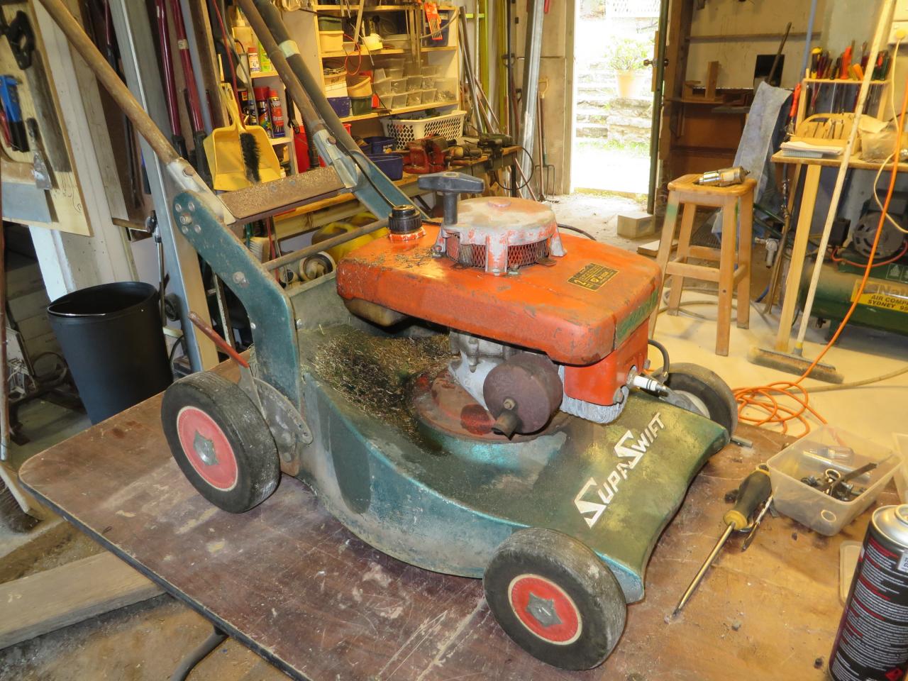

My SupaSwift You don't see many around, there is some other models on this forum but not this one that I could find
What I understand they started making mowers in 1955 but used other brands of engines
SupaSwift is still in business today and still Australian owned? If so that would make it more Australian than Victa
How many different models of SuaSwift are there and why do you see very few around the rally grounds

Hi Ian,
That is a very tough looking chassis design mate, and would make a fantastic restoration.
I couldn't find much info on that model....could you please post the model, type and code stamped onto the metal air cowling...that will at least give us the date of manufacture of the Briggs and approximate age of the machine. wink

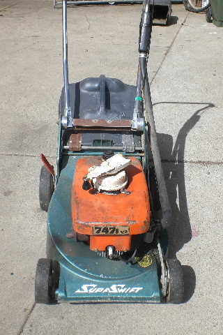

Just acquired.

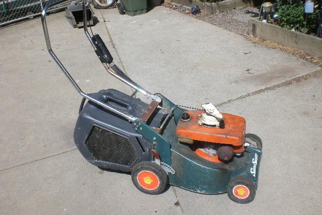

A nice machine. here it is.does anyone know what the catcher on this model would have been?
Catcher would have been the same as that shown on the Model 747V2 above.
Not sure what model yours is; it could be a later 747, or something like the storebrand MSAA Craftsman shown in this 1973 newspaper ad.
Likes: 9
thanks gadge. it has galaxy gt on the front cowl. and i have seen those catchers around from time to time so will keep my eye out for one.cheers

I have got a mower that's a supa swift base , as per the ones in the photos, but with no name "supa swift " on it. anyone have any info why and what it is. I am doing up a supa swift with a Villiers motor as per the al 's mower. the bases are quite retro looking and look even better with the Villiers engine.
