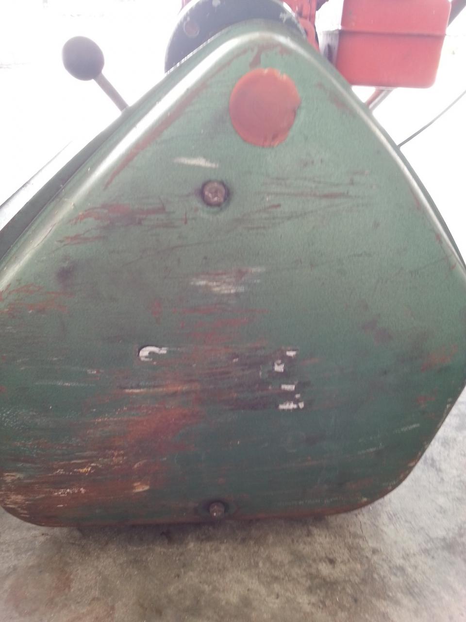

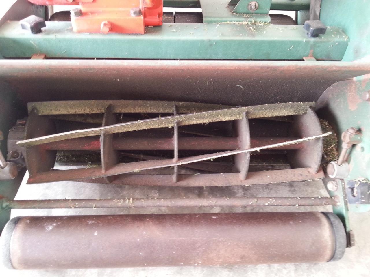

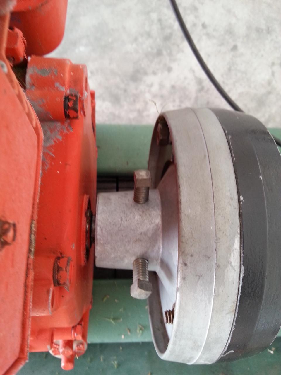

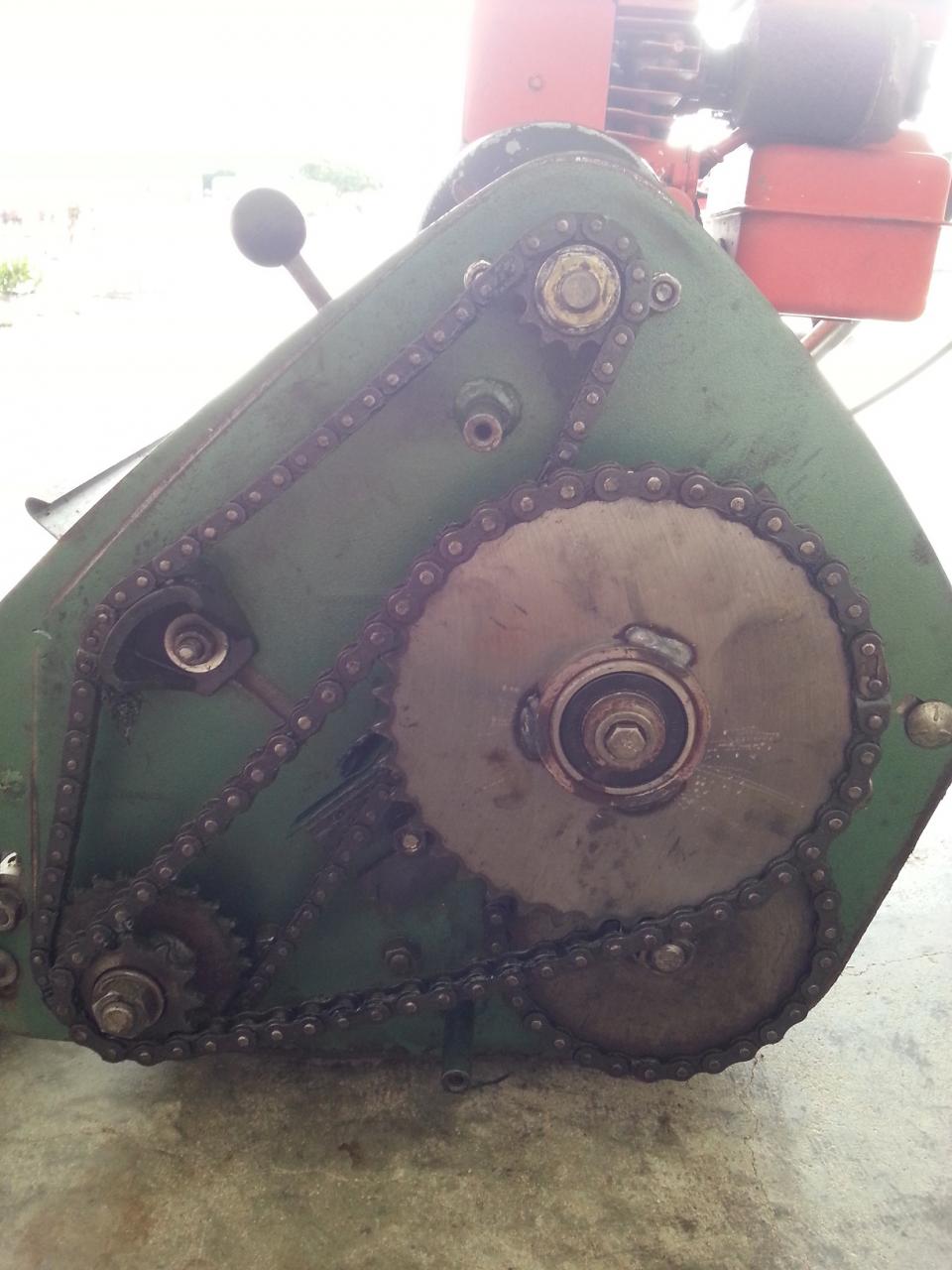

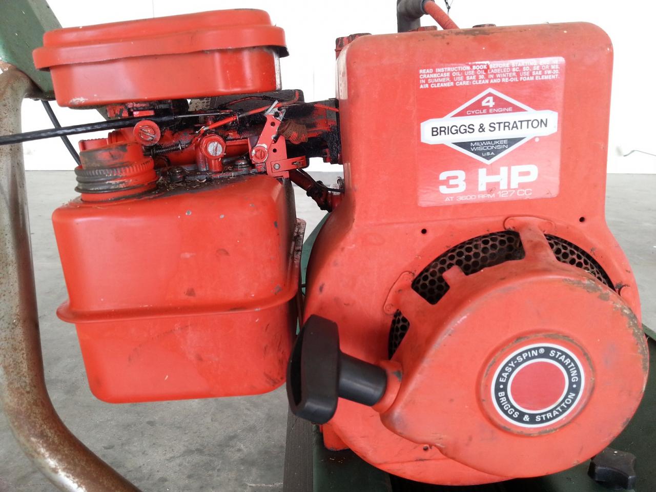

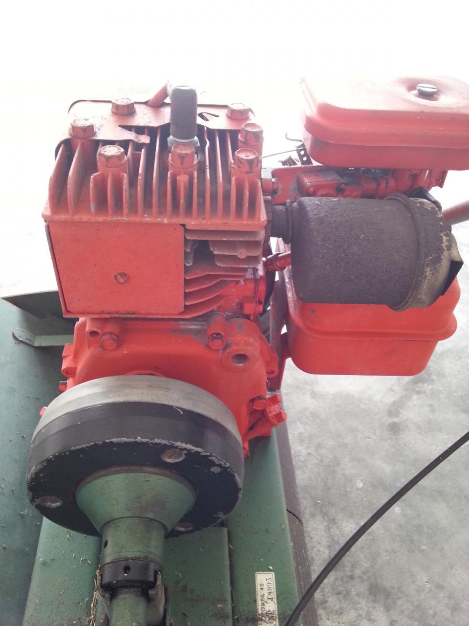

I'm now officially the proud owner of an SB45! I picked the mower up this afternoon and have already taken a few photos to upload. The label on the chassis says it is a Model 45 No. 18993. I'm not sure if this actually means anything to anyone but there is a photo of it below as well.
I've tried to get a few good photos of the cylinder. The gentleman I bought it off said it should have around 24mm of meat on the cylinder - does this sound about right? He is happy enough to make the new cylinder and will also replace the bed knife at the same time. What is everyone's opinion on the current cylinder?
The catcher seems to be in OK condition, few dings and a fair bit of surface rust on it. I'm hoping to eventually sand back and sandblast everything and get it powder coated similar to some of the other restorations on it. I don't really want to go too overboard, purely because I will actually use this mower weekly. But a nice fresh coat of paint to the chassis, engine and cylinder and a full clean up of the front roller, new bearings etc. is about all I am after.
I have attached several photos below - I think I managed to get everything that will be required. Let me know if any other photos will help.
Kenny.

Looks like a very nice base to start off with, well done smile. Could you please post the 'model type code' number stamped on the Briggs cowling (next to the fuel tank)? I'm curious when it was manufactured - I'm guessing late '79 early '80.
The reel needs straightening but you should get some life from it yet. If you do keep it, get the straightening done before you powder coat or paint it as it may wreck your nice finish otherwise wink

Our Inline Uploader will allow you to post 10 pics at one time, I have re-posted those that have not appeared in your post, here for you. wink
Re: your machine, it is a nice twin rail, Series 2 Scotty, The sprockets and chains look to be in nice serviceable condition....
The cylinder reel, in my opinion, is serviceable and has plenty of life left in it and does not need replacing....but I agree with Rolla, have the bent blades straightened prior to powder-coating and sharpening. wink
New cylinder reel bearings will probably be required, but they are not expensive and are essential in achieving the correct reel to bedknife adjustment.
The model, type and code may be hard to see as they are stamped into the metal air cowling of the Briggs and have then been painted over, and are adjacent to the carby intake manifold.
The Scott Bonnar decal on the chain case has been damaged beyond repair, but does confirm my knowledge that was white lettering with black edging.
The catcher will need some panel beating, but is in reasonable nick for its age.
The inner cutter clutch half has been replaced, and that is a good thing...they are a much better design.
The plastic thrust pad looks serviceable as well.
All round, a good buy, a machine that will restore beautifully, and will give you years of mowing pleasure.

I've attached a photo of the Model, Type & Code but it may be a little hard to see. To me it looks like:
Model: 80202
Type: 0879-01
Code: 81081003

Deejay - I noticed you mentioned that the inner cutter clutch has been replaced with a better design - may I ask why this is? The only ones I have seen on here seem to be the 'cotter pin' single type of fixing. This one appears to have 2 screws on the drive shaft - is this any different?

Your engine was manufactured on the 10th August 1981, in Rolla, Missouri, USA.
I think in regards to the reel, you suggestion of getting a second hand original Scott Bonnar reel would have been in my opinion, the best option.
Making a reel from scratch is a job that requires specialist equipment in forming the twist of the helix in what is tempered high carbon steel.
have a look at the video here...you can see the blades being formed....
In my observations, your current reel will last you a long time if used domestically. wink

The inner cutter clutch half fitted to your machine, is a much better design in that it has a better fixing method to the PTO engine shaft. The grub screws are 90 degrees opposed and one secures the engine shaft key in its keyway, and the other secures the clutch half to the shaft.
The captive cotter fixing method is a design failure and suffers from damage by the key moving in its keyway and damage to the thrust bearing. wink

Well I was a year off on the engine but close rolleyes It's an 8 cubic inch (127cc) with a pulsa-jet carb and from your pics it looks like it has the linkage type choke that engages when you pull the throttle control all the way back. Here's some specs..
You can get the engine decals with the correct white/silver/red/black on a clear background from the US via ebay and they're nice quality. I'm getting some numbers together to get some made locally but we're a couple of months off yet.
