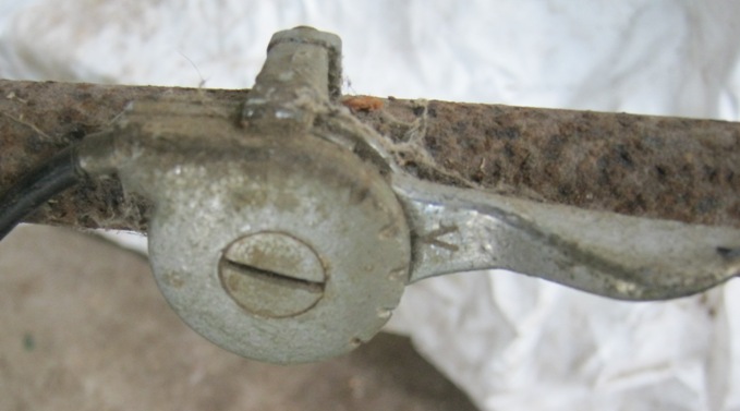

have got a question on throttle, what Model or engine # change had the bakerlite? or Plastic? & steel throttle like the one below?
Cheers.
Are you sure that throttle lever is steel jonesy? It looks to me as if it could be diecast zinc.
Posts: 539
Grumpy, you are most likely right, I should have said metal not steel, it's just not plastic like on my M2, I also noticed the same one in post #49161 of Unkie's on a M5 series 3?
You can tell whether parts are zinc (or if they are not plated, perhaps aluminium) in various ways, but usually I just look to see whether it is a die-casting. Iron and steel are not suited to die casting because of their high melting temperature, though they can be sand cast. Zinc is even easier to die cast than aluminium, and is stronger. Incidentally, for some reason Americans like to call zinc "pot metal".
Of course steel or iron, unless it is an austenitic variety of stainless, is magnetic and few other metals are, so you can usually detect steel and iron with a magnet.

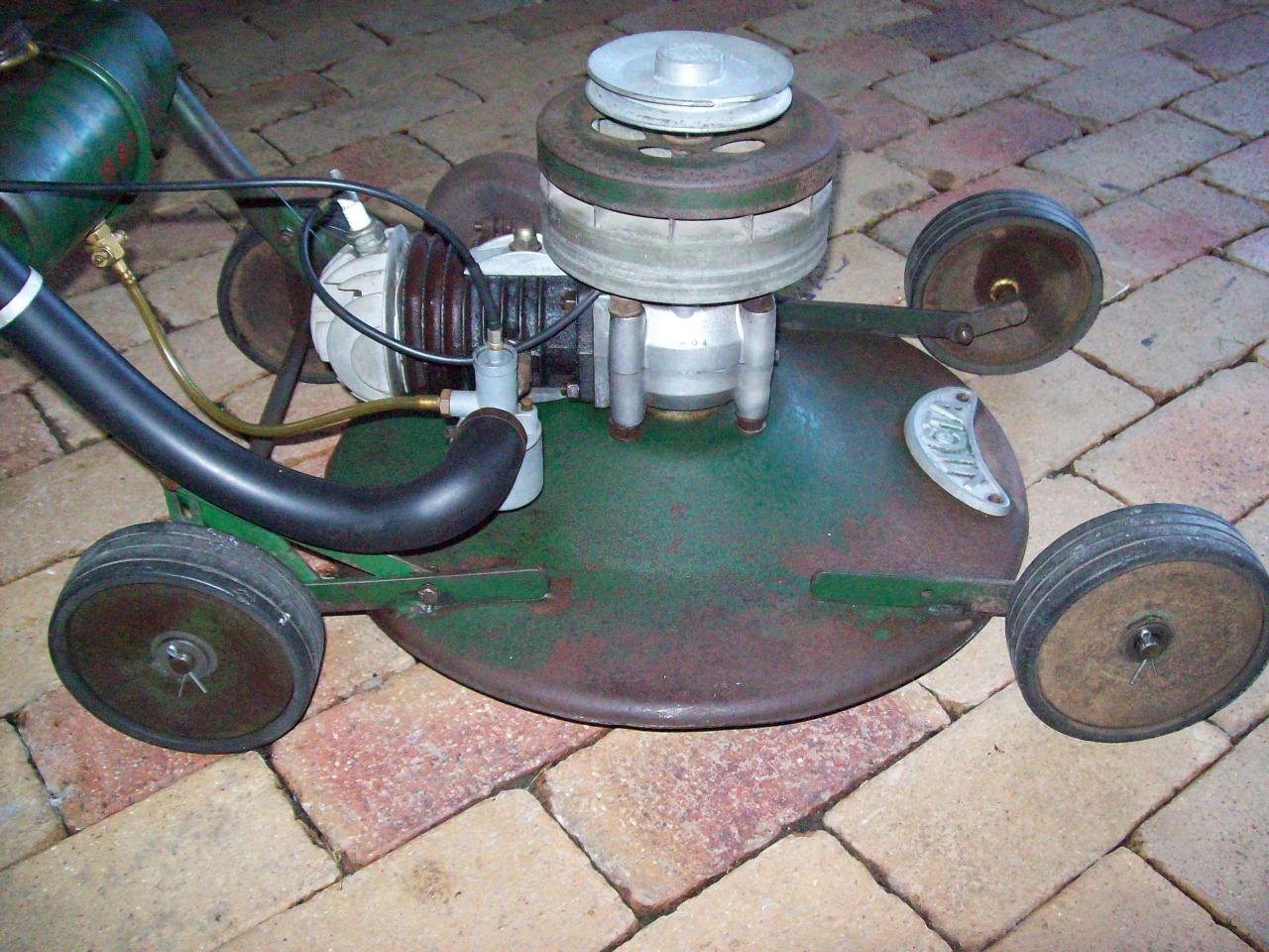

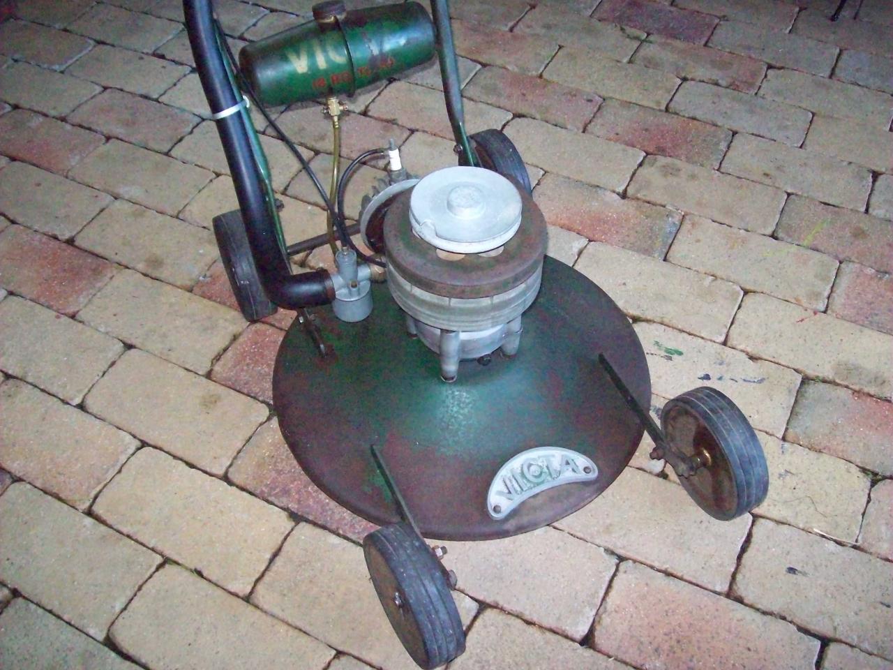

sorry its a little late...The Green Victa badge as fitted to the first Rotomos "The billy cart" Mk 1 Fan and an undetermied amount of Mk 2 fans. This badge has also been seen and confirmed accurate to very early model 1 Rotomos.
The intersection of green to red appears to have been somewhere in the latter period of the Mk 2 fan run with both Mk 2 fan and early Rotomo model 1 recieving either.
This example is one of 3 unrestored model 1s I have in my collection,it is original and untouched. Of the other 2 one has the green badge the other the red.
Both green badge models are below the 1000 serial.

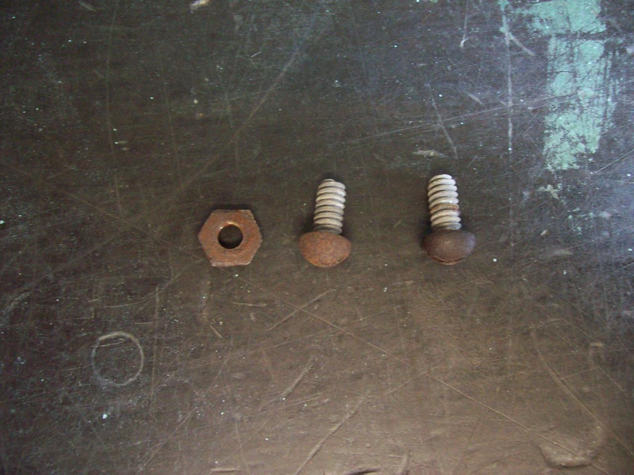

Correct screws and nuts for the Rotomo displayed are identical to the ones fitted in the images and the others I have in my collection.

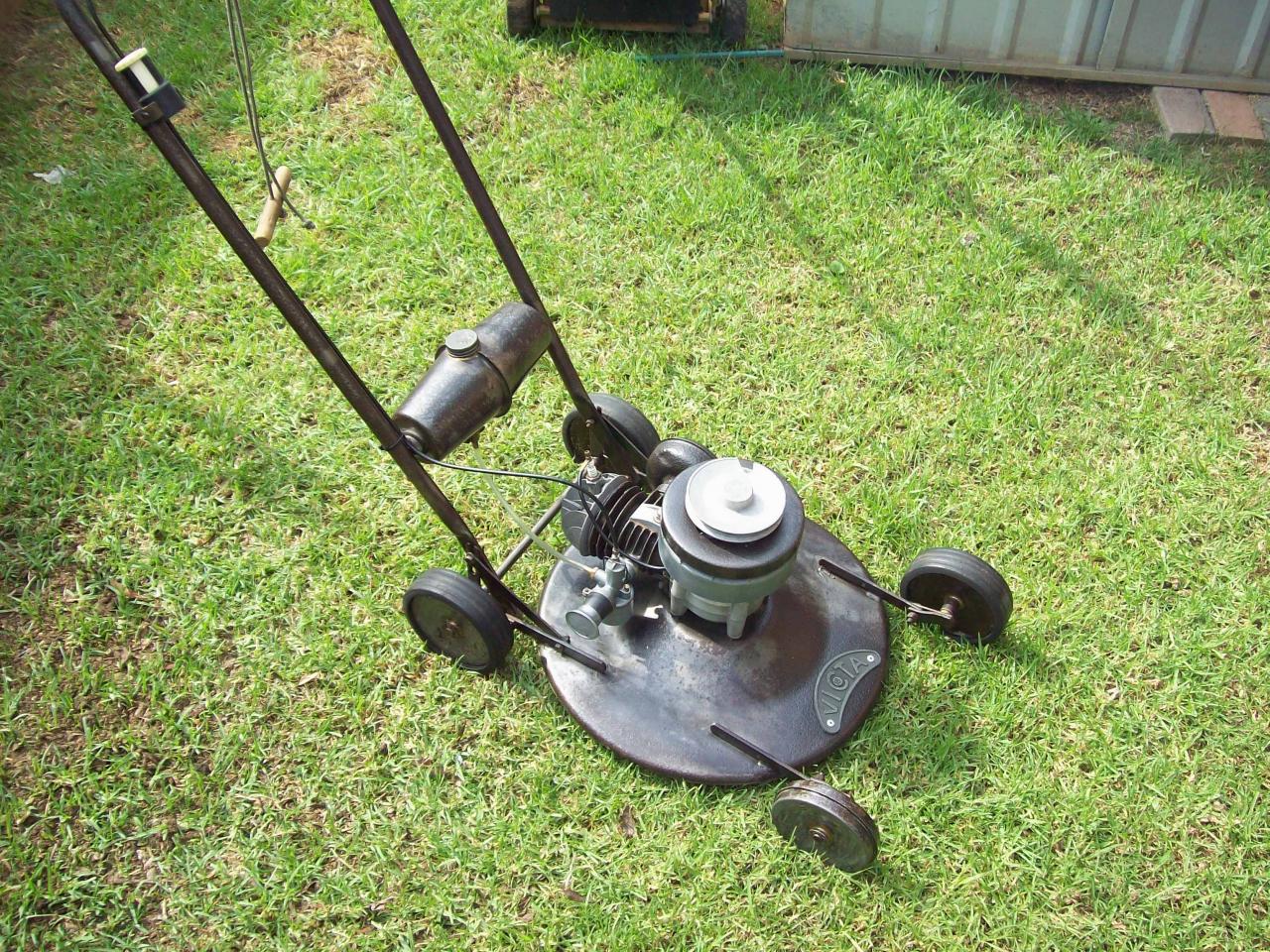

This is Rotomo 2 serial 96,000 so one of the last model 2's made.
The image isnt the best but it shows the same screws fitted to the earlier models,showing that at this point rivets were still not being used.
This was on display at fairfield machinery museum...yeah I bought it lols.

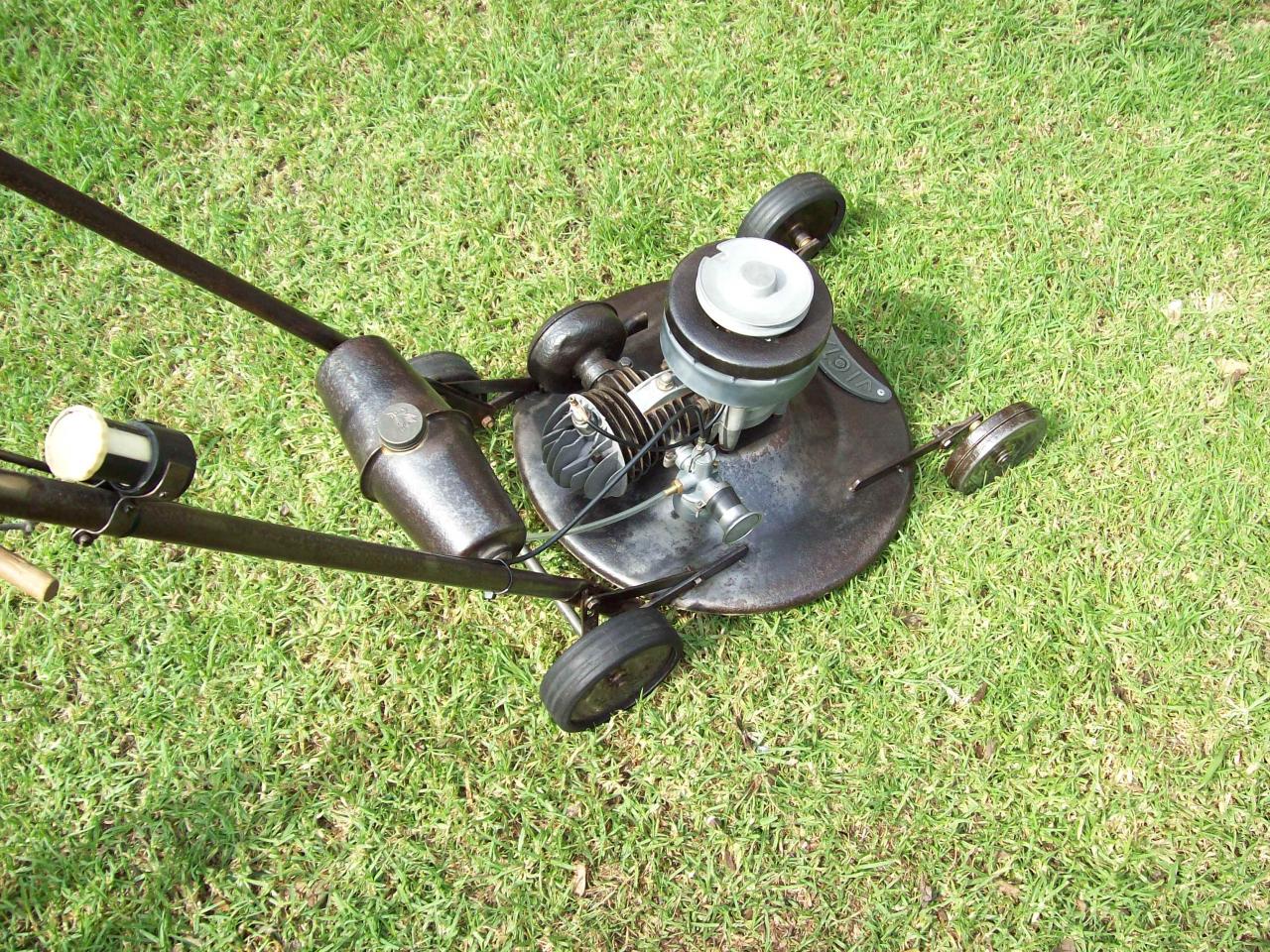

Its an original Rotomo 2 serial 70,000+ and was donated by the original owners estate.
This is an example of enhancing an original mower without full restoration so as to keep its original patina and history.
This was fully stripped,everything cleaned and repaired and missing parts replaced. Engine was stripped,honed SH piston and new rings+ new full gasket kit+ rebuilt electrics+ HT,new throttle cable and new brass wheel bushes. Enhanced all the parts to bring out the remaing colour,then fully coated the steel with penetrol to bring out lustre and stop further rust.

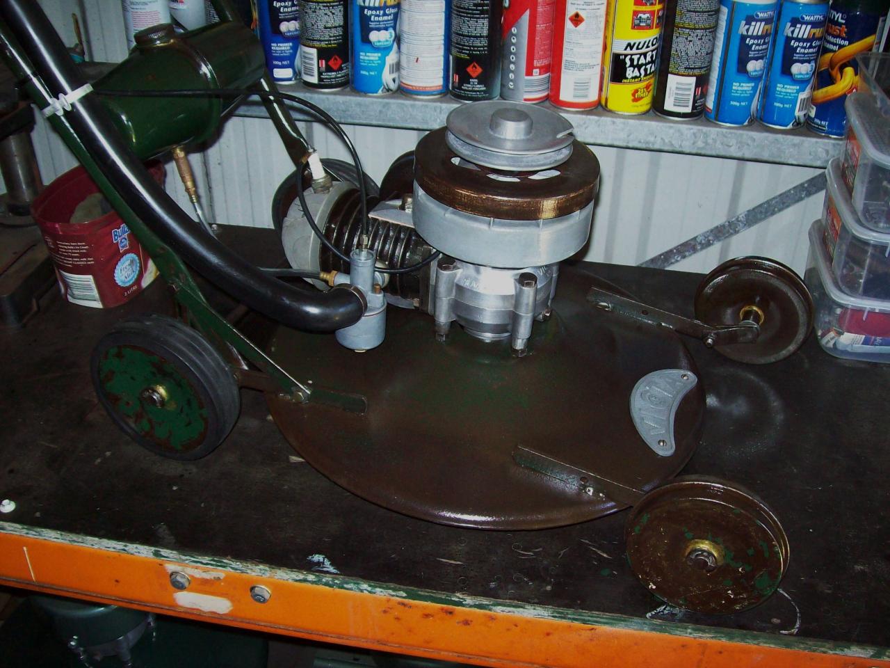

One of my favourite Rotomo Relics. This Is Rotomo 2 Serial 30,000+ its not my earliest model 2 but this one highlights the correct use of left over model 1 parts even up until this serial and with examples beyond.
This is a correct model 2 as sold. Model 2 tin wheel chassis running model 1 throttle control(not fitted as I stole it for another model 1 lols) engine,barrel and brass nut carby as per model 1. The combinations varied model 2 engine model 1 barrel and model 1 head or model 1 brass nut carby model 1 barrel model 2 head and so on. these transitional models are accurate and sold this way to use up existing stock. Model 1 engine parts only were fitted but always the correct model 2 chassis was used. Note this was random or sporadic as and not the norm for all early Rotomo 2 Models.

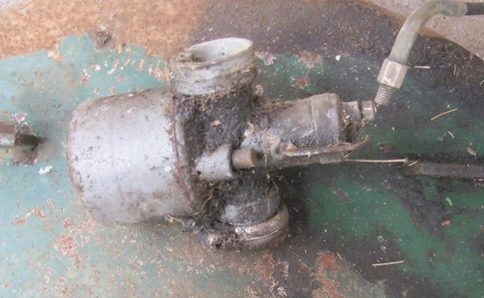

Restored as found,busted choke assy no snorkel no front tyre,pretty wrecked head and field modified villiers carby mesh filter and hose as fitted by previous owner.
Shes a real beast and one of my best runners and was also one of the worst condition Rotos id seen prior to resto,just a pile of rust and siezed parts covered in and inch of mud. But one of my favs as its the only transitional model I own....I like to think of it as Rotomo Model 1 1/2 lols.
