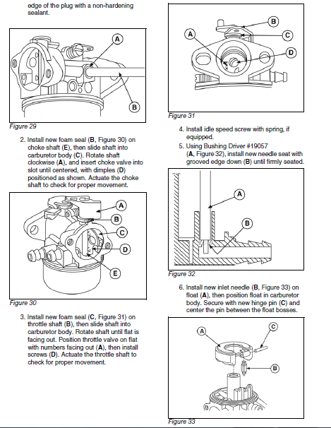

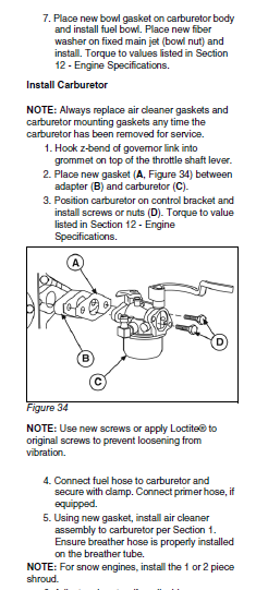

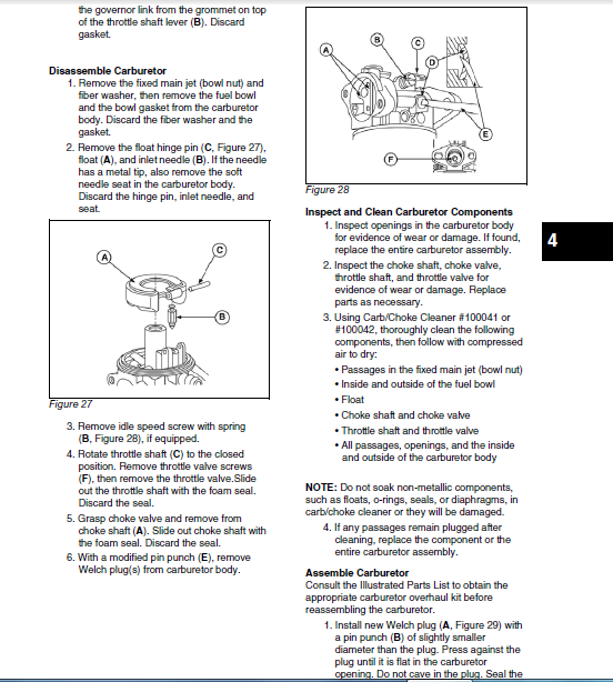

If you go to Page 4 of the IPL, you will see there are two basic versions of the carburetor which might be fitted. From the date code, yours seems to be the earlier type: 125, not 125D. It appears to be a Walbro LMS carburetor. Here are the disassembly and reassembly instructions from the shop manual:
The overhaul procedure Briggs specifies is very comprehensive, but probably unnecessary in most cases, especially yours where all you have is some jelly and perhaps gum in the carburetor, rather than a wear problem. Personally I would just clean everything as specified, but would not remove Welch plugs, throttle and choke shafts, and the float chamber seat. You will notice that replacing the float chamber seat is relatively difficult. Otherwise I would follow the manual and install the easy parts of the kit. If you have questions along the way, or if there are still issues after you follow the process, let's try to work them out in this thread. If, on the other hand, all is well and it works perfectly first pull, please tell us in this thread so we can close the case.
