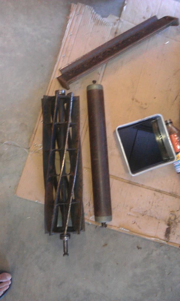

Hi all, I am very new to the reel mower world, but thanks to this forum I have learned a whole lot.Last week I obtained a 20" 45. I originally thought I would use it until the end of summer and then do a restoration in winter but after closer inspection needs a bit more work so I have most of it apart and may as well restore it now. I have a number of questions,
* are the parts all the same part no for all 45 models? 17" , 20" ect I know the cylinder bearings are different and different drive shaft sizes.
* I have not been able to find a manual or parts list on the net except on this site but most parts refer to a 17" machine.
I also wondered Deejay where do you get your reel sharpening done in Wagga?

The differences are only sizes in certain components Timmy, mostly in drive-shafts, rear rollers, catcher, chassis frame, sole plate, 8 blade cylinder reel, bedknife, lower handle etc. There was an early solid deck, (Series 1) and the twin rail (Series 2) chassis designs.
All bearings, including cylinder reel are the same as the 17". wink
Don't forget the baby of the family, the 14" and the same applies. It is only concerned with the width of the machine, all other chassis parts are common for all models. wink

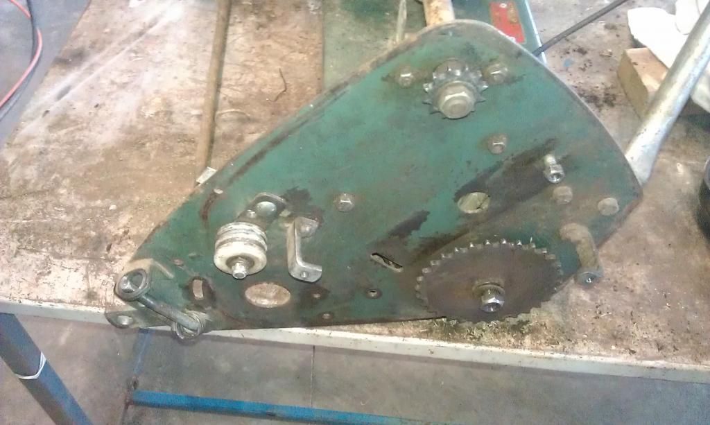

Thanks Deejay, I will try to post some photos I don't have any of the mower together but I have a few others. I have a solid deck with a Honda G150 retrofitted. My chain adjuster looks different to others I have seen on this site.You may notice the dodgy clutch setup I will be repairing that. [Linked Image from i1037.photobucket.com] [Linked Image from i1037.photobucket.com] [Linked Image from i1037.photobucket.com] [Linked Image from i1037.photobucket.com] [Linked Image from i1037.photobucket.com]
Ouch, somone really did a number on the parts there, when I get it brought back, I may (whether they are in good condition or not) be able to supply some parts from a 14" scotty I just bought, it should be here in the next fortnight or so. Worst case, there was a 20" one being sold locally pretty cheap I was looking at for myself but it would be just too big for my yard, I can chase that up and see if its still available.

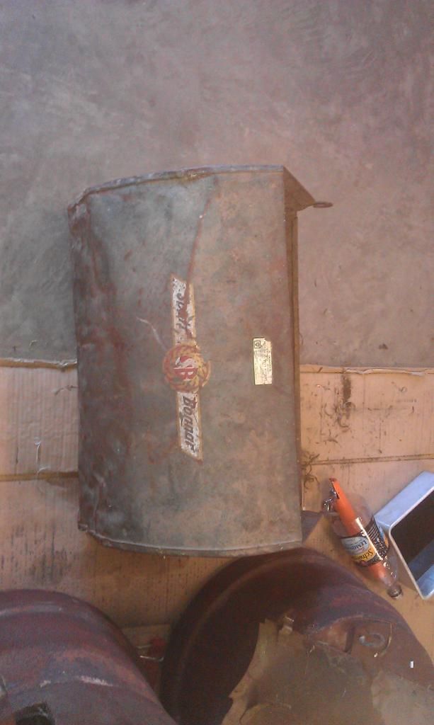

Thanks Joe, I would be really keen on the 20" if it was available, if I could salvage the clutch, shaft and lever that would really save me some money. The mower was all together when I got it I have stripped it down. Engine is in great cond. My to do list as follows: replace all sprockets and chains, reel adjuster bolts were seized ,all bearings and the clutch.(half should be ok) I don't mind buying new Chain and sprockets as I will be using it myself at home. Chain case cover will clean up ok with a bit of panel beating. Catcher is very rough but I am going to try to reproduce it myself as I am a sheetmetal/welder. I was originally prepared to buy a fully restored mower but I am a sucker for a project.

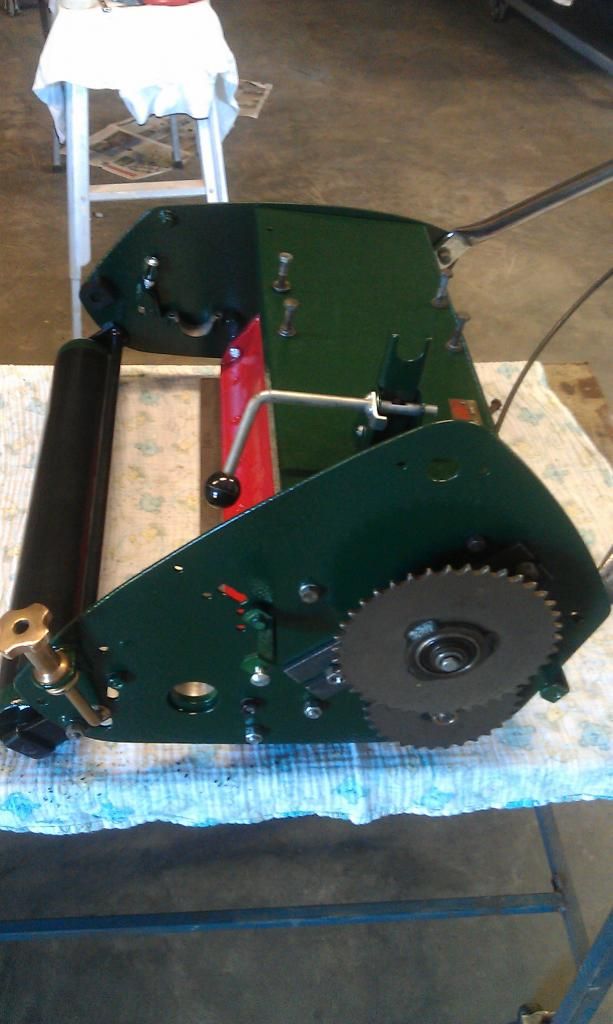

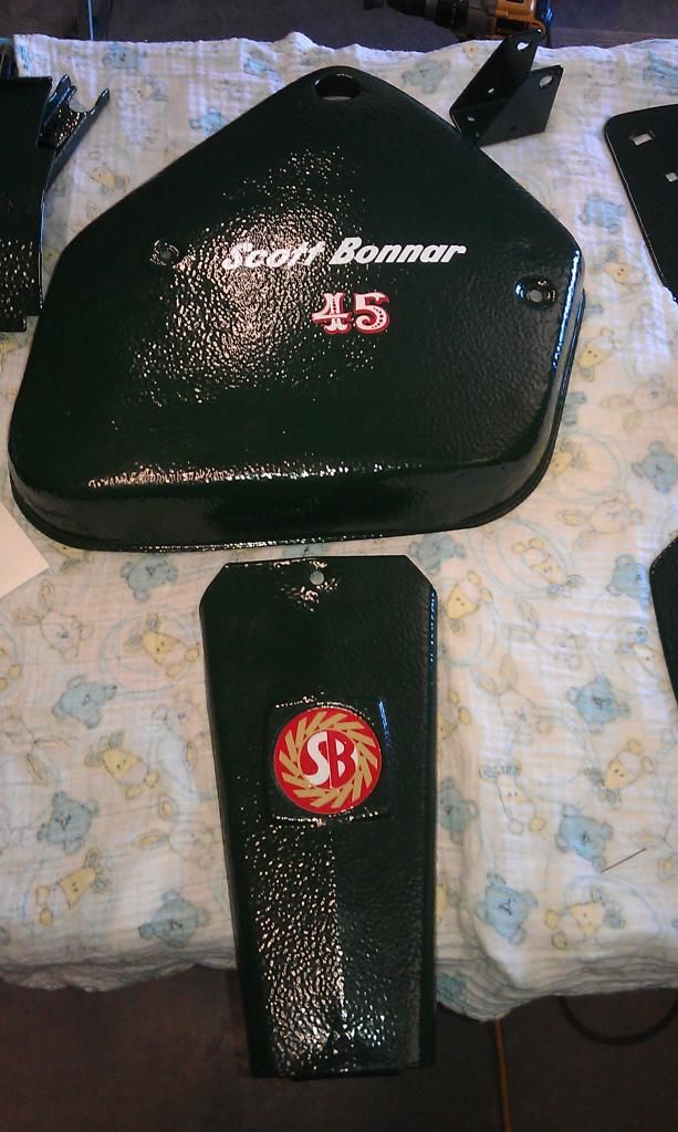

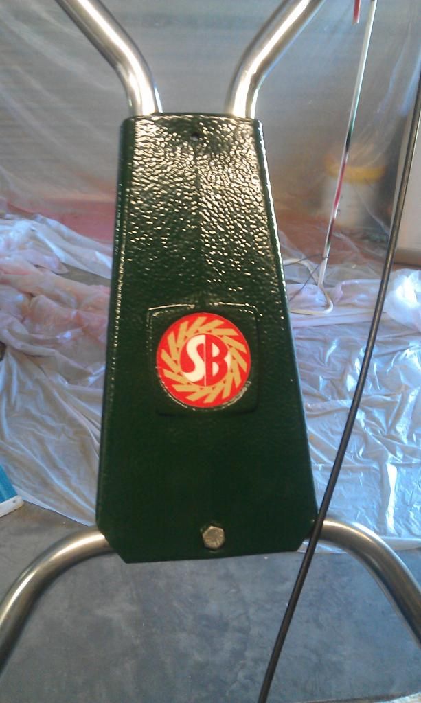

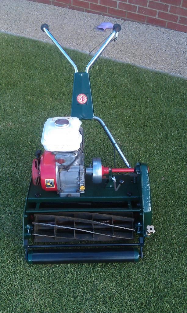

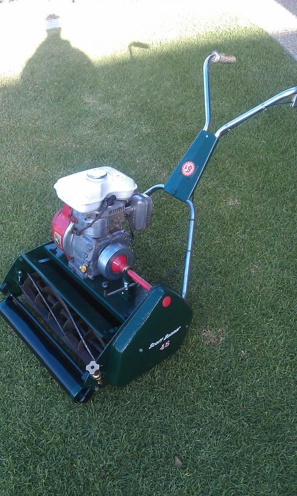

Finally got some parts back. I went with a powdercoat finish in the end (deep Brunswick green).Started to reassemble yesterday,having trouble getting my reel sharpened but have all other parts ready to go back together.

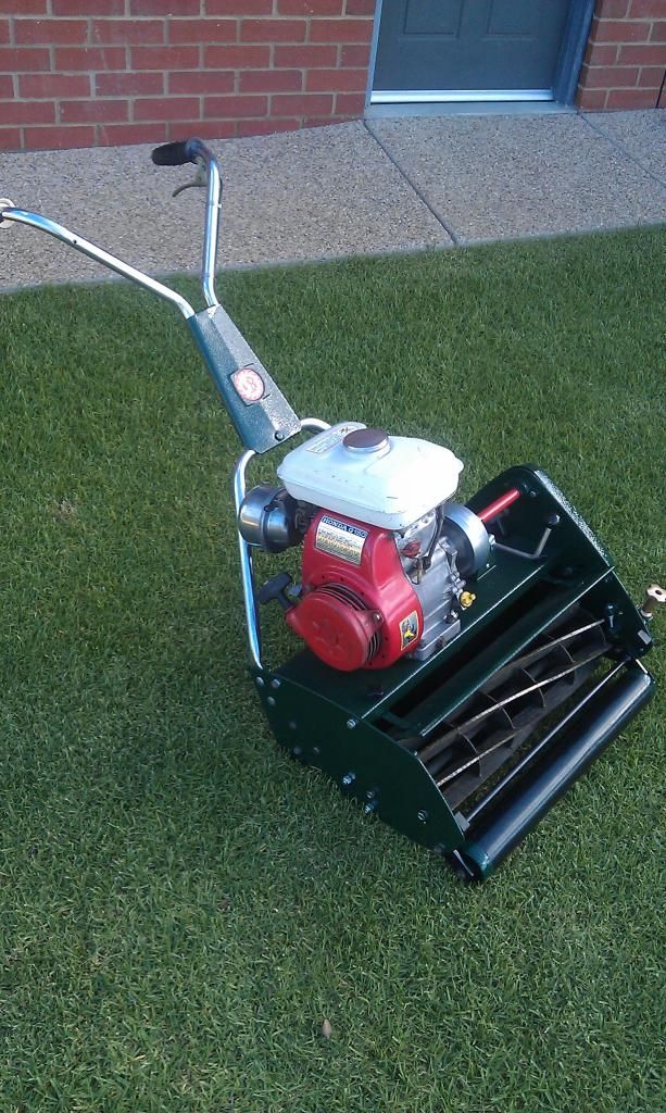

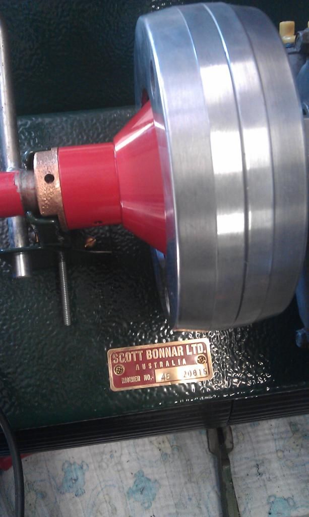

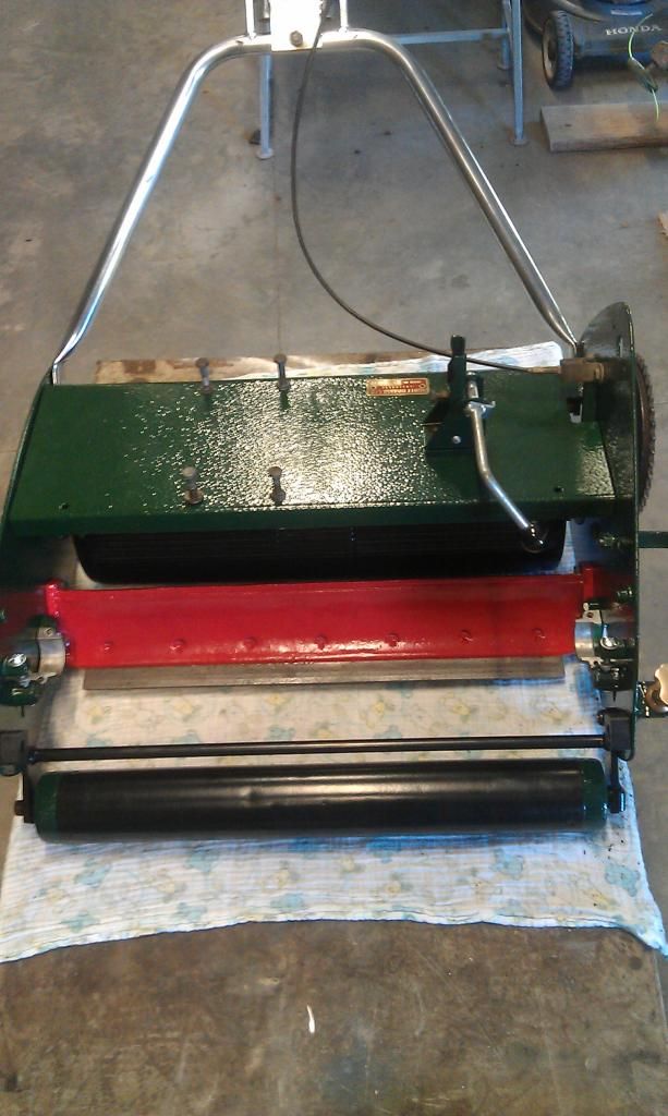

Finished assembly yesterday happy with the result. Reel still needs sharpening and powdercoating. I am tempted to give it a run I wouldn't mind having a play with reel adjustment before sharpening.

congrats on a great restoration, your Scotty is looking brilliant in the new paint, by all means have a play with the reel to bedknife adjustments....practice makes perfect mate.
Thanks for posting the pics.... good1
