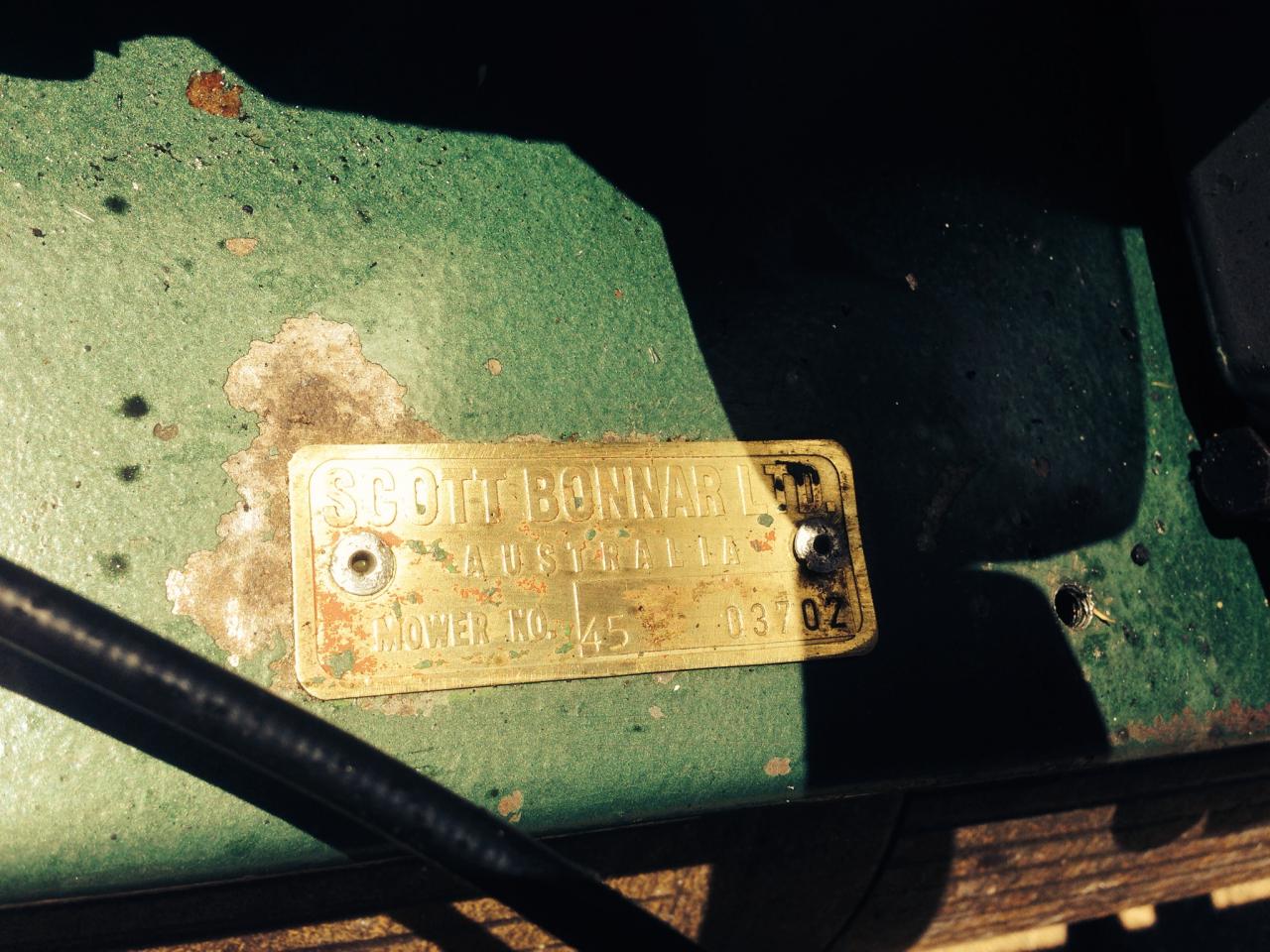

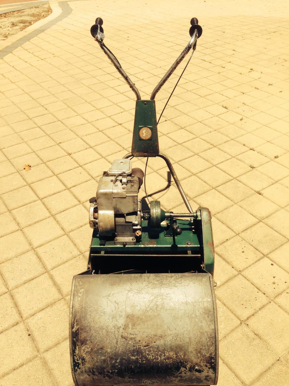

Just trying to ascertain the age of this 17" SB45 that I picked up for a steal. yay
It's mower number 03702 which I'm assuming is an early model. A couple of different features to my other 45 are the following;
  • Engine plate is solid and bolted at the sides
    • cluch lever base is screwed down and not welded

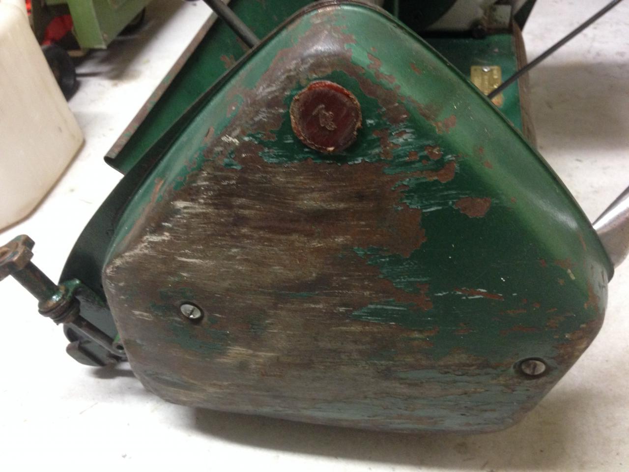

      • side cover has horizontal screws and not vertical
    • forward control cable mount is different.
      It has a silver 2hp briggs which I'm thinking is not original but should be a kirby instead.
      I know that the catcher is from a new model and lucky me, nearly dent free laugh
      Any info or photos would be greatly appreciated. [Linked Image]

This one will be hard to date, because as you may know, the Mower Number is useless for dating a Scotty, as they didn't run sequentially.

Deejay will know the answer for sure, but I don't recall there ever being a 2 hp engine on a 17" SB45. Those 6 cubic inch engines only went on the 14" machines IIRC. The 17" models had engines of 2.5 hp and more.
Your engine is old, being silver - probably 1960s, and probably a 60102 or 60202. I suggest you preserve it in case you ever acquire an SB45 it belongs on. The engine is as much a classic as the SB45 itself.

Grumpy is quite correct, the silver 2HP. Briggs and Strattons were fitted to the early 14" Scotties, whilst the 17" machines were fitted with the Kirby Tecumseh (Lauson) HK 30, 3HP. 4-Stroke engines.
Some of the very early (1968) 17" machines may have been fitted with the Kirby Tecumseh HK 25, 2.5HP 4-Strokes.

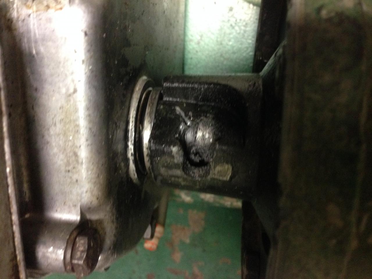

I'll be restoring the Briggs and keeping as a show piece. I rarely see them in silver. The PO drilled through the Scottie clutch and crank resulting on the crank spindle breaking off leaving jus 1/2" left so a new crank is already on the shopping list. I'll create a rebuild thread for the briggs, it will be my first engine rebuild. Following that I'll do another thread for the original Tecumseh on my other mower.

Thanks Tony for your reply, its a real shame that the previous owner did such a shoddy repair....I hope you can source a serviceable crankshaft for it.
Please don't forget to post the Model, Type and Code for it, that way, one of our members may be able to help you with a replacement. wink

Why you should not drill through the crank.

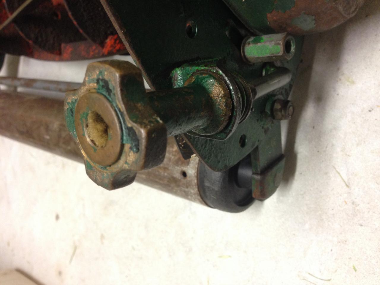

Solid brass height adjuster. Would polish up nicely.
Horizontal cover screws

The sprockets and chains look in great condition...I also notice the the front roller end-caps have been replaced with the later plastic ones, the original ones were alloy and you can see the holes in the roller where the rivets were drilled out that were used to attach the alloy caps.

Your machine is an early solid deck...impossible to date it, but between 1968 and 1973 I would guess.
The silver Briggs is definitely not original on this machine...all 17" machines were powered by Kirby Tecumseh's. wink
