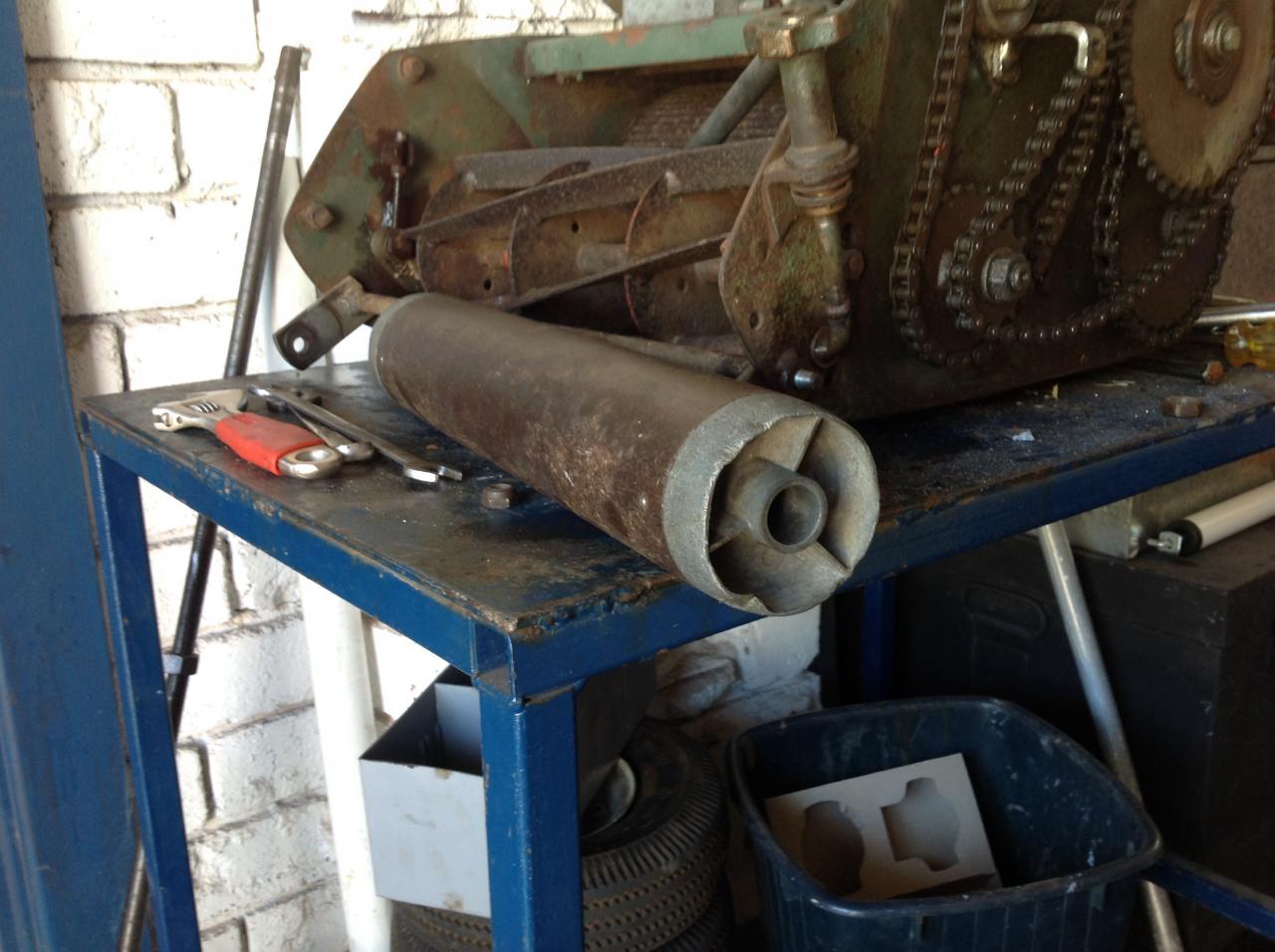

I'm new to this Scott Bonnar reel mower subculture! After recently laying new lawn (sir walter) I decided that the old rotary mower could not do it justice and that it was time for an upgrade. Finding out how much a new reel mower costs was a definite eye opener!! I decided to look for something second hand and this weekend purchased a 14" SB45 for $100! It runs quite well for something that has been "sitting around" for years in a blokes shed. Oil change, carbi clean and tune, air filter clean, and fuel system clean is all that is on the cards engine wise. Also plan on re spraying the frame (early model I'm assuming as it's a single piece frame and the grass deflector attachments are steel screws rather than plastic?) Front roller is in sound condition and should only need a clean up, however on removing this today I have found the roller shaft to be flattened / worn at both ends so may need to be replaced?

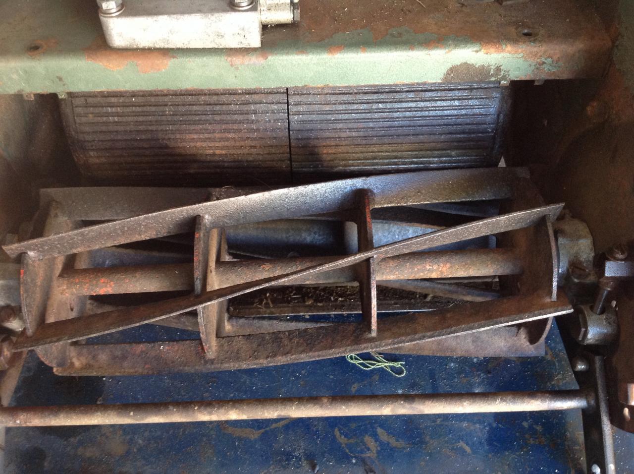

The reel and bottom blade are in dire need of sharpening however I believe there to be plenty of 'meat' left on them for this (will post pics tomorrow for comment on this one please?!).

My front roller ends appear to be aluminium? Are these removable and replaceable? If so how? I see that the replacements are plastic - is it best to stay with the original (not in bad condition but will need some work)?

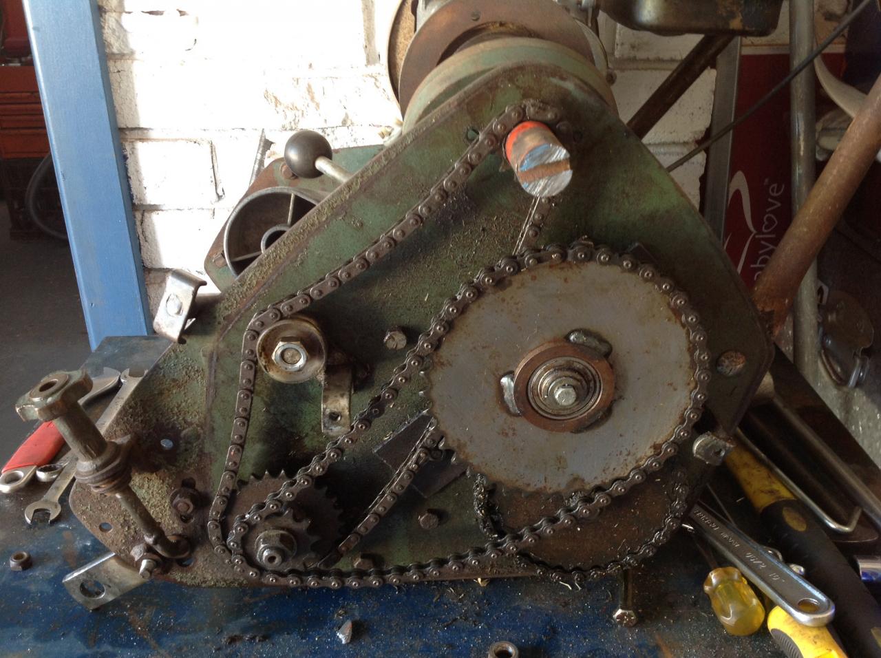

On taking the the chain cover off it is apparent that the chains are quite loose. I've noticed that the chain tension adjustment and bushing appear to be different from the images I have seen on this forum. The bushing is white nylon / plastic, round and grooved for the chain to run over I presume (or is this just wear?) and when adjusted still allows for more than the 1/2 inch slack prescribed?

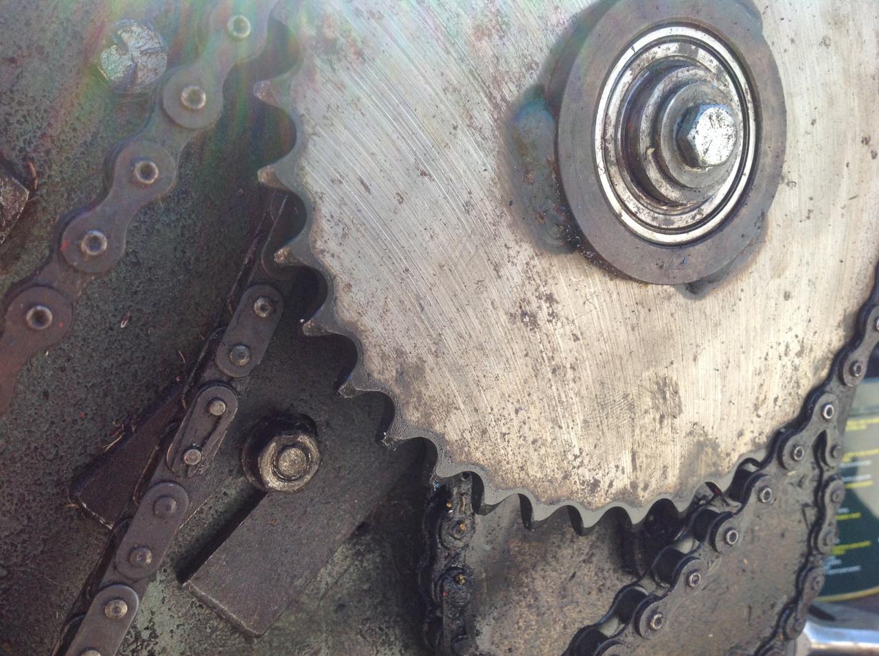

In order for us to give you the correct advice, we need some photos of your machine, from different angles, including the cylinder reel, bedknife (bottom blade) and inside of the chain-case including all chains and sprockets especially where the sprocket is not covered by the chain. wink We can then assess the overall condition and make some observations.

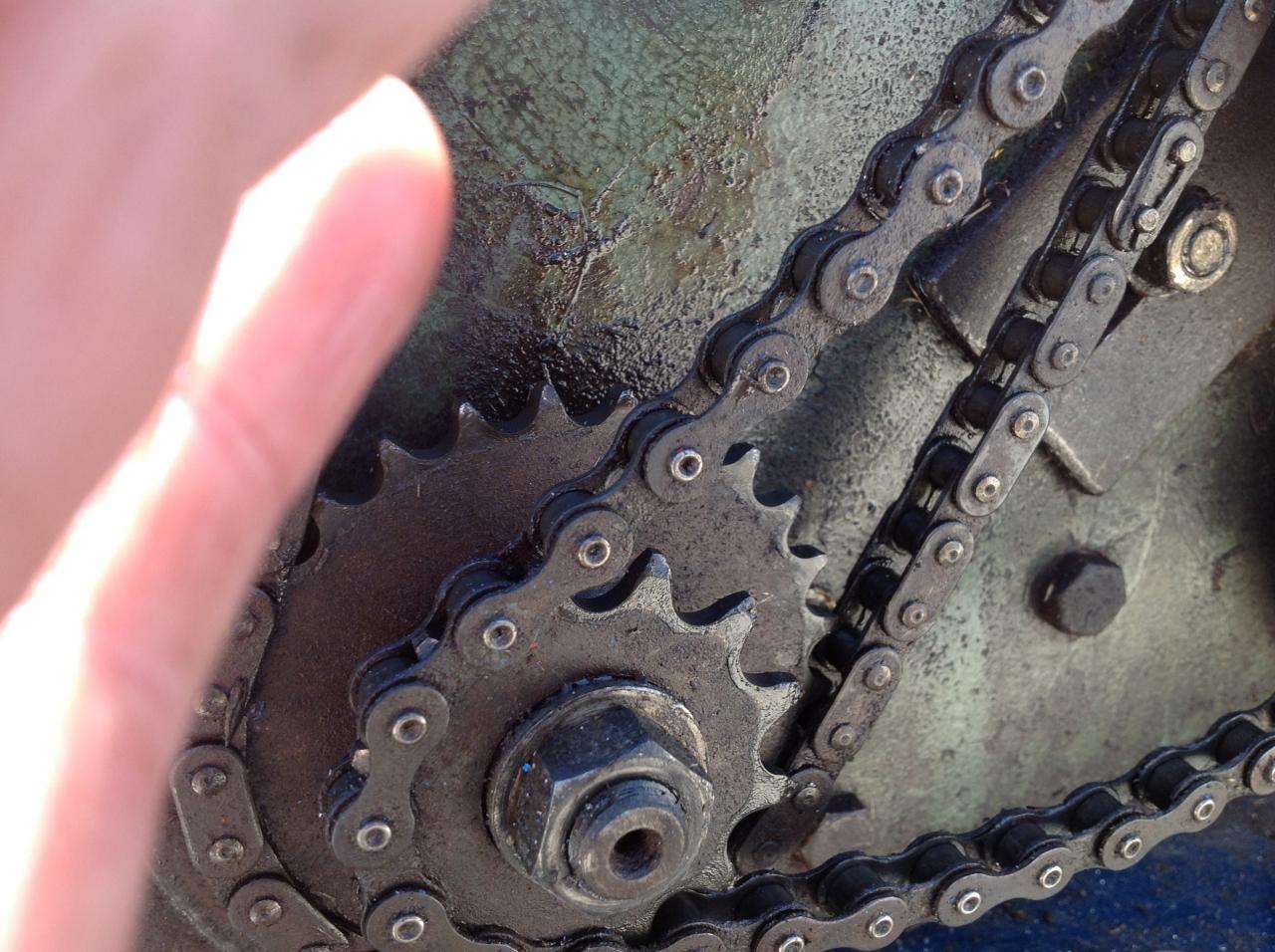

I will also need a close-up of the top (12 tooth small sprocket with the old edger pulley was attached...this may prove hard to remove, but we will get there! grin

The worn front roller shaft can be repaired by building up the worn areas by welding and then turned down to the correct diameter, or by using brass sleeves to slide over the worn areas, and secured in position. New shafts for the 14" machines are not available, but are for the 17", one of those could be cut to length and a new thread turned by an engineer if necessary. wink
The alloy roller end caps of your machine could be repaired by re-bushing or you could purchase the plastic ones from our Online Store...see HERE if you are not worried about originality.
Yours can be removed by drilling out the rivets and pushing out with a long drift...they just slide into the roller tube. New alloy ones are not available. cry

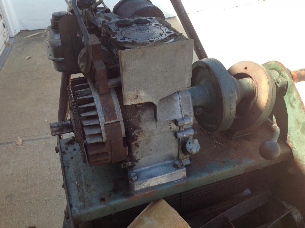

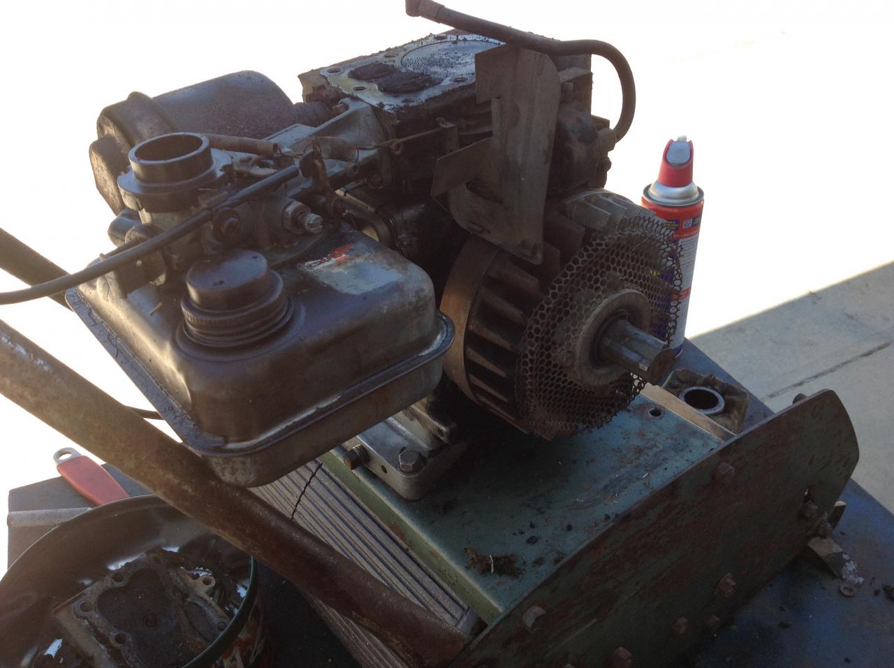

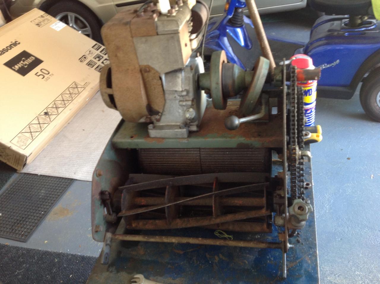

Thanks for the reply. Here's the photos. Model no is 45 00917. I'm having great difficulty finding the no for the b&s engine? Where should it be?
The old man decided to take the head off so it looks like we'll be sorting that too!

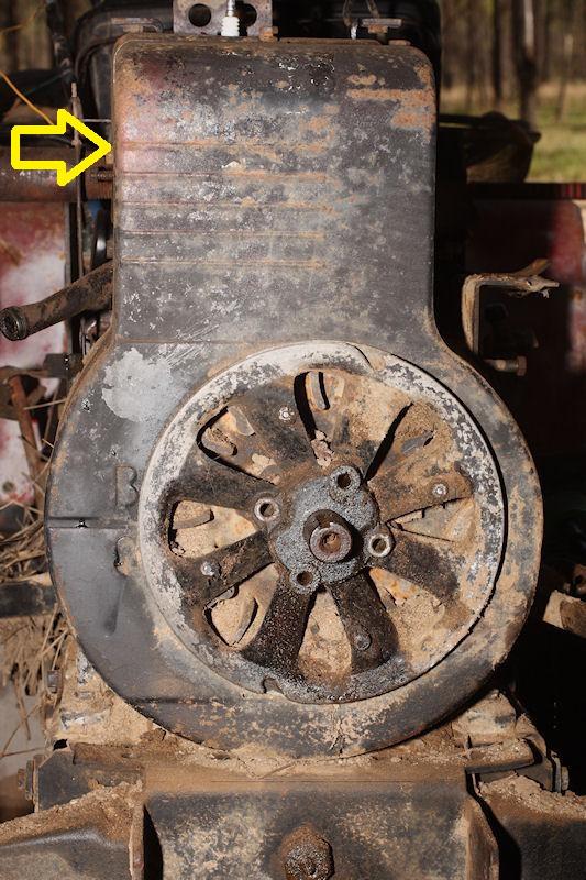

The Model, Type and Code information should be stamped on the side of the metal cooling air cowl above and forward from the intake port, at the tip of the yellow arrow:
or alternately, it may be on the area as in this post
HERE
You may have to clean the cowl and carefully examine it, but it will be stamped there somewhere. wink
To remove the old PTO shaft of the edger, leave the chains on, place a piece if timber through the cylinder reel to arrest the drive assembly, spray the small top sprocket with Penetrene or equivalent and use a suitable wrench to remove the old shaft.
From memory, it is a normal right-hand thread and unscrews anti-clockwise.
You will need to source a new nut for the engine cutter sprocket.

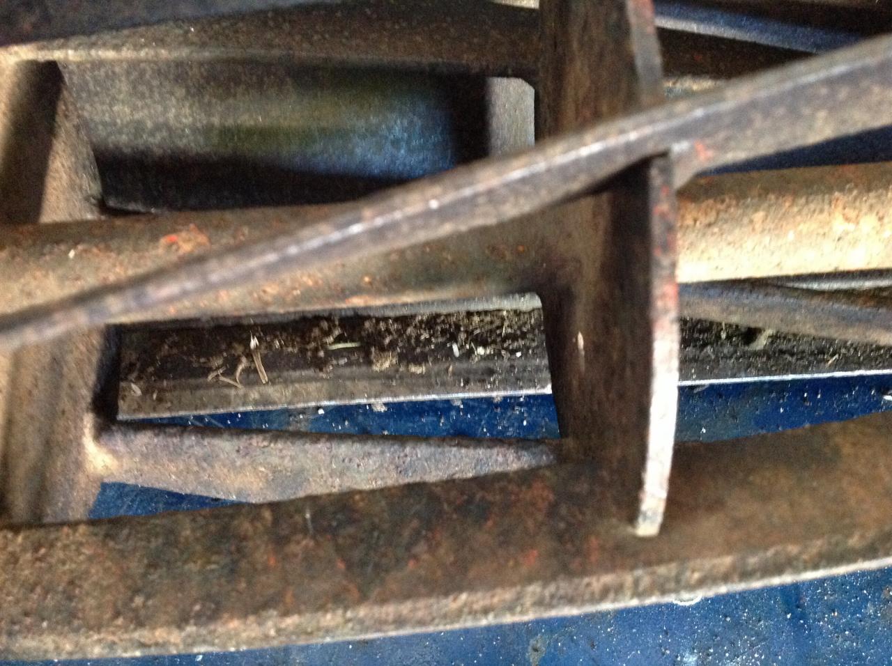

The chains and sprockets look to be in serviceable condition, as is the cylinder reel with plenty of 'meat let in it for re-grinding, which it badly needs as does the bedknife blade.

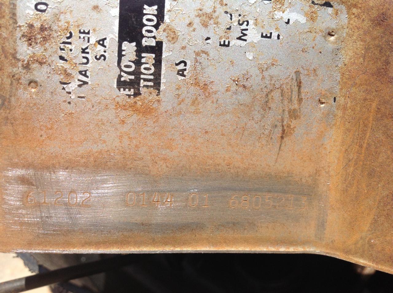

That's great thanks for the info! Managed to find the serial number!
61202 0144 01 6805213
Well we have the whole engine off now and it looks like we're going to do a proper engine overhaul while it's off! Tomorrow I'll be removing the reel and sole plate, stripping the whole frame down to get ready for a re spray and to gather a list of any replacement parts needed.

Great news on the Model, Type and Code, I can now tell you it is a real early one for a Scotty as the Scotty 45 was first introduced in 1968. Your engine was manufactured on the 21st July 1968! Wow! grin
Good luck with the overhaul,
Whoops, typo Deejay. 21 May 1968, at Plant 3 (Rolla, Missouri). That makes it even more likely the engine was built into a mower before the end of 1968. Do you know what month manufacturing of the SB45 began?
