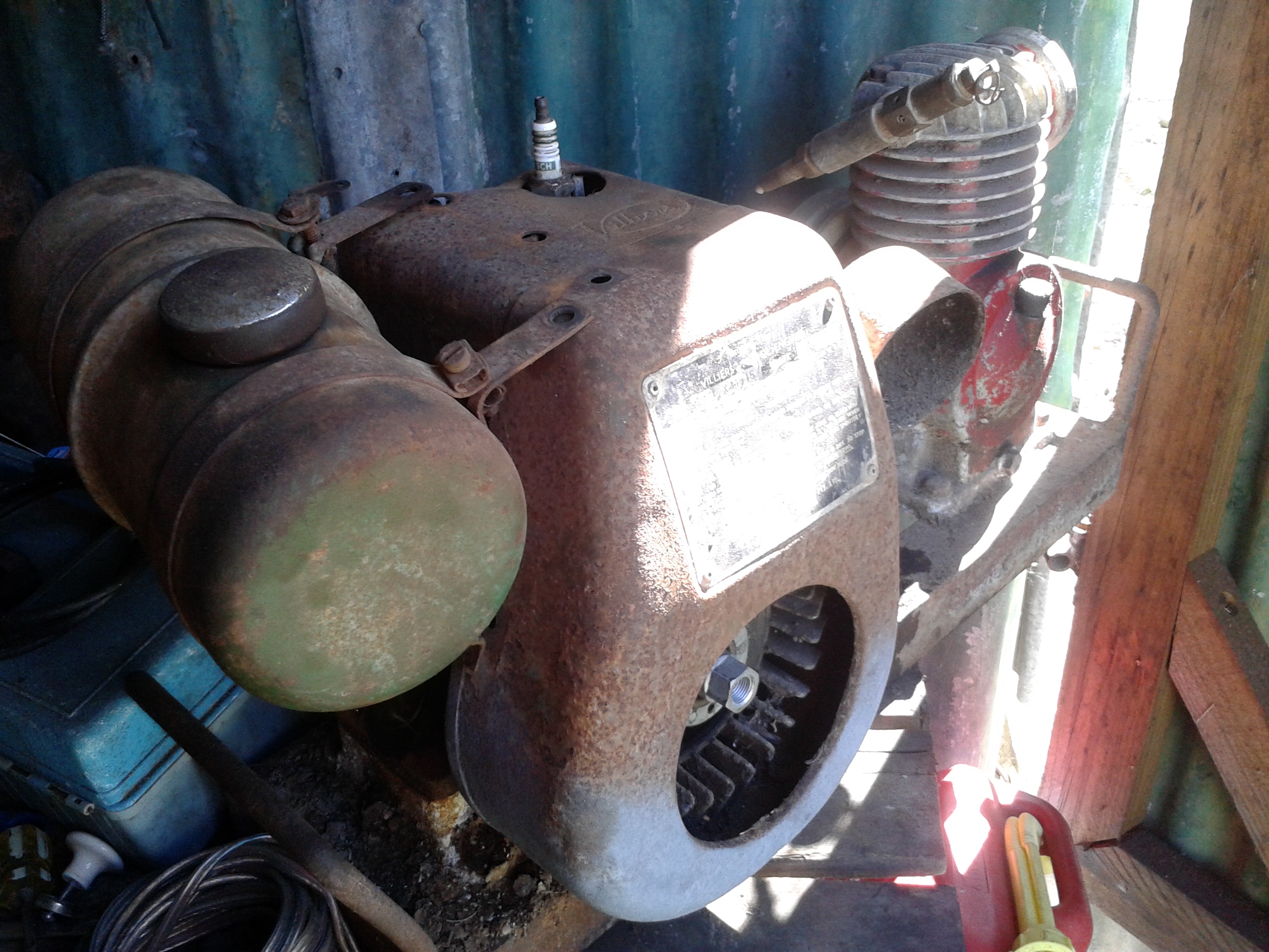

G'day all,
i have a Mark 12 and a Mark 12/2 Villiers which has no spark.. they sure give a kick when i go to turn them over, but no spark at the plug?
I believe these old villiers had a bit of trouble with the electrics, but im not fantastic when it comes to coils, windings et.
is there anthing i may have to do/clean.. whatever!
I really am buggered if i know, so maybe one of you will?
Thanks,
Tyler

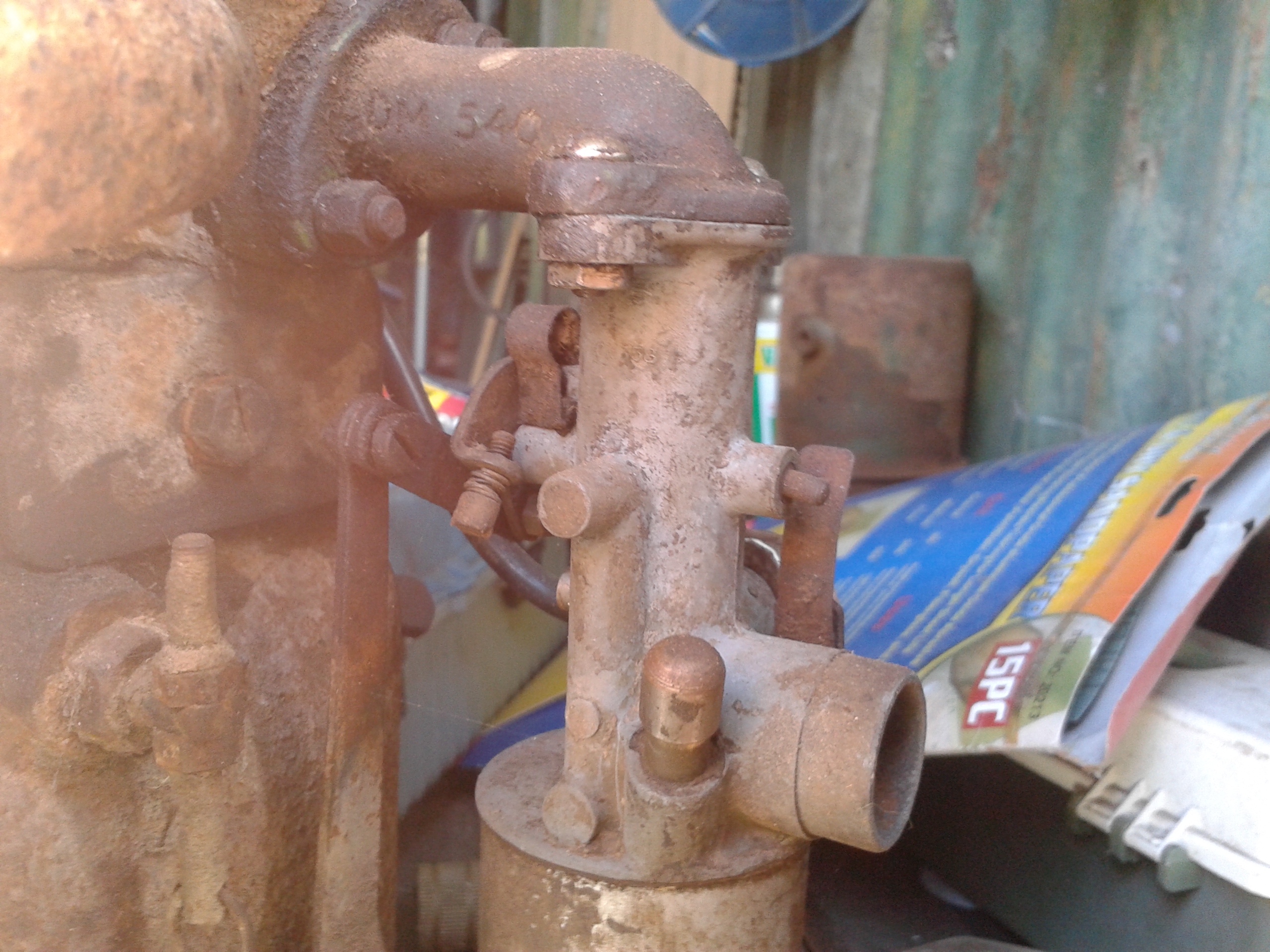

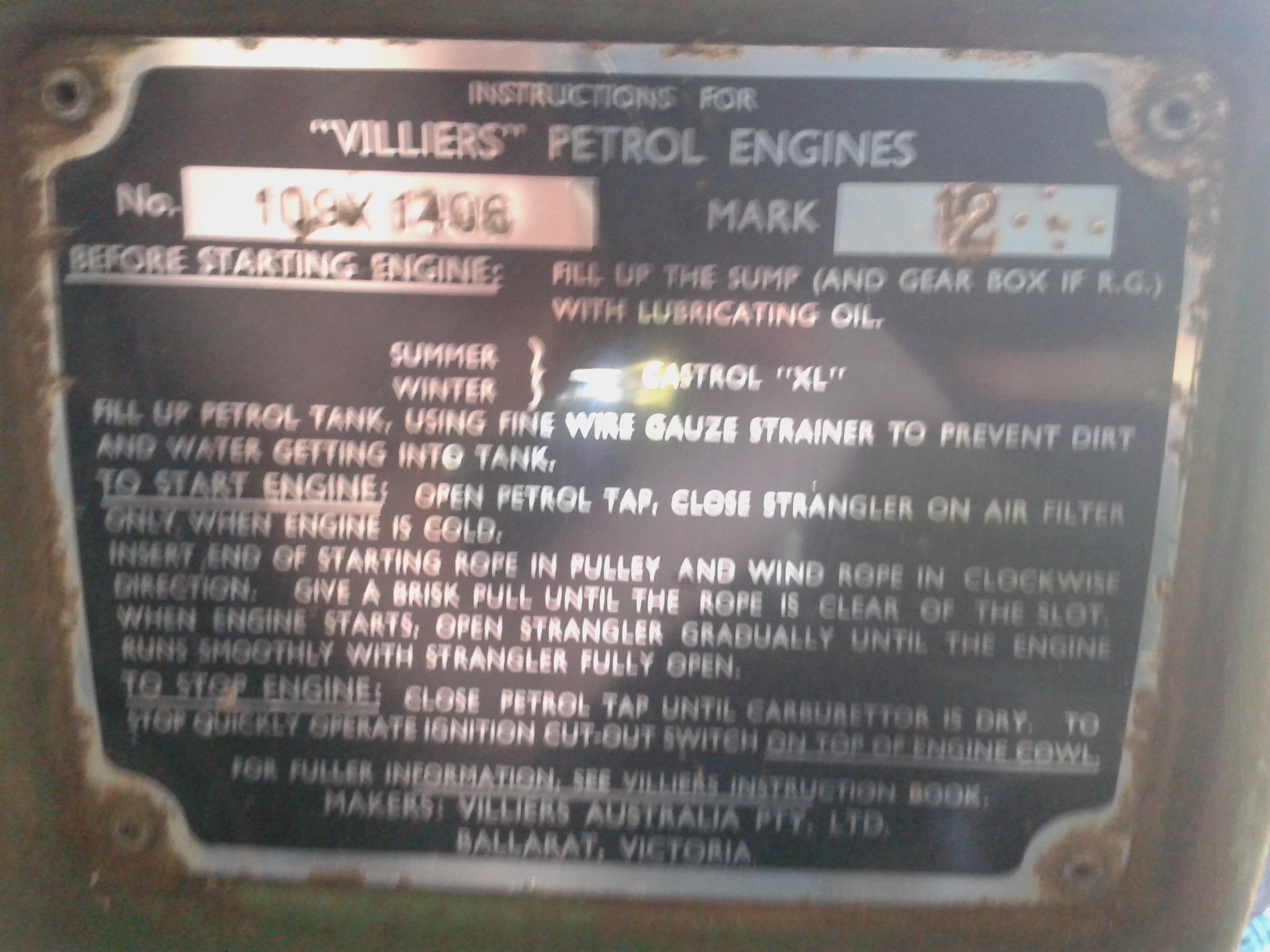

heres a few photos of the Mark 12/2
